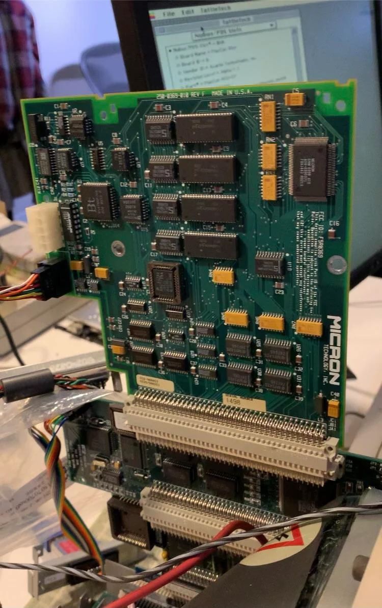

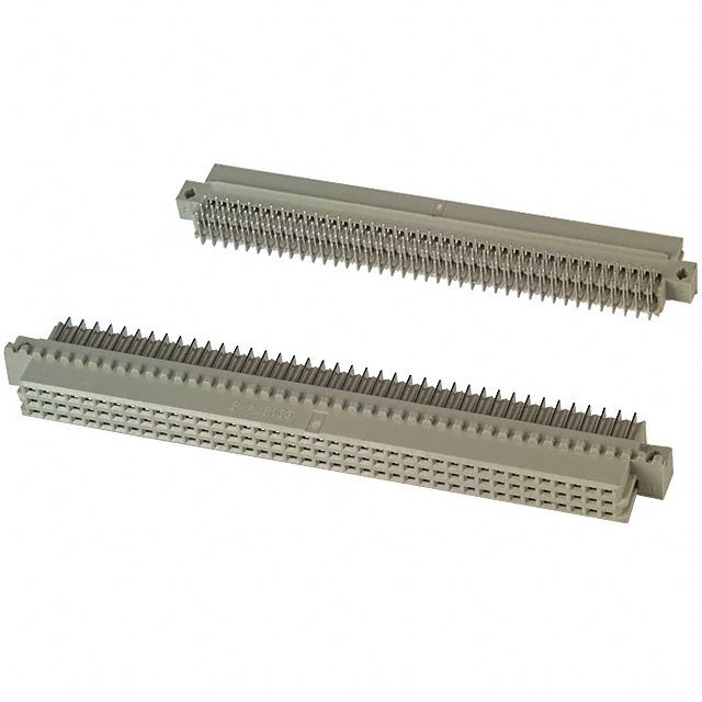

Before I order, I'm hoping someone can confirm which of the three (or maybe all three) will work. They look the same to me, mechanically speaking: they're all right angle, which should do the trick. They're 120 pin (40 x 3 rows). The prices range from $9 –$11.

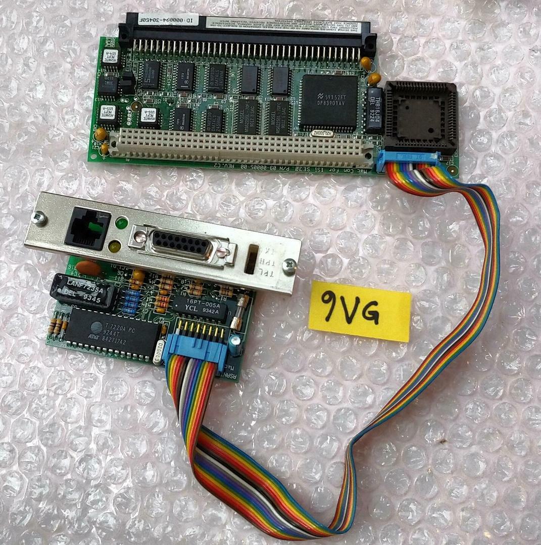

The plan is to remove the PDS connector and adapt my Asante Ethernet card passthrough slot so it can chain a video card above it (not an Xceed, mind.)
Is there really any difference between polyester and "polymer thermoplastic”?
Seen on mouser as well — only one option there, and better pictures which suggests it's the right thing.
Looks right to me, the keying of the connector is the only thing that could possibly be a problem. We called this "wrong angling" the connector on just this kind of card in order to use it underneath the short version of the DiiMO accelerator adapter @Bolle came up with in that project. Don't recall any problems at all about keying offhand.
Visualize this connector soldered to the component side of the NIC. Check the keying on the VidCard, it'll almost certainly be compatible. ;)
That's enough confirmation for me, thank you!
They're inexpensive enough I might get a one from each to test out, would rather have too many that too few or not the right one.
