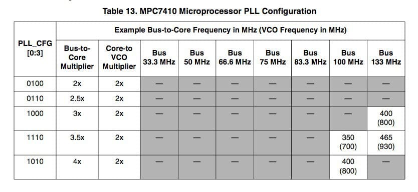

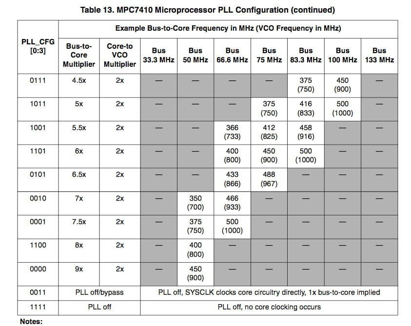

Originally this topic was about how I couldn't get my G4 upgrade card working in a B/W G3. Initially, I thought something weird was going on with the board revision and such, but discovered (thanks, dosdude1) that the switches on the card weren't set right, and the card was trying to run at...600MHz. Yeah, that's...a tall ask to say the least. Because I had pulled the card out of a beige G3, the bus speed is different and that caused everything to go sideways.
Also, unfortunately, my Google-fu wasn't finding the config settings for the dip switches on the card. As he does, dosdude1 delivered, and here they are for everyone to enjoy.
I can confirm firsthand that these work (on the NewerTech MaxPowr G4 card for the beige G3/G3 blue and white)

First, I had completely forgotten I had posted this, my oh my. I got wrapped up in some projects that went sideways and meant to update this.
So what actually had happened was I forgot to account for the bus speed difference between the beige G3 and the B/W G3. So...the problem was that with that considered, the G4 was trying to run at *600 MHz.* Yeah, not gonna fly very far, if at all.
Thankfully, (courtesy dosdude1) I was able to find the jumper settings for that card (it's a NewerTech CPU with dip switches on the card itself) and setting it to run 400MHz with a 100MHz FSB got it working just fine. It was just my dumbassery that caused it all to not work. And a lack of documentation. Which I need to upload here. Now that I have a second to breathe I'll get around to it.
