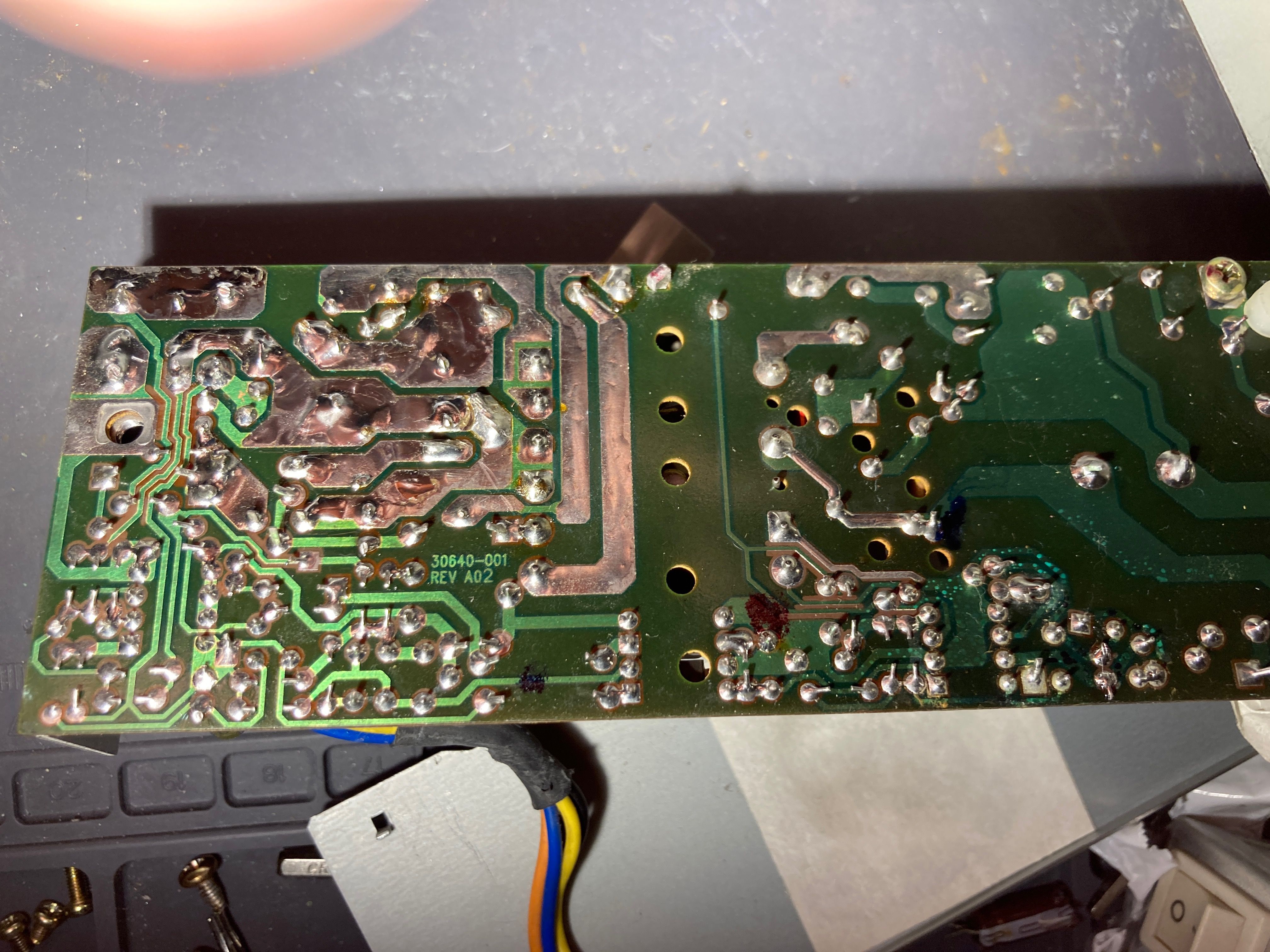

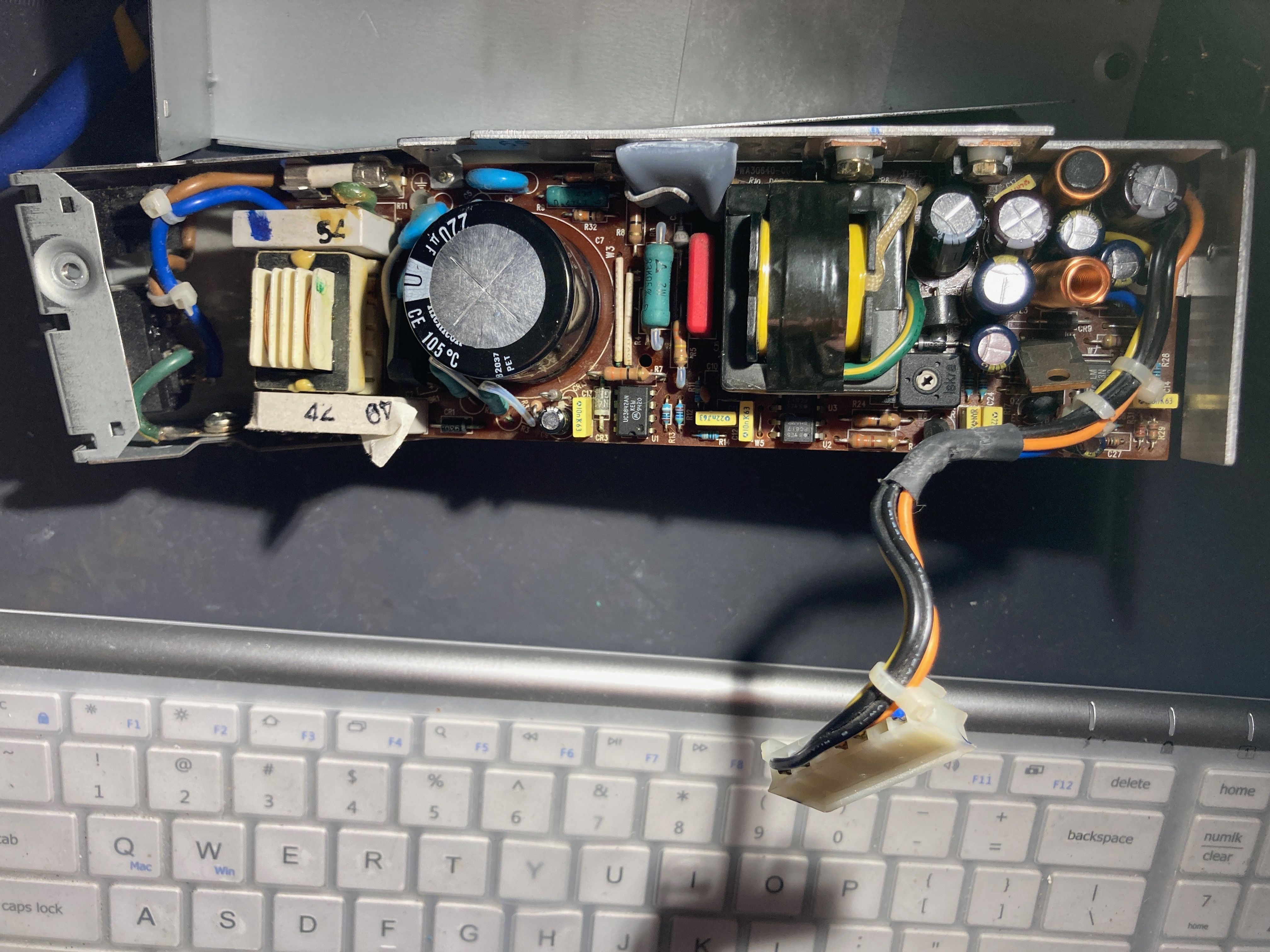

Hey guys. I just recapped a dyna comp PSU. I tried to test it on my LCII and it didnt do anything. No power to computer. I assume that this thing is compatible with my LC. Previously I had recapped a TDK and this one didn't give me any trouble. Anyone ever work on the Dyna Comp model and experience this? I'm sure I did something stupid, but not quite sure what.
Also the "pads" on the soldering side were unlike anything I had ever worked on. Maybe I soldered to this incorrectly? Any help is appreciated.

Hi @mloret! :) 👋
At first glance at the second picture of the bottom circuitry of the PSU, I noticed some solder joints are bridged. That is not good as that causes shorts and possibly other issues. Here is what a bridged solder joint looks like:
Review this guide to try to identify other solder joint issues you have. You will need to remove the bridgings and redo any problem joints. Using magnification will help.
Good luck. :)
