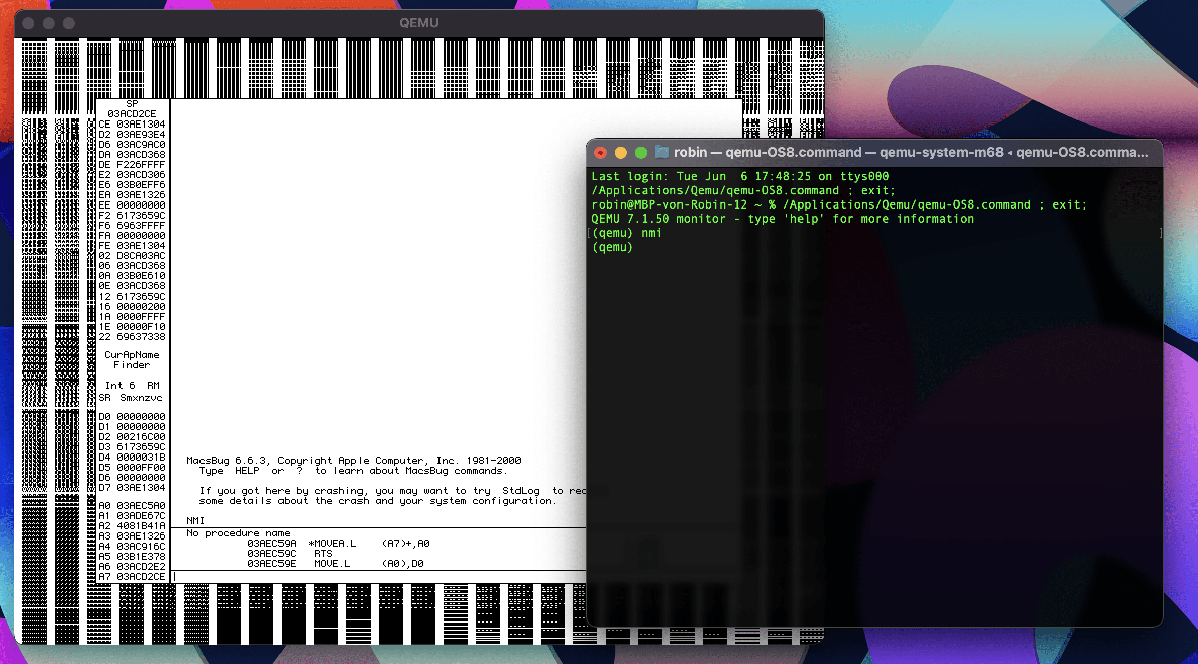

It appears to be buggy, but I tried it in Qemu Quadra 800 running MacOS 8.0.
Well that’s great! Thanks! I will check it out.
Those video artifacts in your first snip are normal for Macsbug running in a screen bigger than its default display size. I think it just fails to clear out that area of video memory representing the pixels outside the Macsbug display, or just randomly writes nonsense to it.

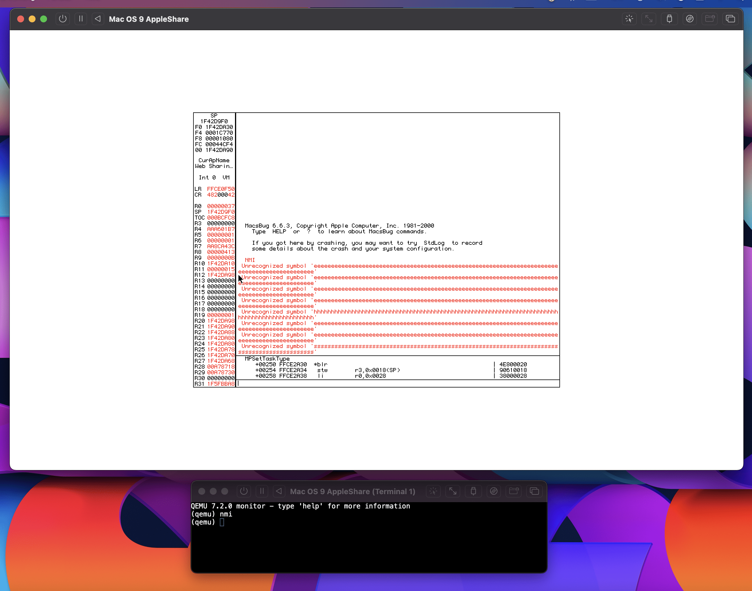

You can also start MacsBug inside UTM running Mac OS 9.2, but there is an issue with keyboard input
I think I get this same problem on a real Power Mac 8600 running Mac OS 9.2. Something wrong with autorepeat?
This happens under Mini vMac, too, when emulating at high speed. I think Macsbug, to keep it lightweight, may be doing something in its own code to replicate the normal key repeat function and whatever it is (at least in earlier versions of Macsbug 6) breaks on a really fast Mac. (Curious what version Macsbug you see this under?)
MacsBug only uses 640x480 so it appears in a small window in the middle of the 1600x1200 display.
I'm using MacsBug 6.6.3. It seems to work fine on my B&W G3 running 9.2.2 except for some corrupted pixels. I can't see the background while in MacsBug because the pixel depth is not set to 256 colors.
On the 8600, the background is visible in full color while the screen is set to 256 colors and there's no corrupted pixels for any color depth. Pressing Escape hides the MacsBug window and shows the full color background but pressing Escape again doesn't unhide MacsBug (maybe because of the key repeat problem) but clicking the mouse does unhide MacsBug. I can use the mouse to select some commands from menus or to retype words that I click on.
