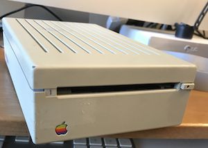

This is an external 3.5 inch drive, model number is consistent with 800K. The cable was cut off but it does work as I've tested it with the cable from a 400K external drive. I want to build a cable and have a 20 pin ribbon cable and have ordered a 19 pin male DB connector. Is this a straight through pin 1 to pin1, pin 2 to pin 2, etc cable?
I am tempted to use my floppy emu the cable as it has the right DB and flat cable connections but I don't want to ruin anything.

I can confirm the cable on this drive can be replaced with this Apple Iic to Apple Disk II cable and it does work on a Macintosh SE.......this drive should work on both an Apple IIe and Apple IIgs, however, still haven't tried it as fairly paranoid about compatibility/damage particularly after googling information on the IIgs.
Does anyone out there have a clue as to whether it should be a problem with the Apple IIgs?

The IIGS uses the standard DB-19 female floppy connector as well as Apple and other disk drive controller cards for the Apple II series.
I am going to look into the pin-outs.
Yes...I've seen some dire warnings as far as using an external from a Macintosh on the IIgs, however the unidisk is OK....but not sure now that I've changed the cable.
