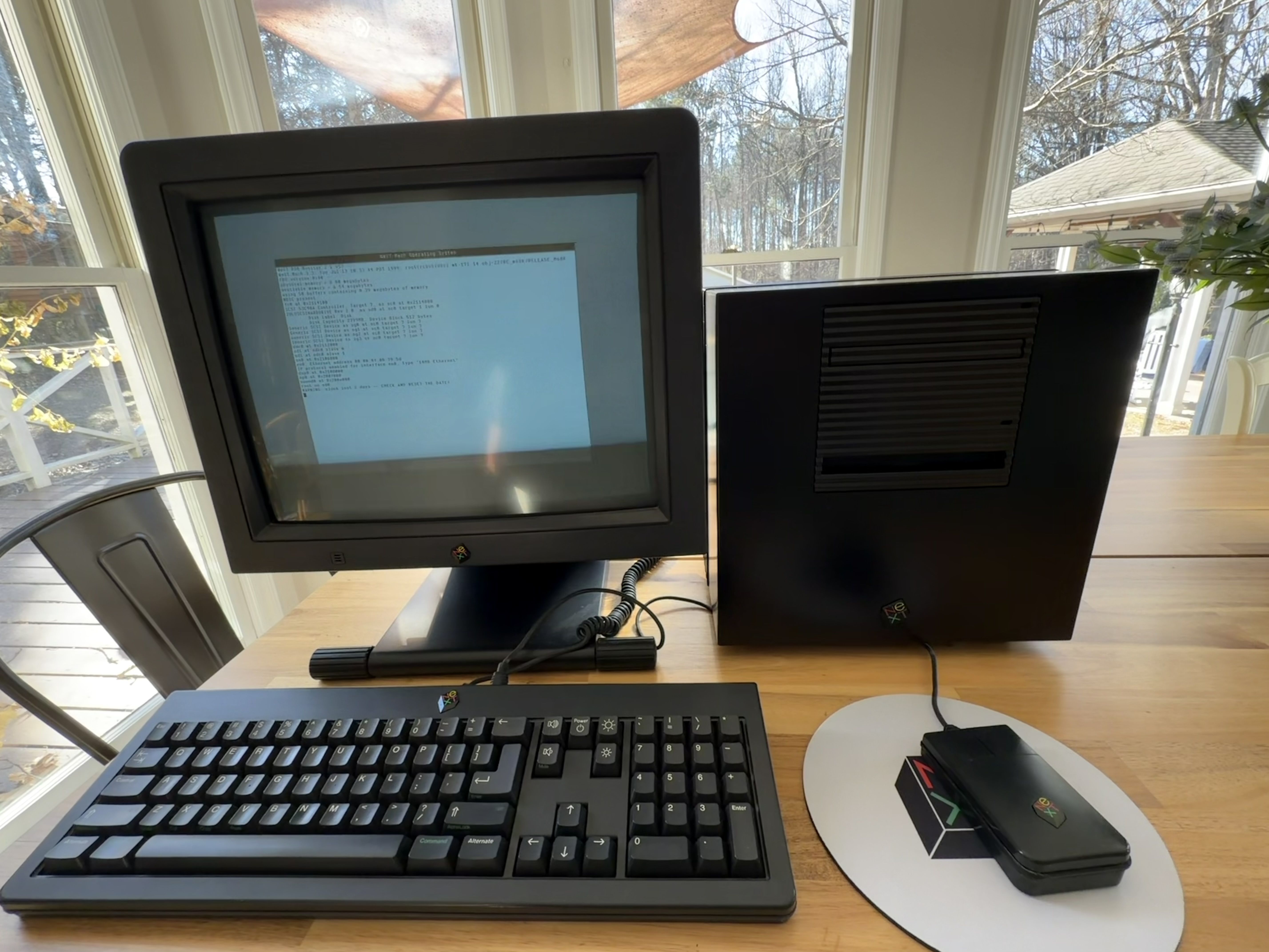

It's been on the top of my wanted list for some time. I've been selling a decent number of items from my collection and decided I had sold enough that if an opportunity came up to purchase one at a not unreasonable price, I'd finally pull the trigger. Well, I bought on earlier this week and it finally arrived.
I was surprised how nice condition it looked on the auction pictures. Unfortunately, it appears to have been painted (I should have noticed the Knicks and discoloration on the rear panel that were absent from the main case. Still excited to have this beautiful machine.

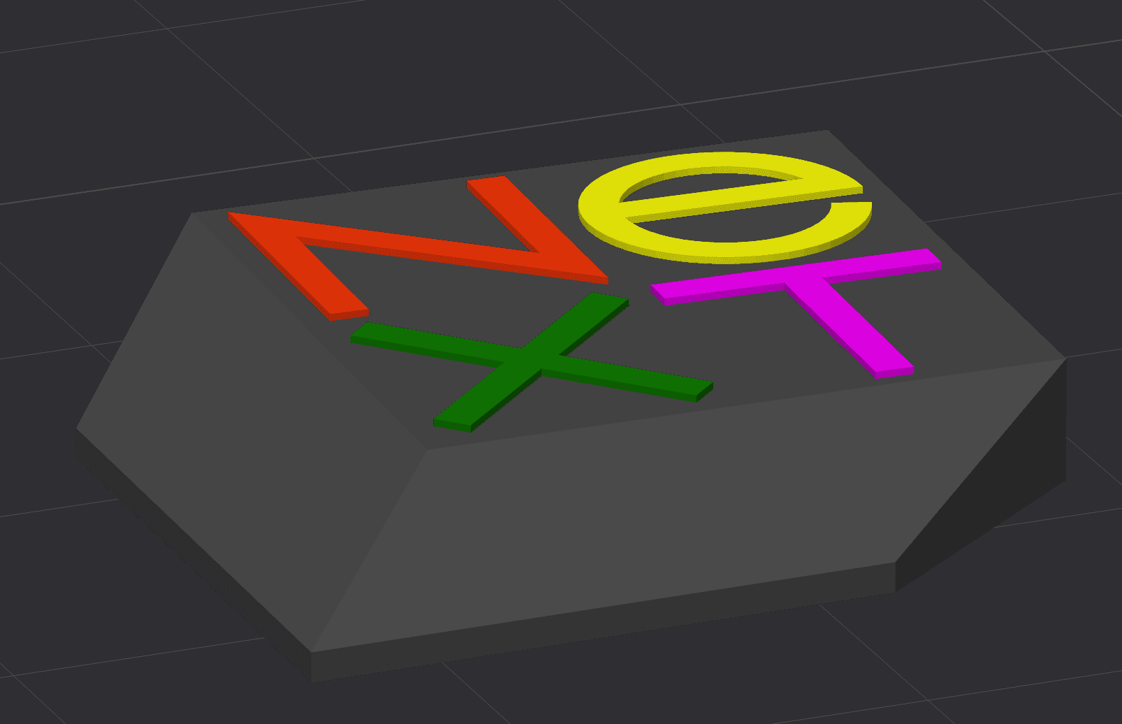

So I found a model of it online, it was scaled a bit wrong, so I resized it. I then sliced the letters off the base colored them according to the official NeXT colors, and am getting it printed in full color resin from JLC3DP. It cost me about $7 plus about $3 shipping. The model I got has the NeXT letters raised. I'm not sure if the original logo had that or if the designer did it because it made it easier to color the letters after printing in a single color if they were raised. I may print another with the letters basically at the same level as the rest of the cube..
I will send an update when the print comes in to show off the quality. This is my first color resin print, so excited to see if the quality is close to the single color resin prints I've gotten from them.

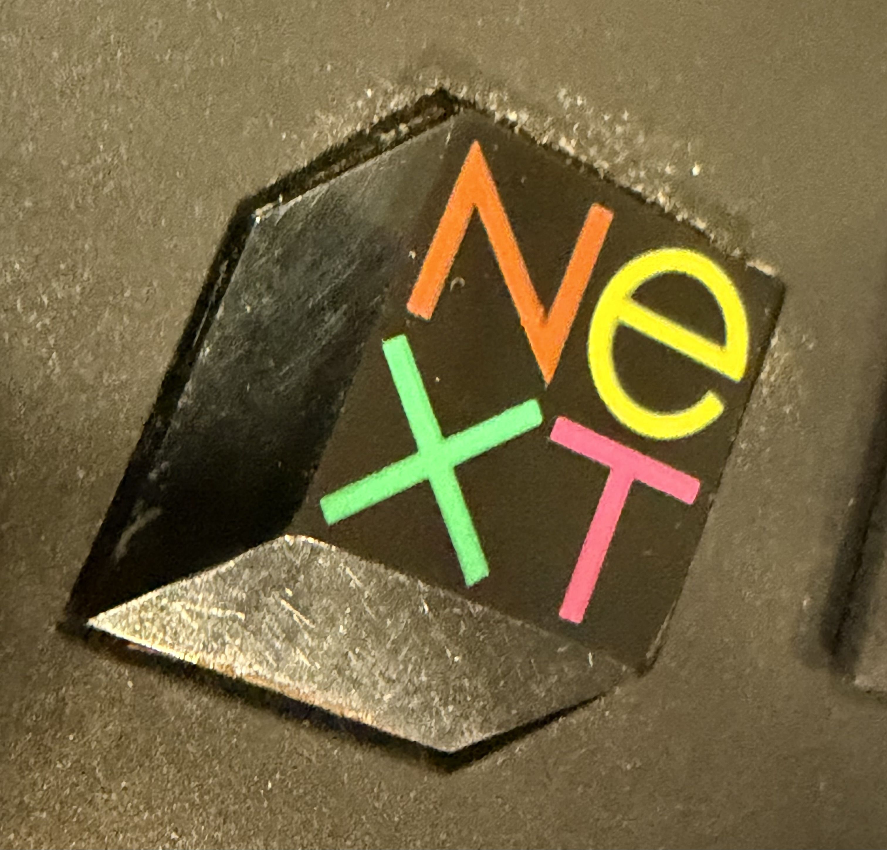

After about 6 back and forth interactions with the very patient support person at JLC3DP, I finally got a printable, full color model that they were willing to try to print. It's a bit thicker than the original, but it meets their requirement of prints being at least 1mm thick. The order is now in production, so I'll post the files (obj file for the 3d model, mtl file with the material / color) if it prints properly and produces a good result. I ended up getting a closer look at the original logos on my keyboard and mouse and the letters are not raised, so I adjusted my model to have the letters flush with the top. I can probably adjust if the result doesn't look good.
Can anyone with an original NeXT Cube badge confirm if the logo has raised letters?

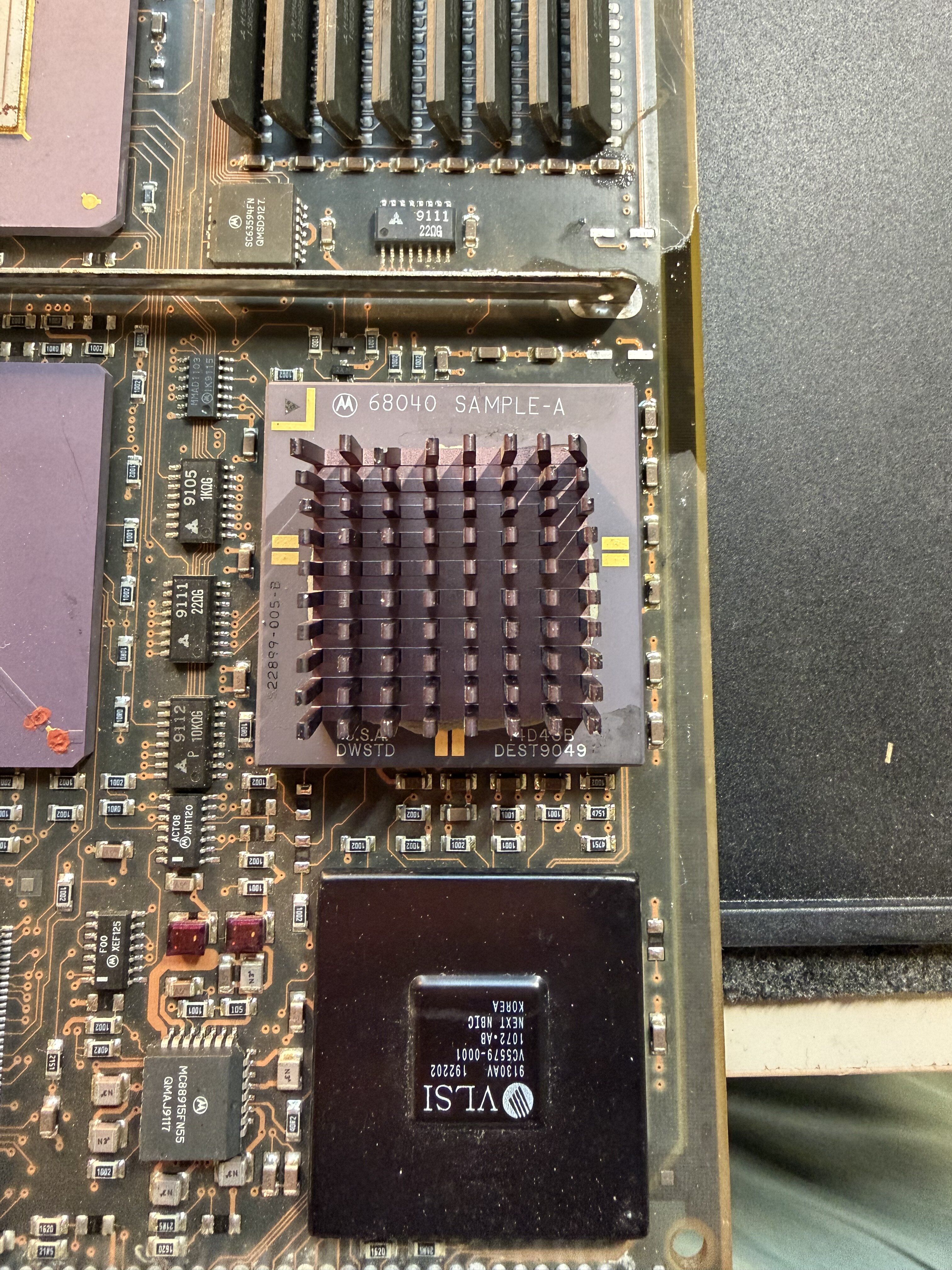

So, I just recapped the logic board (it looked like someone had recapped, but the surface mount caps were poorly done, and I wanted to get some OS-CON caps in it for longevity.
It looks like maybe this machine had an engineering sample installed?
Is it possible that this was a reason it might have been running slowly? Any Risk to throwing a 68040 from my set of 040s from Macs that have been battery bombed? As long as it is a 25MHz or faster, I should be OK to do, right?
And probably figure out a way to add a heatsink similar to this one...
I wouldn't think that would be a problem, but is your board socketed? Mine isn't, but I know some Cube boards were.
Reactions: wottle
OK, I found the reason for the slowness. It appears to be due to the ZuluSCSI or SD card in it. I copied the same HD image over to a BlueSCSI and it is night and day. I suspect fragmentation on the SD card as a possible issue. I formatted the SD card and copied the HD image back on using the "cp -X" command in Mac OS X and will try it again. If it persists, it could be a bad SD card or a bad ZuluSCSI. But really glad to have it performing better. I remembered NeXTStep being a bit slow, but this was unbearable. Now it's back to performing better and I need to figure out if I can get Doom to run on the thing...
I will also likely swap out the 68040 for a standard one and keep the engineering sample protected separately. It's also worth noting that my NeXT Cube seems to have a pretty low serial number: AAK0000697. Not sure if it was an early run of the 68040 Cubes (still being called NeXT Computer)?

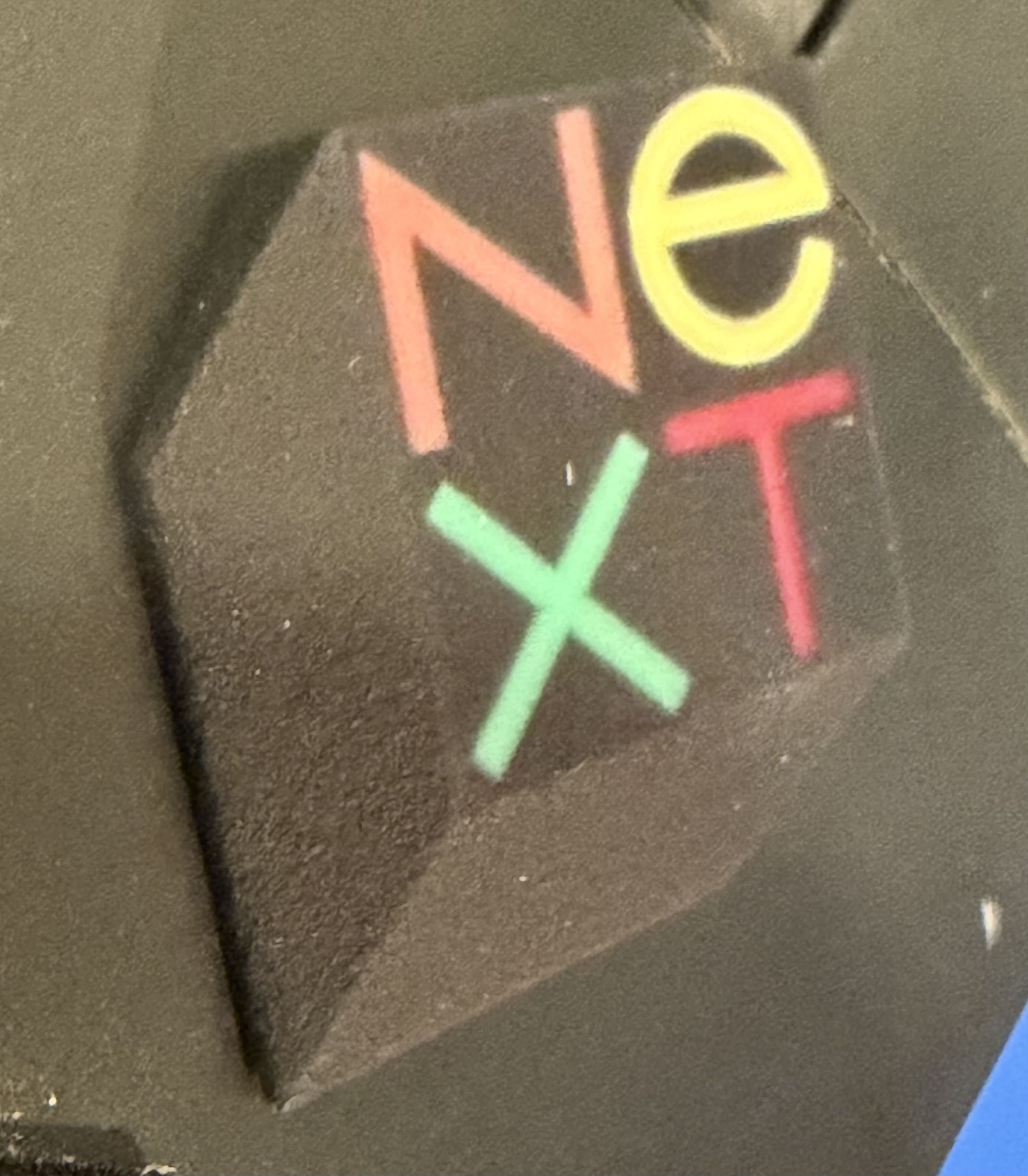

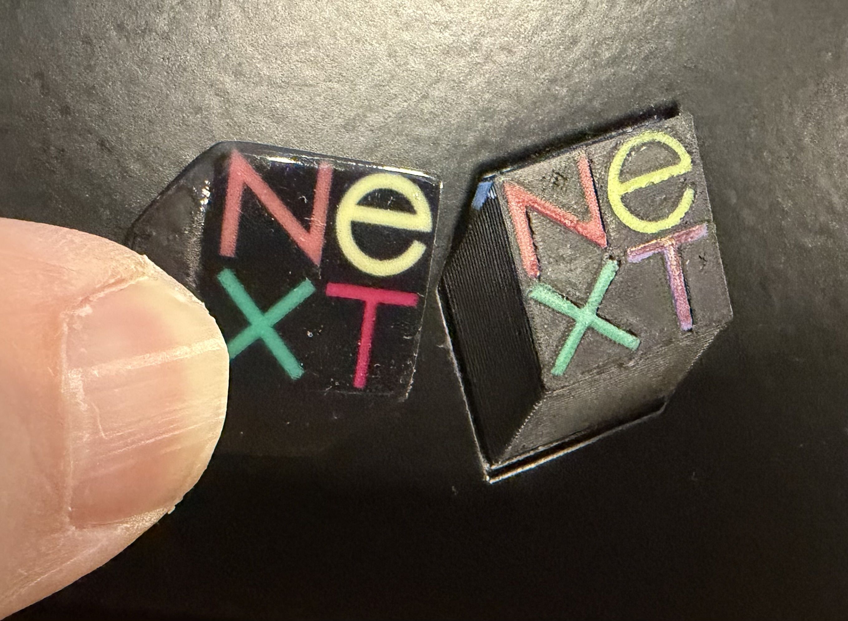

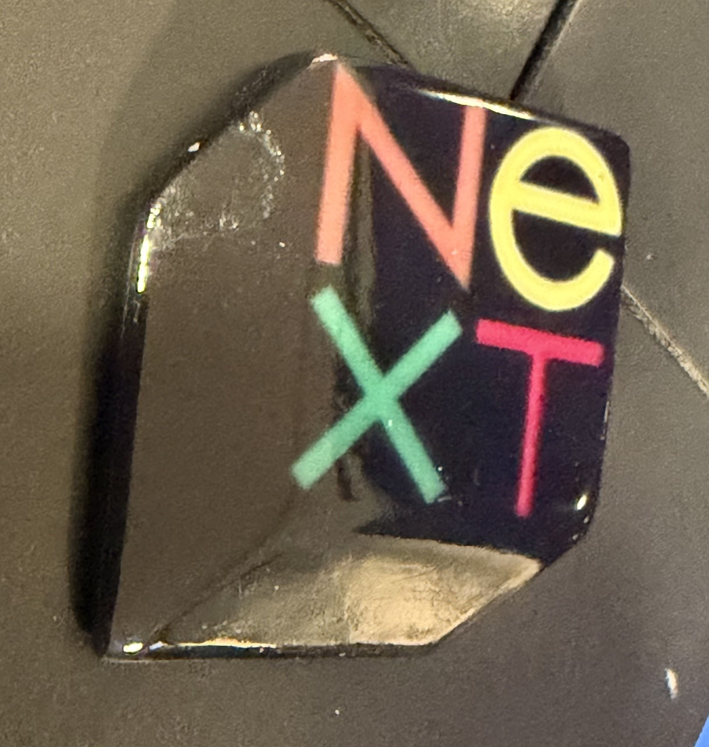

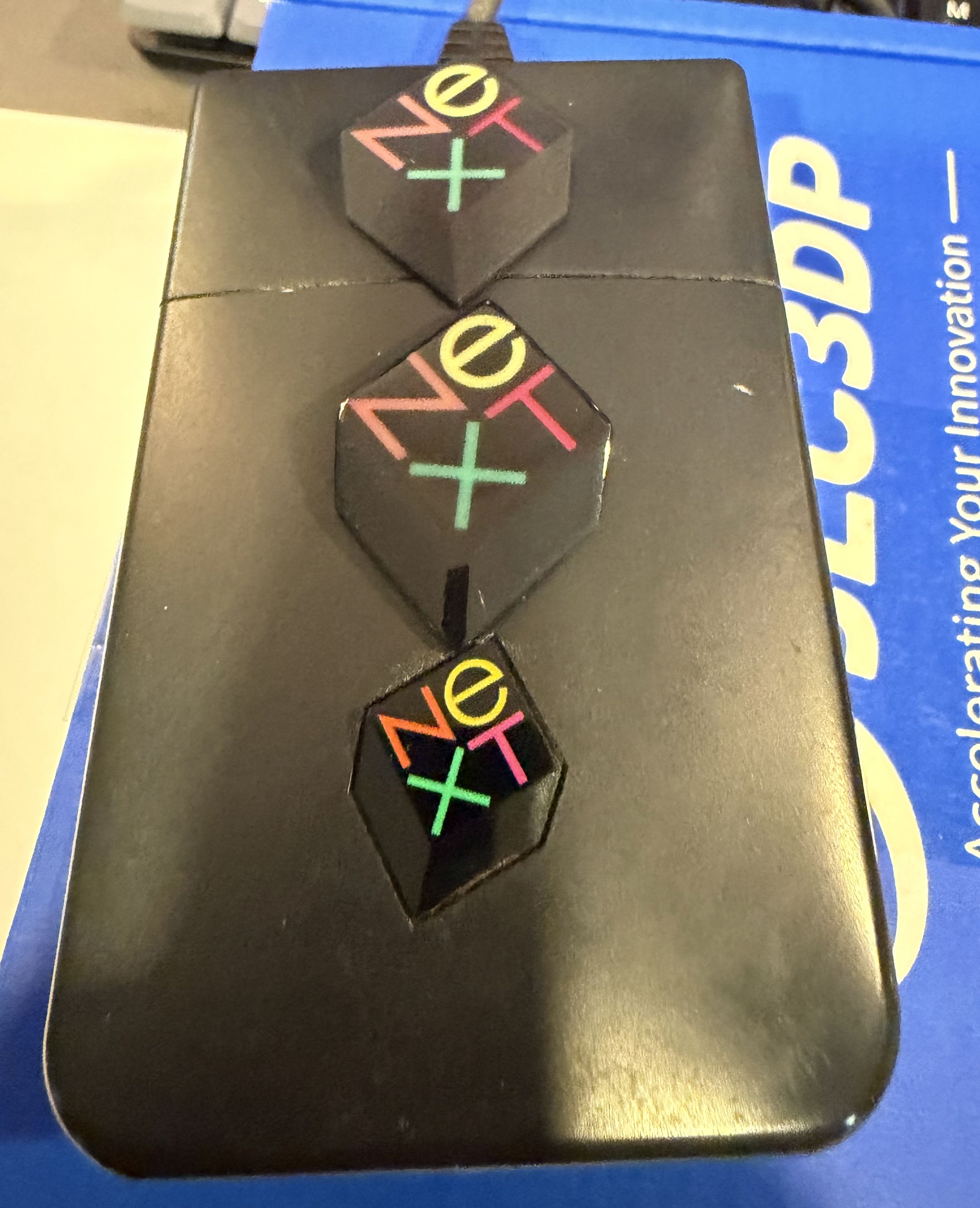

OK, so the full color resin prints came in. They're good, but might be better with some adjustments. The gloss finish really softens the edges so iy doesn't have the sharpness of the original logo. The matte one retains the crispness of the angles, but doesn't match the gloss of the original. I'm going to try a gloss spray paint to see if I can get the best of both worlds.
The colors could use a little adjusting. The orange and magenta are a bit too dark (may be due to printing bright colors over black?). Not sure how easy that will be to correct.
Here's some more detailed shots (original from Mouse, glossy, flat. next to FDM printed one on my Cube) :
