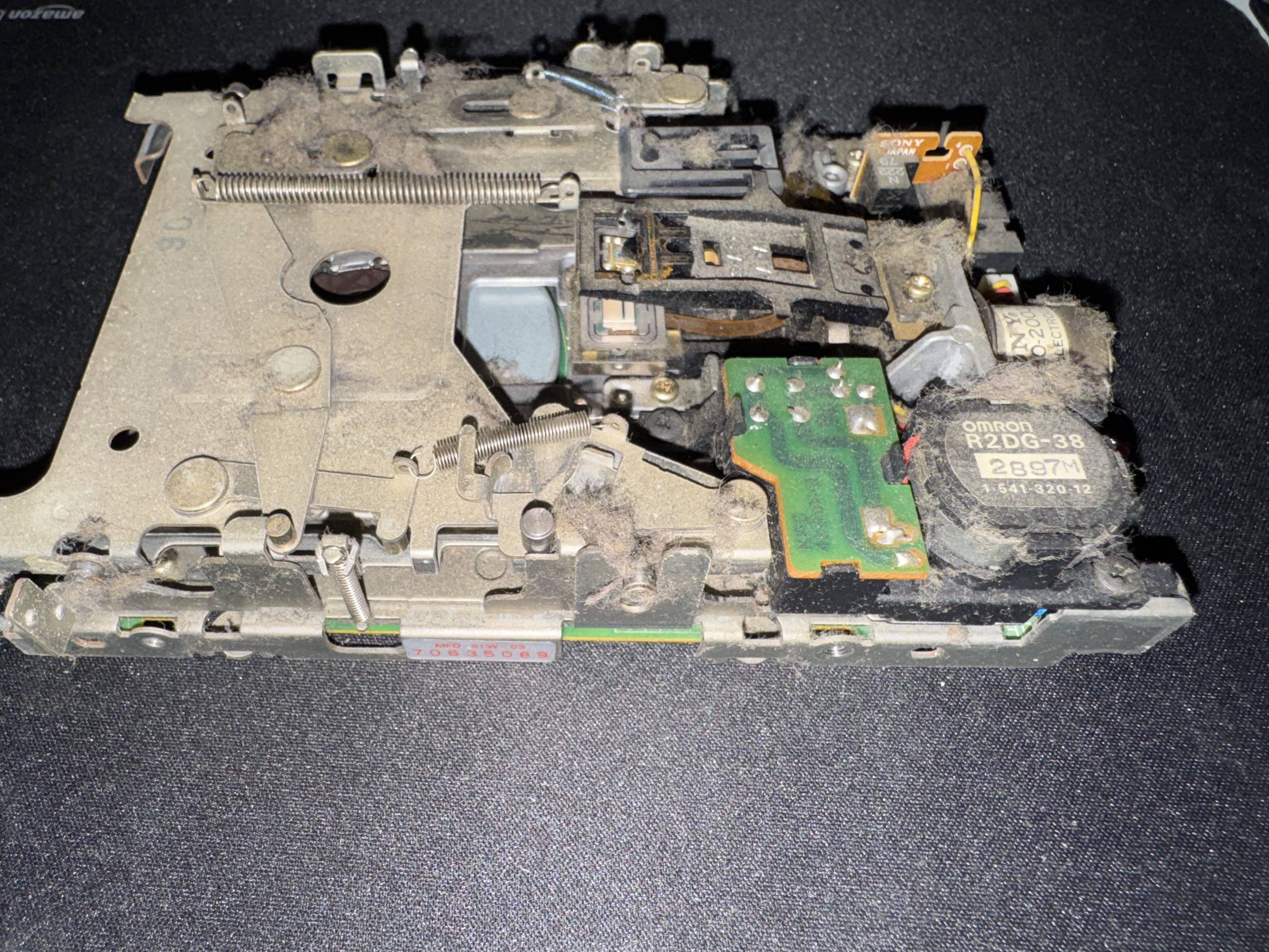

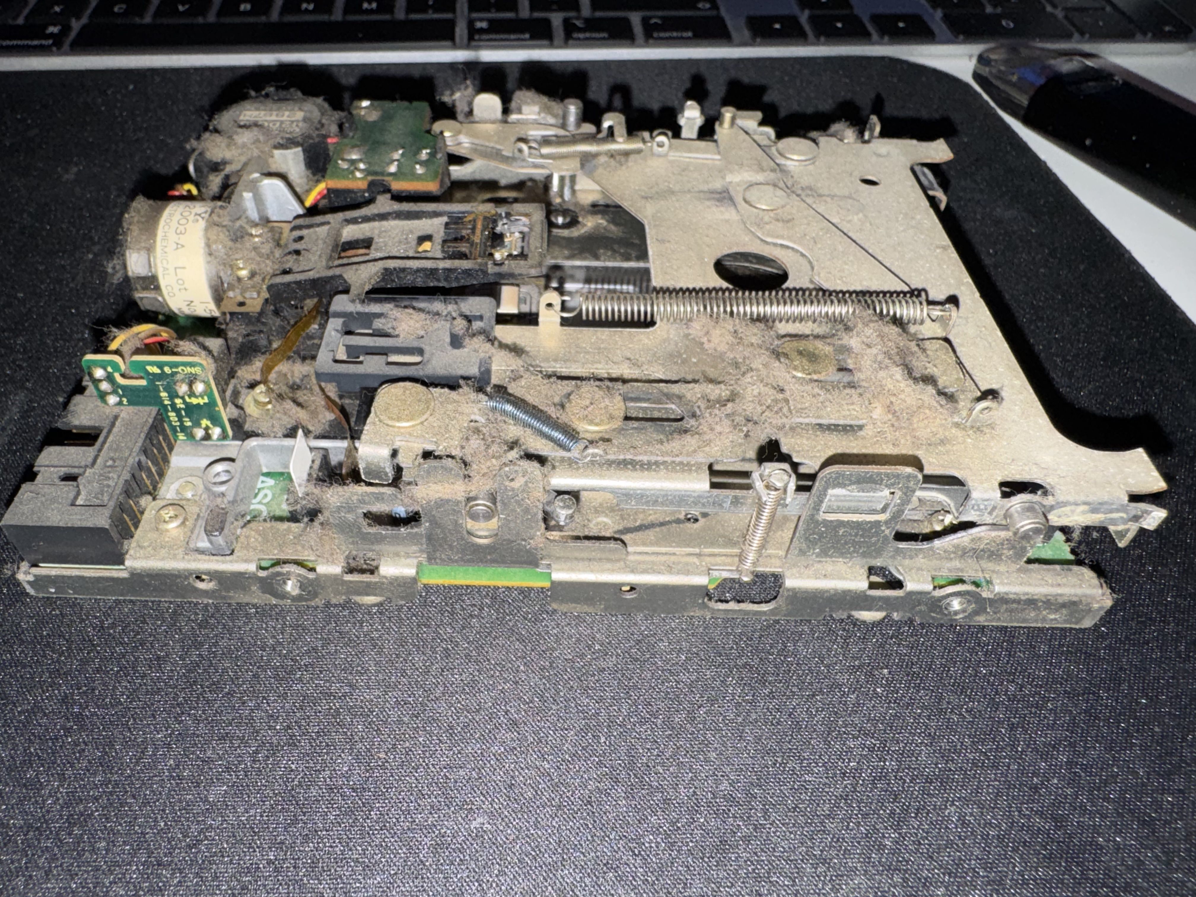

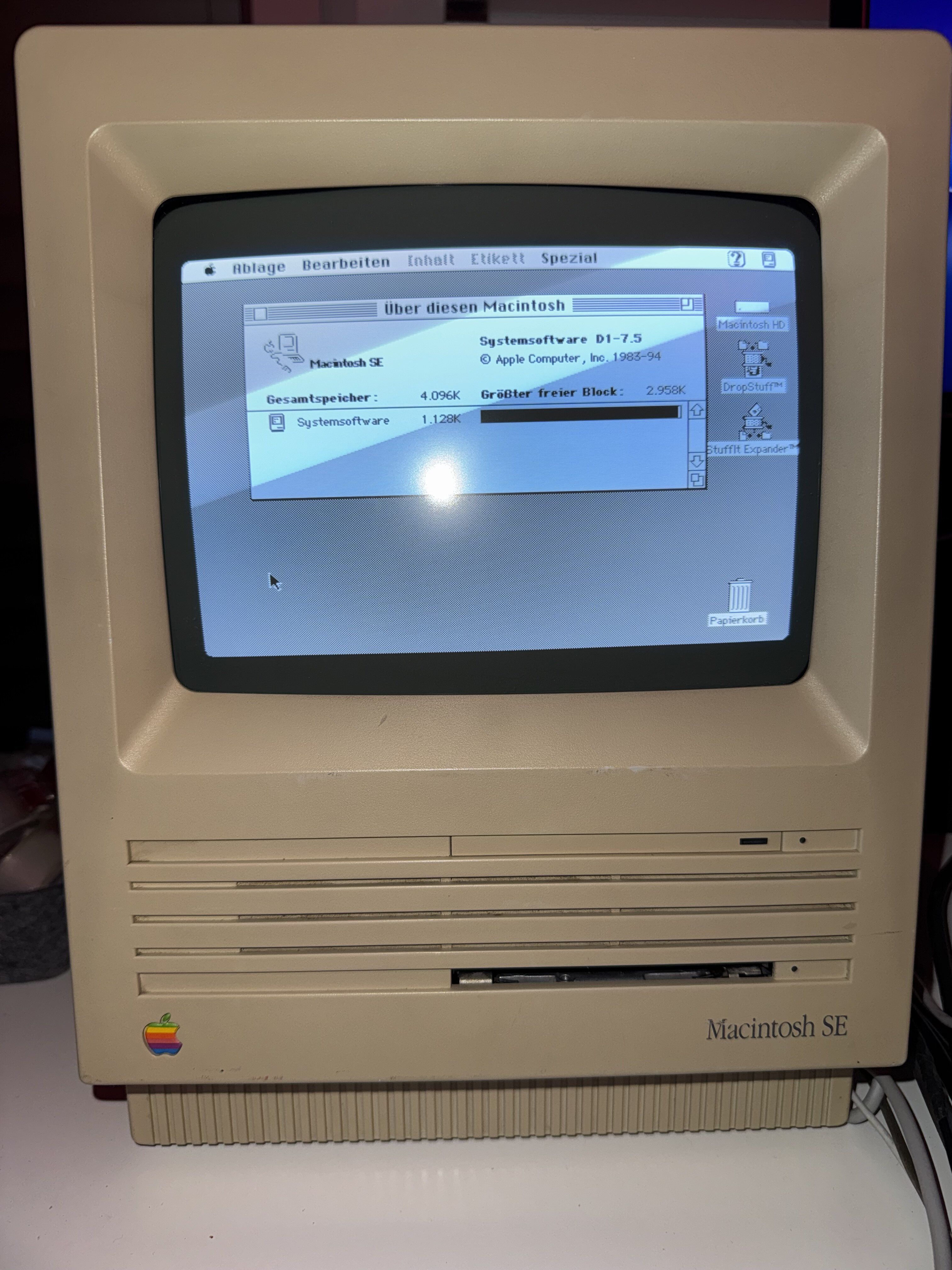

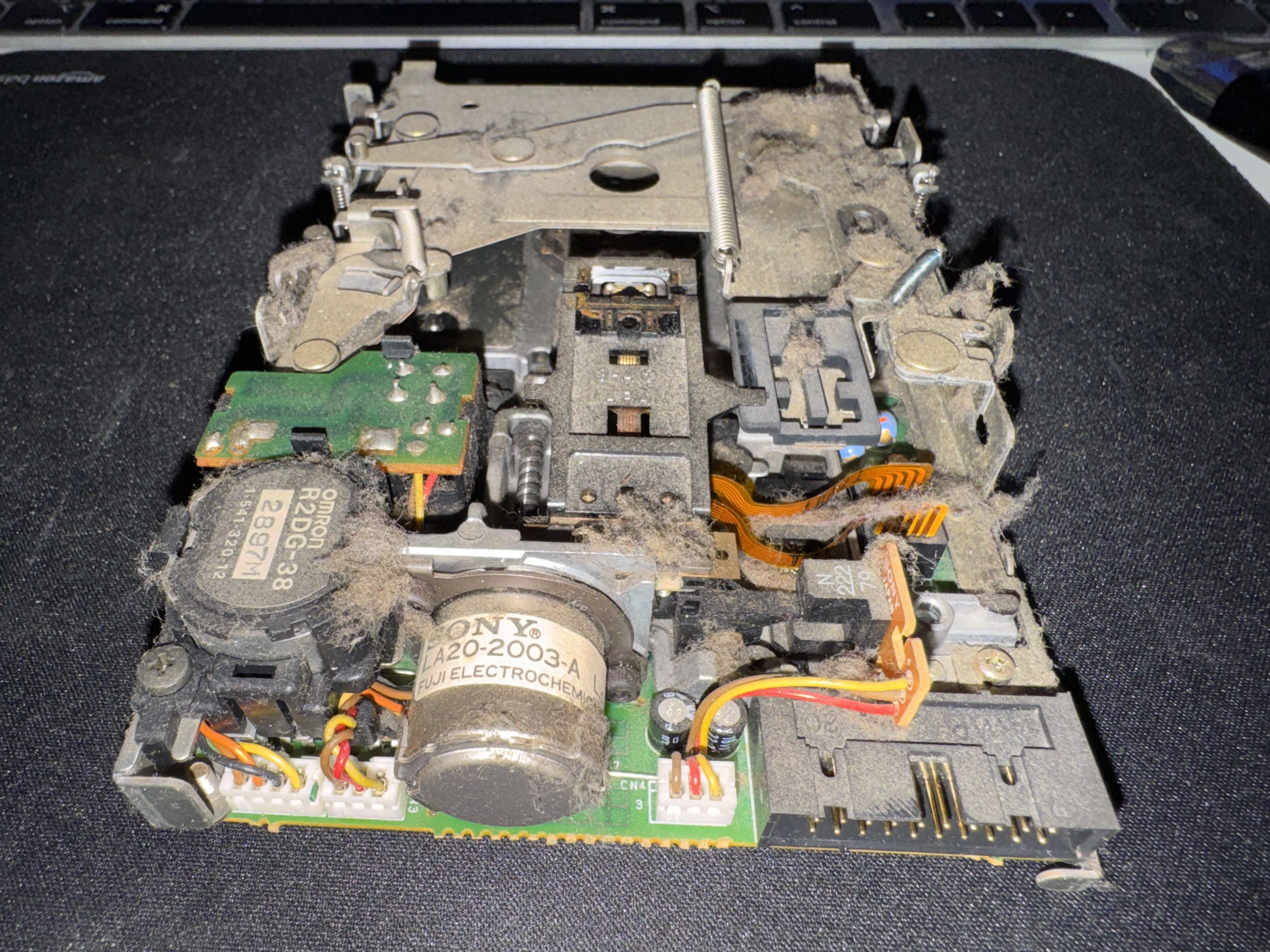

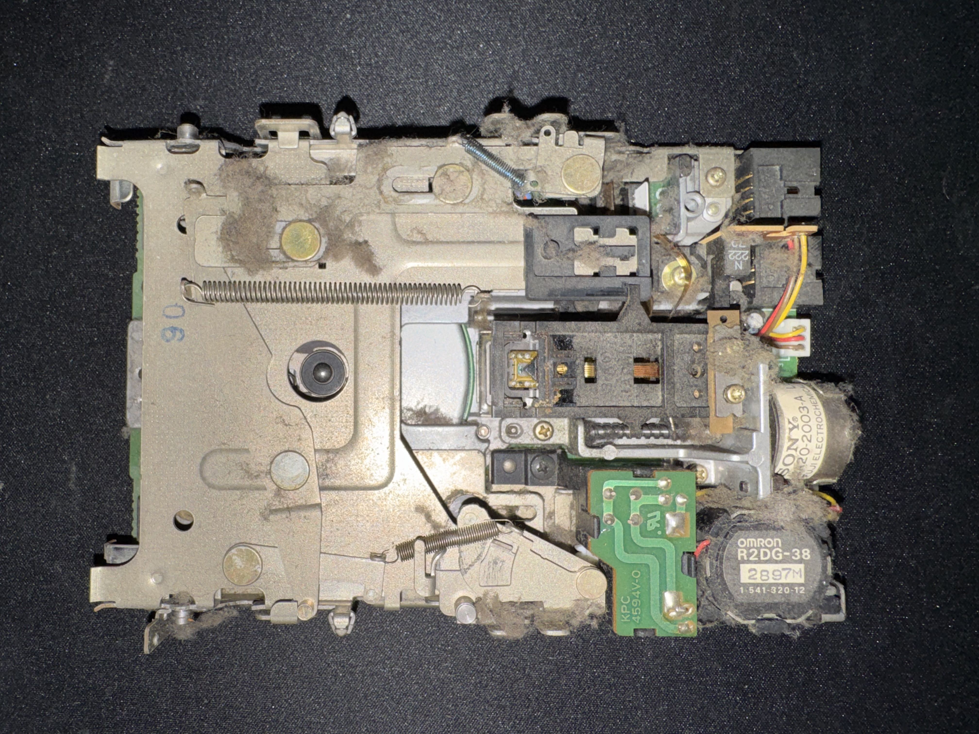

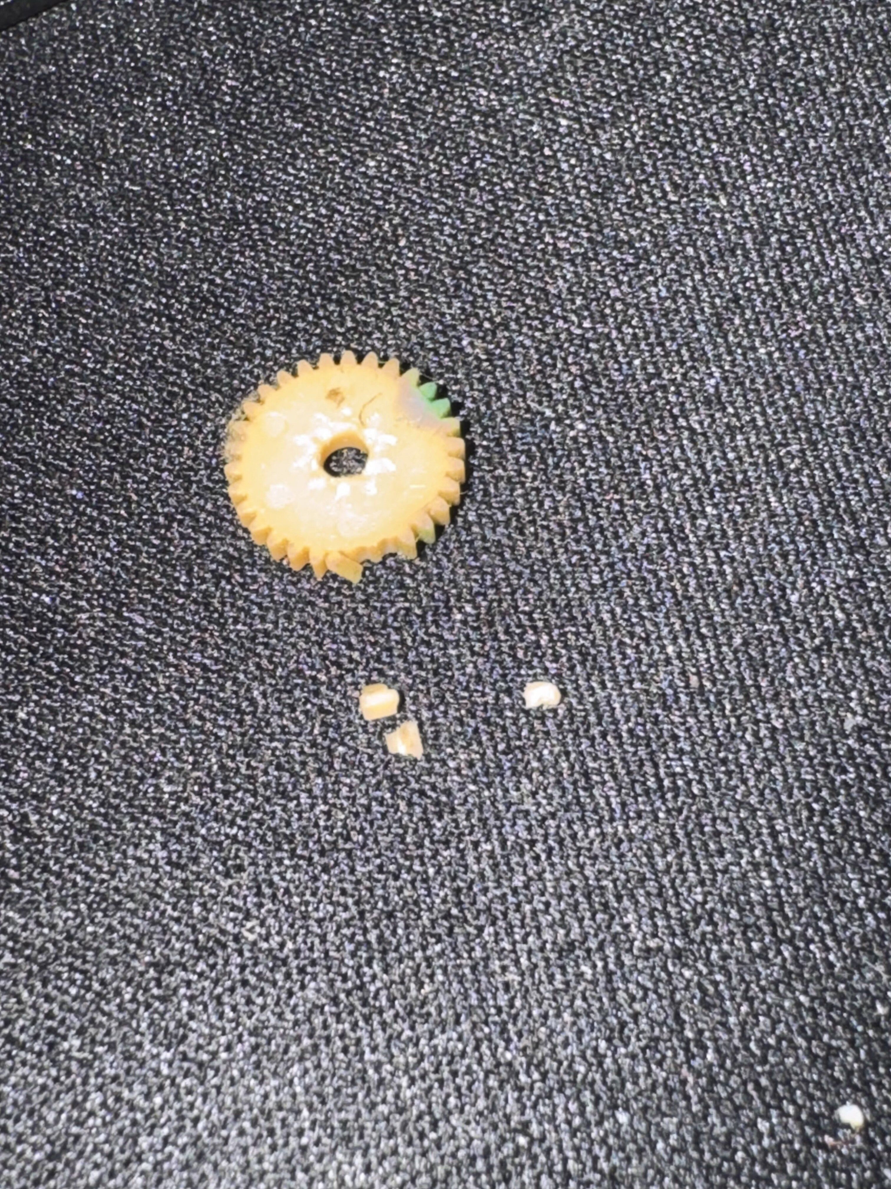

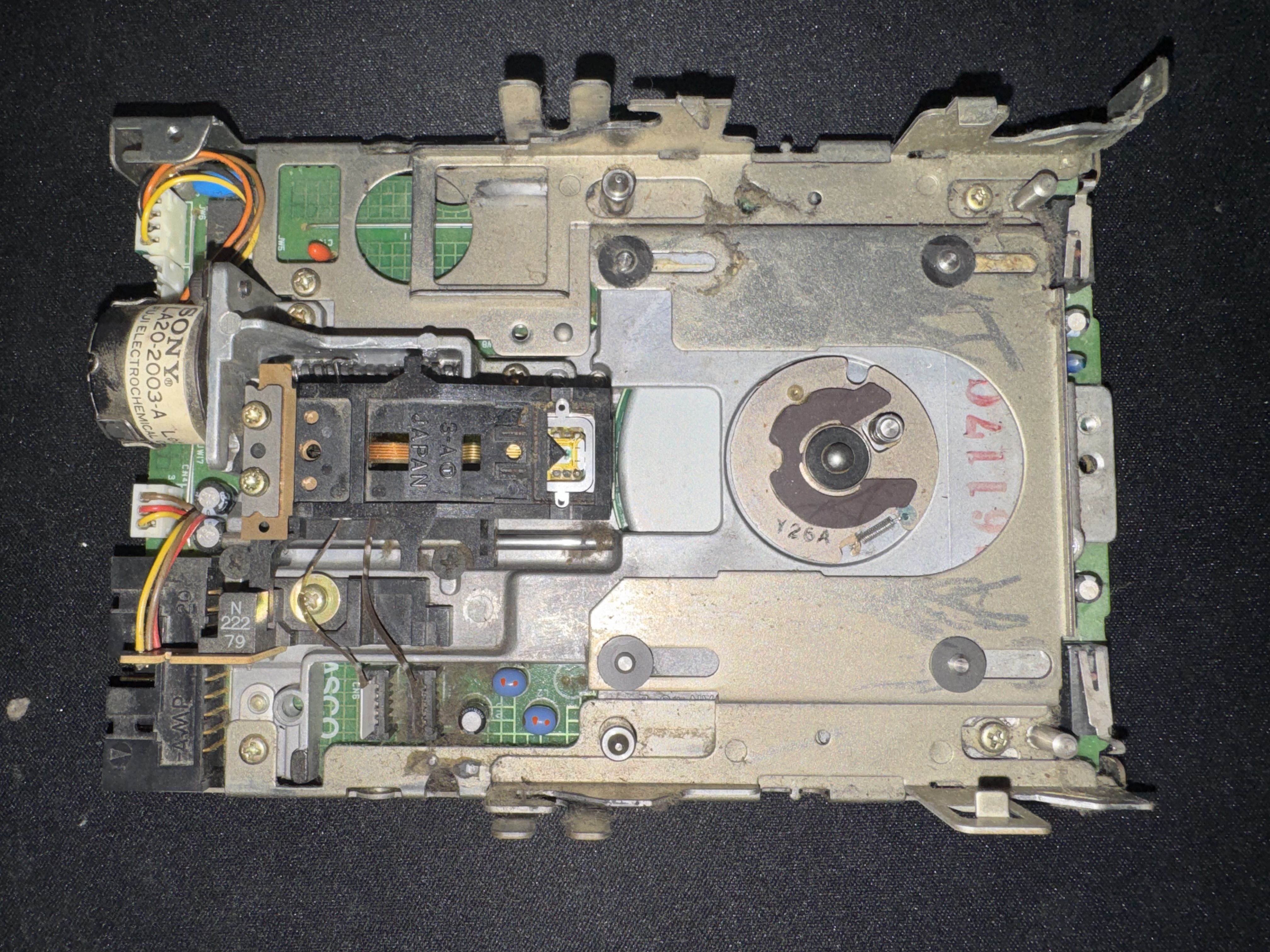

I actually did overcome my CRT fear today and finally fixed the floppy successfully (without getting shocked)!!
@GreenBar0n: your videos helped a LOT. I used the second video you sent as my walkthrough.

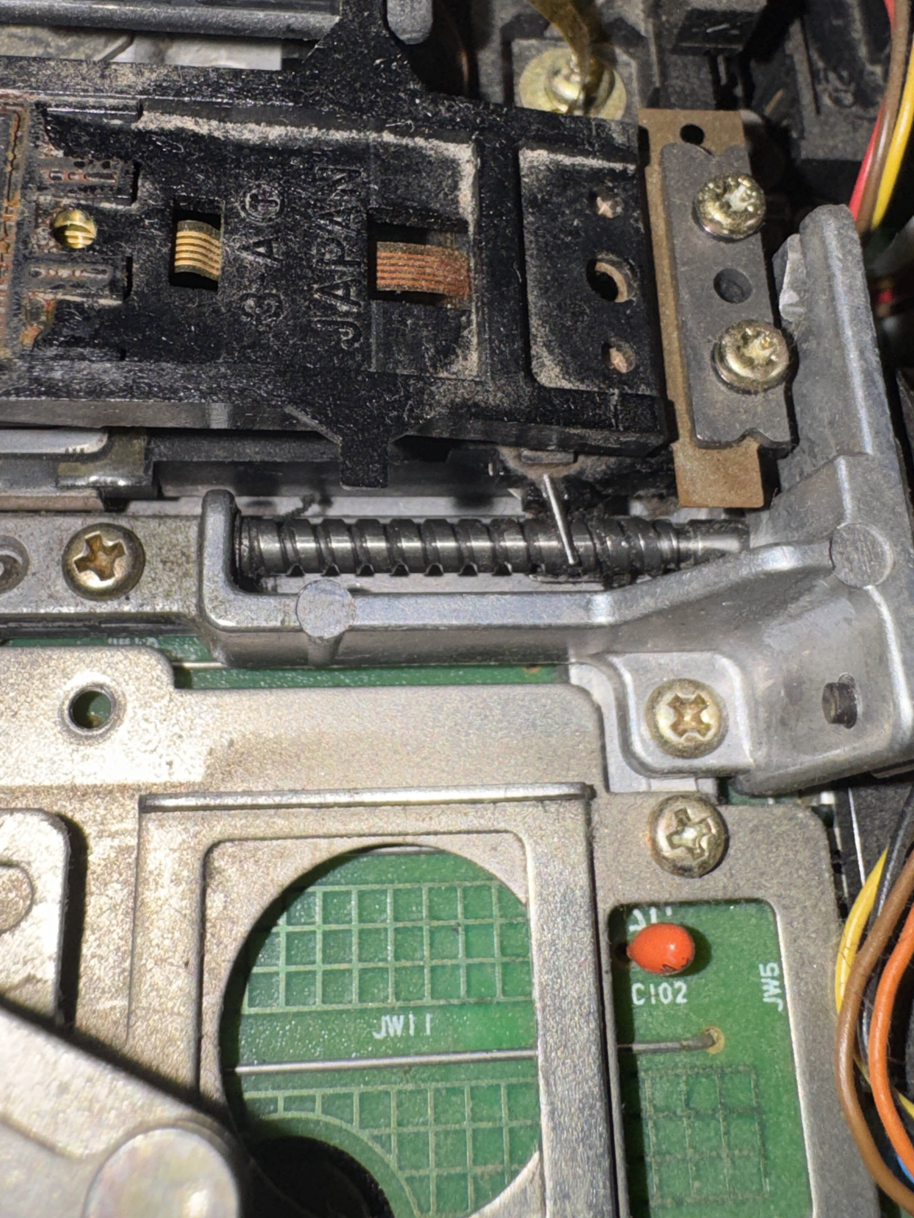

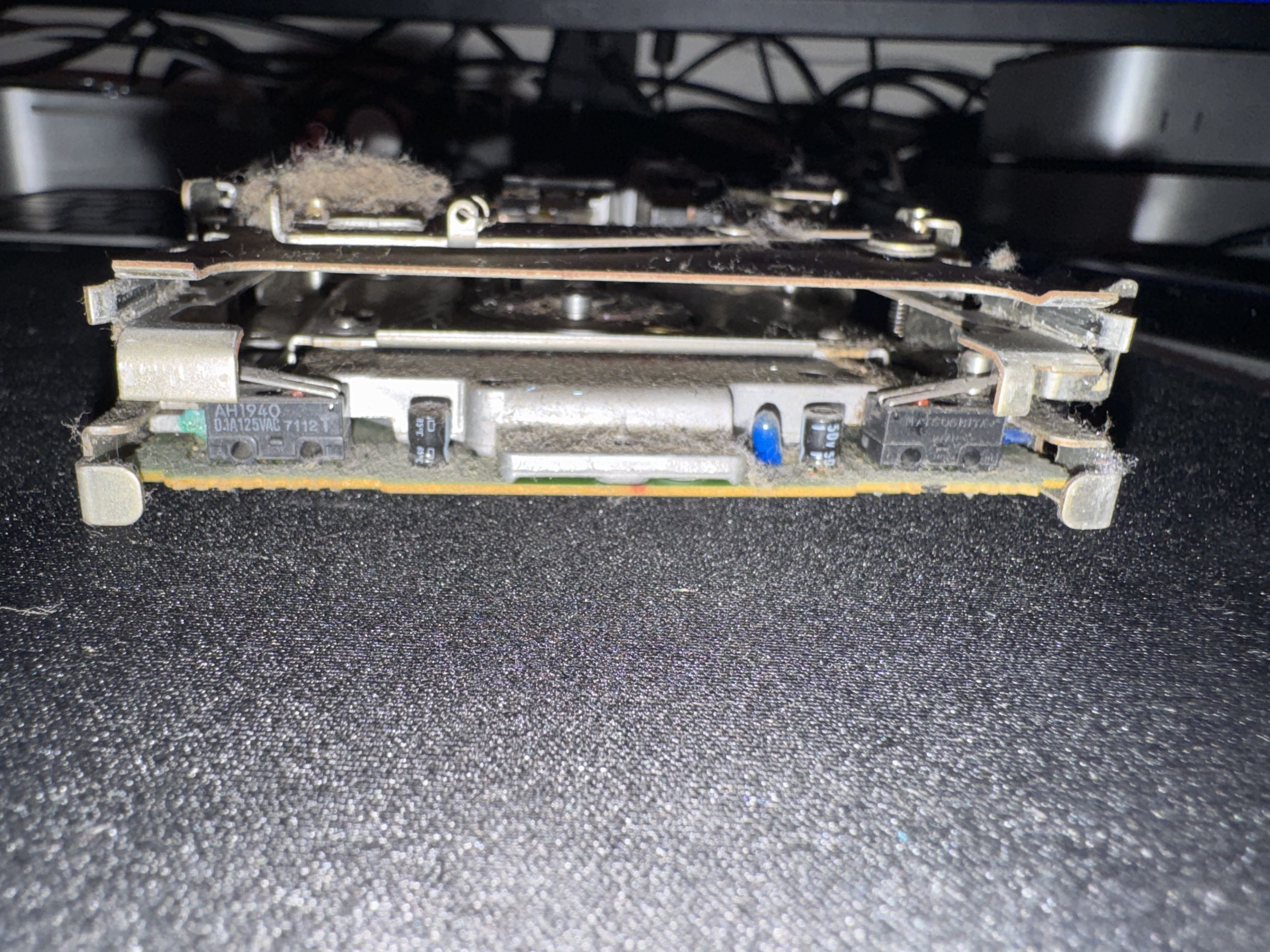

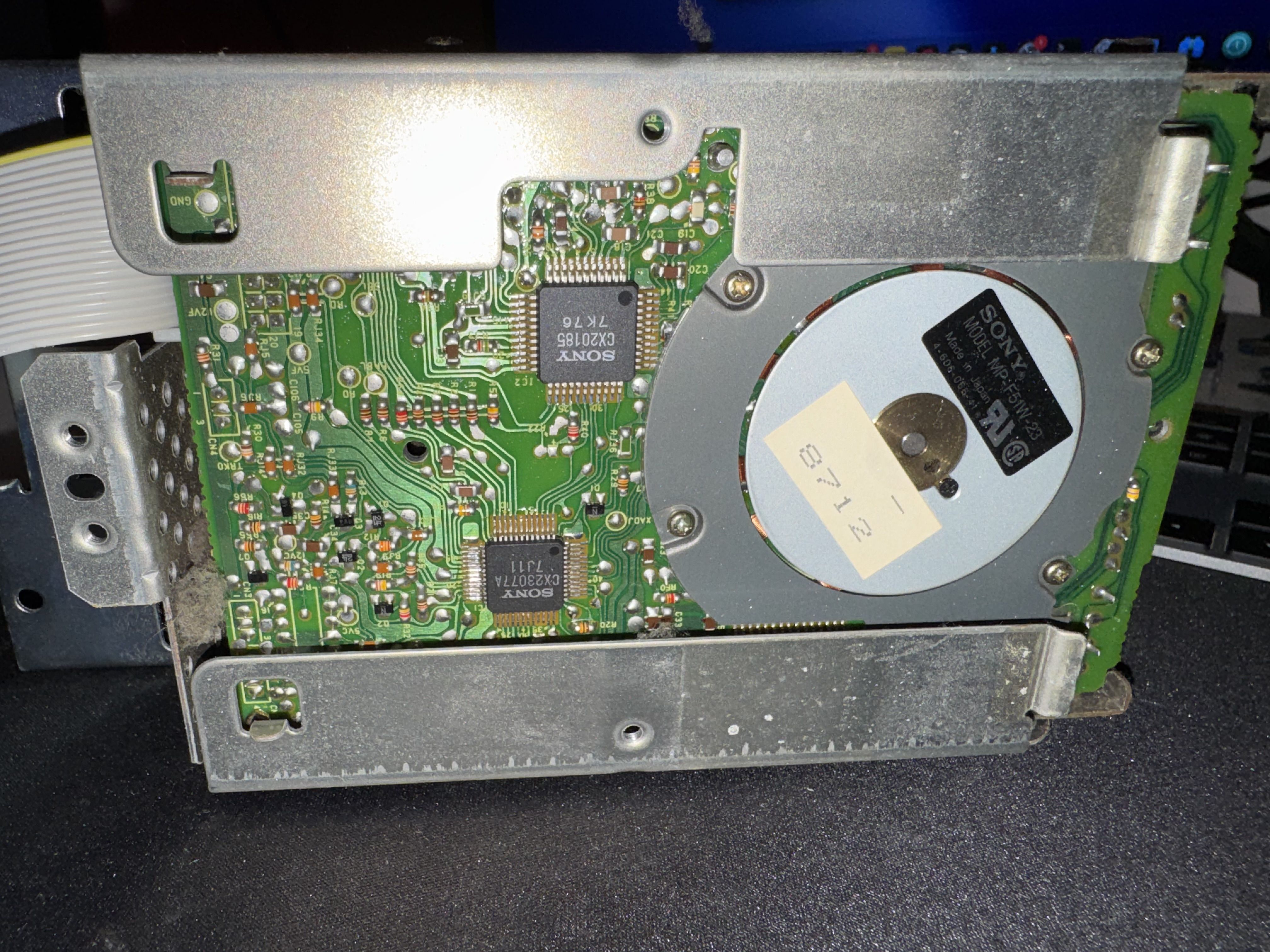

The floppy drive itself and more importantly the eject mechanism work, but it’s still a bit weird. It won’t insert the floppy by itself, so I have to manually put it all the way into the hole myself.
Ejecting also only works a few millimeters, and after I eject a disc, it recognizes an empty „ghost“ floppy.
I disassembled the whole drive and cleaned and lubricated it, so I think I forgot something on assembly. I’m not even sure if I put the 2 springs back in since I removed them a couple of times 🤦‍♂️

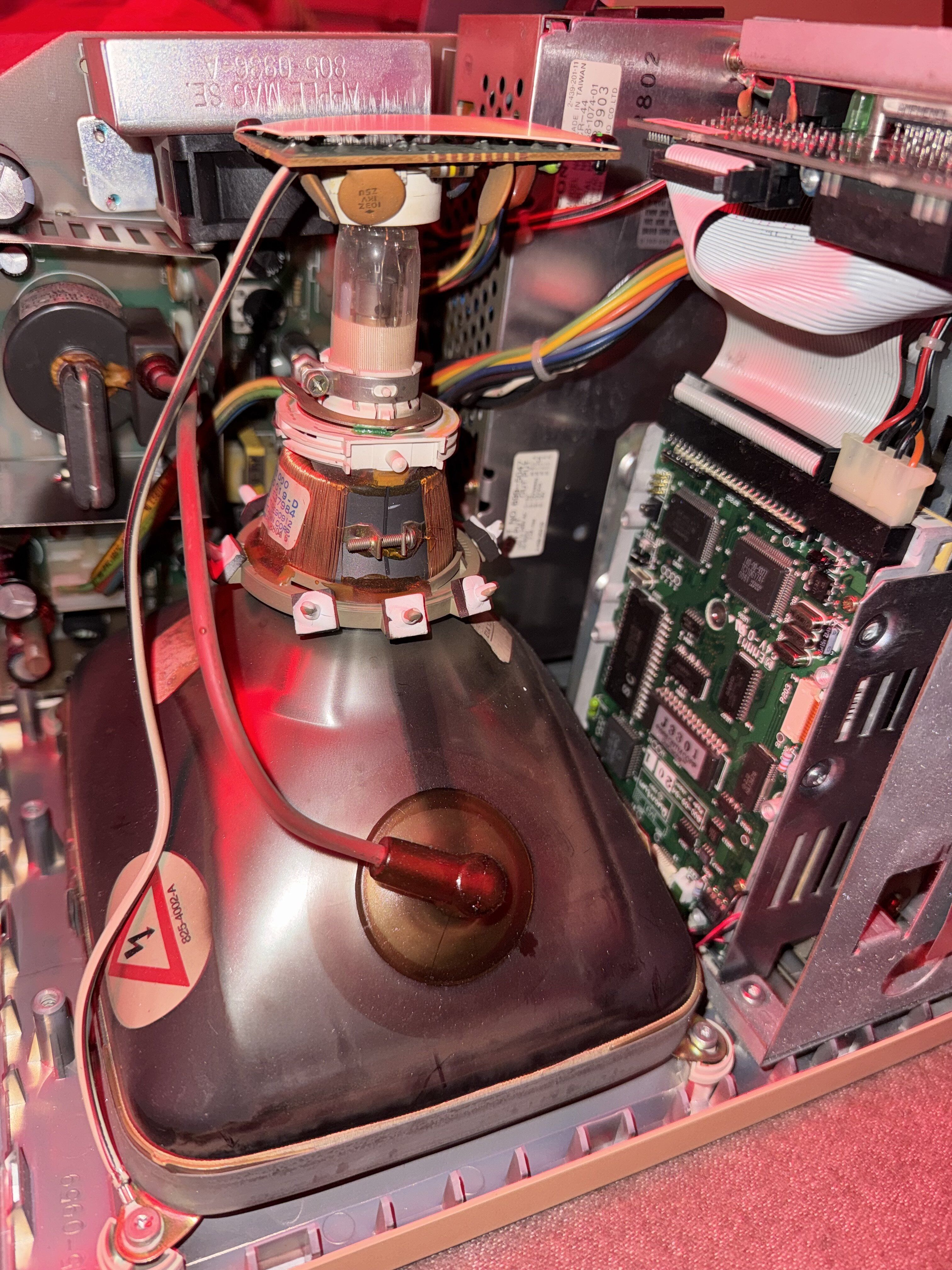

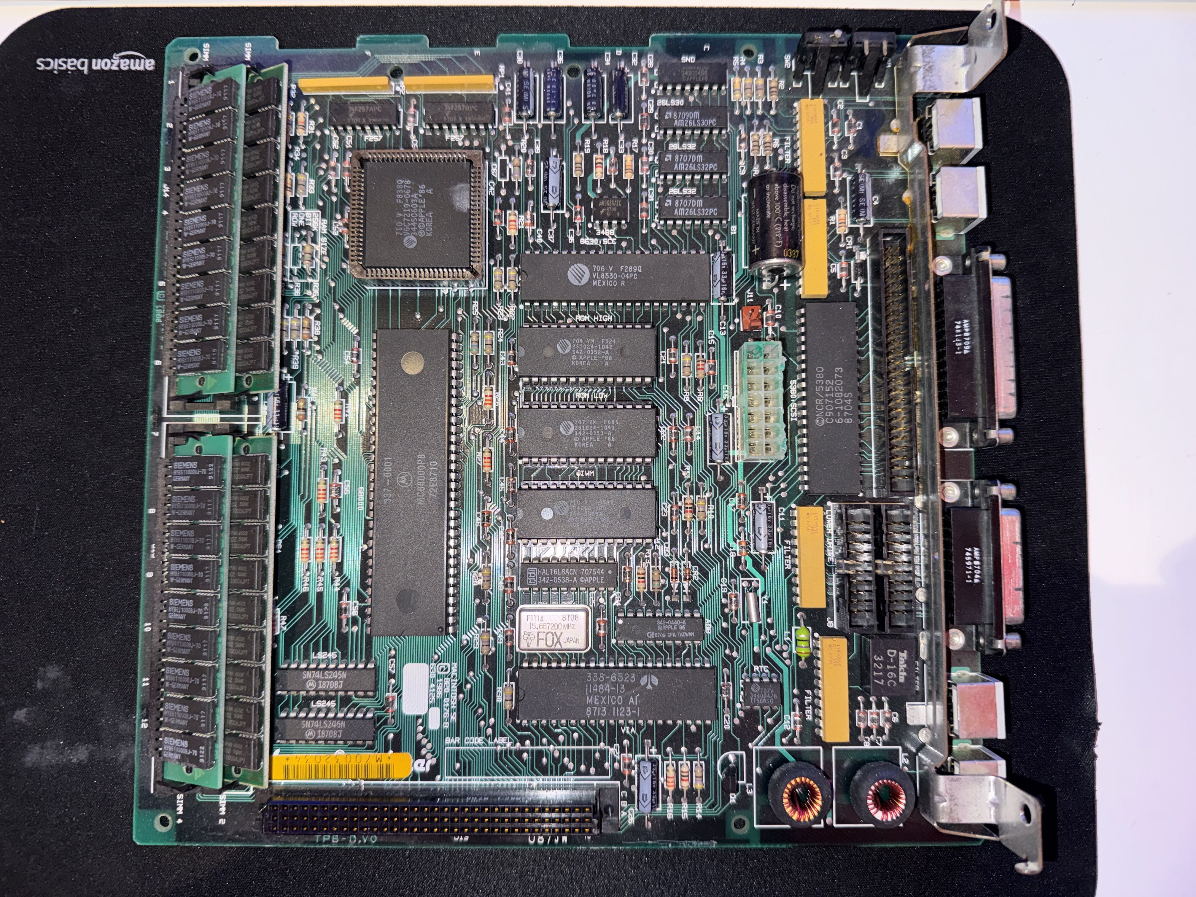

I will disassemble the whole thing again tomorrow and fix things up. Also a tip for anyone who opens this thing for the first time: the thick power cable which goes from the Analog board to the logic board has a clip on the bottom side. I took 30 minutes trying to disconnect it until I saw the clip. That was my dumbest mistake I ever did with a vintage repair. 😅
I’ll add some pictures as well, maybe they’ll help someone else someday as reference.
I forgot to take photos after the final cleaning and lubrication since it got pretty late, but at least I have some in progress shots to show the disassembly and general layout.
