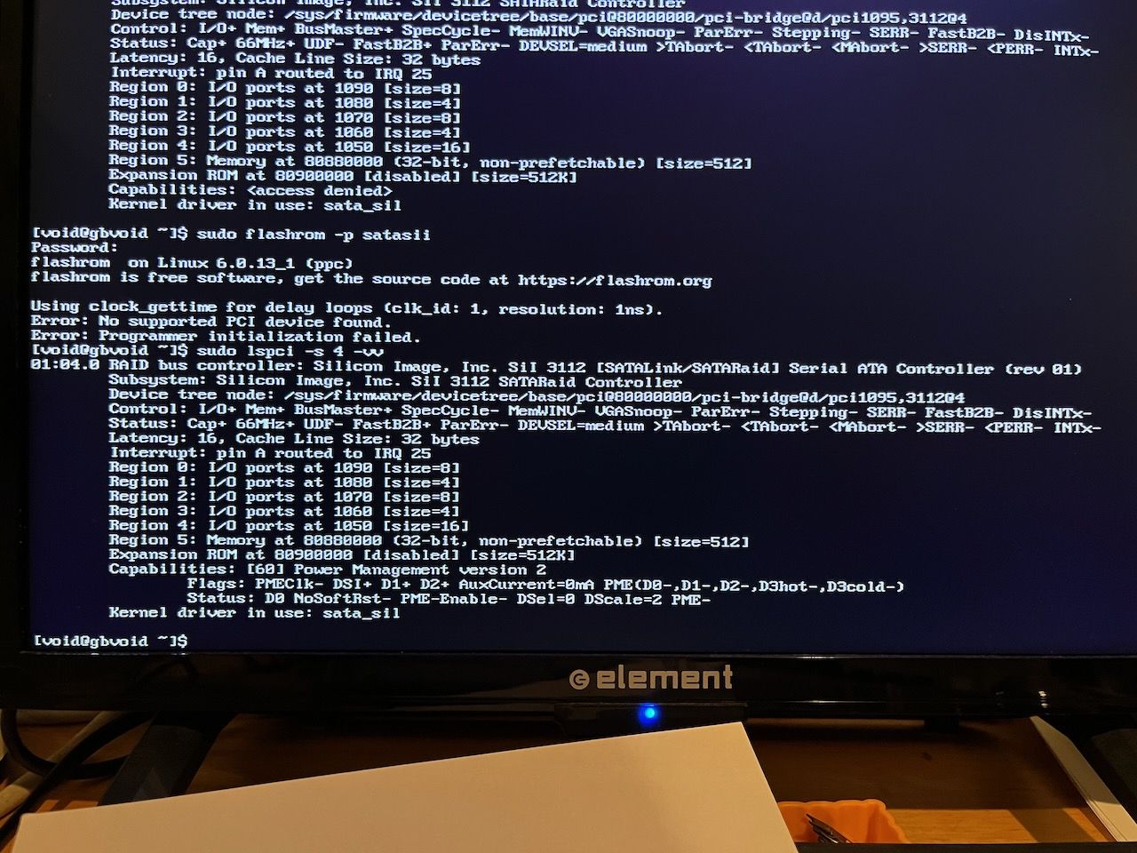

Linux isn't going to fall for those OF shenanigans, OS9 probably will be so try flashing from there. Linux re-probes the PCI bus itself so it's going to pull up the 6112 ID again. I think that 6112 ID is a red herring. The main ID is still 3112, it's the subsystem device ID that's 6112 (aka RAID mode). Flashrom only checks the primary device id so being in RAID mode shouldn't be noticed.
Could be a bug in the satasii flashrom driver in void. A different distro might help but it probably wont. I'll try and get Linux on my G5 and see if I can reproduce your trouble
Thanks for your suggestions. Unfortunately, flasher under OS9 is freezing the computer when clicking “update firmware”. I thought it was the B&W G3 but I just read someone having the same problem with the same card on a beige G3. I will try a Debian Linux on my G5, but I am not very optimistic either. Despite all the efforts of Dosdude1 for changing the chip properties to 3112, it is still recognized as a Raid card and not a Mass storage device…

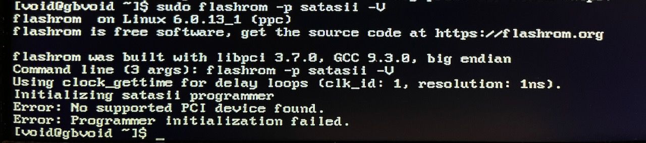

Have you tried running flashrom with the verbose switch (-V, -VV or -VVV) to get more information? It's pretty specific.
yes I did, here is copy as attachment. If you can send yours also and doing sudo, it gives the details of "capabilities" , I will compare them this afternoon, but I have the impression that they are the same.

Unfortunately, as flashrom does not recognized the card, the verbose is just one extra line with the built reference of flashrom

I meant flashrom -VVV -p satasii. My spew is attached.

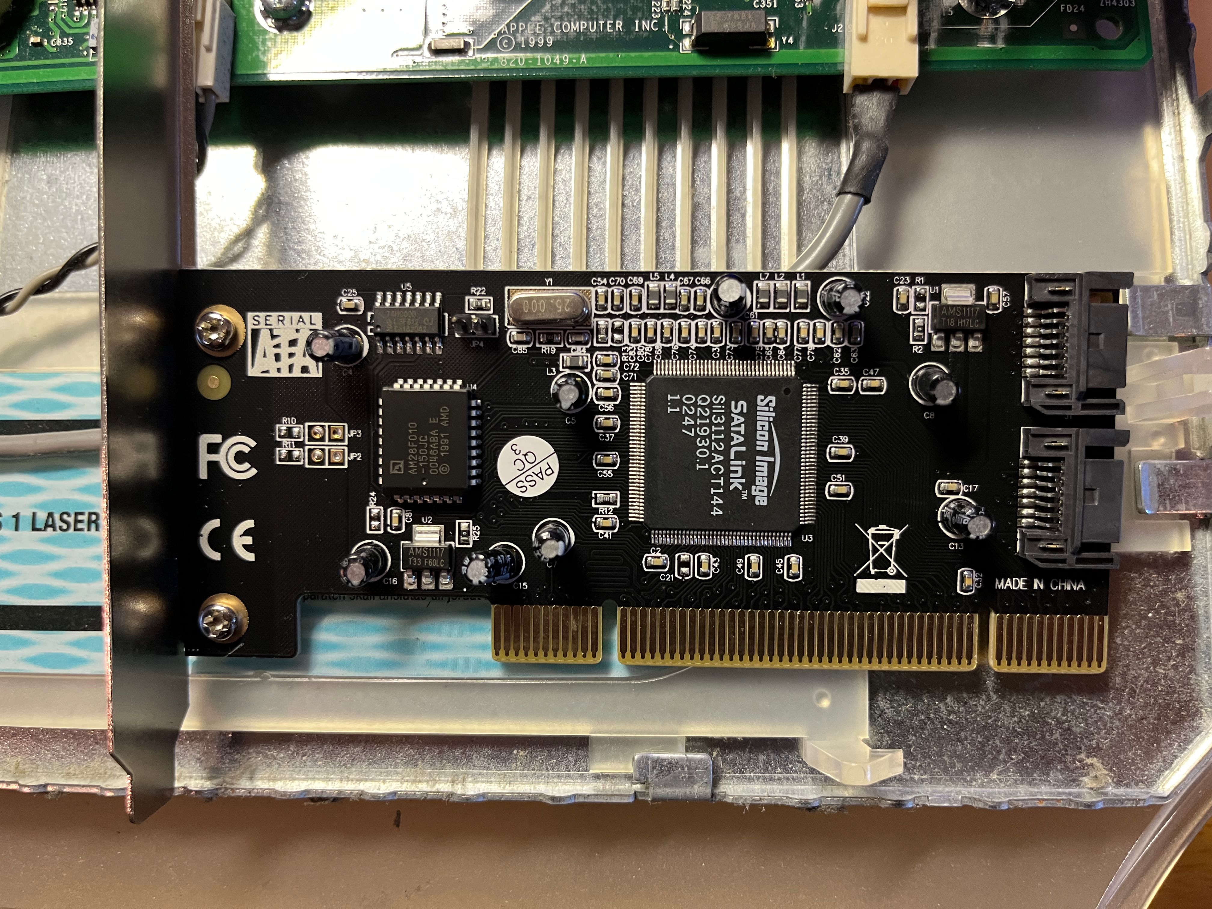

So unfortunately, after a bit more analysis, I found that there is no way the AM28F010 will ever be able to be programmed via Flashrom on the board, as the 12V signals are required in order to perform any commands on the device, such as writing, erasing, or even reading the chip ID. Not only does Flashrom not have any implementation for this, but it would be physically impossible to do, as the card has no 12V source, nor any provision to provide a 12V signal to the EEPROM when sending commands. The ONLY option here is to flash externally, using an EEPROM programmer that supports the chip.
Unfortunately I have to agree with you. I checked my card and if the 12V signal is present on the PCI pin 2, the card does not have any connection with that pin. Waiting for the AM29F010 to replace the AM28F010, another challenge to replace a 32 pins chip, my first attempt! Attached pictures of the card so that you do not buy it!

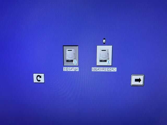

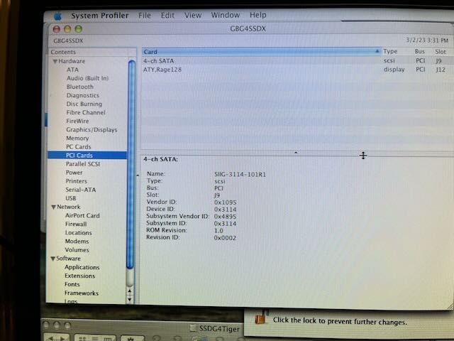

OK, found the way to get the binary file in HEX mode (xxd), content looks indeed OK.
So I used your 3114 flash file, worked like a charm!
Been able to startup G5 and G3 computers with only one SSD connected to the PCI to SATA card.
