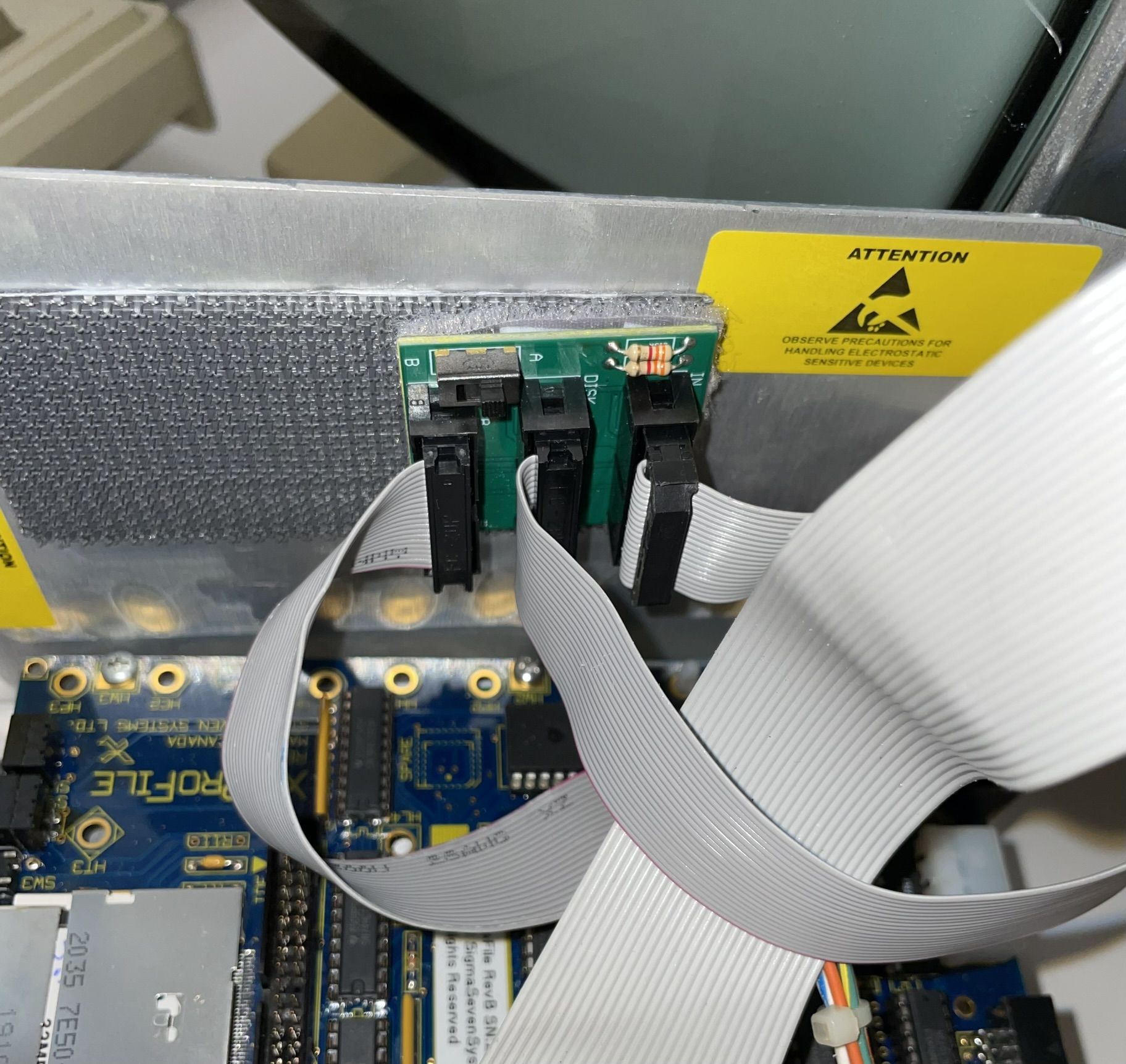

I have a BMOW Floppy A/B switch velcro-ed into the drive cage:

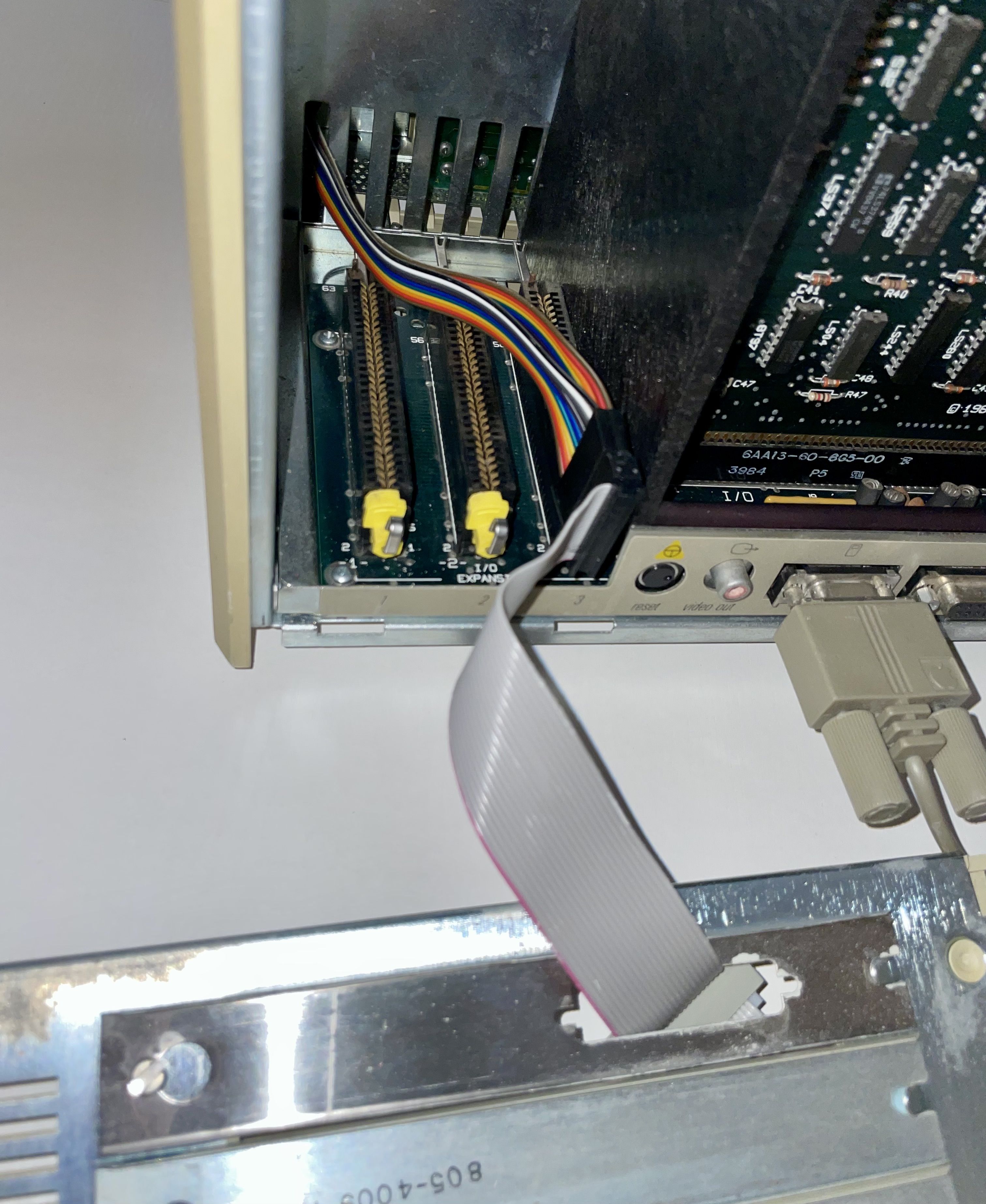

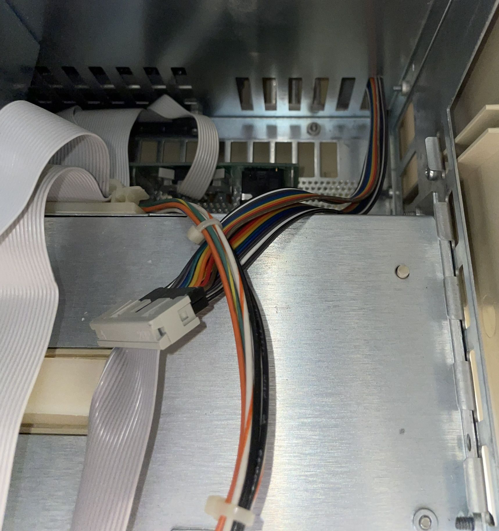

One output goes to the internal floppy, and the other is routed to the expansion card area via the air vents under the drive cage. I (very carefully) used some jumper wires so things would actually fit through the hole:

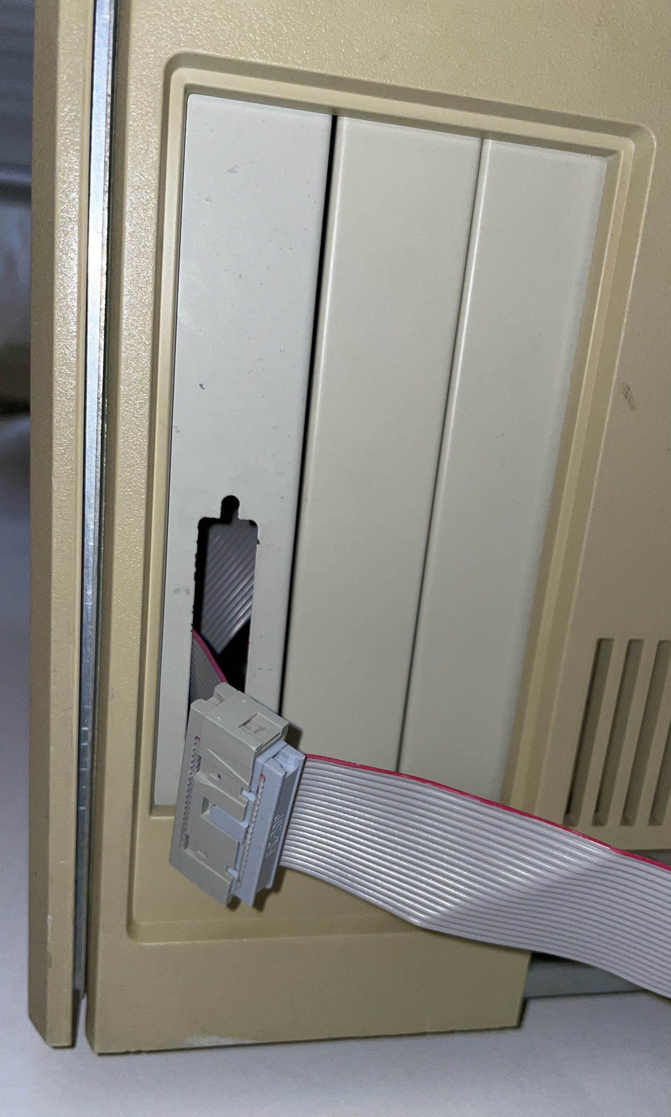

The cabling then continues out the back through an expansion card slot with a port hole:
The exact cables are a 20-pin IDC F/M cable, then 20 12" F/M jumper wires, then another 20-pin F/M. At that point you're all set. You can plug the Femu into the back with its included ribbon cable:
Now you can route things around the machine however you'd like. Swapping between the built-in drive and the floppy emu involves powering off the Lisa, removing the front panel, and flipping the switch. You already have do this to change the settings on an X/Profile adapter anyway, so from a usability perspective I'd say this is fine.
