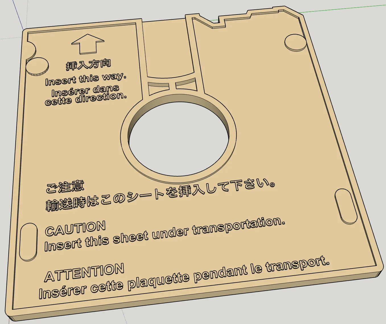

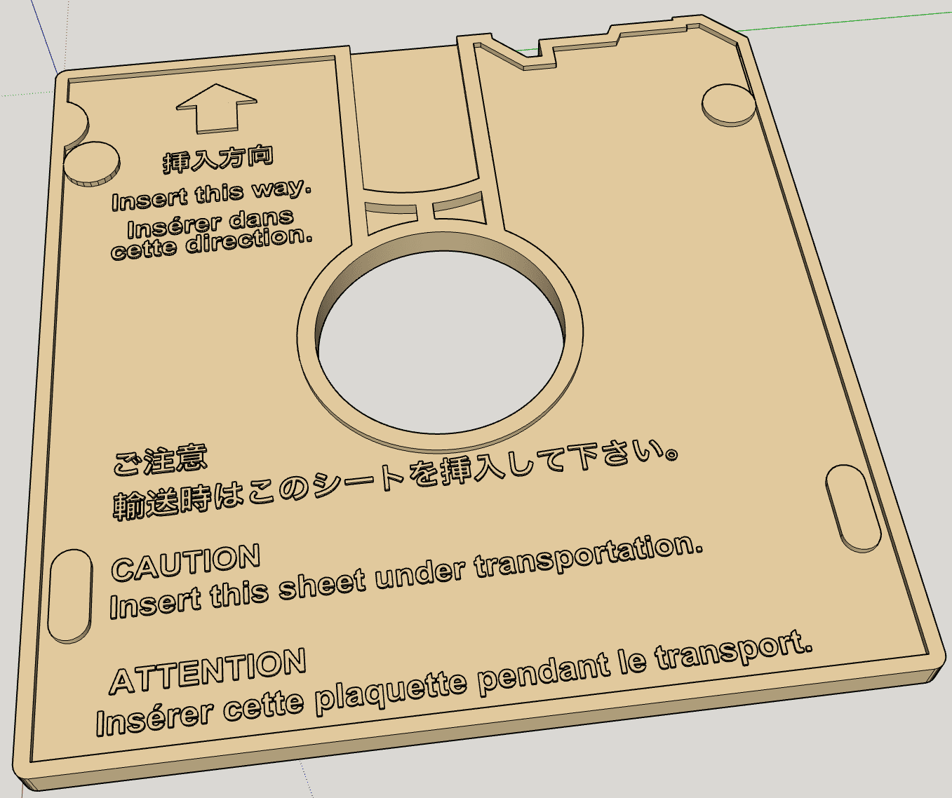

I decided to recreate this Apple Floppy Transit Protector to be more accurate for the restorations works.
Do you have some original? I've found only two pictures, based on them I do my design.
((Native Japan speakers, could you please check the text?))
This is one of my source: Transit Protector

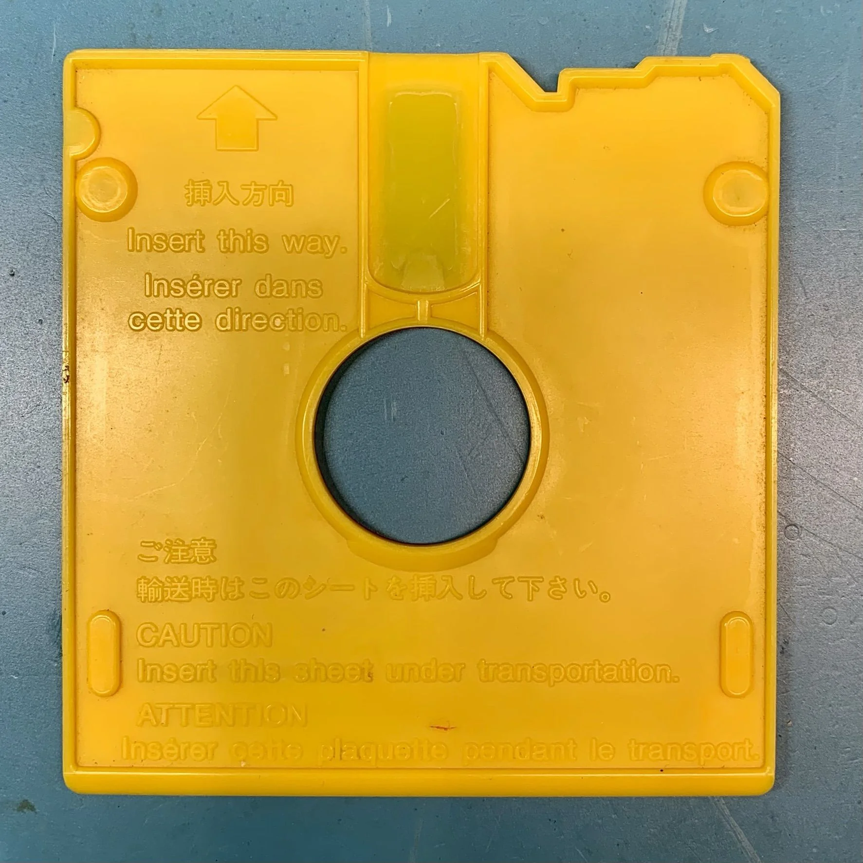

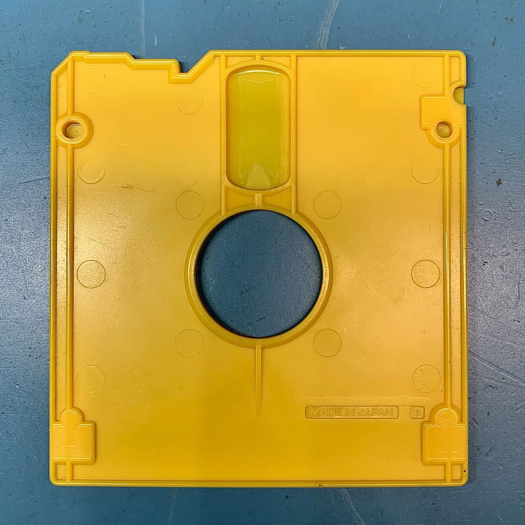

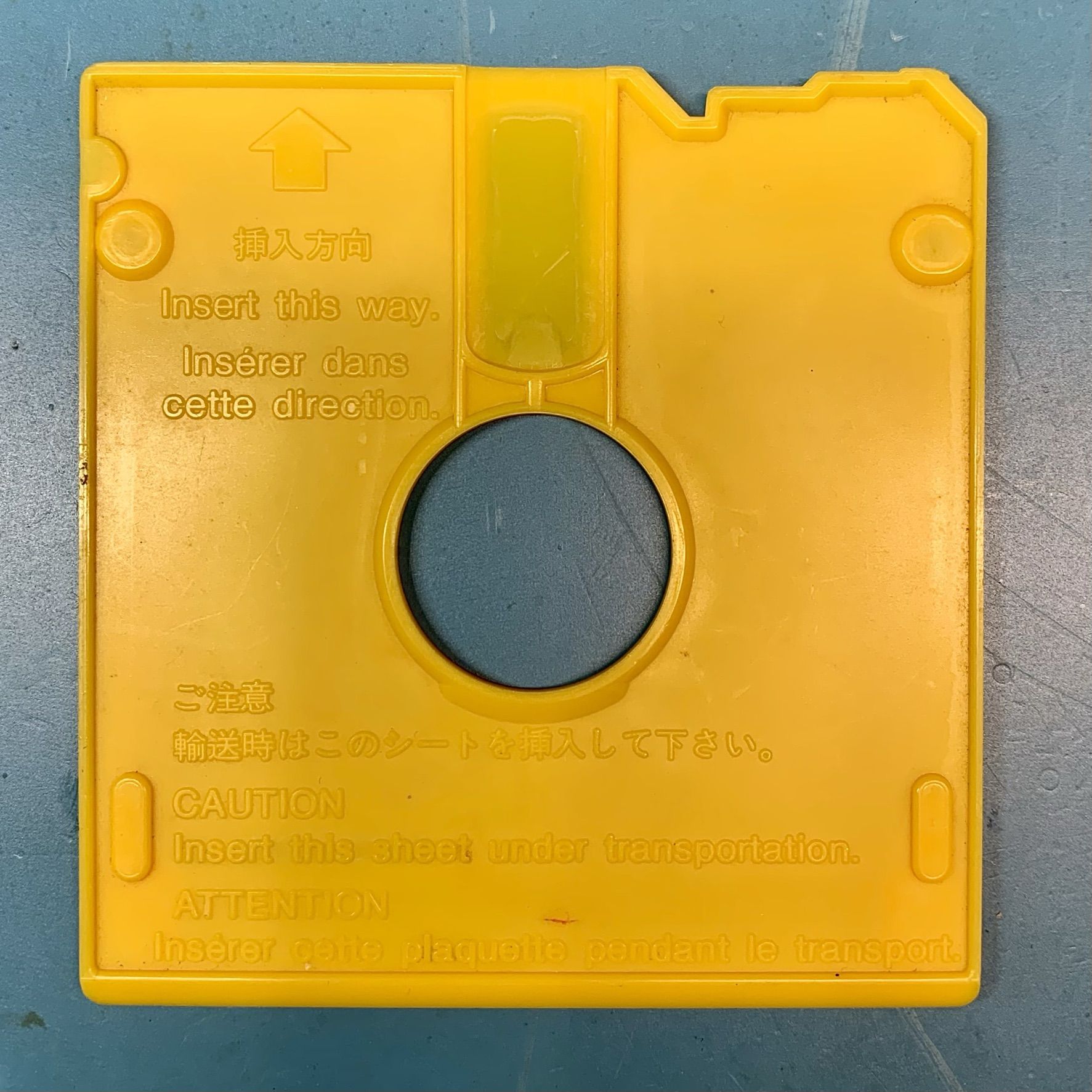

I have a couple. Do you want pictures, or do you want an original, preferably on loan?
Thank you.
I have one good resolution photo about both sides but if you could do HiRes photos from exact 90 degree about both sides that would help a lot. Also would be great to have it in my hands to feel the material, the flexibility, but I'm in Germany - don't risk it with postage.

I am still working on it, the back side is not ready yet. It is a low prio project, made in SketchUp Free.
((( I don't like Fusion 360, it is "too much" for me. )))

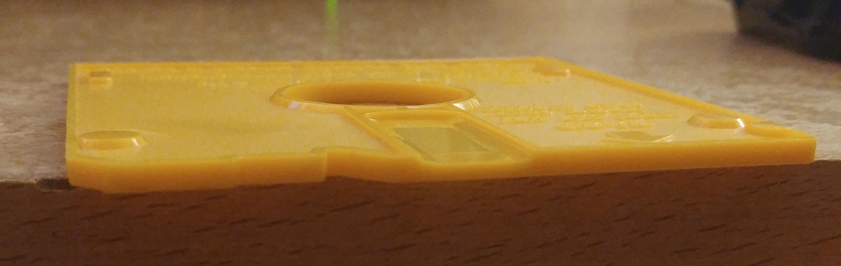

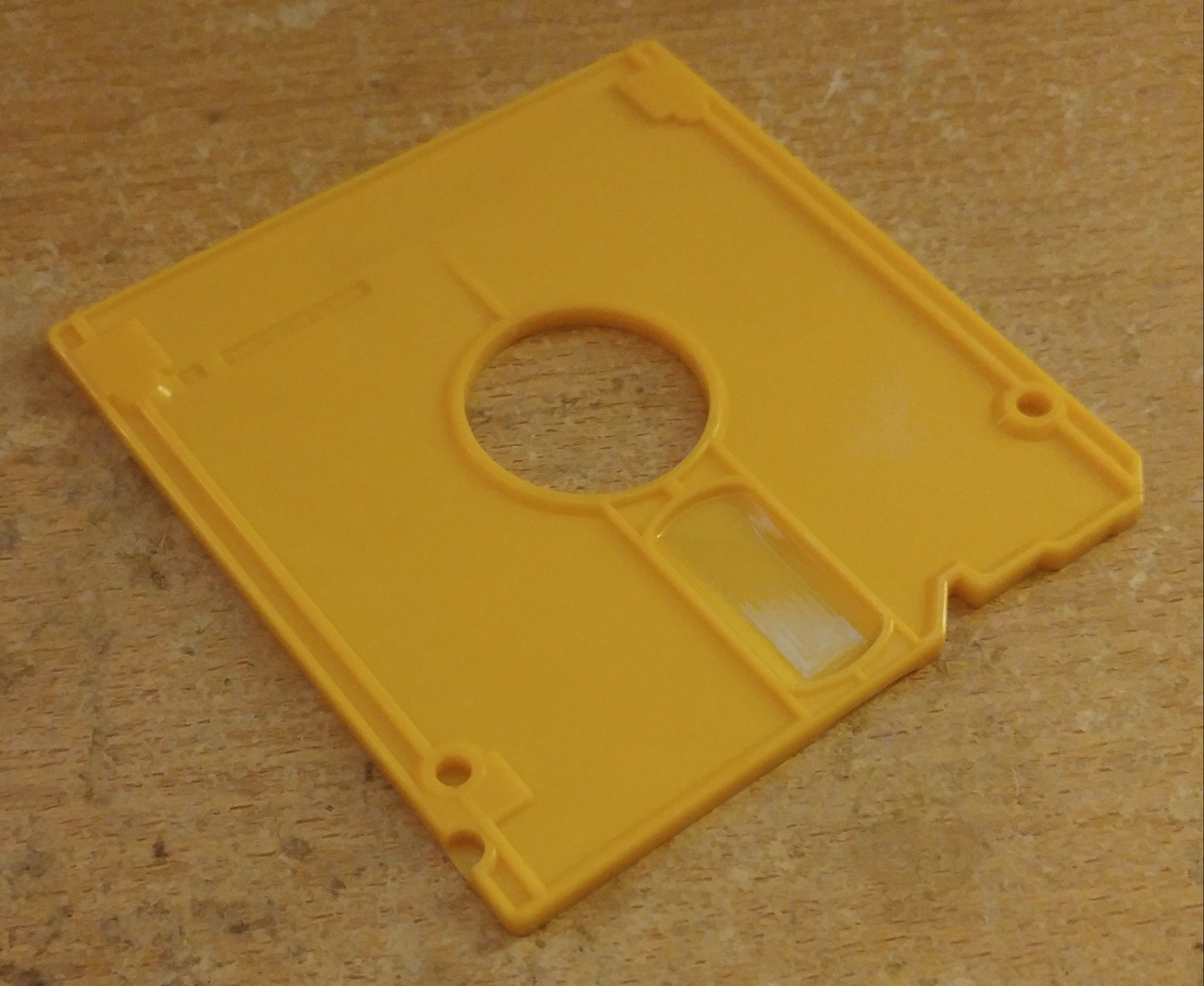

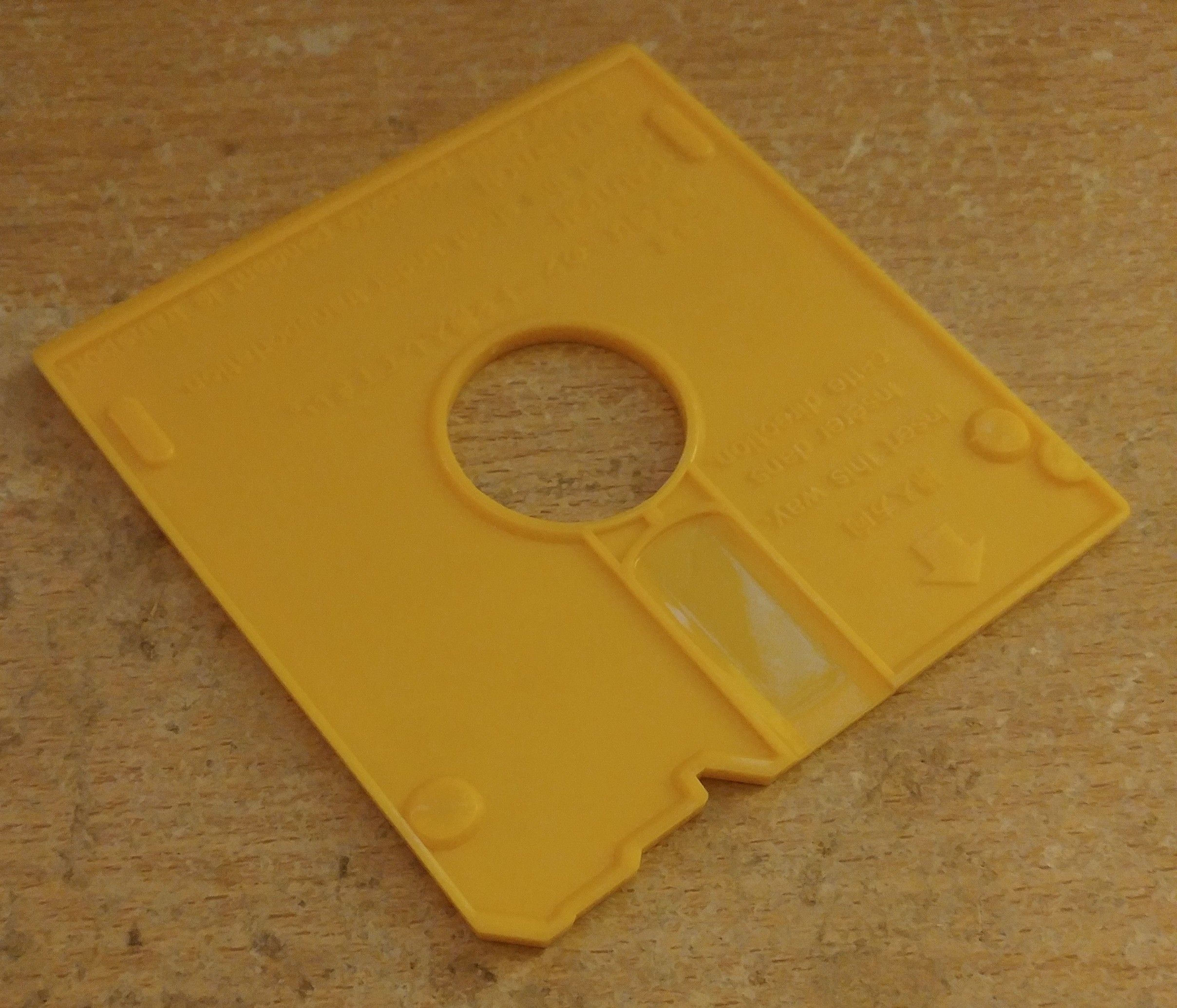

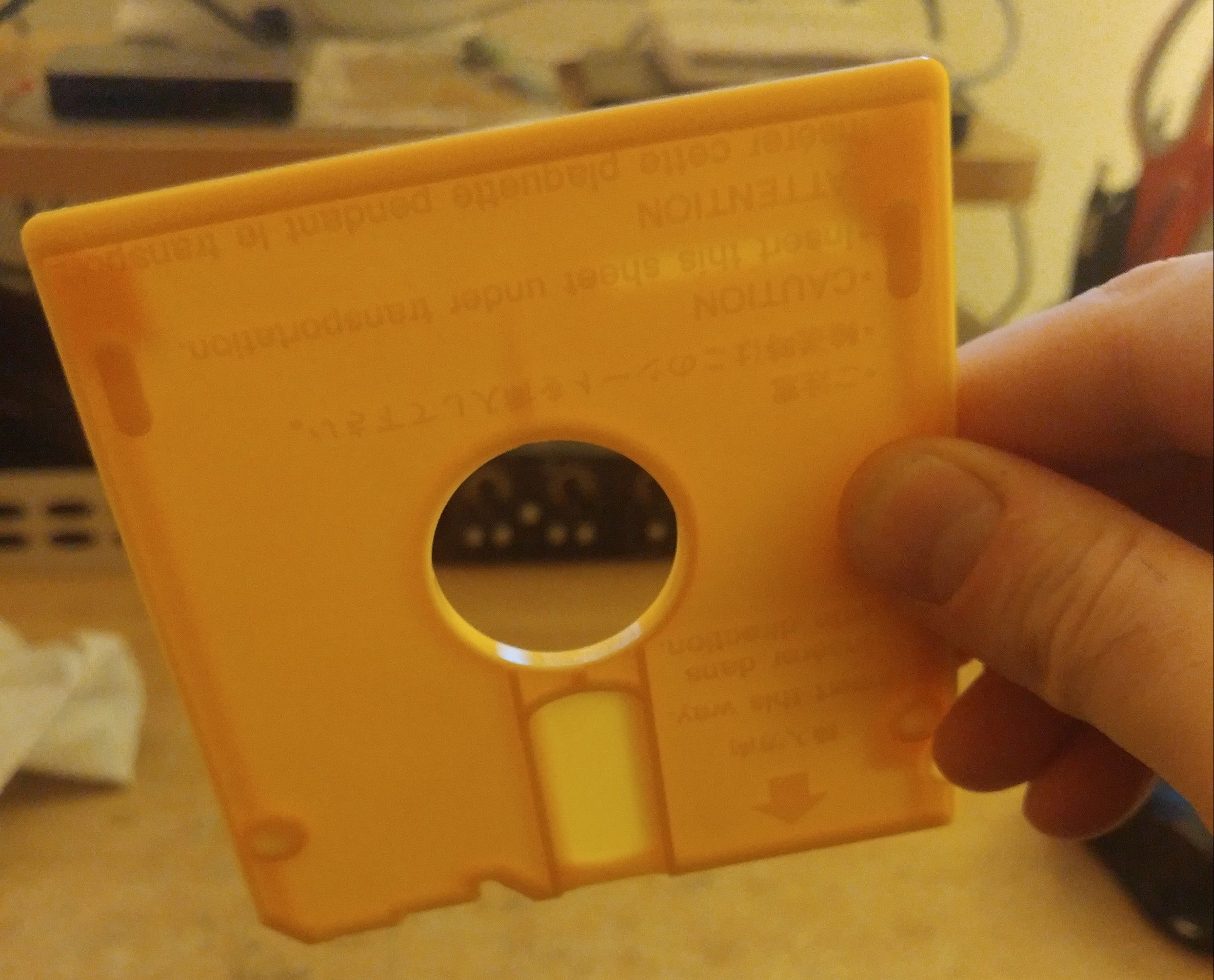

Unfortunately I don't have calipers to measure, and there's a rim blocking the edge, but here are some pics to compare. The head area is noticeably thinner, being more translucent than the rest of the plastic.

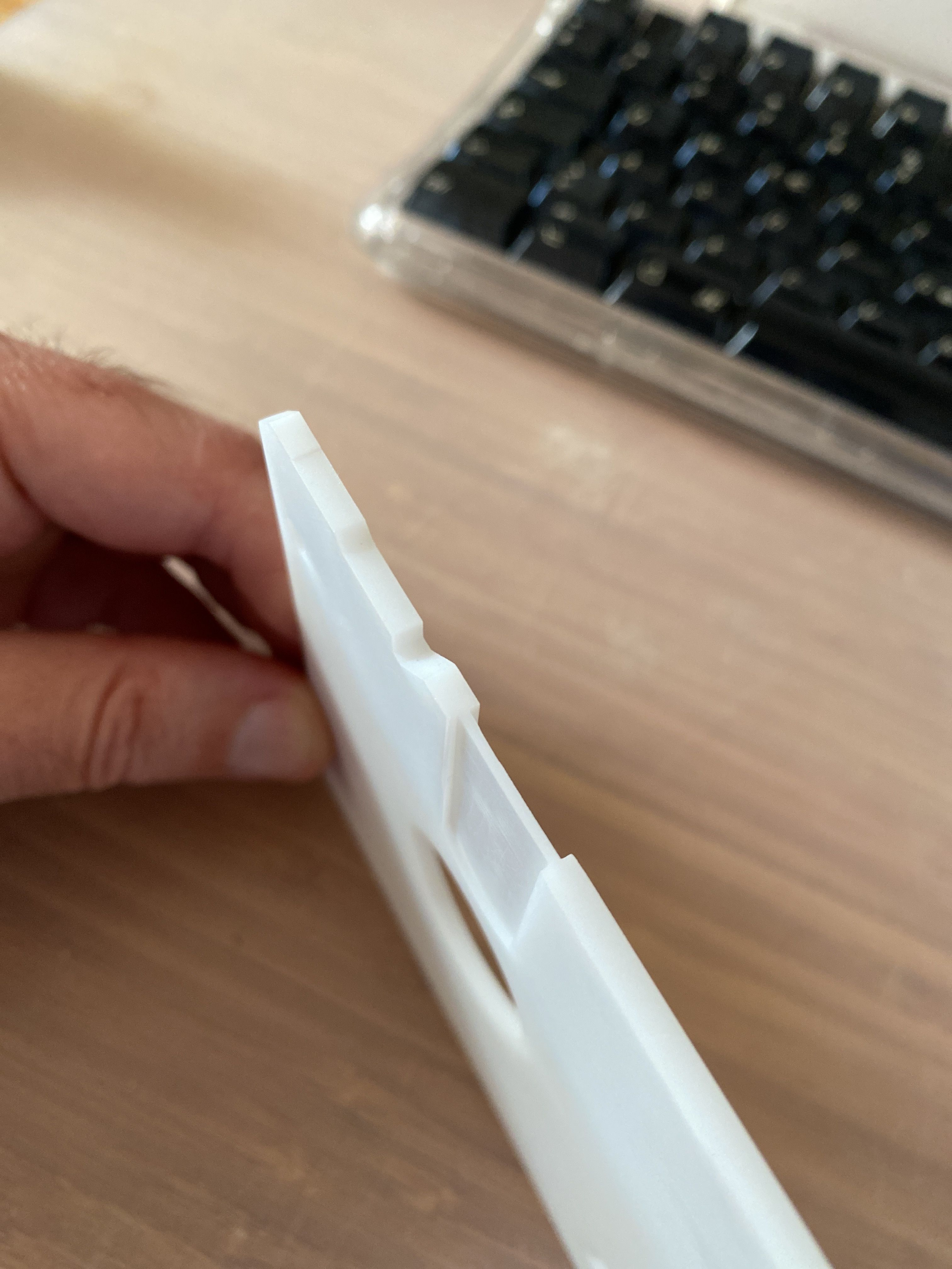

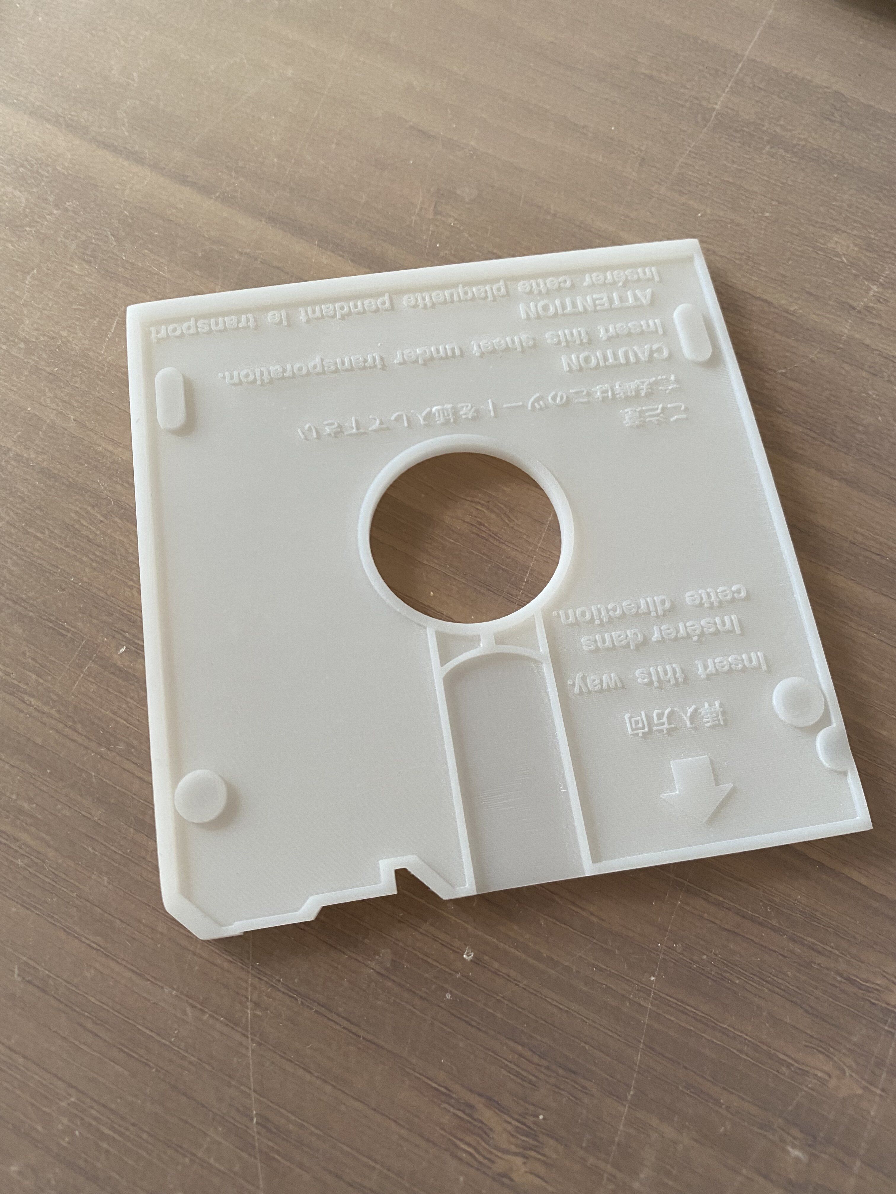

I finally got printed that model O mentioned above.
View attachment 5129View attachment 5130
It seems quite nice, but maybe the zone for the heads is too thick.
How thick is the head contact zone in the original?
Very cool!
Based on the pictures what we've got from @RetroViator and @lilliputian it is "much thinner" but that goes between the read/write heads. if it is less than a millimeter than it is ok.
When you eject a disk from the drive, the upper head moves away from the lower head approx 3mm.
I think if the head area is less than one mm, than it will bo OK for the heads and possible to 3D print too.

My main goal is to use this to store older Macs in a way that the metal plate that holds the upper head is not in tension, as I heard in long term this causes deformation and read/write errors.
In the model I used (it's not mine, I linked it in my post of November 15th) this area is about 1mm thick. I hope that's OK. I'm just worried that the surface finish is not too smooth, and it could scratch the heads if I forget to remove when powering on. To improve this I added kapton tape... I hope this trick doesn't backfire.
