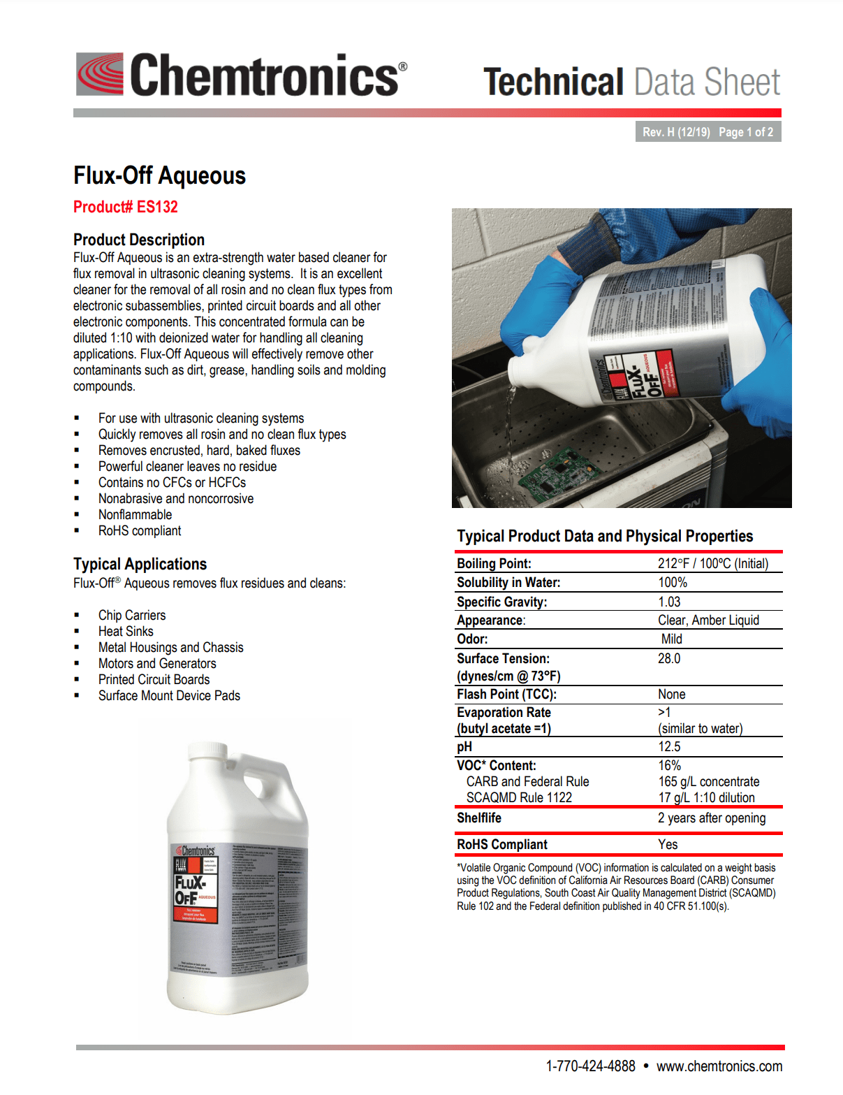

Looks like I misremembered what I bought - here is the TDS for what I have:

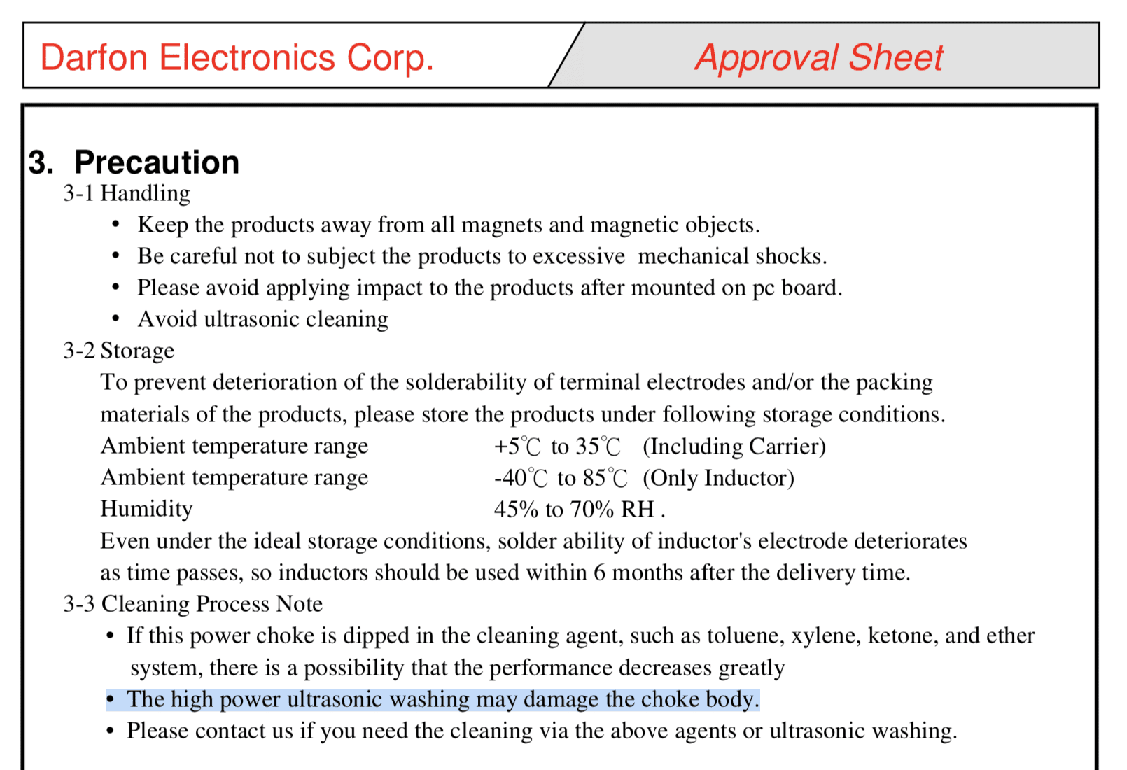

While reviewing the datasheet of a coupled-inductor for one of my switch-mode power supply designs today, I noted the following warning...
Of course, I have known about these warnings on other ferrite core components, but it only dawned on me today that many people in the vintage Mac community use Ultrasonic cleaners without thinking too much about what it is they are cleaning. I doubt any of you check data sheets on components before cleaning your vintage boards.
I myself have never used an ultrasonic cleaner. I therefore am curious if any of you like @Branchus have ever damaged components accidentally in your own ultrasonic cleaning experience?
(I am not chastising anyone, nor am I suggesting people not use ultrasonic cleaners. I am just curious about the experiences of you who do use them.)
Yes, I've broken the leads off SMD caps by cleaning for too long.
I'll clean logic boards in the ultrasonic, but not PSUs or analog boards, due to the pots and inductors.
Reactions: Patrick and JDW
