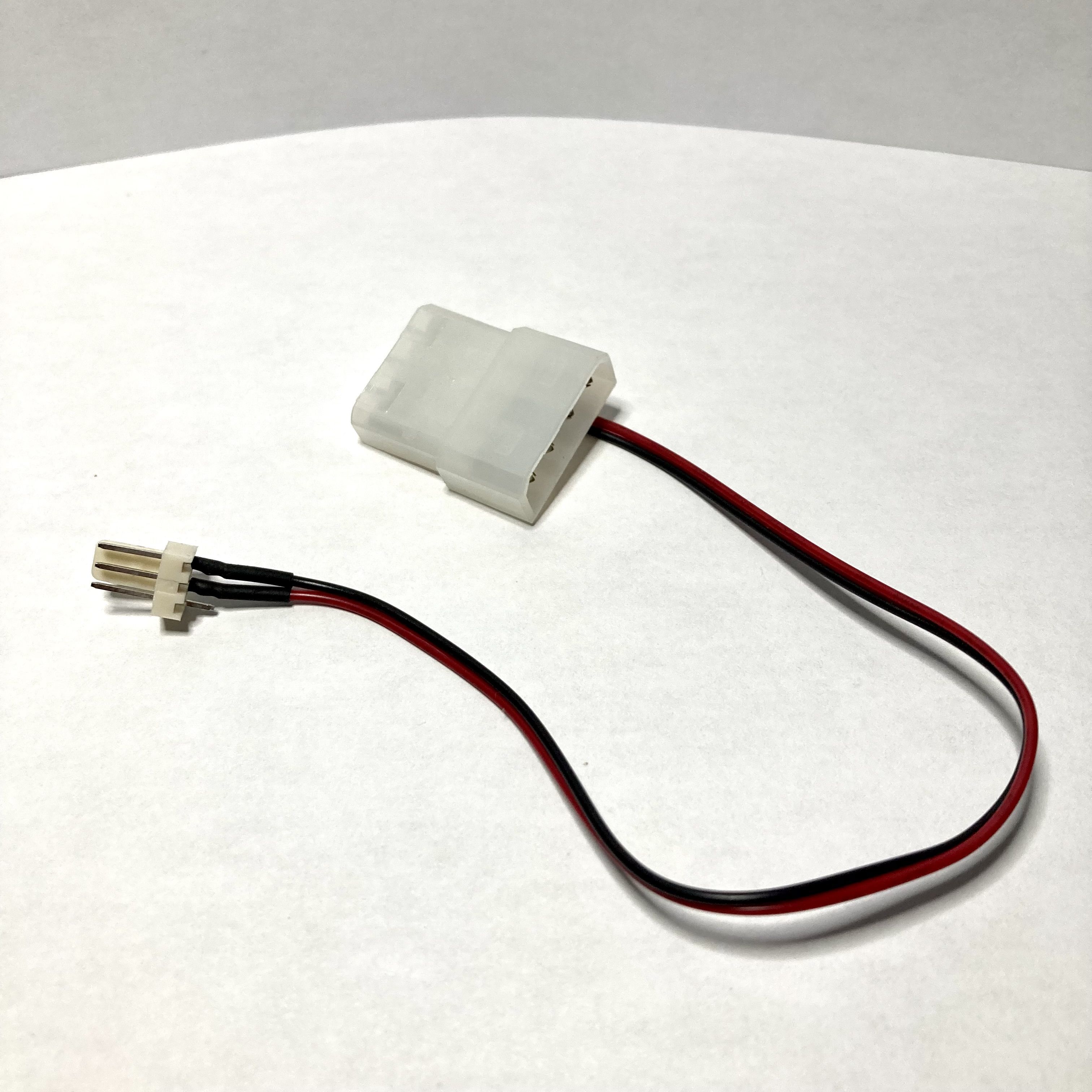

Yes, if there is room and venting at another location, by all means. You can use this adapter to power the second fan. The thing is, the load on the PSU you may want to consider. Also, ensure the second fan is blowing in the right direction. It usually has air running from the front, front bottom, or the sides to the back, depending on the case. If you were to add a second fan blowing in another direction out, then it might not be as efficient.
I'm not too worried about that since I'm no longer powering a hard drive. I checked the voltages under the current load with the PC running and they're all still at spec. Another low amperage 12v fan shouldn't be a problem.

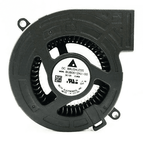

There is another type of fan for high flow:

I saw someone over on 68kmla use a blower style fan like that over the intake vents to direct fresh air towards the CPUs...wonder if that would make a noticeable difference. Smaller fan will be louder though, and any air pulled in from that spot by a traditional fan would have nowhere to go but towards the CPUs anyways...

I'm sure it won't at 5 or 7 volts.
Ya, I suppose I could try running it off the 5V line and see if it's effective...should be about 1W that way if my math is right. Startup voltage is 7V though. I'll figure something out...
