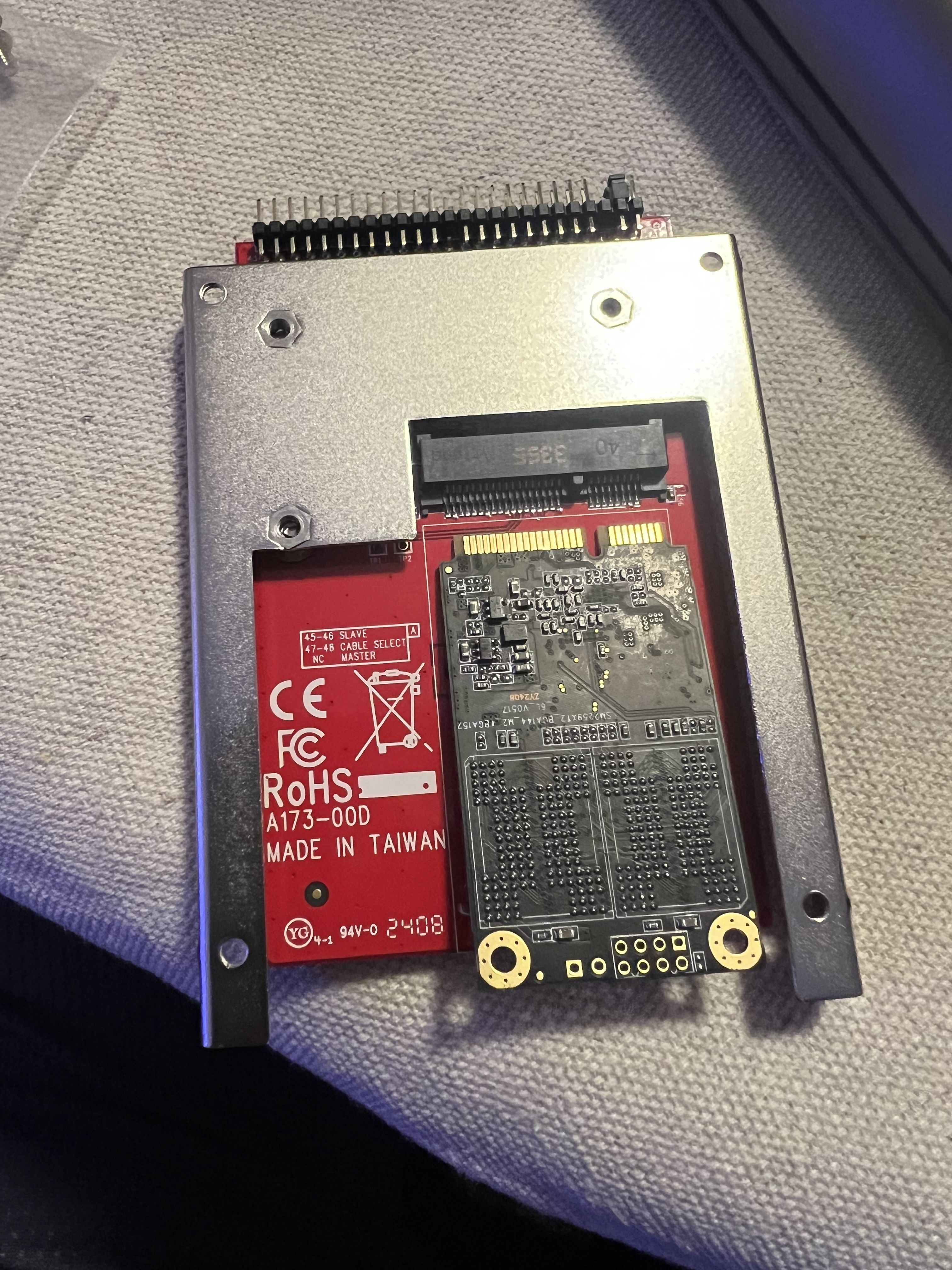

For anyone continuing to work on TAMs I recently did an upgrade with an IDE to SSD adapter and a 128 GB SSD. I bought the parts on amazon. I took out the IDE drive, used an IDE to USB adapter to connect the drive to a G4 mac mini running 10.4 Server and OS 9, (the mini itself using an SSD card). The Mini server share makes file and driver copying, imaging, reformatting etc easier since it has classic (Mac OS 9) running.

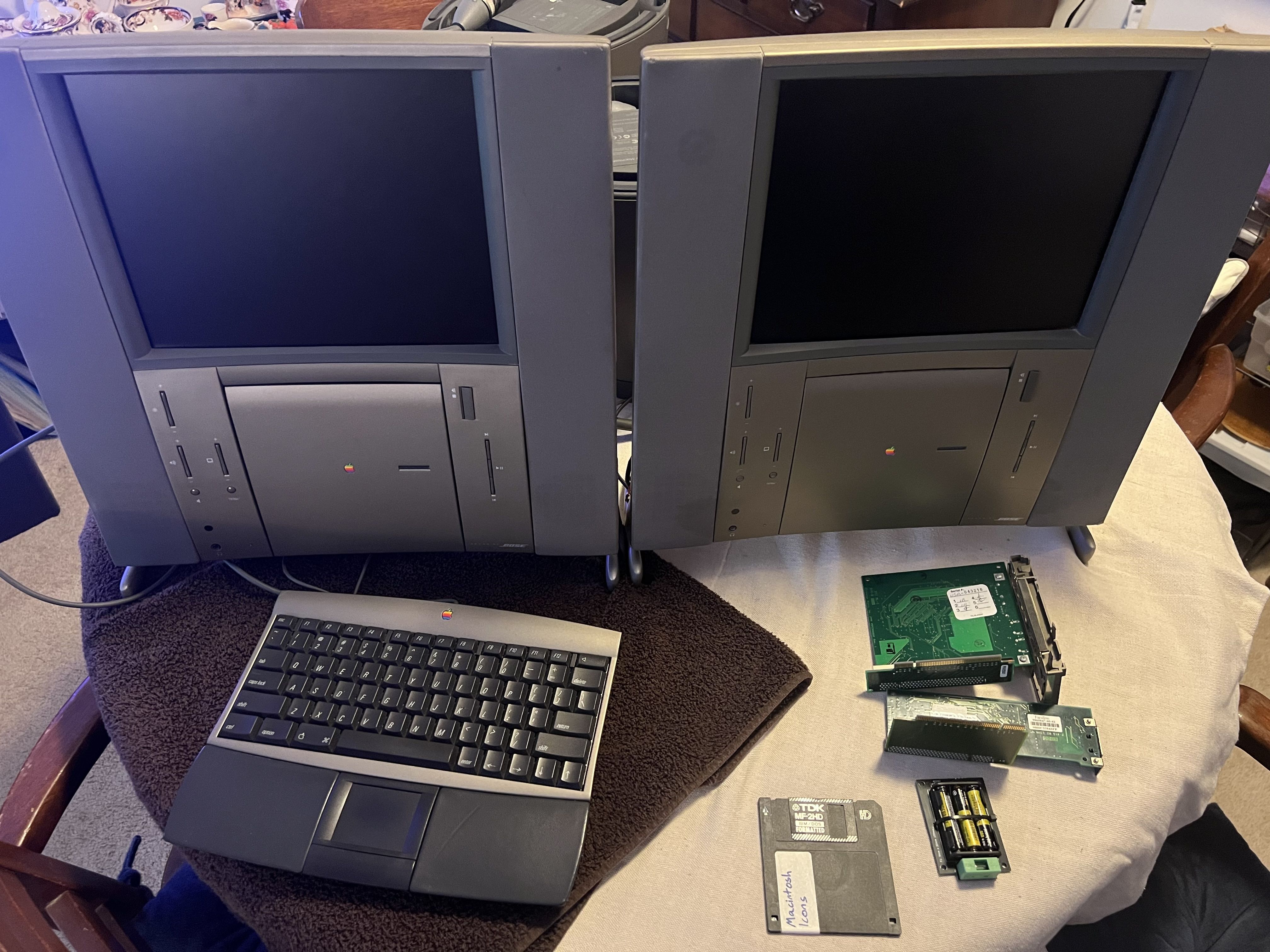

Recently I had an old and very dear friend meet up with me for lunch, He brought along his old TAM, another TAM stock, and one still in the box. I already have one from '97 I bought new for my first "I bought it new" Macintosh.

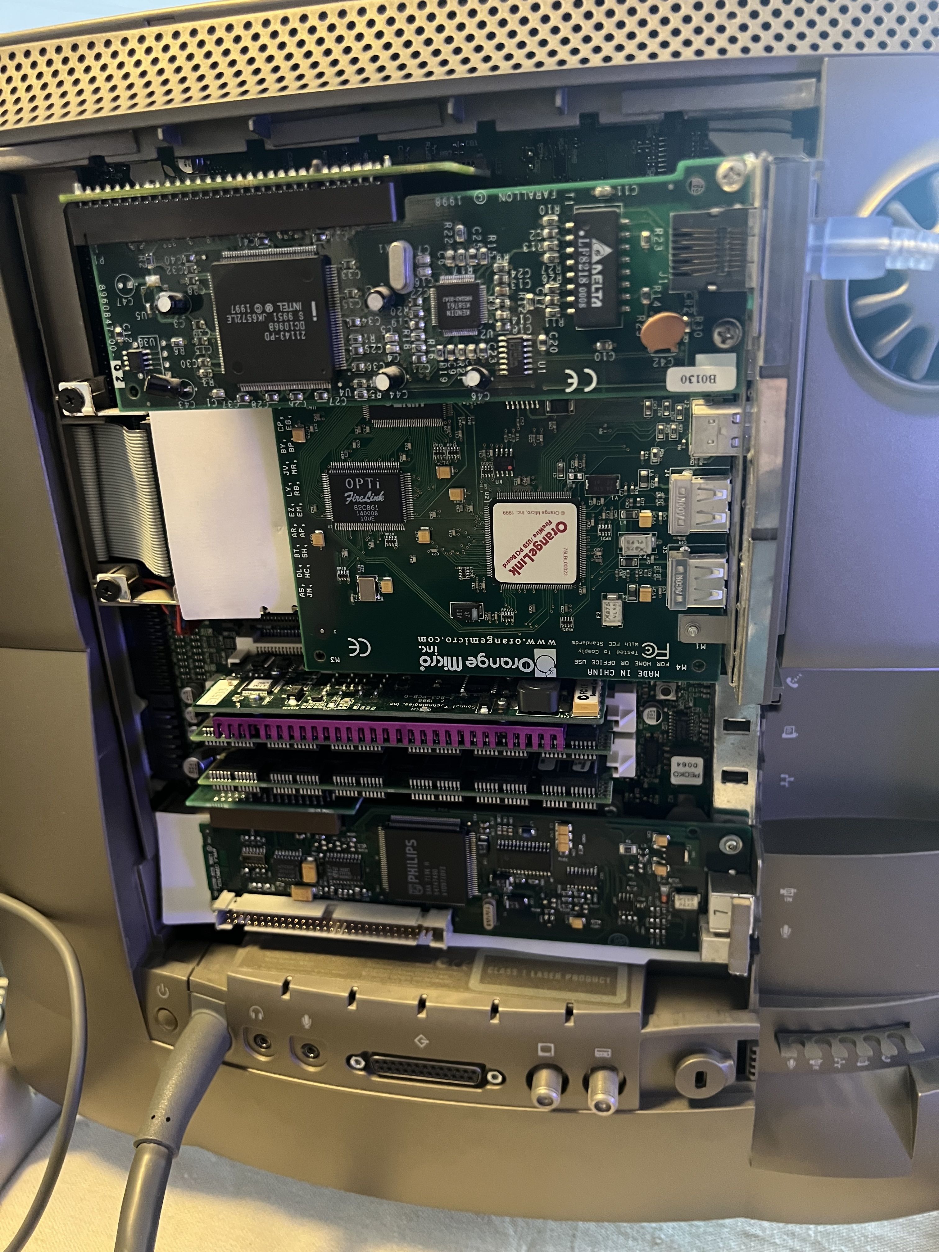

My friend's TAM is tricked out; max RAM, Farallon ethernet card, Orangemicro FW/USB upgrade card and a Crescendo G3 upgrade in the cache card slot.

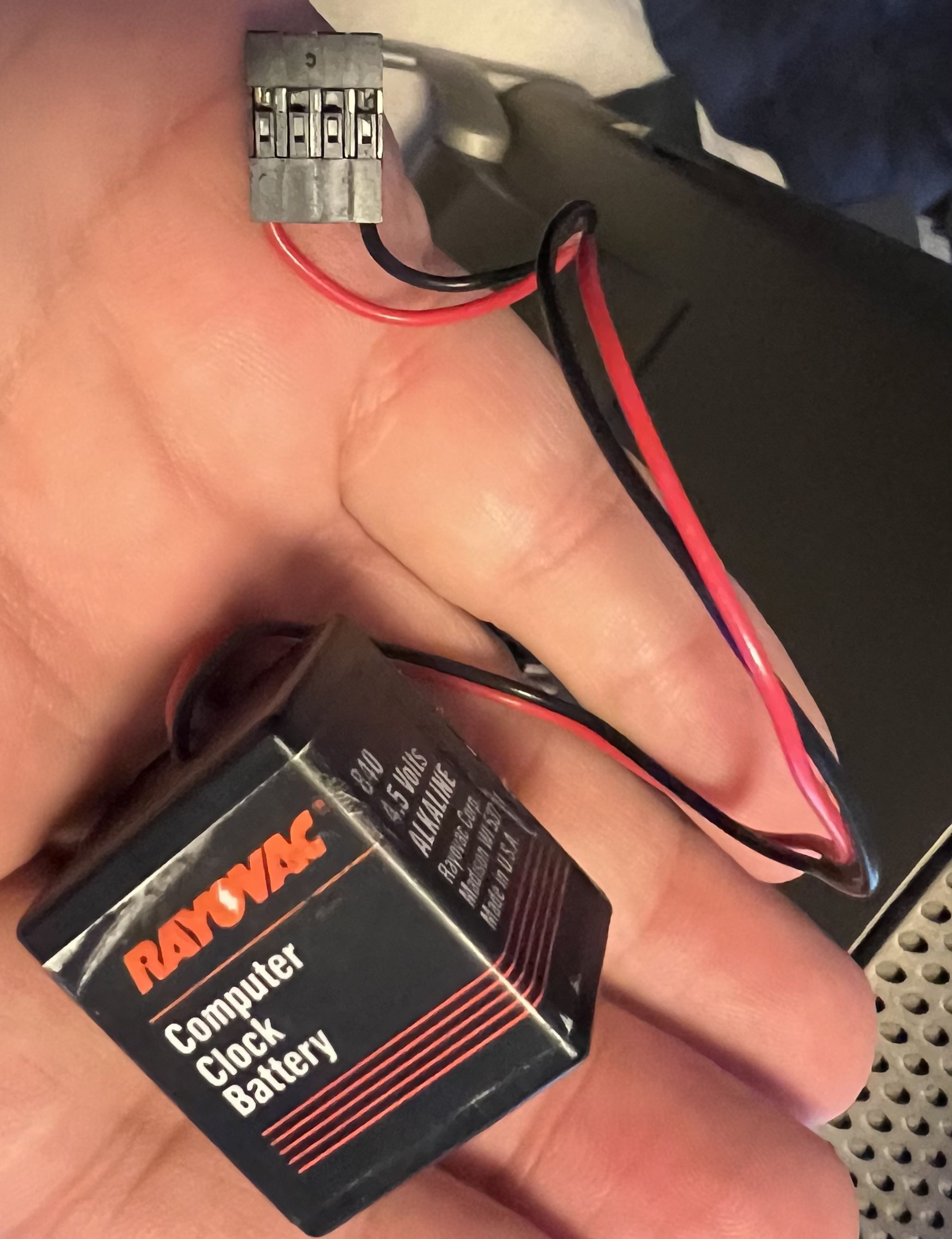

Once the TAM's internal IDE HD was imaged I copied it back to the SSD using a SSD USB adapter. reinstalled in the TAM. Added AA battery PRAM upgrades to replace the dead 4.5v weird Rayovacs that were dead but not leaking thank goodness. Fixed the clock on it.

How's the Orange Micro card working out with the G3 accelerator installed? I know that installing the Sonnet USB/FW card will cause lockups with their G3 card unless you apply a manual EFI patch. I'm wondering if the Orange Micro works any better?
I've currently got an ATA to CF card adapter in my TAM instead of an SSD. I'd be curious if the SSD with adapter would actually be any faster on a machine this old. I'd suspect there'd be other bottlenecks.

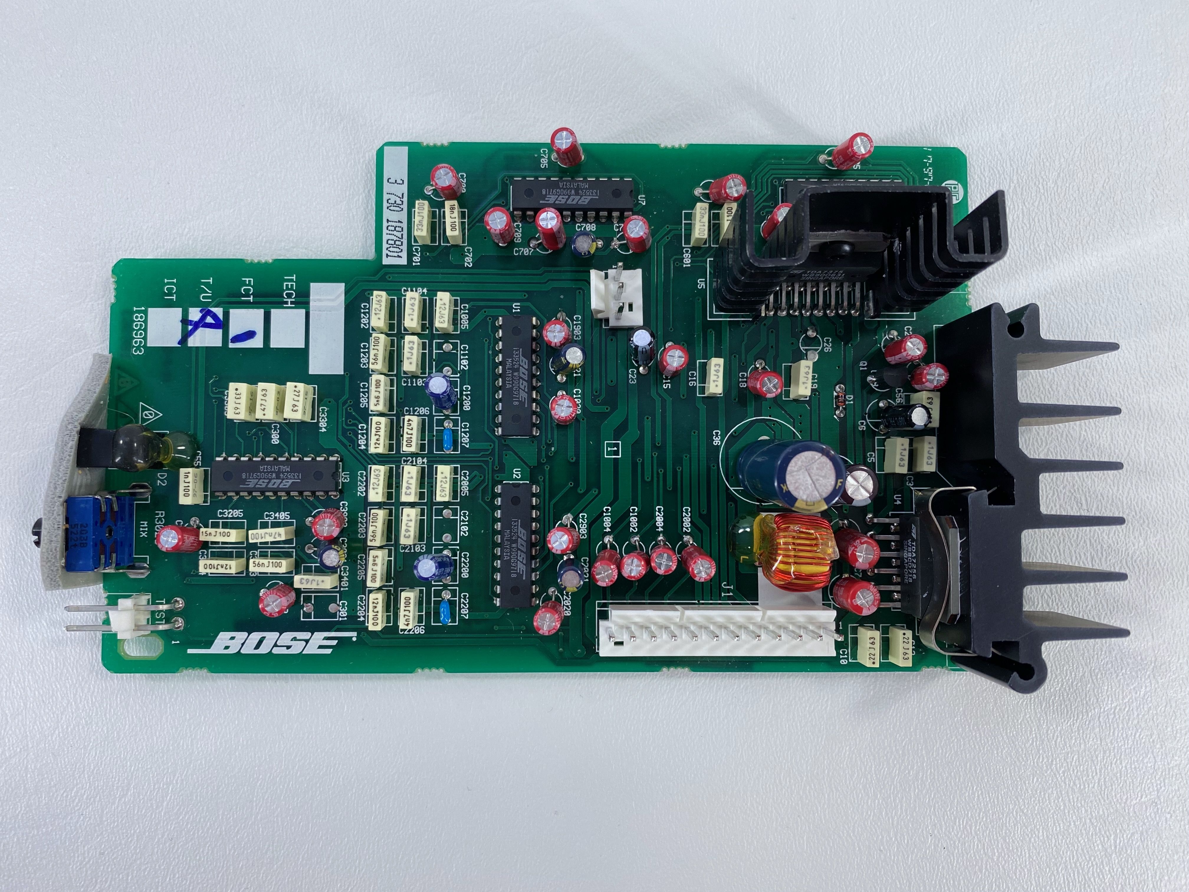

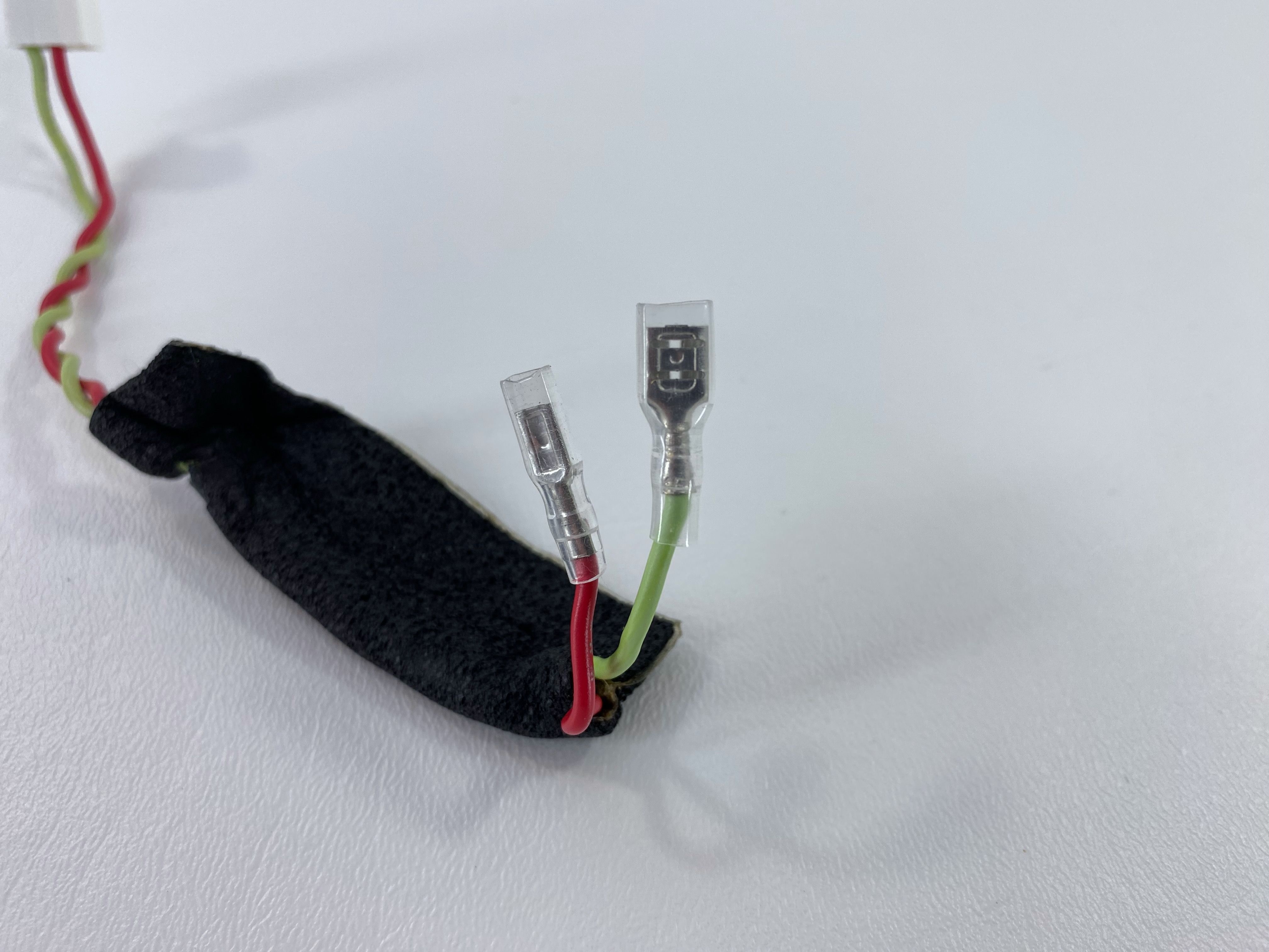

As I believe is mentioned in the iiiDIY video linked above, and also on the Macintosh Museum site, the issue is caused by some combination of (a) the uncoated spade connectors installed on the subwoofer at the factory, and (b) the pin header connections on the Bose amplifier board. These uncoated connectors can allow surface corrosion to build up, even a *very slight* amount, which then causes the buzzing sounds. AFAIK the umbilical cord connection(s) do not play a role. The issue can be somewhat mitigated by tinning the leads on these connectors, or even using a pencil eraser to remove surface oxidation on the pins, but I've read that these methods are sometimes not a permanent fix.
This past year I did a complete overhaul/'restoration' of my TAM including a full recap of all boards, SSD install, fan replacements, and also the "Bose buzz" fix. In working with Thomas Andrews (Amiga of Rochester), who did the recapping work, we decided to just go ahead and replace both of the spade connectors AND the pin headers on the amp board with new, coated ones. Thomas wrote up this post on his site about the work he did on my unit. So far (about 8-9 months later) these steps seem to be holding up as a permanent fix - no recurrence of the buzz to date.

Bose amplifier board after recapping and pin header replacements
Subwoofer cable with new (coated) spade connectors installed

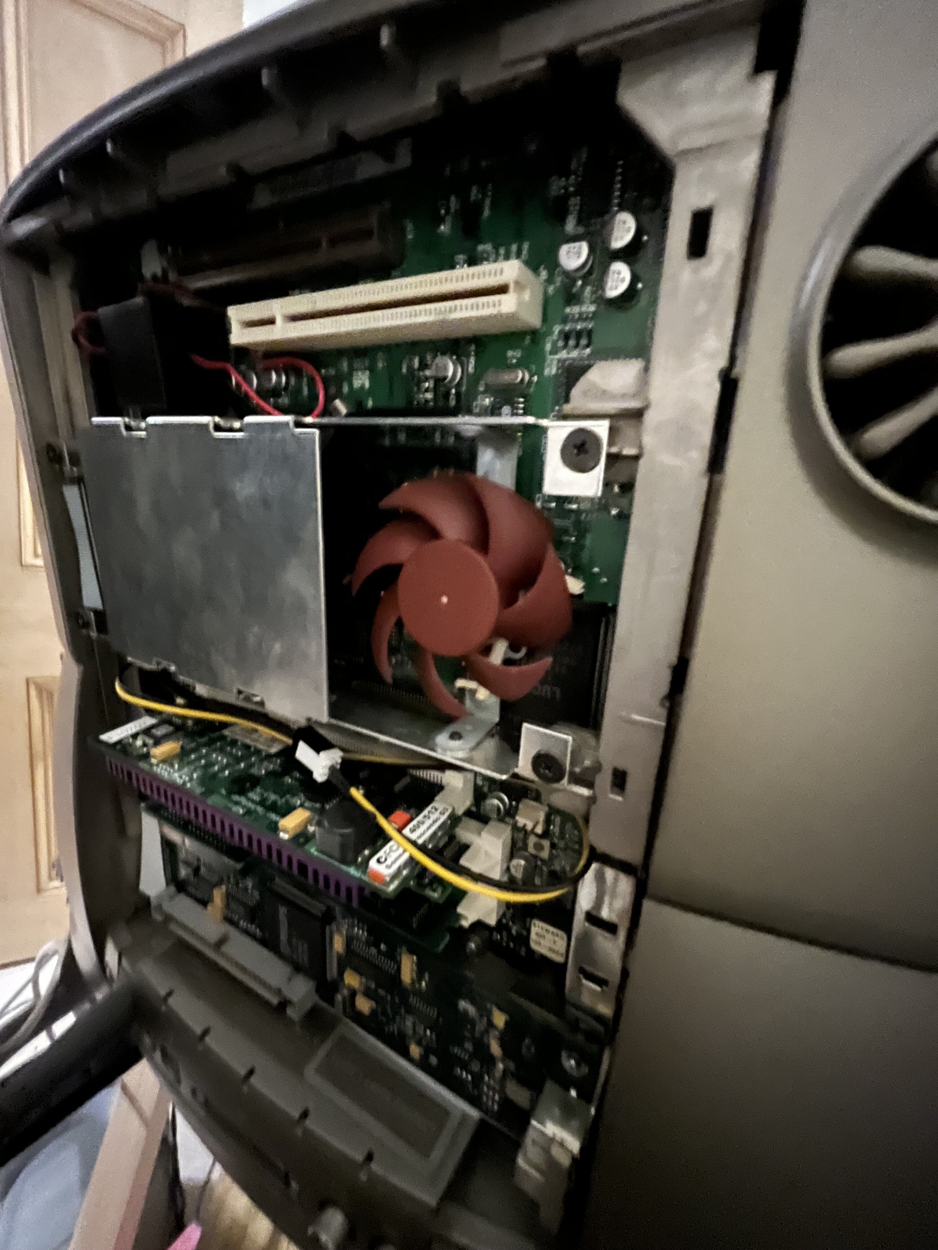

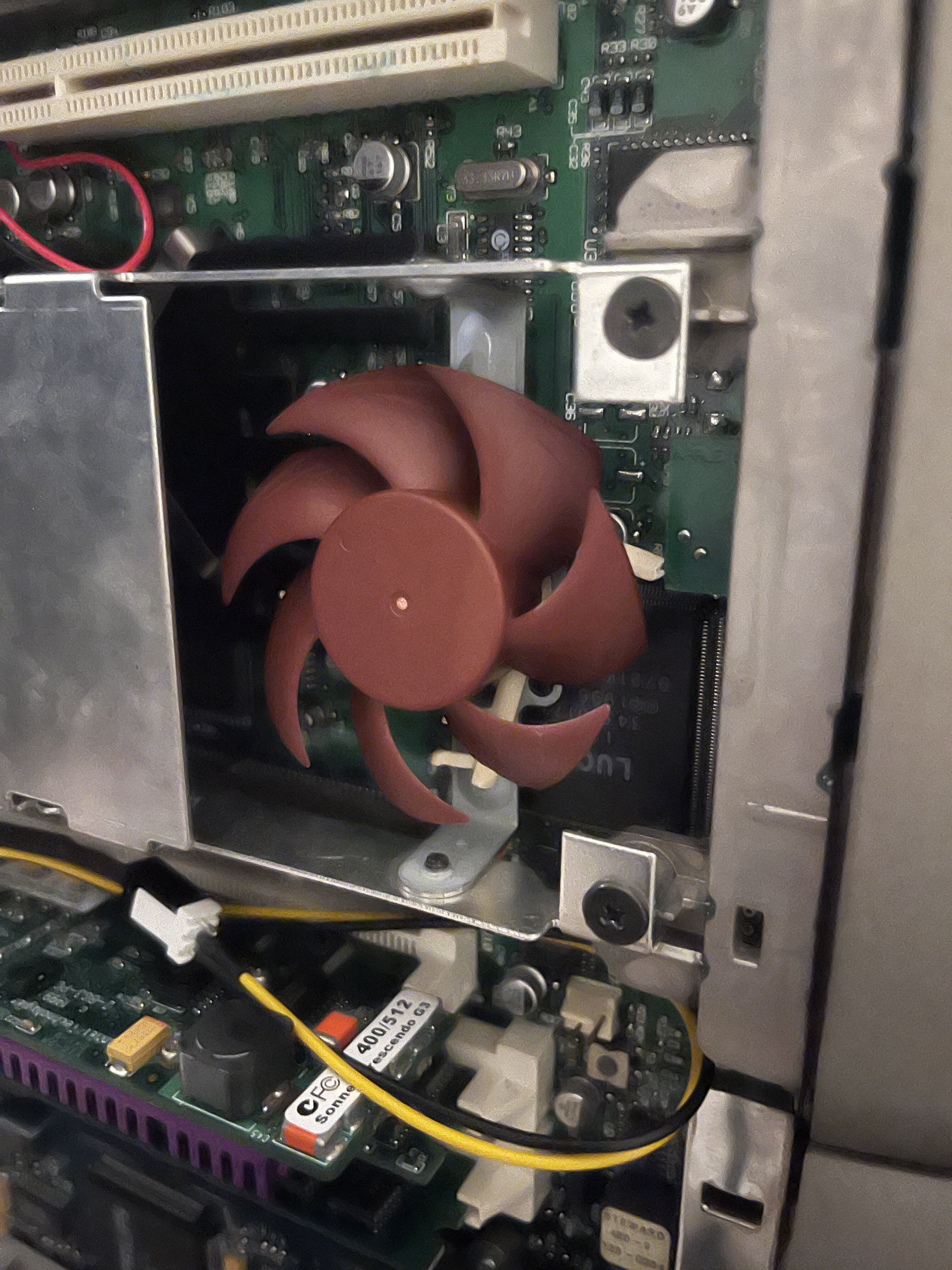

I wanted to share a relatively quick quality of life mod I performed on my TAM recently: swapping out the fan on the HDD/fan bracket which is distractingly loud (on my unit at least), especially with the slim back fitted. A reddit poster inspired me to try this, and it's made my TAM's background noise much easier to live with on my desk.
I removed the existing fan (mine was an: Elina Fan 0PF6015L-12MB-2) and replaced it with a modern Noctua unit. The original fan has screw mountings to fit it to the bracket which are not going to be easy to find on a replacement, so I used thread through the screw holes to secure it to the bracket (the OP on reddit used tape). I would caution against using zip ties - I tried this and the locking clip on the zip tie stuck out just enough from the bottom of the bracket to cause a clearance issue.
There are two candidate fans from Noctua - the original reddit poster used an NF-A6x25 FLX which is a good fit, but it is too deep to use with the slim back of the TAM. The better option if using the slim back is the NF-A6x15 FLX which is very close in size to the original fan. I removed my G3 expansion card and tested this with the slim back, and it clips shut nicely. Also note that the Noctua units are 3-pin, while the motherboard connector is 2-pin - so you will need a 3-pin male to 2-pin femaie adapter (I used this one).
The original fan has no housing, so I clipped the Noctua's 'legs' where they meet the outer housing so that the curved parts could be used to secure the fan to the bracket, then used thread wound around the legs and threaded through the screw holes to secure it. The extra slack of the 3-pin to 2-pin cable is sitting on top of my G3 card in the pictures below.
