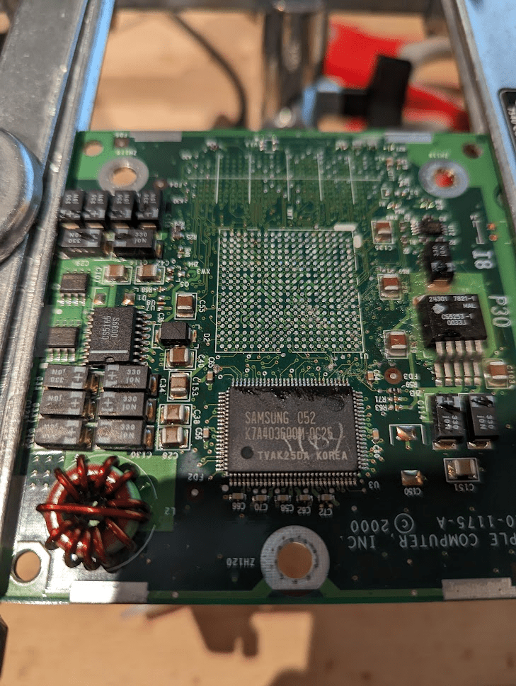

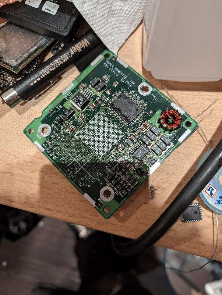

Well I did a small project here... I started with my G4 DA 466 board with a 7400 on it. I removed the CPU and I cleaned the pads...

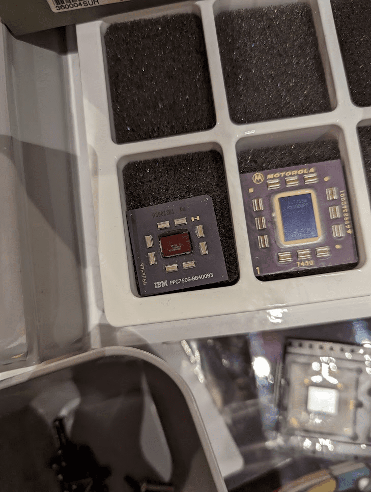

I got in a PowerPC 750S yesterday night, so I decided to work on getting that installed on the G4 board
Everything looks great! I install the board and nothing happens. I forgot to adjust Vcore, I come back and I install the CPU board again with the proper VCore (was 1.8 for the G4, needed to be 2.1 for the G3), and the CPU gets warm! But no bong. :(
Very disappointed to report that at this stage you cannot run a G3 in a G4.
So why did I do this? Because I can... :p
I'll be trying a firmware patch soon when I get a new CPU board for this with a G4 so it can boot, then retry the G3. If anyone has ideas I'd be glad to hear them!
Edit: someone on the TinkerDifferent Discord just came up with why it probably isn't working! 133MHz FSB models use MPX for north bridge communication and well, G3s don't have that! I'll need to find a Sawtooth/GigEth!
It would appear all AGP G4s use MPX (labelled as MaxBus), so the dreams of an AGP G3 are dead. :(
