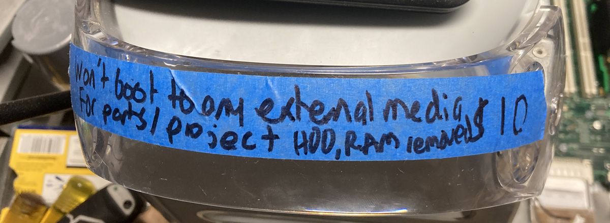

Stopped by Free Geek Minneapolis last week and found this Quicksilver $10 project. Labeled "Won't boot to any external media, For parts / project HDD, RAM removed $10"

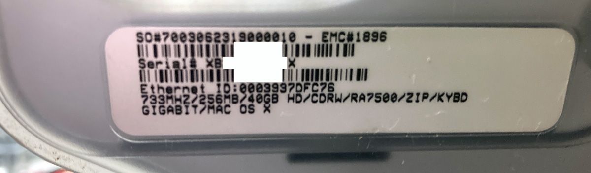

I can't say no, so I took it home. I threw in a single 256MB DIMM and a mechanical hard drive from another old G4 and powered it on. Data plate on back:

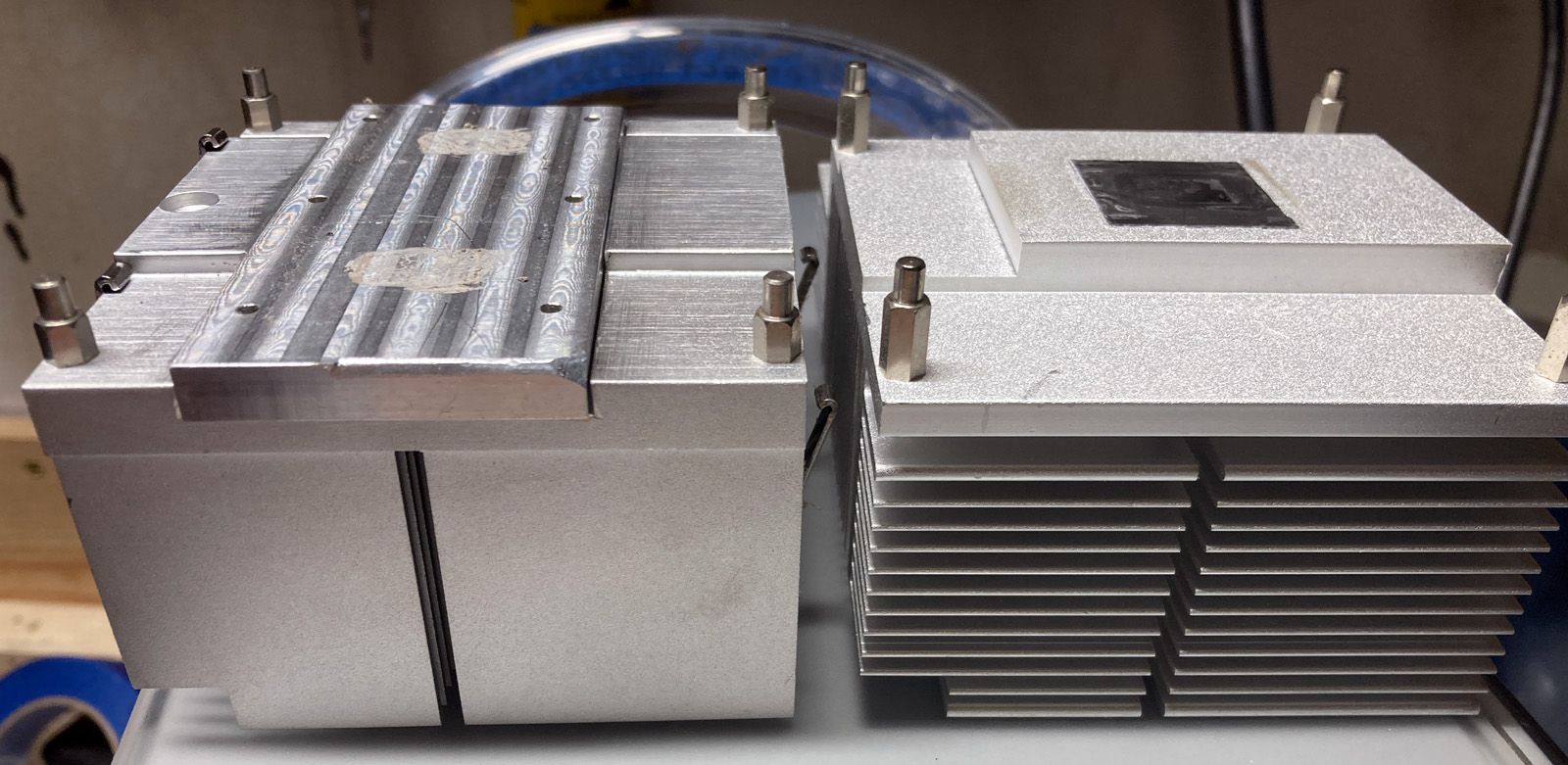

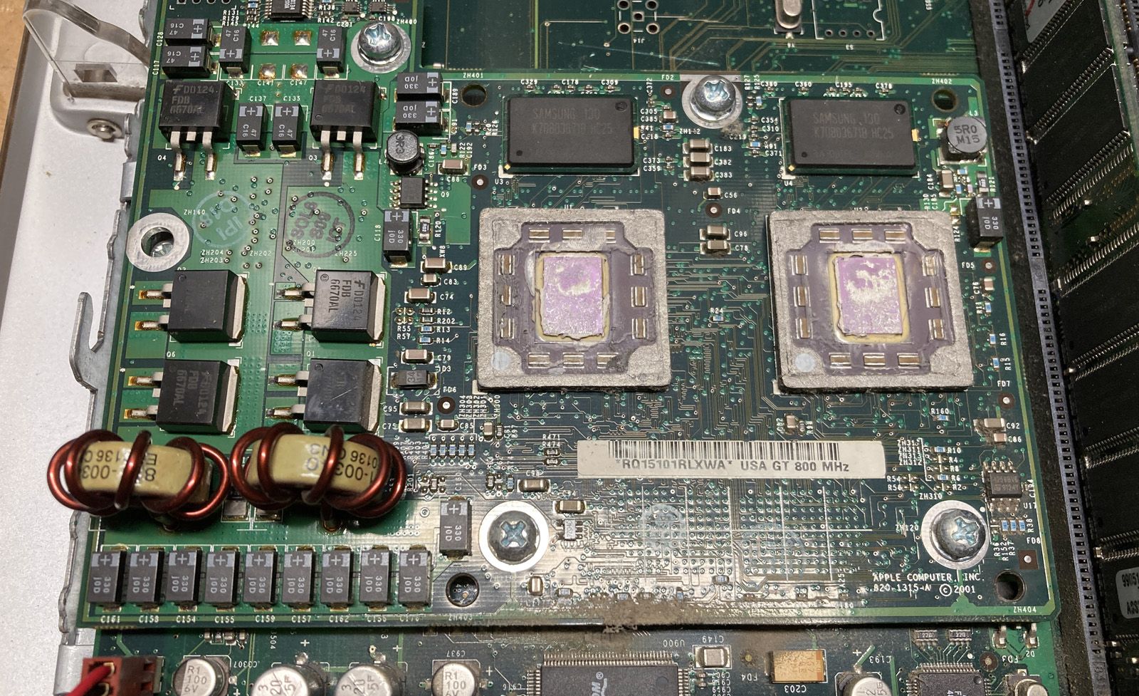

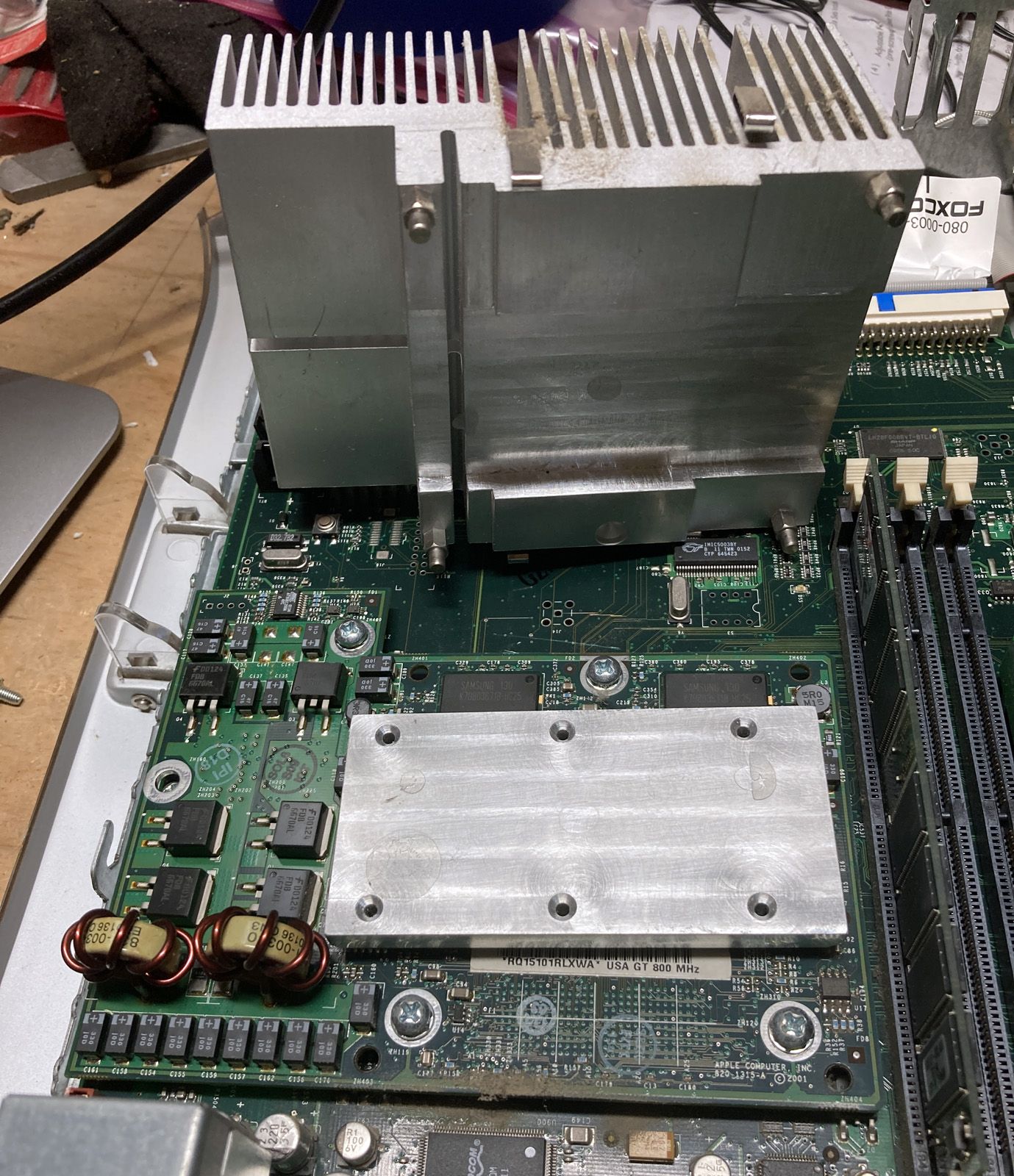

It gave me a chime, then a warning that a CPU failed, and another warning about another failure... then it froze. I suspect it was an upgraded dual CPU from the single 733MHz listed on the label. Ok, I have never seen a cooler like this. Obviously home brew.
And a dual 800Mhz was revealed.

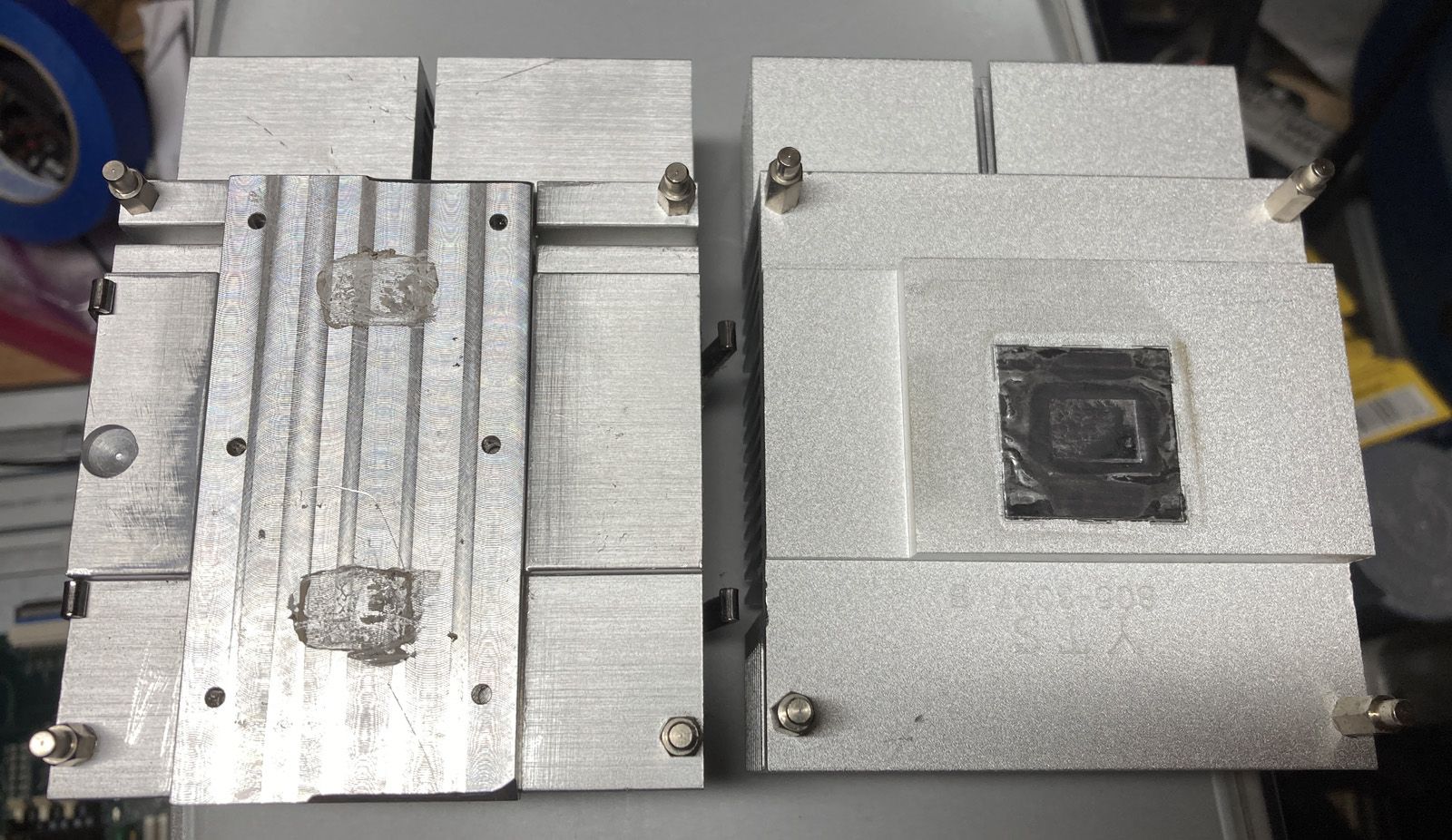

Cooler comparison
and another

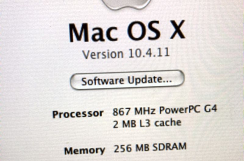

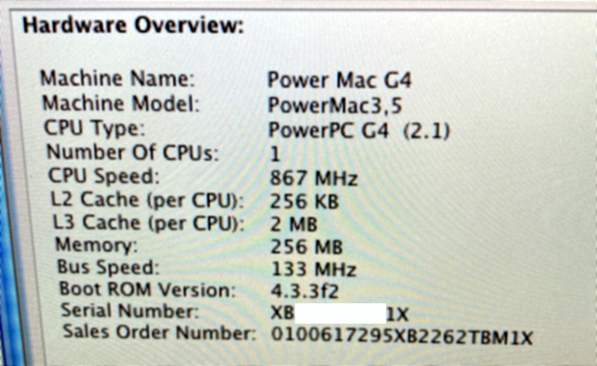

I have a spare 867MHz from my other QS when I upgraded it to dual 1GHz, so I installed that single CPU and the correct cooler.

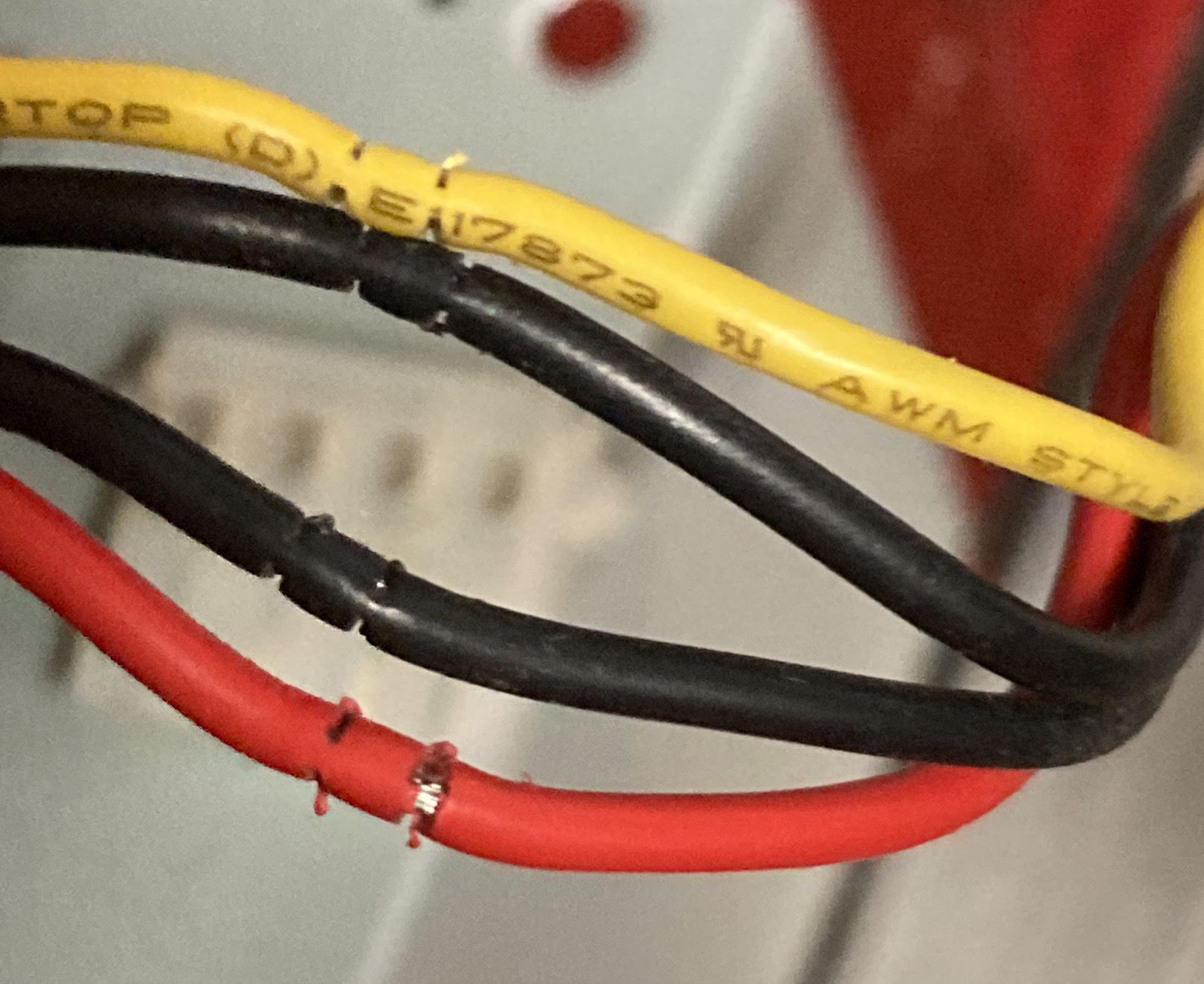

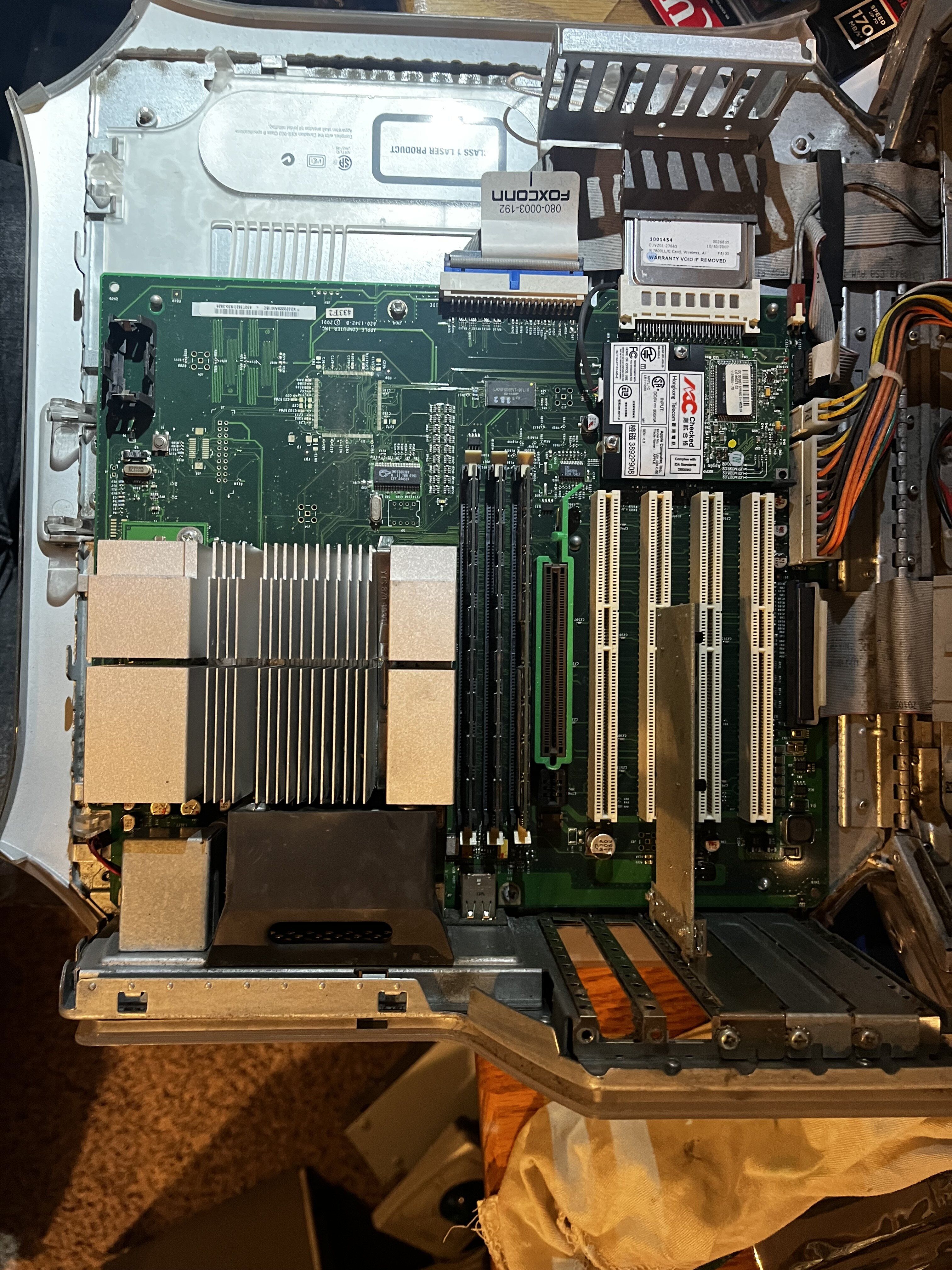

Then I wiggled a wire and it powered off. Oops. This one has a zip drive and I did not see a power cable going to the zip drive... but the plug was installed. Strange... so maybe the wires were yanked out and somehow shorted when I wiggled them.
I removed the PSU, and will find some spare wires and rebuild the 4 power cables for the drives and then reinstall everything.

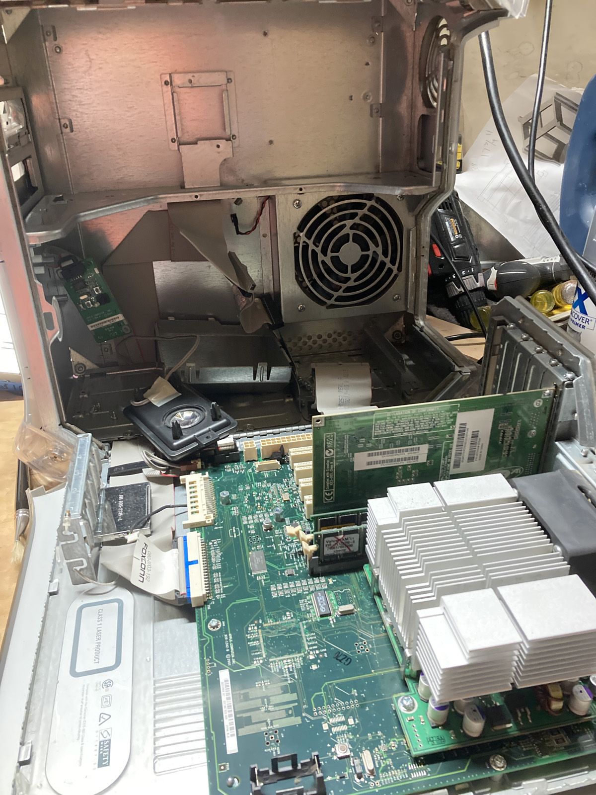

Very dusty, so the tear down is useful.

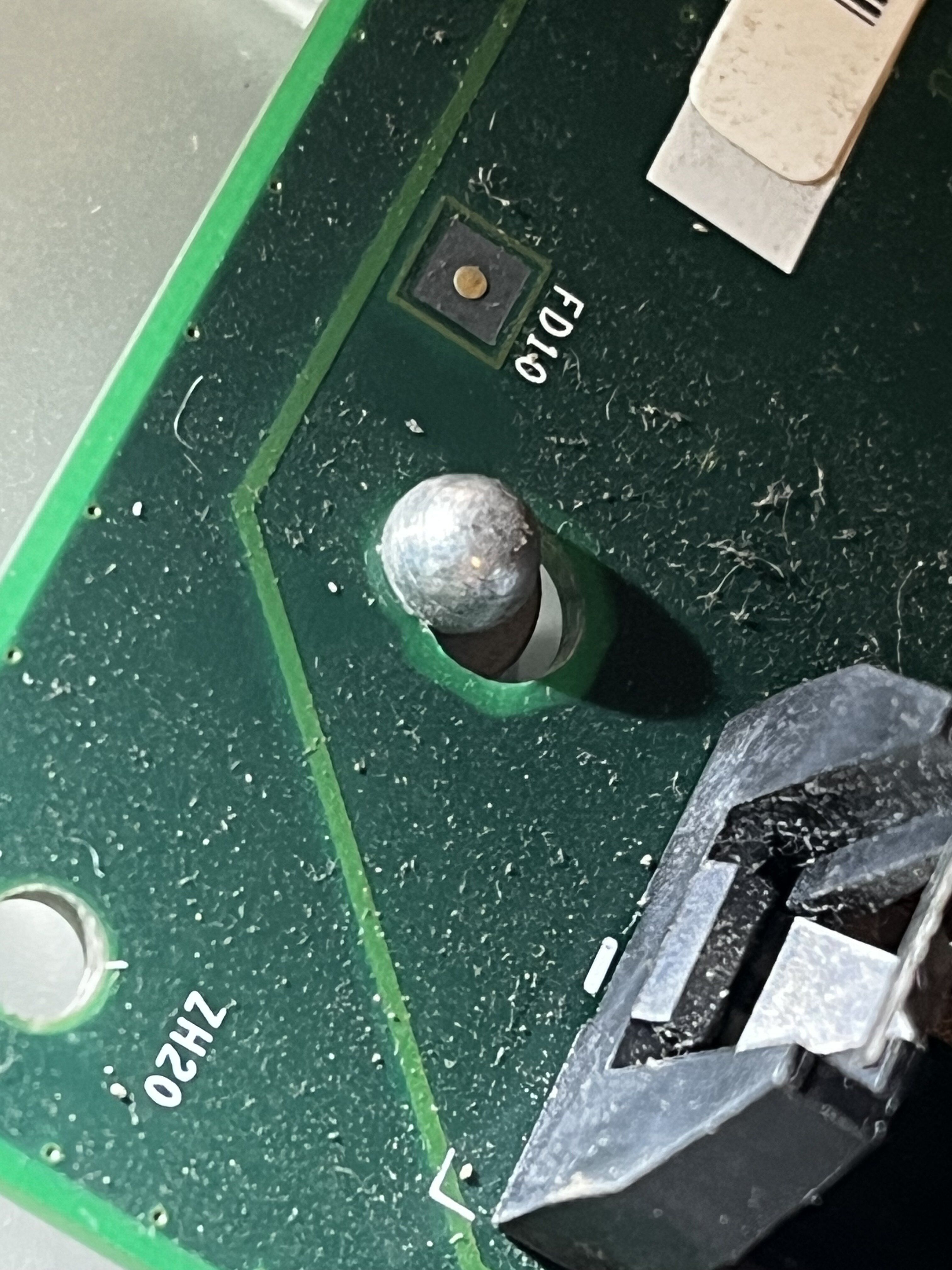

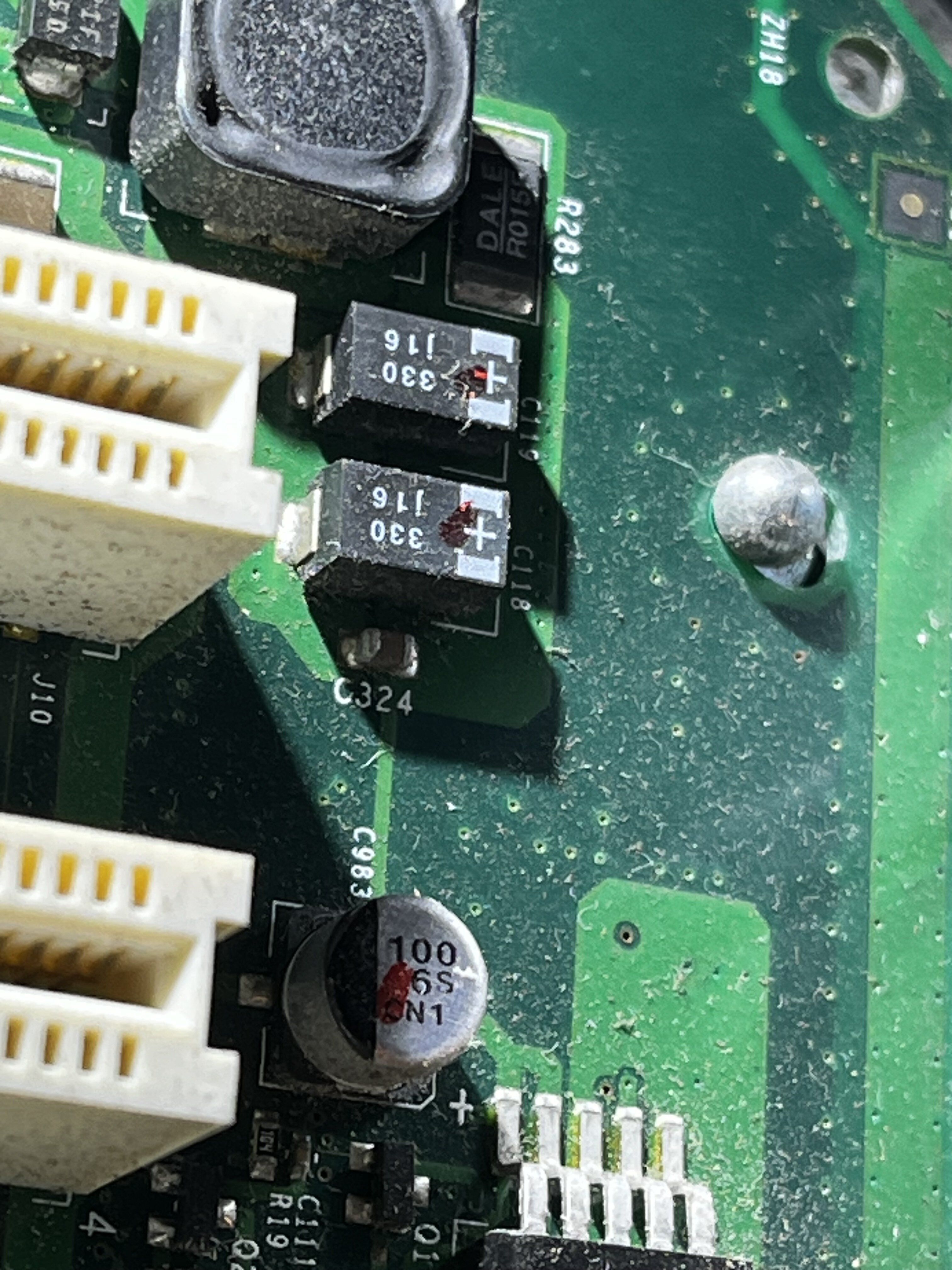

I just acquired one and it booted but it’s clear the logic board needs to be recapped. I’ve been following this iFixit guide and can’t figure out what they mean by “remove the pins by the RAM” Then slide the whole logic board off.
I see what looks like pins… I think. But they don’t seem removable? What am I missing here? I’ve removed the four screws. It won’t budge.
The pins in your photos do not move. The 4 screws hold the motherboard is a position that engages the pins. So in the 3rd picture, the motherboard should slide away from the back IO plate towards the Airport card, just about 1/8 of an inch. Then the motherboard will lift up off the frame.
I think the guide is talking about the 4 offsets that the CPU screws down onto... remove the 3 supports by the ram, but not the 4th one.
  • Lift off the heatsink and remove the 4 screws of the CPU board
    There are 4 pins: remove the 3 pins near the RAM but not the pin nearest You.
Well dang. Why the guide said “pins”… who knows. Right! I didn’t think to use a ratchet to move those hex bolts! Thank you!
