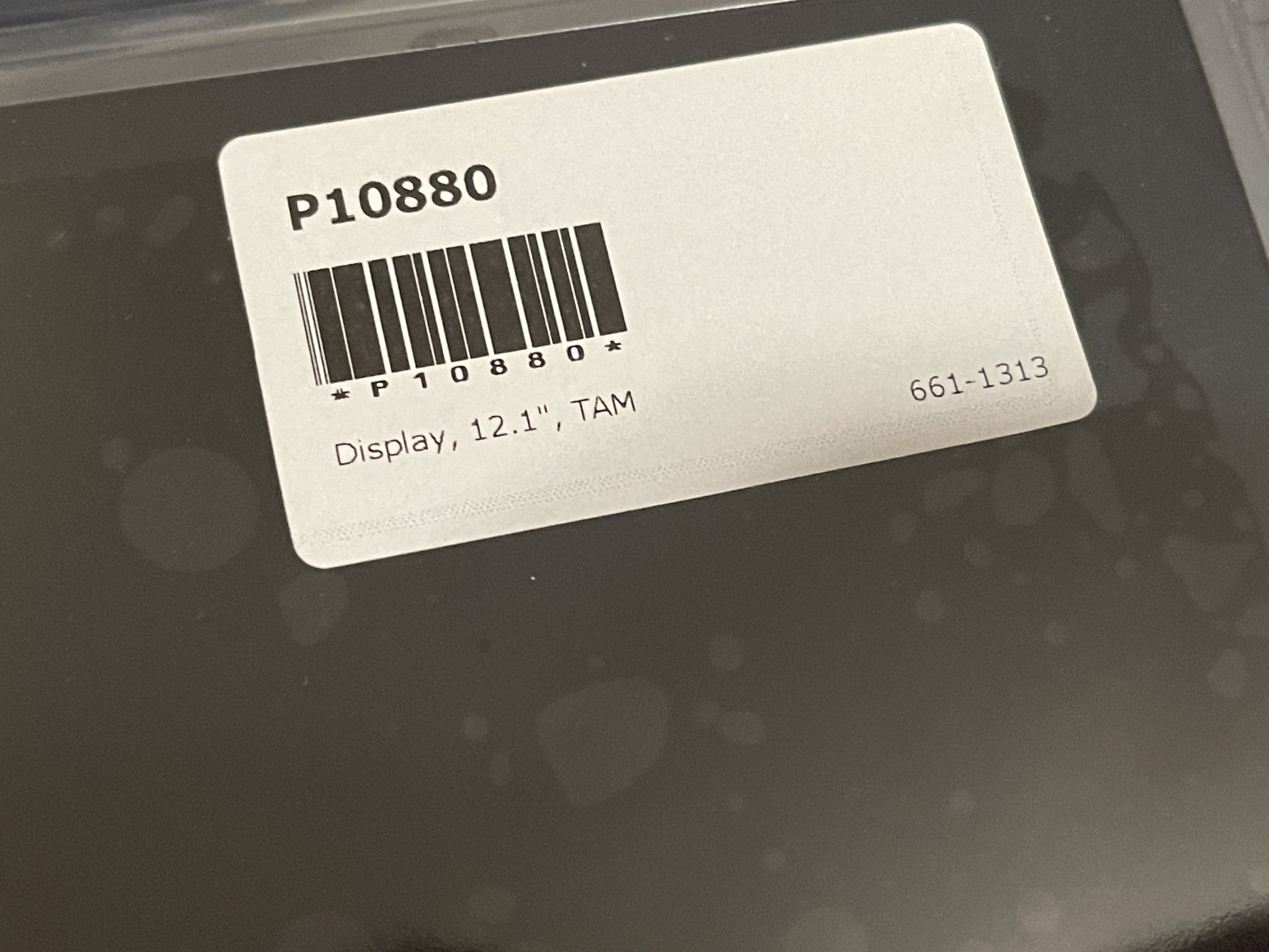

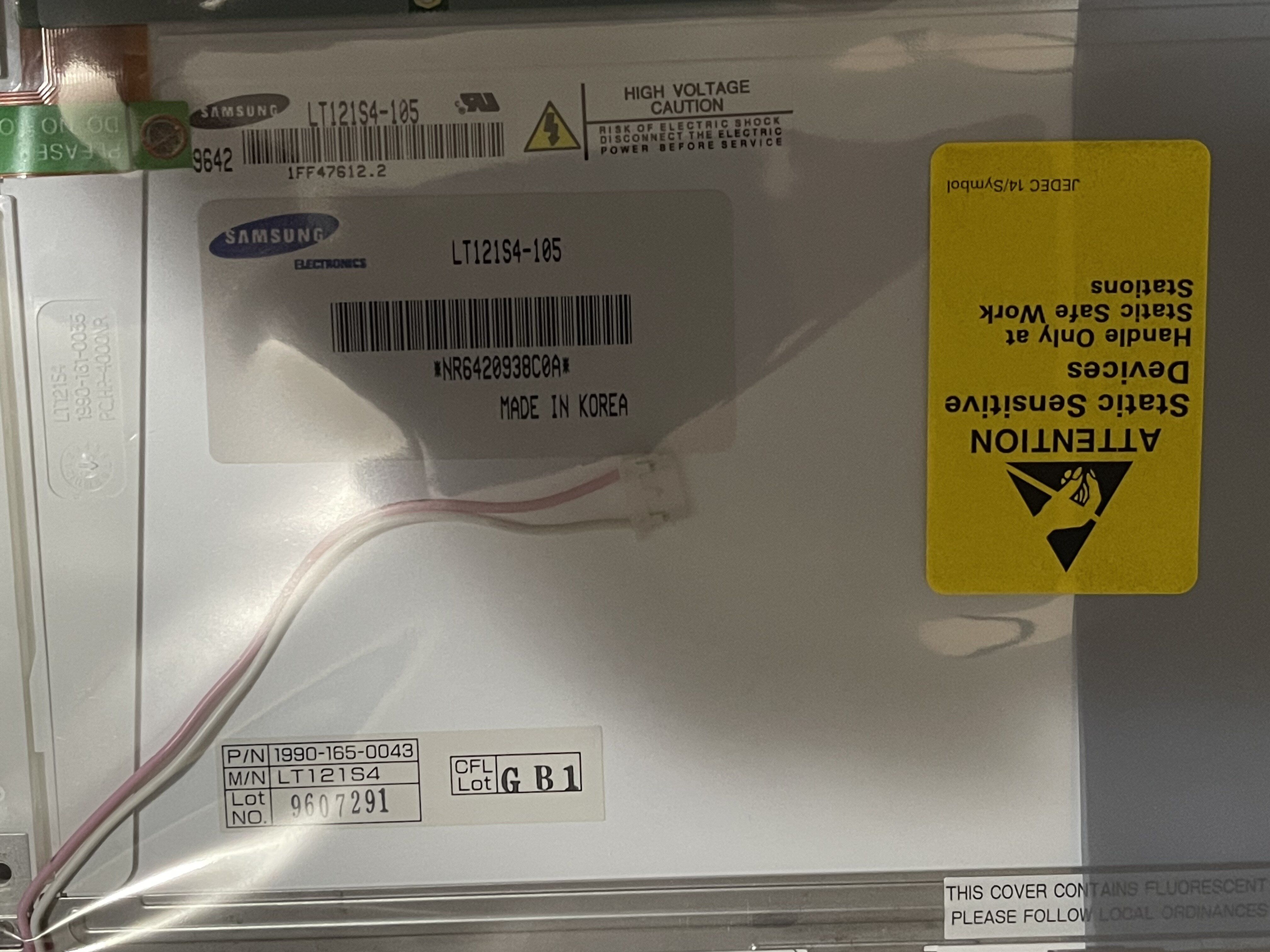

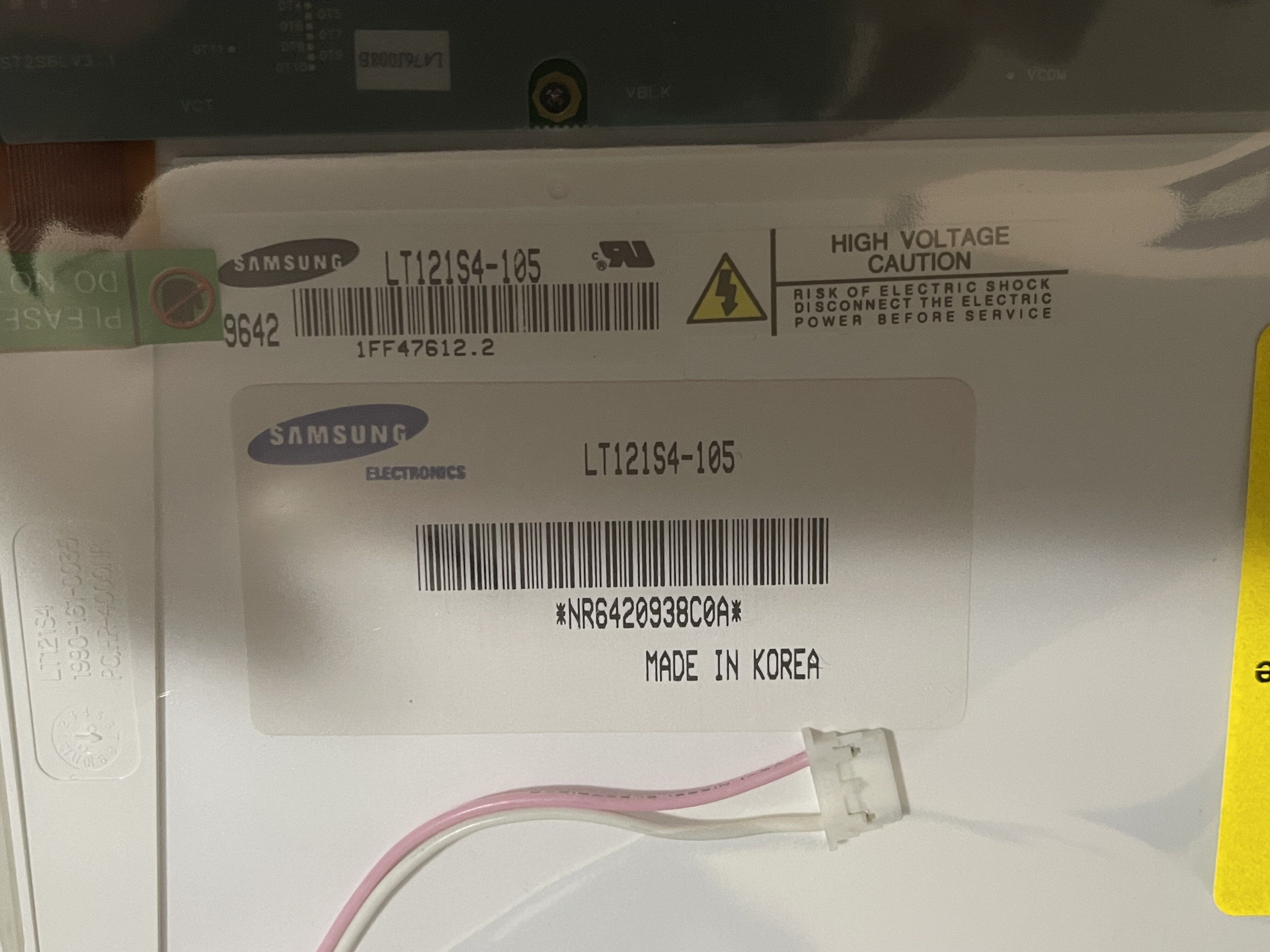

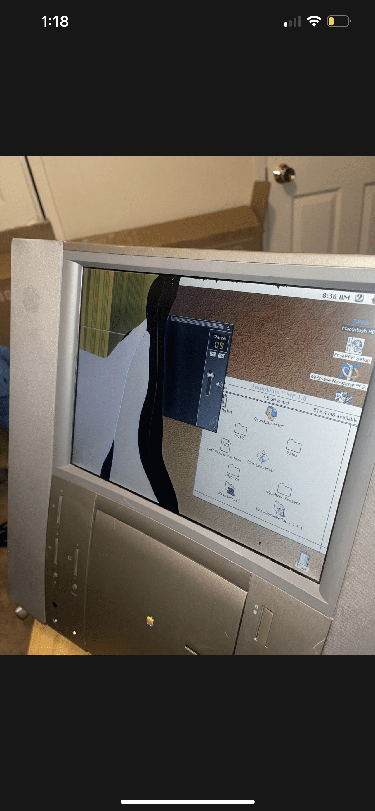

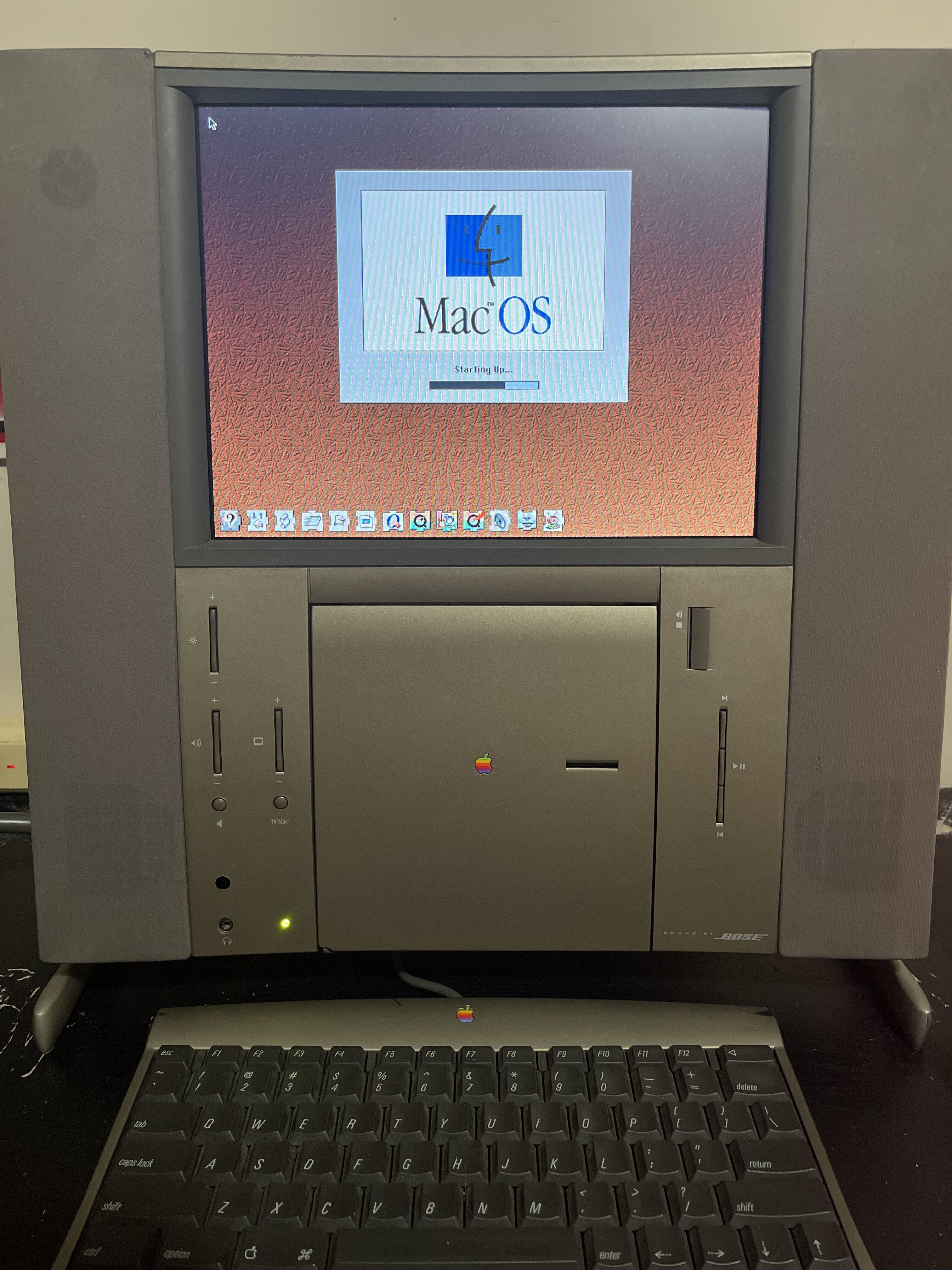

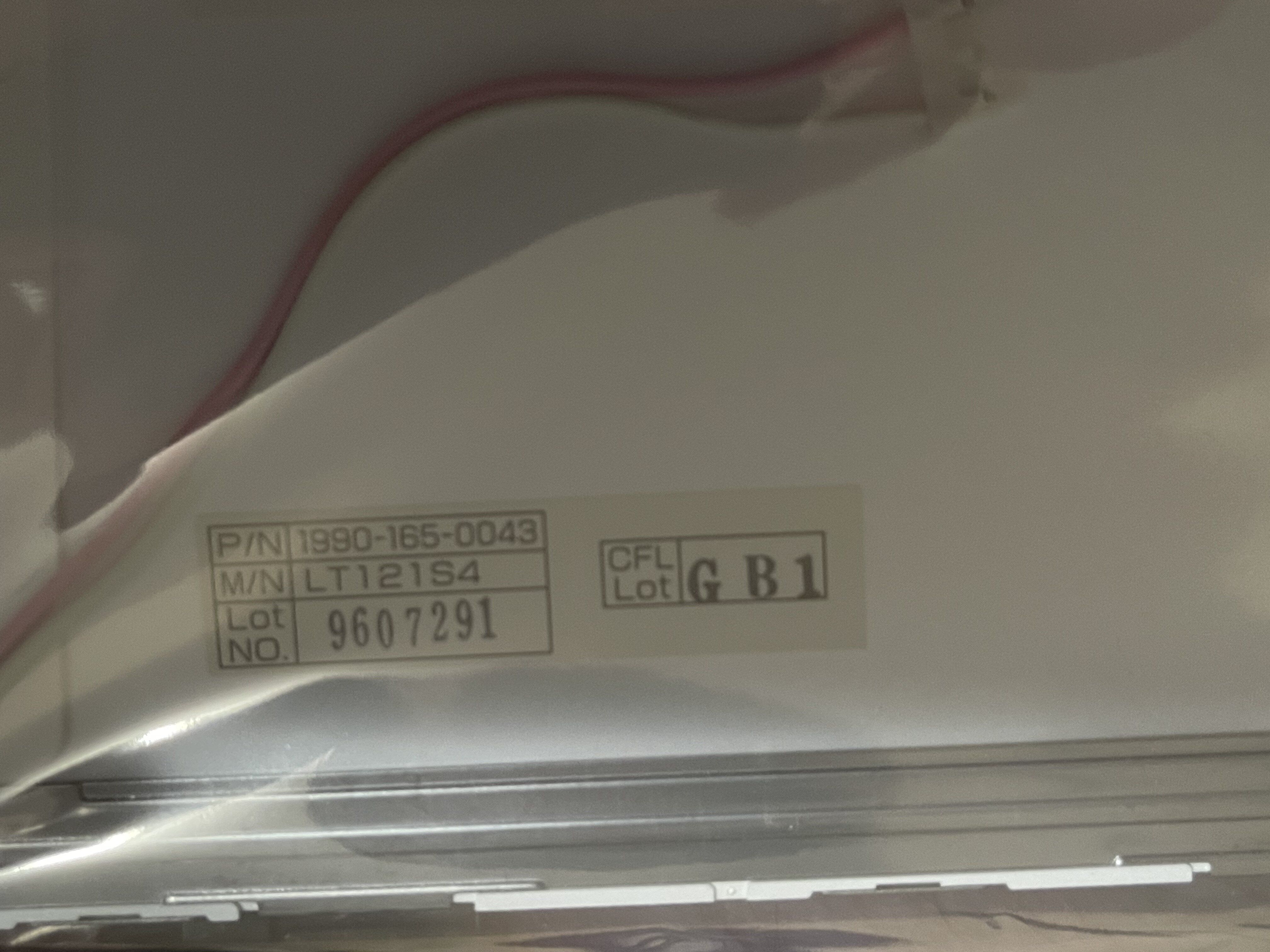

Well my screen arrived sealed from Apple in 1997 and now freshly installed in my TAM, it's waited 25 years to be opened and used and its brand new, the screen looks absolutely amazing! I added a photo below (yes the TAM needs some TLC and its in the works) what I noticed is the replacement and the original in mine were a Samsung 12.1" 600x800 TFT LCD part number LT121S4. I did some looking and I found a site that actually has a few in stock so if anyone needs one I say give this site a shot I cannot validate it though as I didn't use it.
Replacement Screen Link
Photo of My TAM Before vs. After
Sealed Packaging
