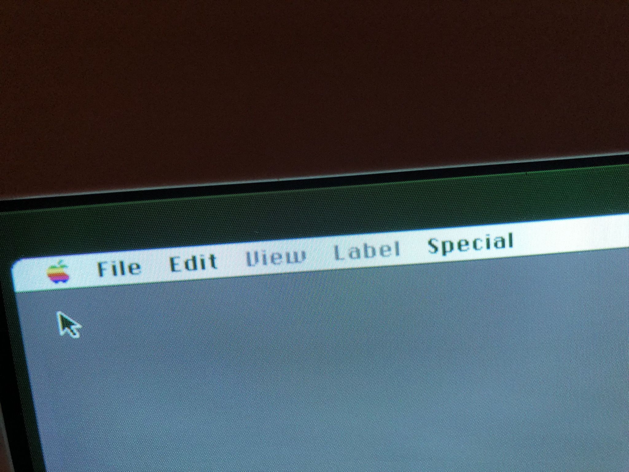

However, the remaining issue is with a green tint on the picture when the monitor is connected to my IIx. I have an Apple DB-15 to VGA adapter that worked with a flatscreen Dell
This sounds like a sync-on-green signal which your monitor doesn't know how to filter. There are circuits that will remove this. Myself I use an active sync-on-green converter that turns it into more typical composite sync, though these are not cheap.
Alternatively, you could try fiddling with the adapter if it has DIP switches, or you could use a different Mac video card that doesn't emit (or solely emit) S-o-G if you have one.
Unfortunately, my adapter doesn't have any DIP switches. Do you have any recommendations for a specific sync-on-green converter?

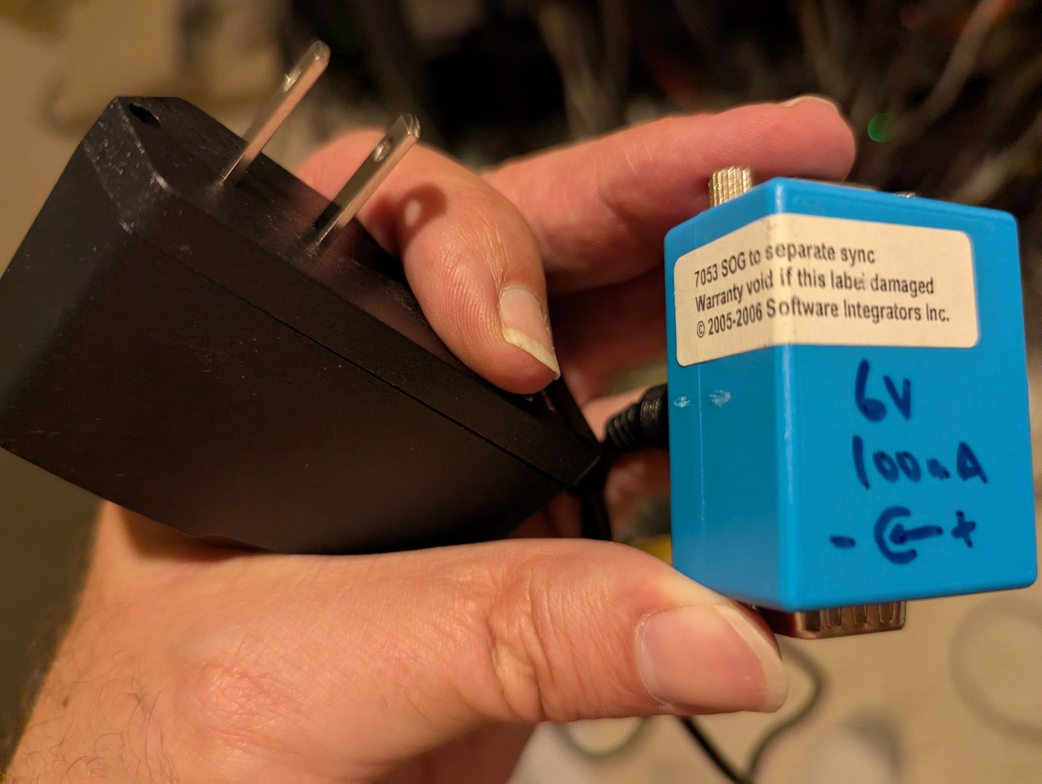

The one I use is a Software Integrators #7053. They still sell these, but they are not cheap, about $140 ( https://si87.com/Shops/3738123e-8b74-40b2-bd96-ddff0f19d352/Products/7053 ). They require an active 6V power supply which is included, and work for most systems and monitors. You plug the output of your Mac adapter into the input and your monitor into the output.

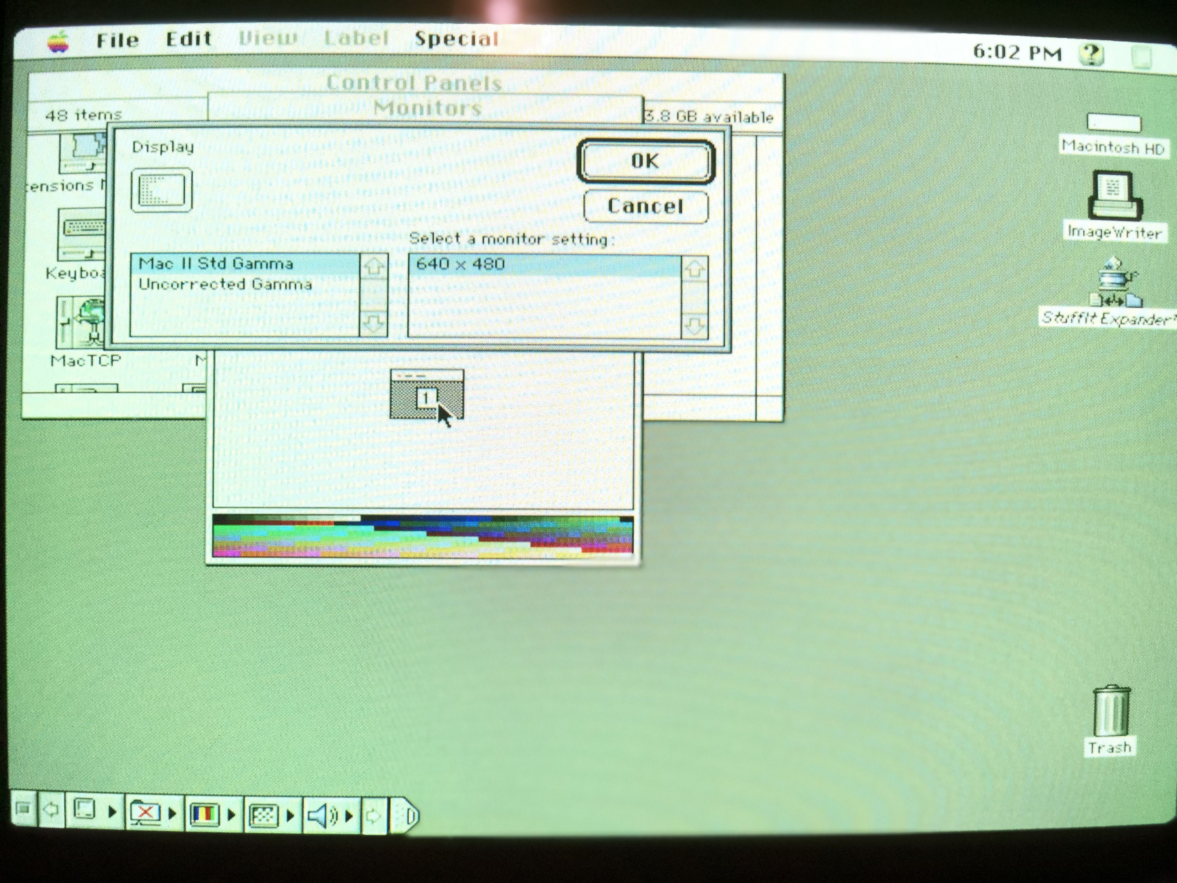

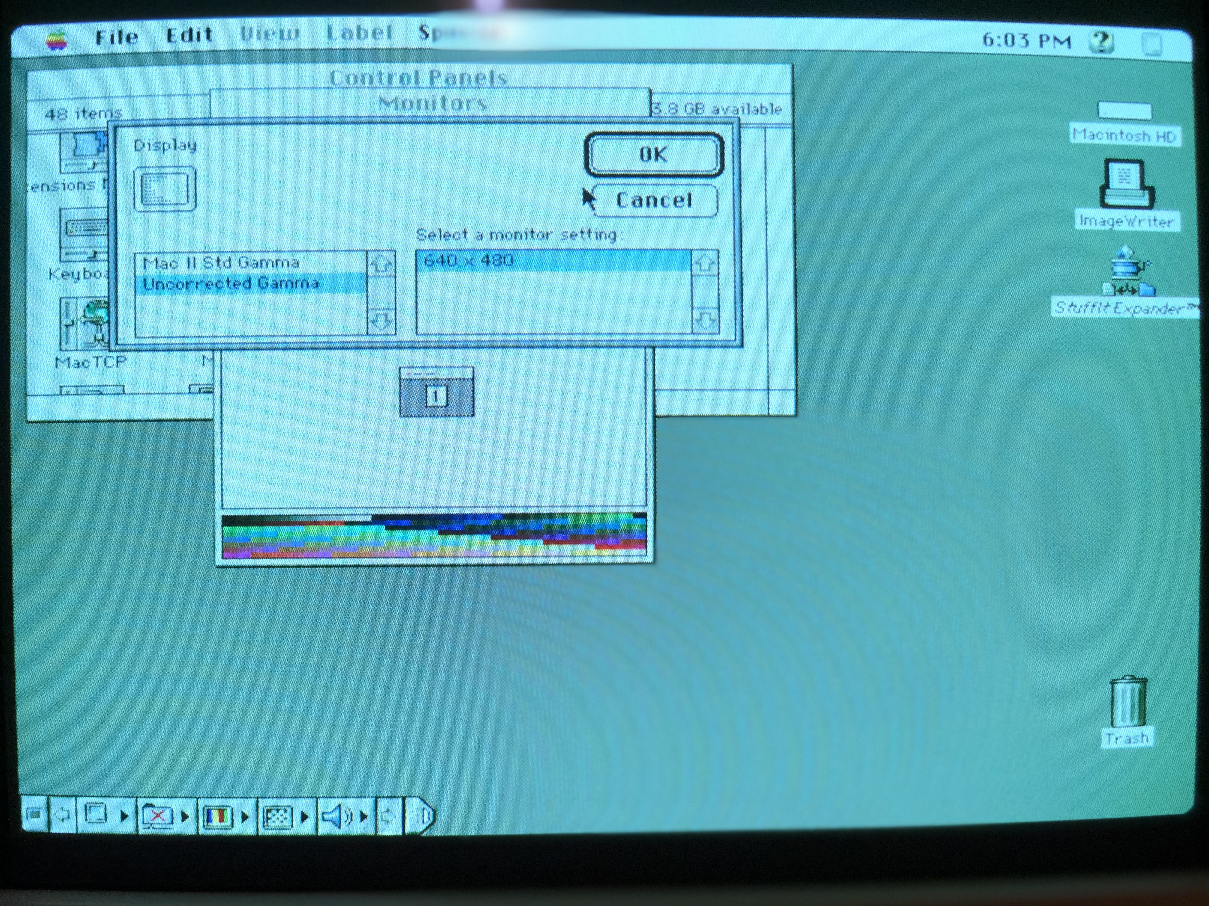

Unfortunately, adjusting the gamma does not fix that much for me. There are only two options for gamma: Mac II Std Gamma and Uncorrected Gamma, and it doesn't change when I hold down the option key and click on Options.... Even though it doesn't really look like it through the camera, selecting Uncorrected Gamma makes the green deeper, and selecting Mac II Std Gamma makes the picture a somewhat less saturated shade of green. So far, I have been able to get around the issue for the most part by turning down the green all the way in the monitor settings, but the color still looks off.

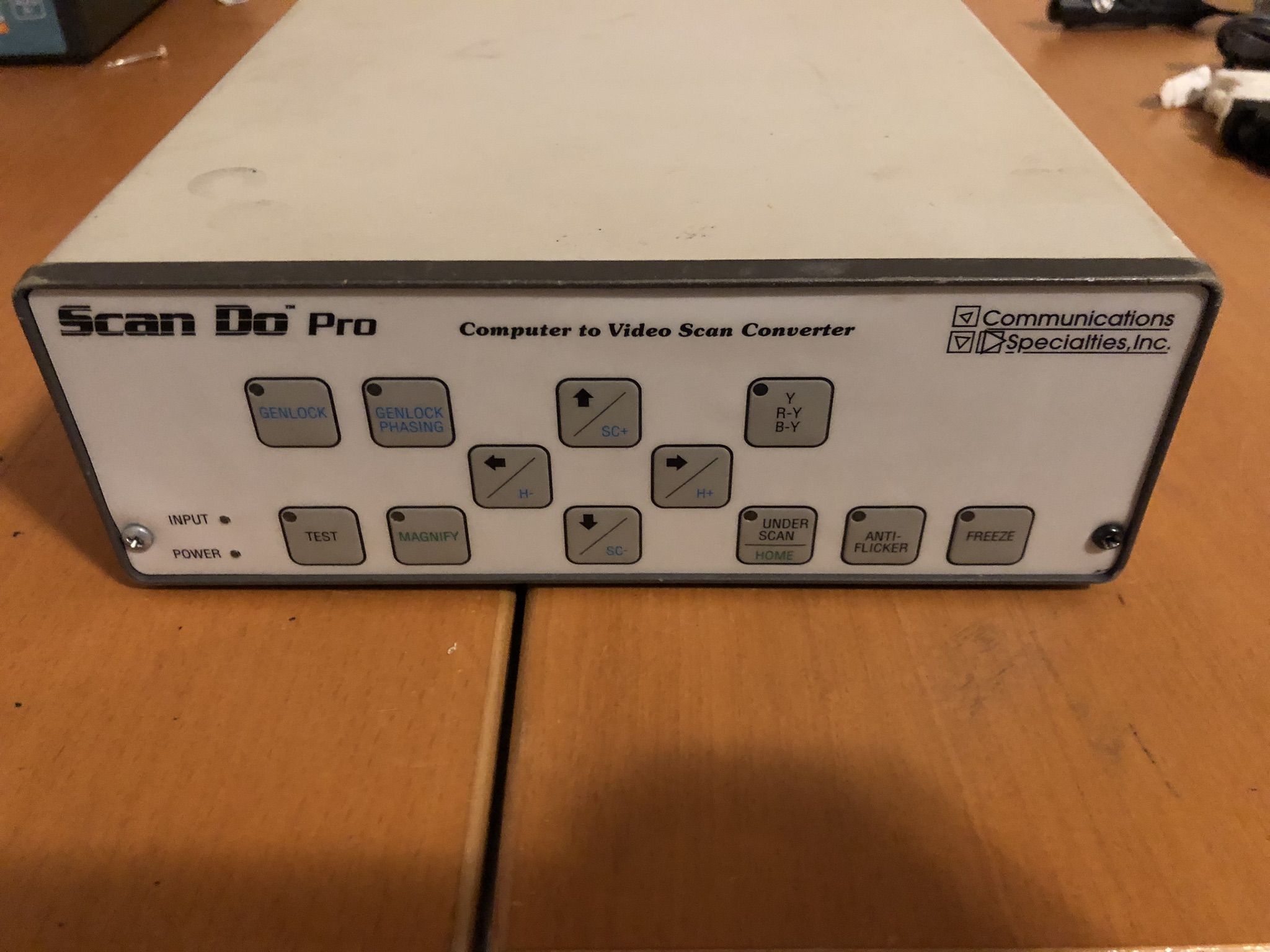

I actually just remembered that I have this thing, a Communications Specialties Inc. Scan Do Pro, that looks like it might be able to do the job. I'll have to try it out and see if I can get it working!

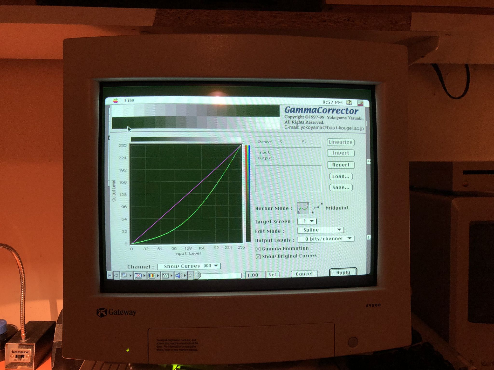

There is a control panel named Gamma which might help. It’s not Apple’s, it’s aftermarket. I think it’s on Macintosh Garden.
It does look like this is the sync signal on green. I have also seen a version of this where sync signals over RGB cause certain displays to lose contrast (Appear washed out). I actually modified some of my video cards to turn off adding sync signals to the RGB signals. You just have to lift one of the pins on the RAMDAC (BTxxxxxxxxx for example) and tie it to ground.

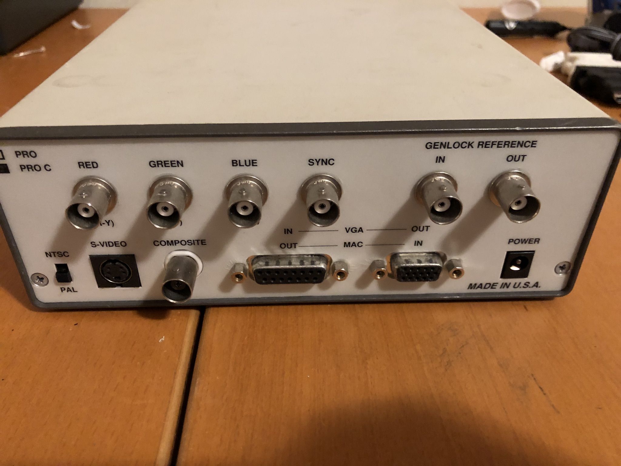

View attachment 24612View attachment 24613
Interesting unit. I guess it would come down to what it does with the colour lines. The BNC connectors have a separate sync; perhaps you could connect the Mac that way.

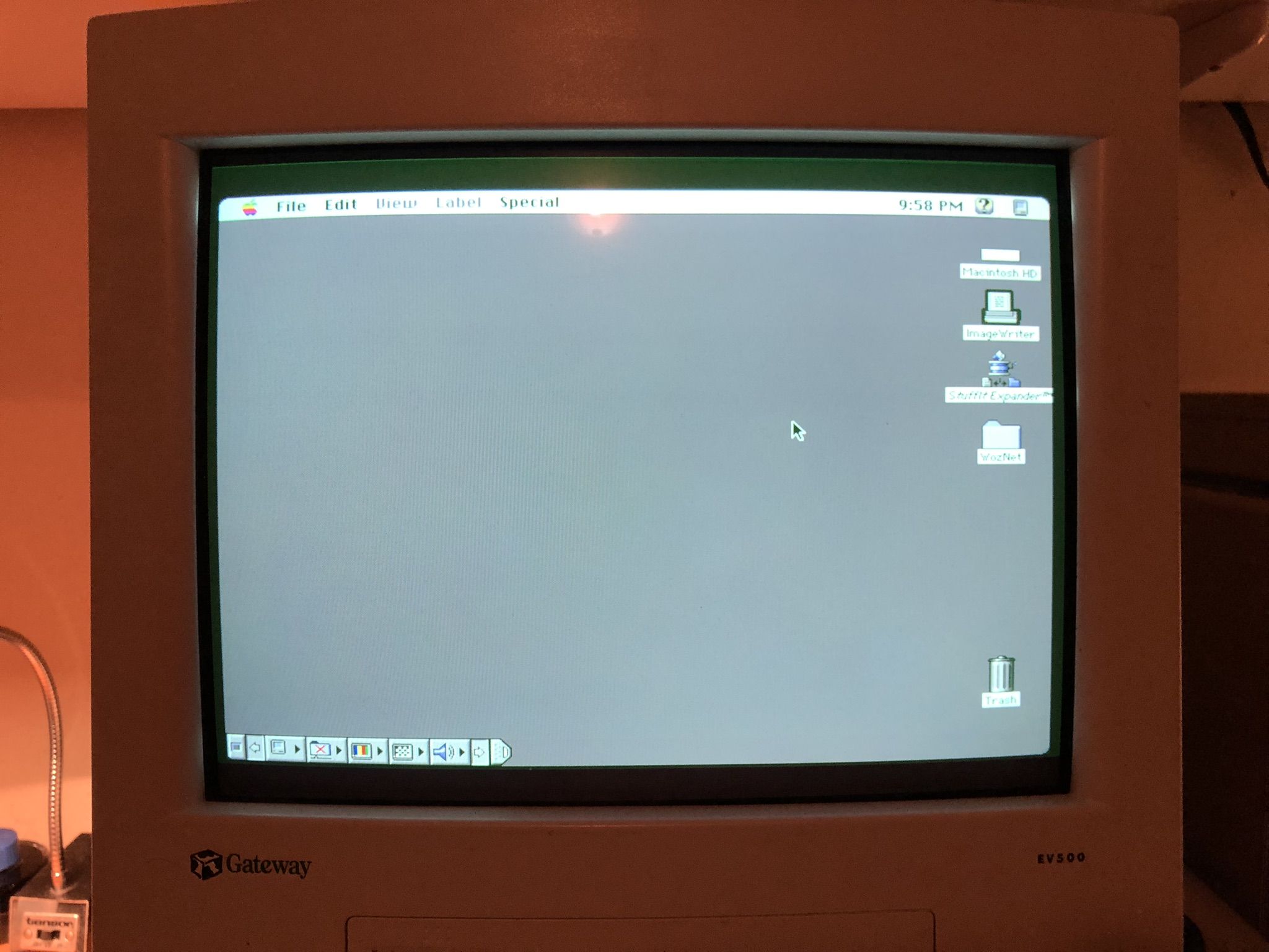

Update! I've installed GammaCorrector 1.1.1 from the Macintosh Garden, and it has worked really well to get rid of the green tint! In person, it still doesn't look perfect, and there is a noticeable green tint just a bit off of where the desktop is. However, I only spent a few minutes playing with the software; if I spent more time I could probably get it to look even better. The Scan Do Pro may or may not eliminate the sync-on-green signal, but for now this software works fine.
Also, as I was writing this post, I realized that when my IIx went on to the screensaver it looked like the settings were just completely lost, as there was a very strong green tint. However, exiting the screensaver makes everything return to normal.
