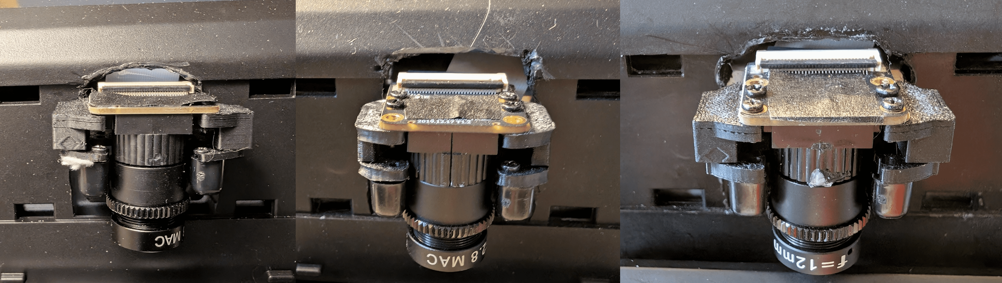

I hope you dont mind helping me out with a few - possibly dumb - questions:
1) The 12mm lens for the mod has a fixed aperture of 2.8. I noticed someone say that they should have purchased the 5.6 version instead. Is there a 12mm with a 5.6 aperture? If so, thats TWO f-stops higher, and im worried it would have a huge impact on exposure, no? (what do you think?)
2) Is there a location on this forum that has all the files for the lens modification? 3d printed spacer, lock ring, lens offset, etc...
3) As I was reading all the forum posts, I think I remember someone mentioning they would post a tutorial for the lens mod - was it ever posted? if so, where can I find it?
4) lastly, I see that several people are wrapping the "posts" on the scanner with "pec pads". I got the idea in my mind to purchase "felt tape" from AMAZON and place it on the posts. What do you guys think of this option?

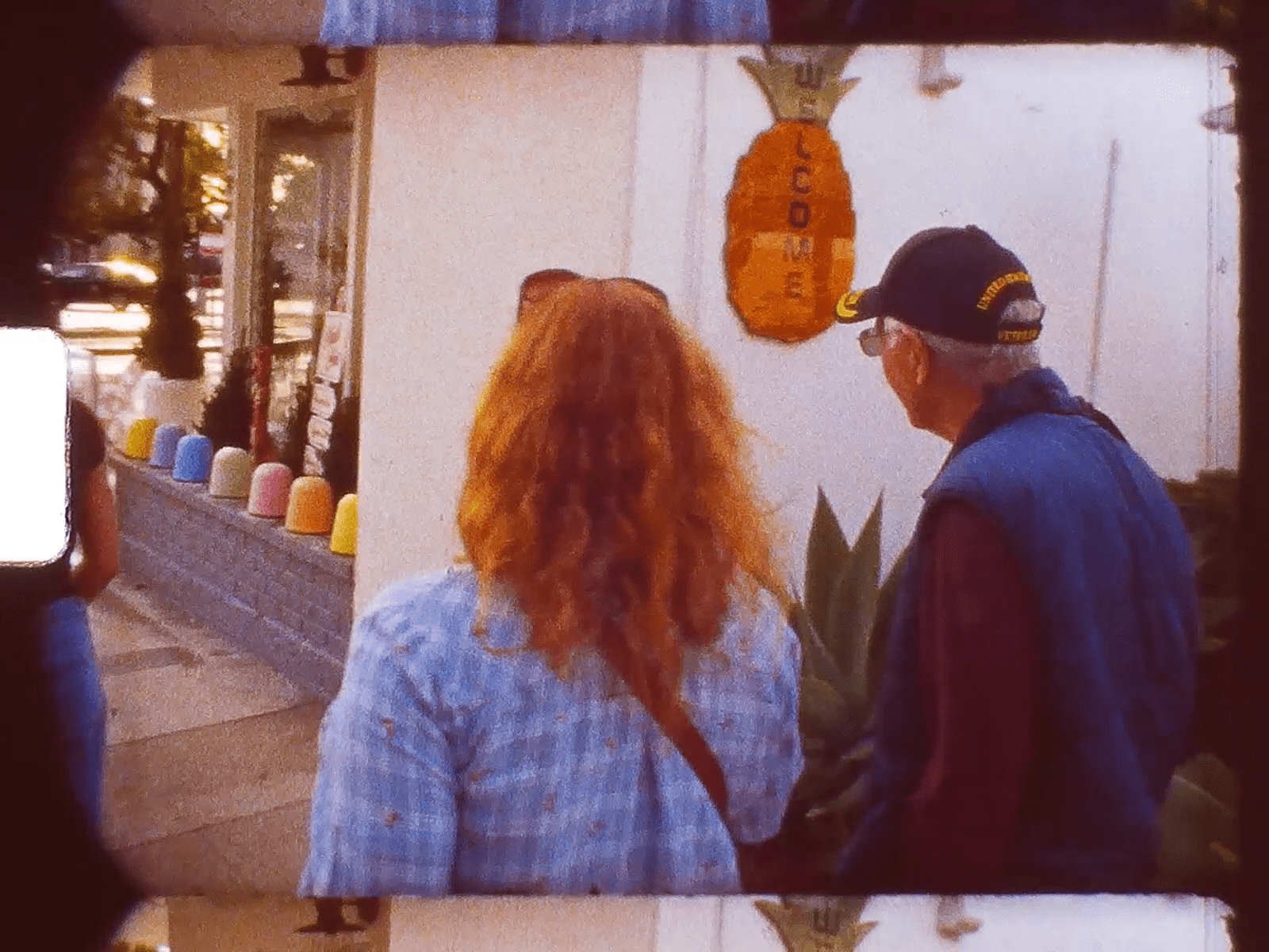

Maybe it is more of a support question rather than a hack, but how can I improve my capture?
I am trying to digitize old Super8 reels and the capture is jumping around like crazy. The footage to me is useless this way.
The result:
What is happening during capture:
Is my machine faulty? Or they all this bad? Can I do anything to improve?
I tried this with three reels (two sizes/types) and the film seems fine.
After reading and watching a ton, I started prodding the machine like a monkey, I tried: 1) creating slack in the take up reel, 2) no take up reel, 3) slack in the film reel, 4) different paths (this you see in the video), 5) toggled the selector switch to improve engagement with the film, 6) slide finger pressure on right side of the guide. Nothing has really improved my situation. Sometimes it seems like something is working until it doesn't.

1) stick with the the known lens 12mm at 2.8mm. I have three units running 2.8mm all work great. Use: https://www.rmaelectronics.com/azure-photonics-azure-1228mac/
2) Latest 3D spacers: https://tinkerdifferent.com/threads...-film-digitizer-firmware-hack.2897/post-42590
Locking rings: https://www.m12lenses.com/category-s/97.htm
Extension tube: https://www.m12lenses.com/7mm-Metal-Extension-Ring-for-M12-Mount-p/pt-erm12-700m.htm
3) I haven't seen one
4) Try it. Pec pads are working for me, haven't tried anything else.

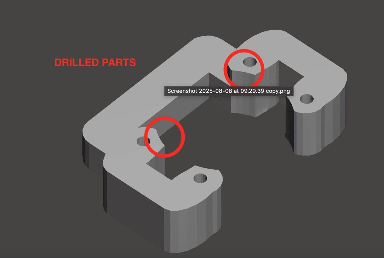

apologies if im being redundant, but what is the piece shown in the image? and where can I get the STL files, please.
ok, that clears up my confusion. thank you
and lastly, how do I know how much to "cut out" and raise the camera unit?

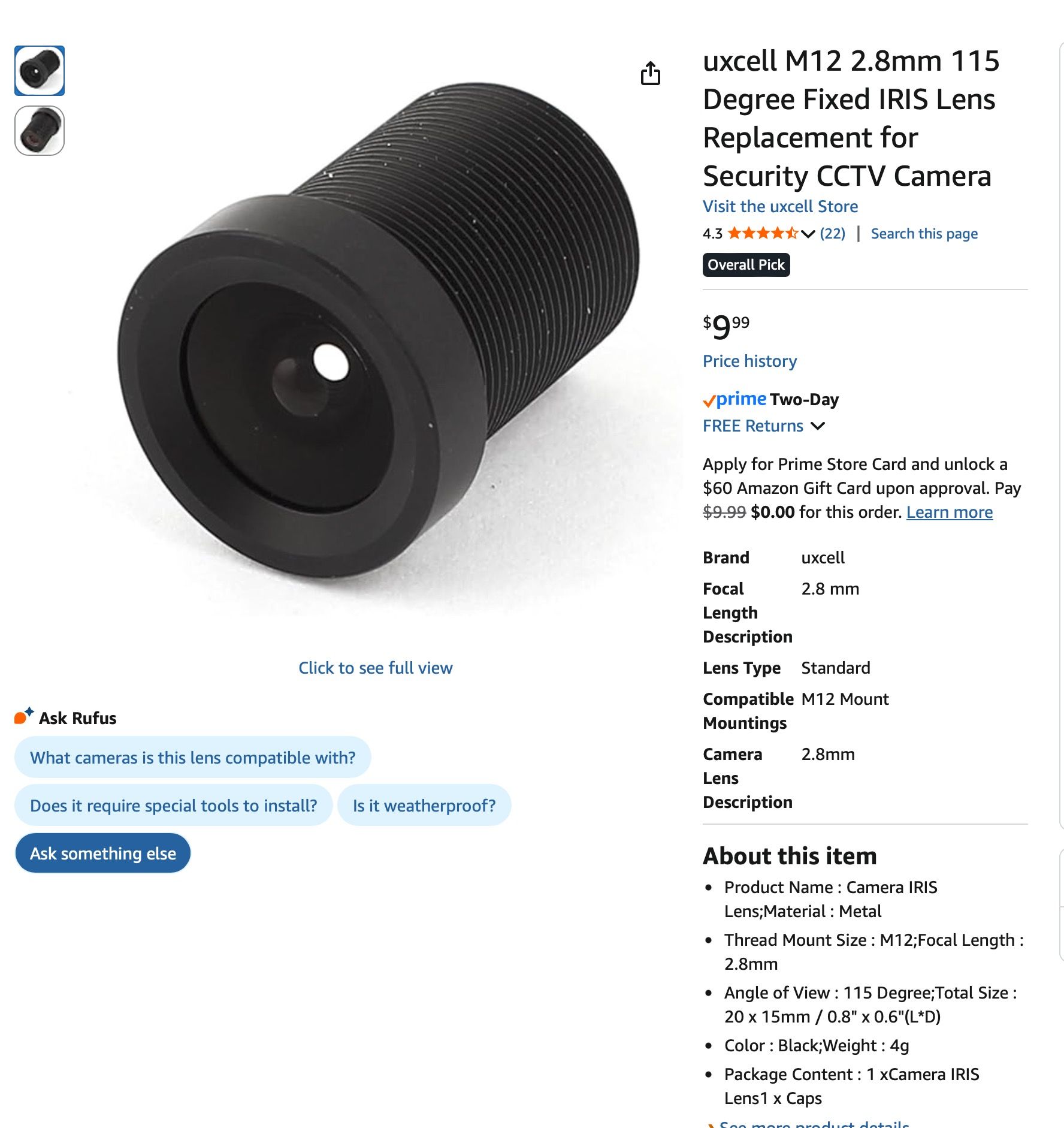

Ok, I just came across this M12 12mm 2.8 lens on AMAZON for $9.99!!! (Please tell me, that, IT MIGHT work.
For $9.99 I've got nothing to loose, right?
It will not. Only the AZURE-1228MAC 2/3" 12mm F2.8. The lenses need to be designed as a macro.
