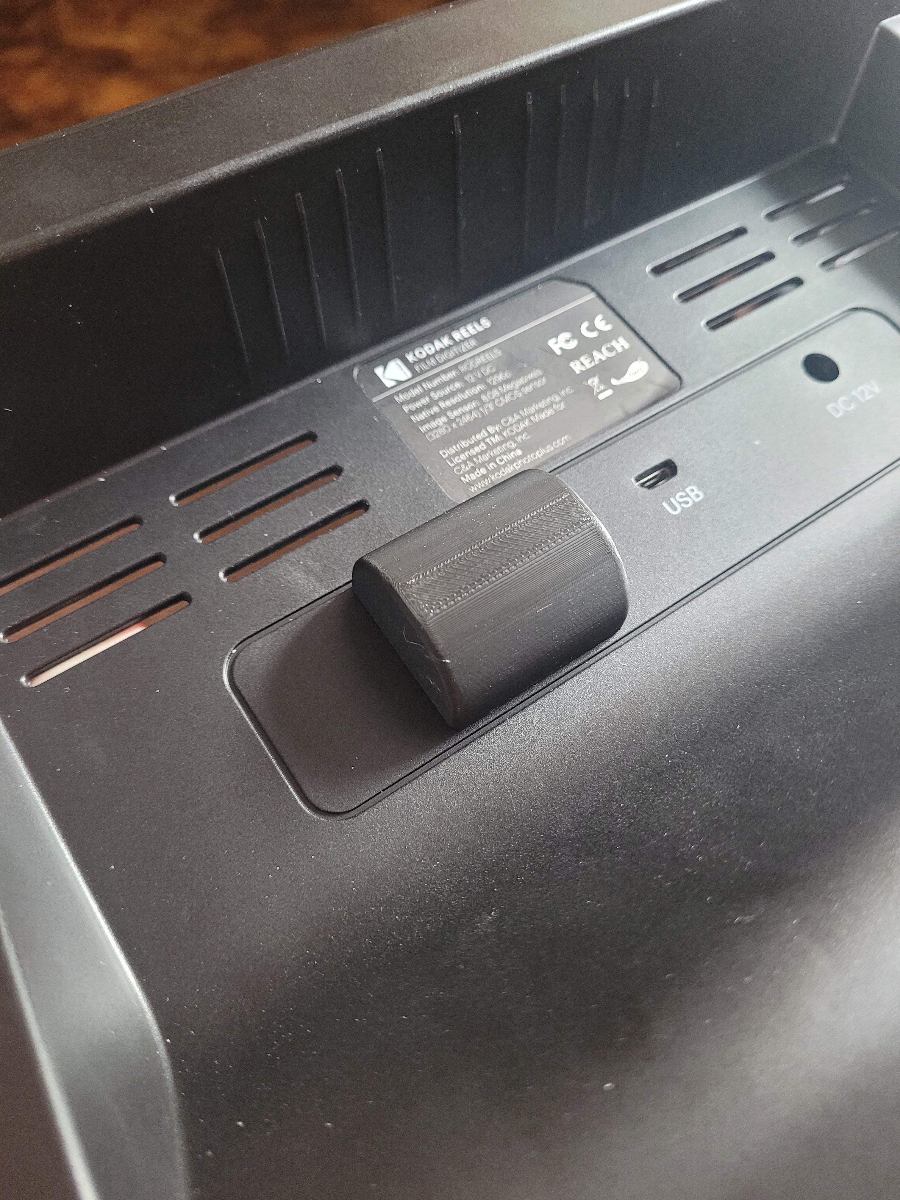

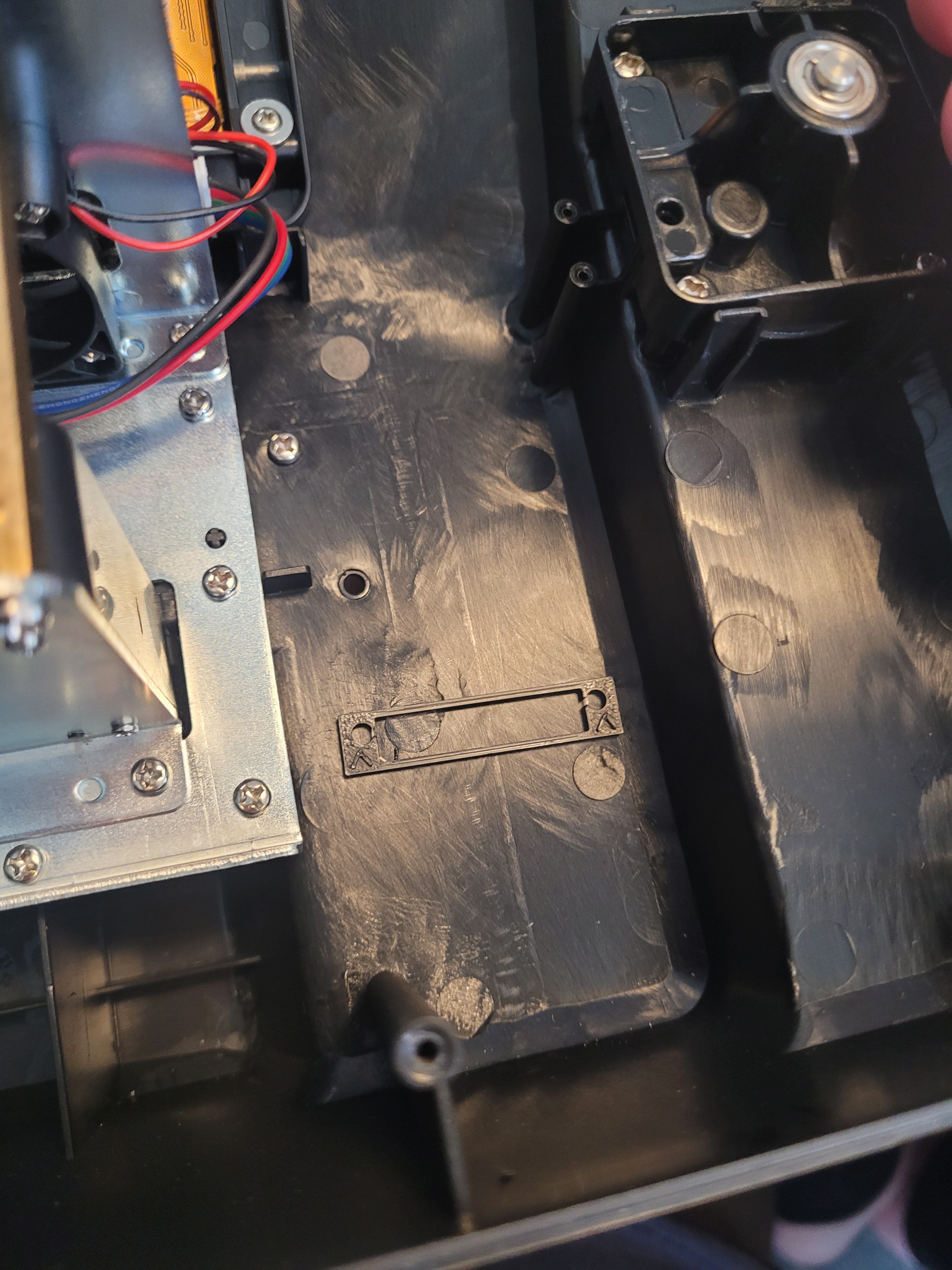

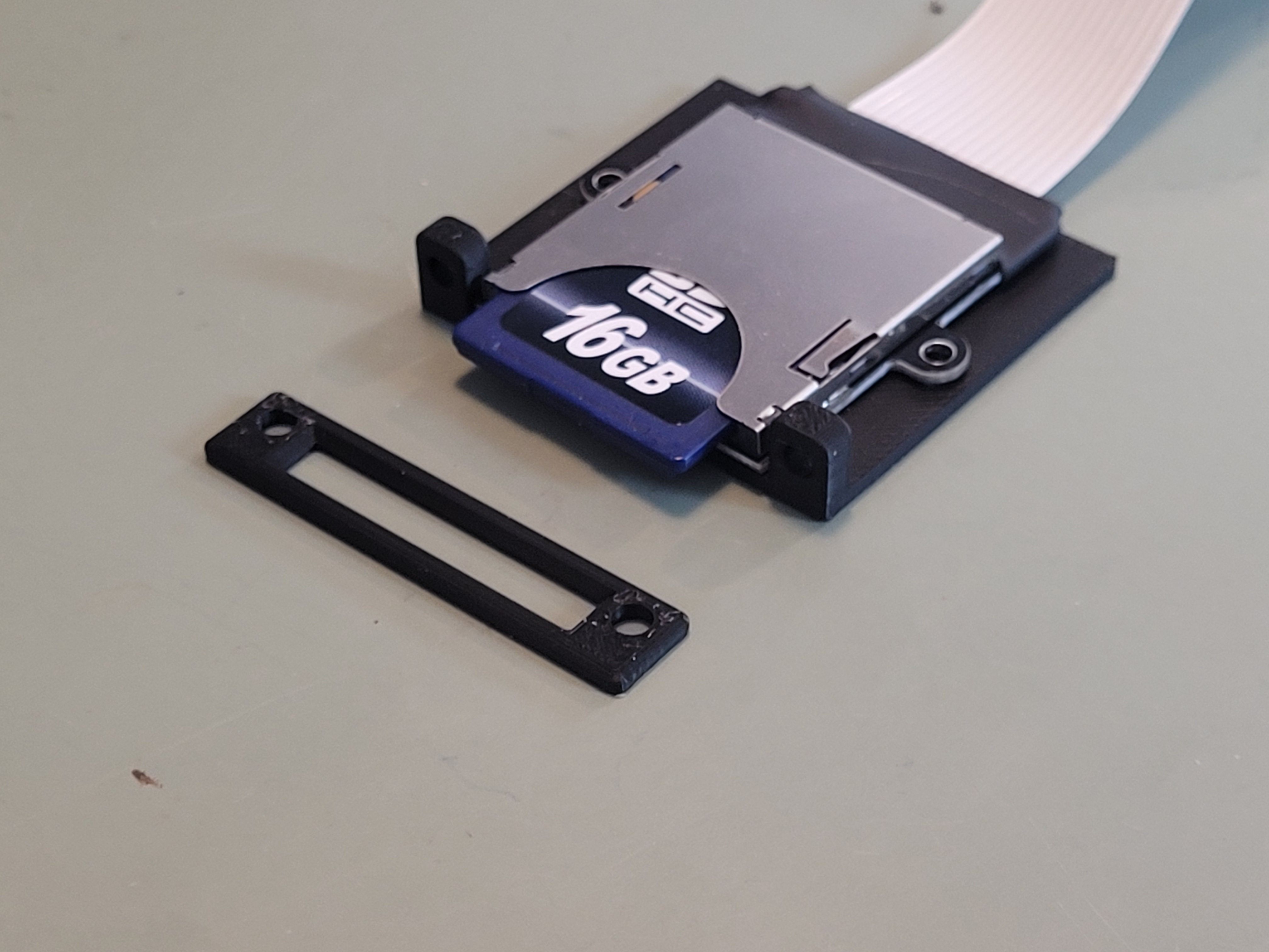

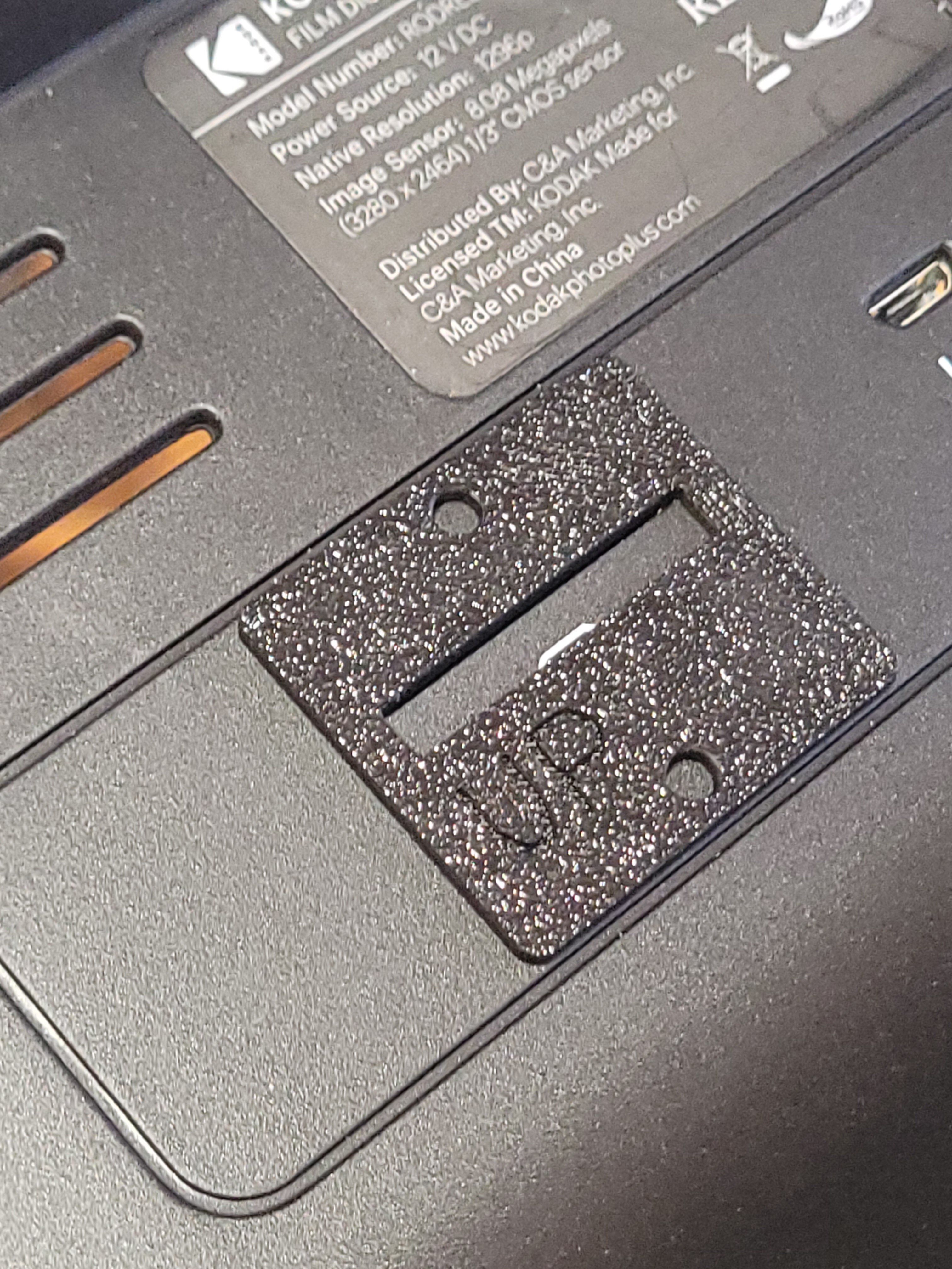

6. I'm out of time but I am still working on my plan to integrate the relocated SD card slot using the extension ribbon cable and the bare housing with ears. The idea is you will cut the existing SD external slot a little larger to enable looping the ribbon back inside the case then reroute the cable internally to where you want the new SD slot. There is a template you print and put on the rear to first guide you in cutting the larger hole and then in drilling the holes for the screws. The cover mounts to the outside to protect the exposed ribbon/card and screws from the inside with two #4 x 1/2" or similar sheet metal screws. Where the new SD card slot mounts is up to you, but there is also a drill template you put on the cover, drill two holes and cut a slot, then you will sandwich the case with a faceplate outside the case and the bracket/new card holder inside. This bracket uses two #4 x 1/2" or shorter sheet metal screws, pan head to mount to the body. The SD slot attaches to the bracket using the same M1.7 or similar screws used elsewhere for the lens mod. UPDATE 20260224 newer versions of the cover (deeper to accommodate 1/2" screws) and the SD board (better fit) have been added to this post and the originals removed. UPDATE 20260310 newer version of the new slot drill/cut template and faceplate. This version makes the new SD card slot easier to locate and more flush with the front of the unit. For the latest mod instructions see this post.
For the flex, drill template and slot cutter.
And cover installed. You'll have to install the cover, then put the extension in the SD slot before reassembling the unit.
To relocate the SD slot, find wherever you like then use the drill and slot cut template (look at front and back sides!):
Then assemble!
(This is the latest board mounting design)

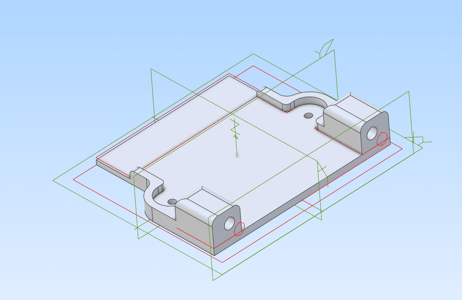

7. If anyone wants to do the nylon roller mod or similar I've attached a dimensioned drawing of the stock fixed posts. You have to open the case to unscrew them.

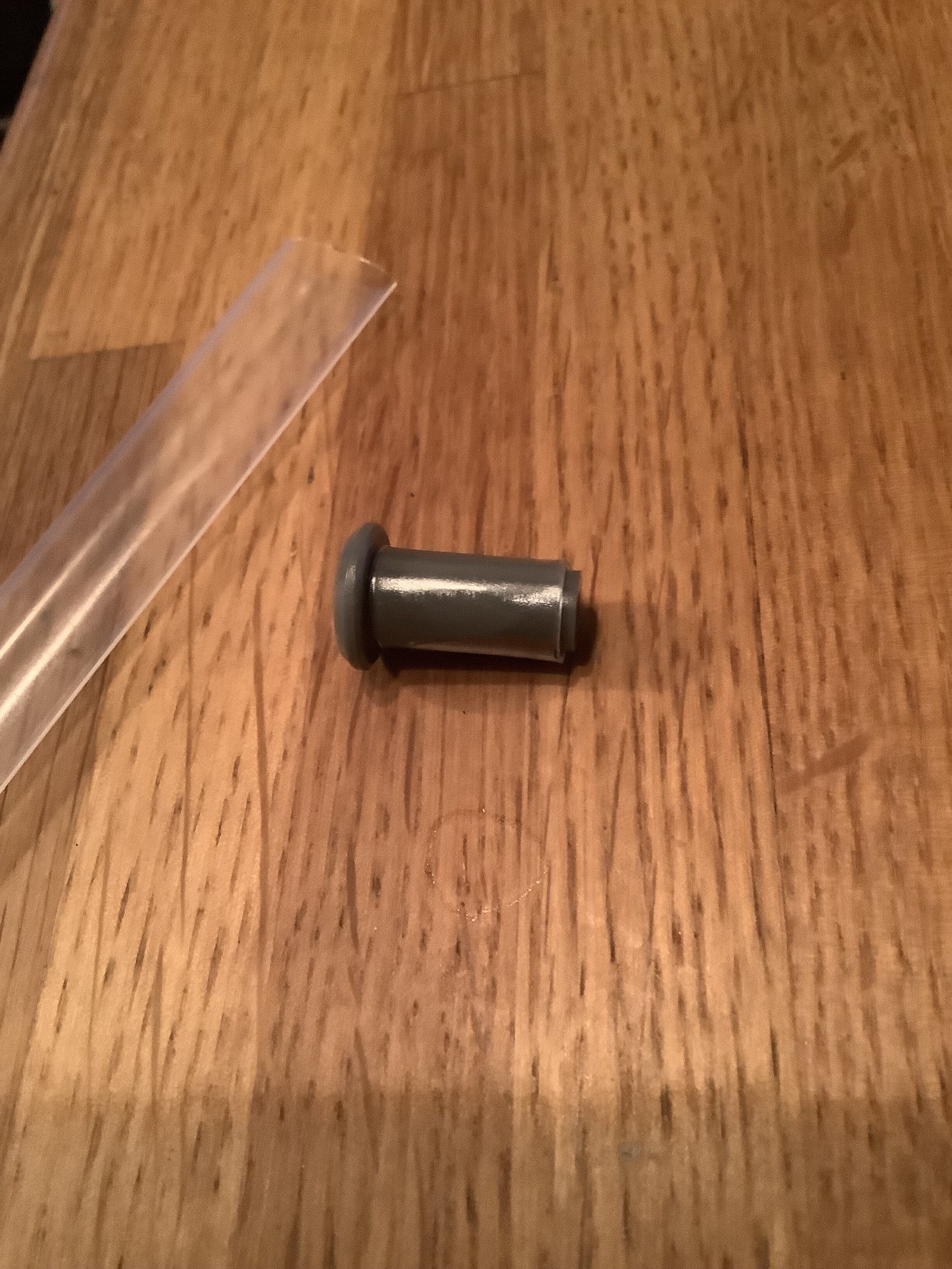

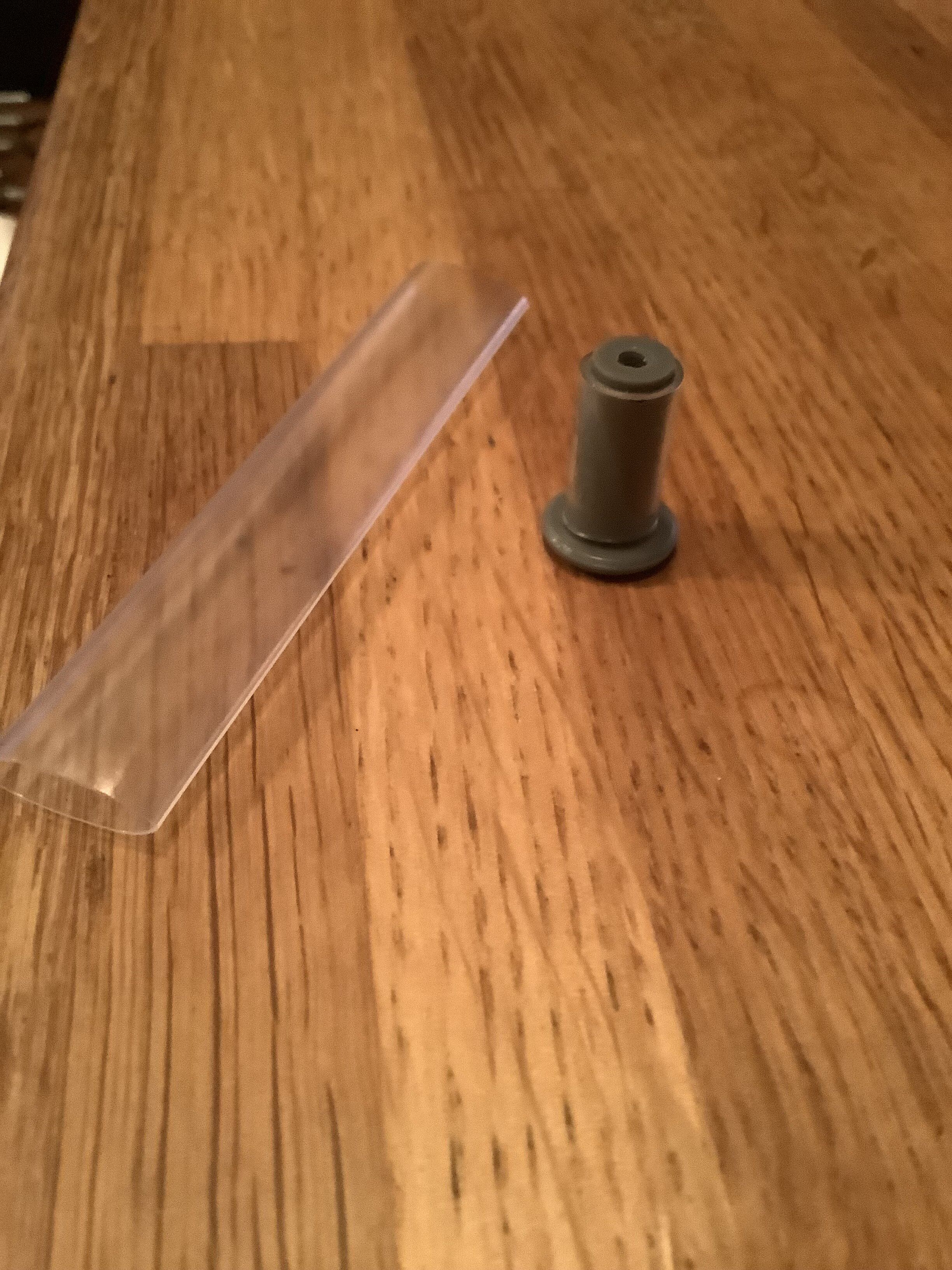

Do NOT try to eliminate the possibility that rollers give scratchmarks on the filmbase USING heat-shrinking tube. I did a test, se pictures, with transparent tube. The surface is unfortunately to soft and will give friction when the film is somewhat stretched. Maybe if one uses another heat-shrinking tube, like black.
All done to try finding an easy way to protect the filmbase☺️
brg
Claus

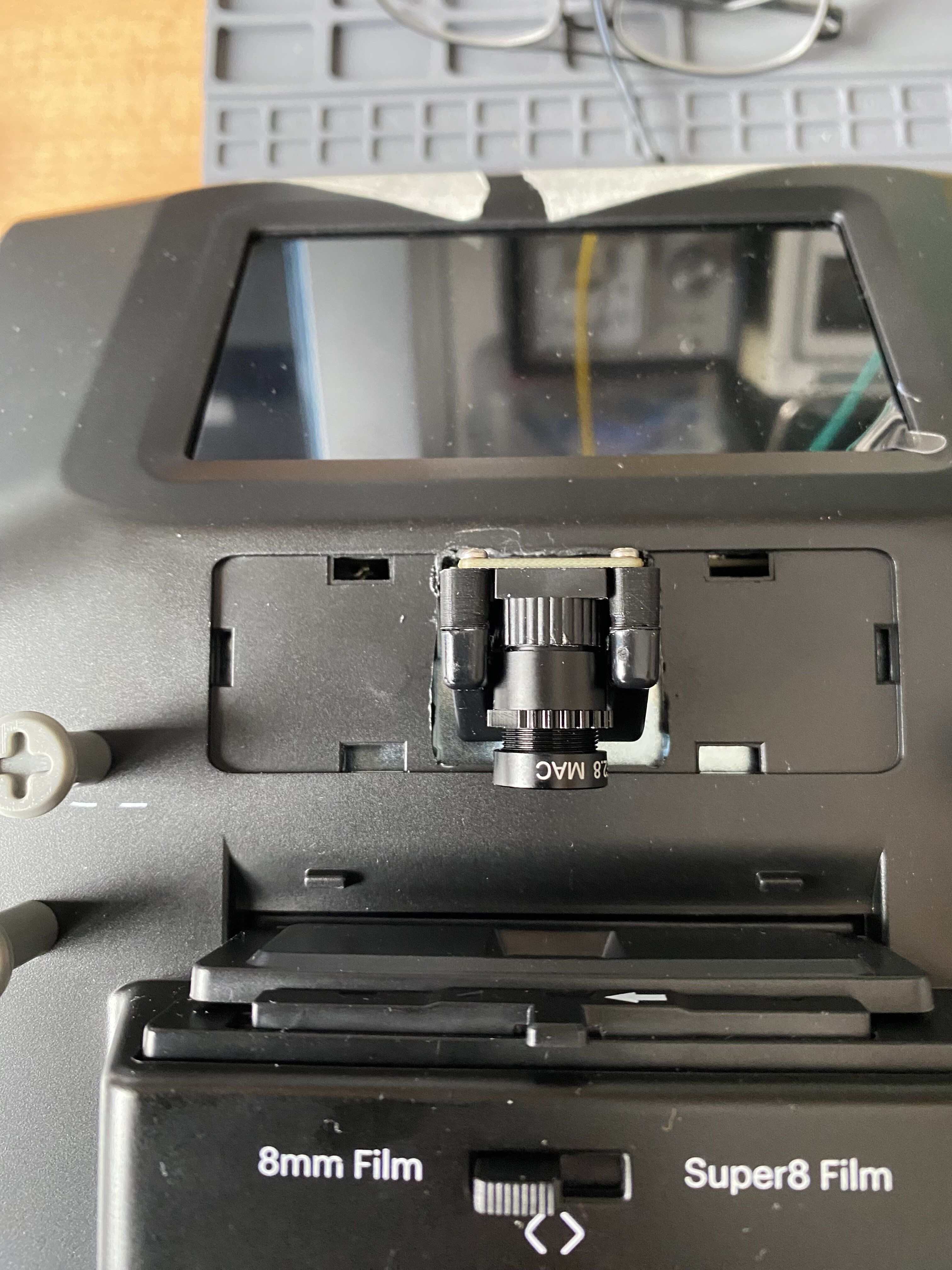

Hi Guys :).
I just modded my scanner with a 12 mm macro lens and used all help that I have got here on this forum, both with advise from You and the Manual and also STL-files for making the distance (7mm). After plugin the scanner to 12 V, I had to zoom out and also move the frame, but then I made a recording(y)(y)(y)(y). OK, I will have to adjust the white balans but when I compared the recording I made with the 8 mm lens, I see that it is a hugh differance. The original 8 mm lens gave a pixelated movie, but just by switching the lens to 12 mm macro, I got a great quality with much much less pixilation.
I have the version D, so I have not tried any firmware yet. Now I am ready if You want some testing. I have not connected any arduino to the board, so I will only be able to test functionality without any dumping of data.
I hope that there will come a firmware for version D, but until then, I will play with the scanner and just try the new 12 mm lens.
Brg
Claus

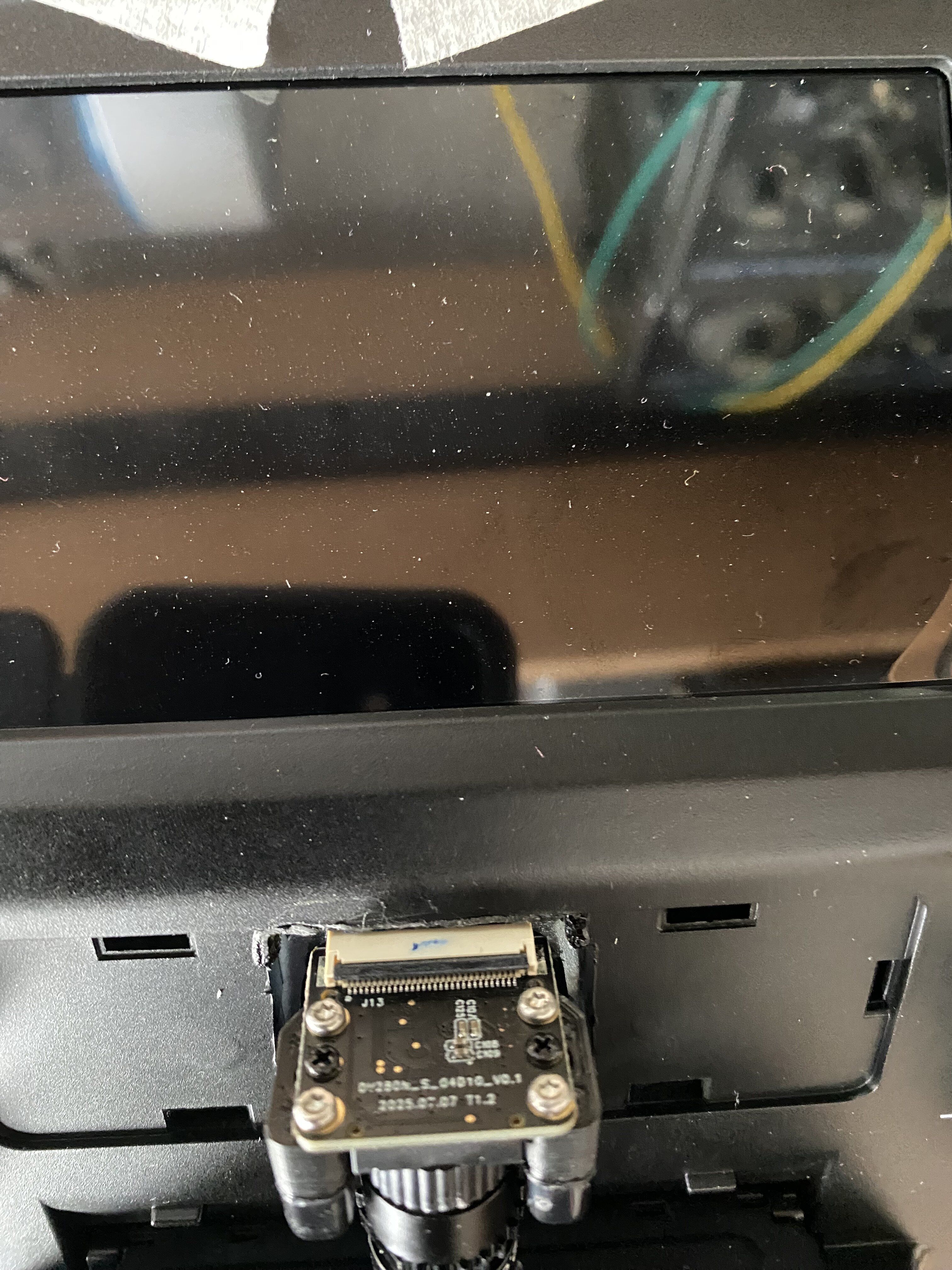

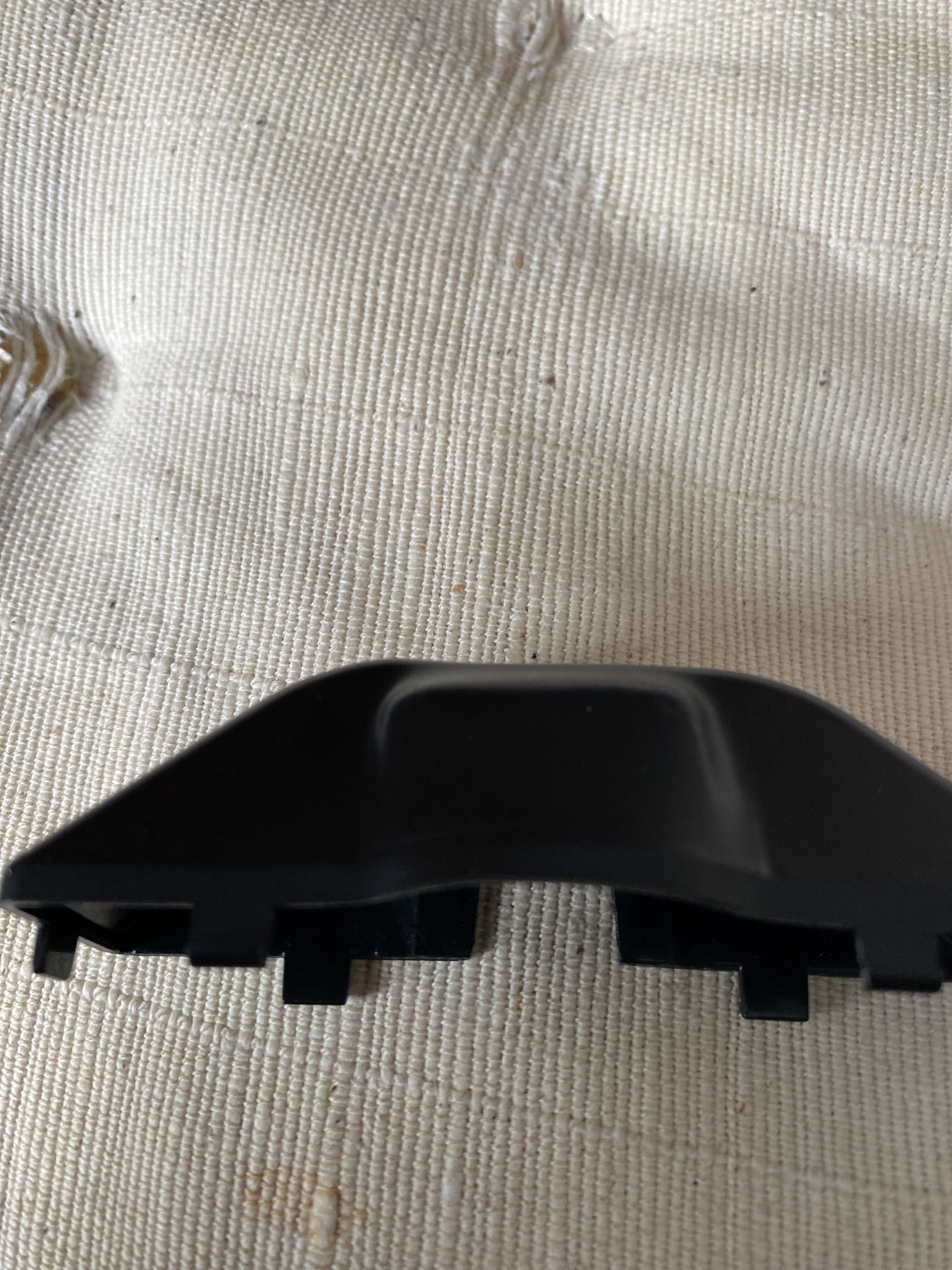

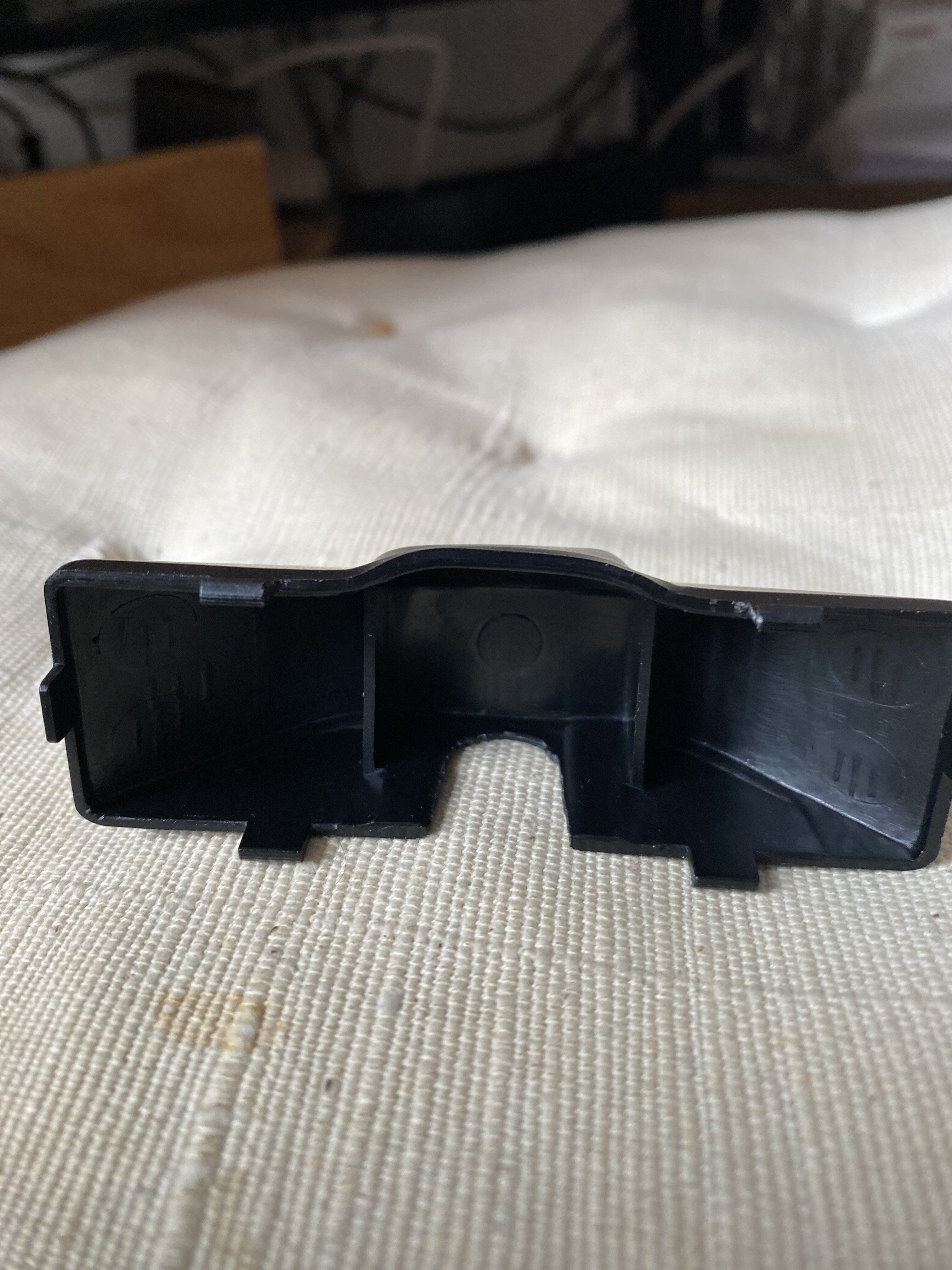

Modifying the covercap to the lens and sensor.
I have modified the thermoplastic cover, shown in the attached pictures. 160-170° Celsius with a hot air gun and then pressing with a wooden stick. It seems to work. And then a small strip of black electric tape to cover a small strip where the plastic cover has bend due to stress when working with hot air gun.
The plastic wall where the flat cabel goes, was enlarged with a soldergun.
brg
Claus

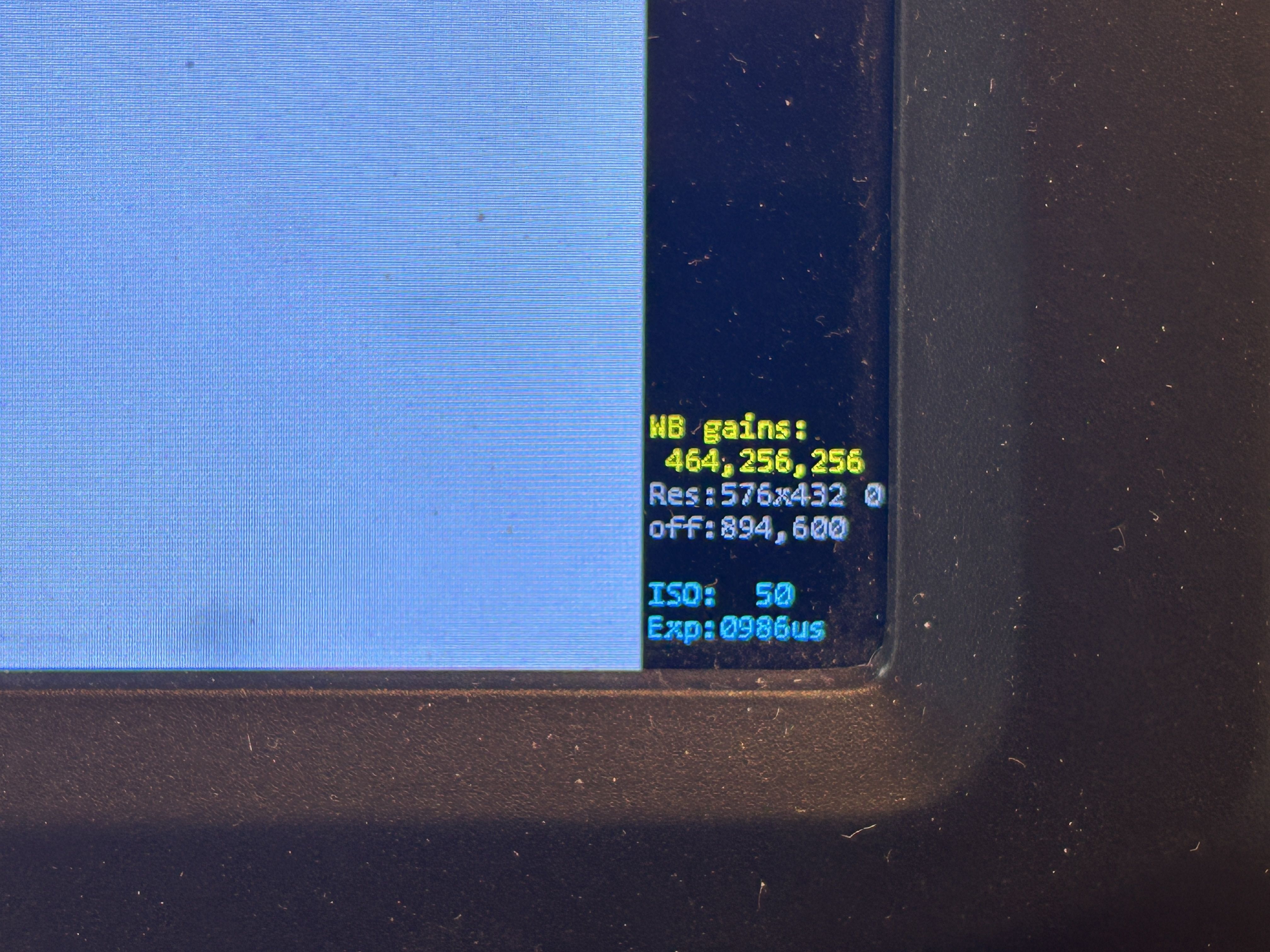

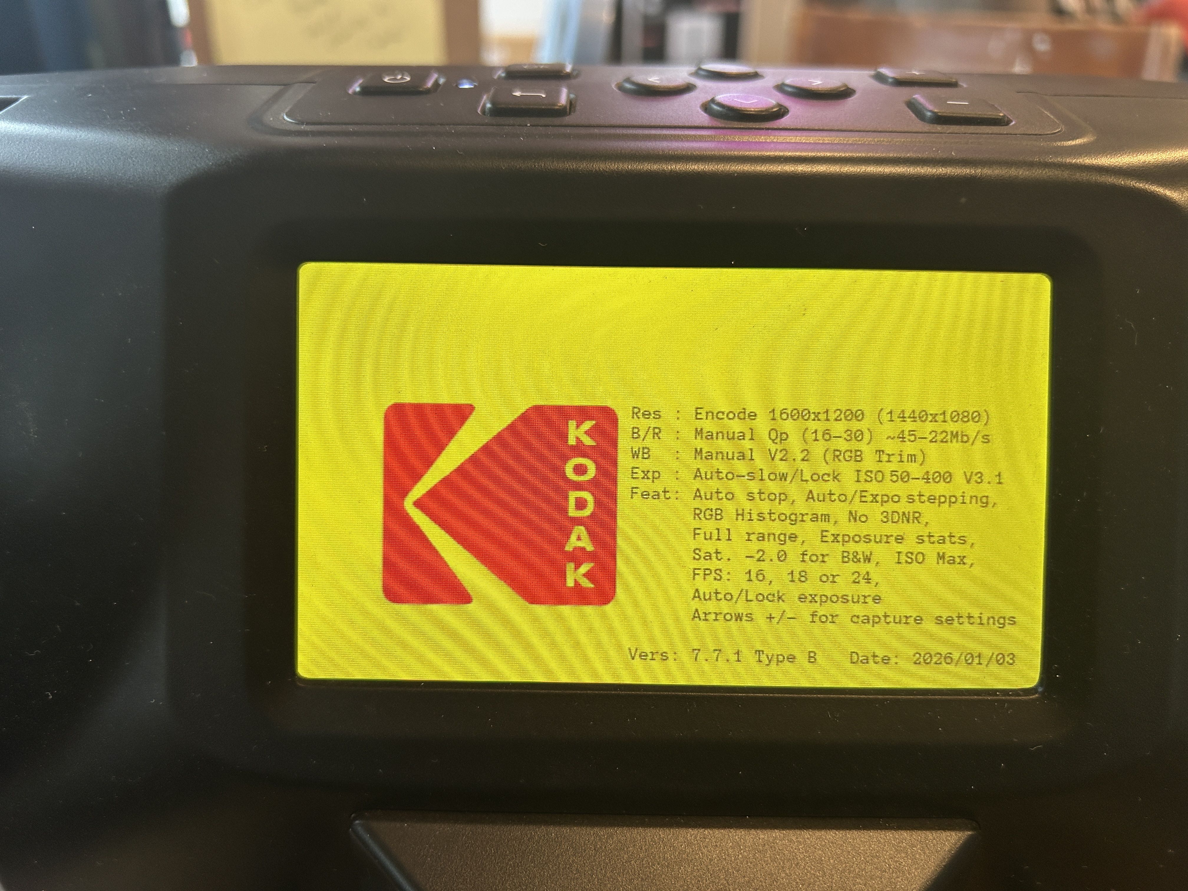

New member here! I've spent the last few hours scouring this thread looking for the answer to my question, but I could not find it for the life of me 😂
I have a Kodak Reels scanner with B Firmware. Just installed 0dan0's 7.7.1 firmware, and everything went great. HOWEVER I'm afraid that I'm missing a setting somewhere?
I figured out how to adjust the Qp value to minimize compression, but my "Res" setting during the preview window still shows 576x432. Looking at some of the screenshots from 0dan0 (and others), I see a much higher resolution (1440x1080).
Is there a setting somewhere that I haven't changed? This updated firmware is the only change I"ve made to my stock scanner so far.

Back in firmware update v7.6, 0dan0 added that resolution readout on the preview window to reference the "active" sensor resolution. The way I understand it is that when you use your in-menu frame controls to digitally zoom in or out, you are affectively using more or less of the sensor's pixels. Whatever the sensor uses then gets enlarged to 1600x1200 for encoding.
If you use the frame controls to Zoom all the way out, you should see a higher resolution readout on that preview window. If you don't, it would be helpful to document this (with a video showing the all-the-way zoomed out image, and whether you toggled to 8mm or Super 8) and see if you found a bug (earlier versions did need a power cycle after flashing the firmware to ensure the framing controls functioned properly).
I could be wrong, but I think 1440x1080 is the maximum active sensor resolution that is realistic to achieve when capturing a frame (probably S8).

@0dan0 and @ThePhage Thanks for the quick reply! I understand now what's going on with that number. I just tried zooming in and out in the preview mode, and the resolution number changed as you described.
I saw those posts today, about the hardware hack of installing a 12mm lens with all of the correct couplers. I'll be ordering those parts tonight. I'm very thankful that I found these improvements...but not thrilled that I need to go rescan a box of reels from my Dad's childhood 😂
