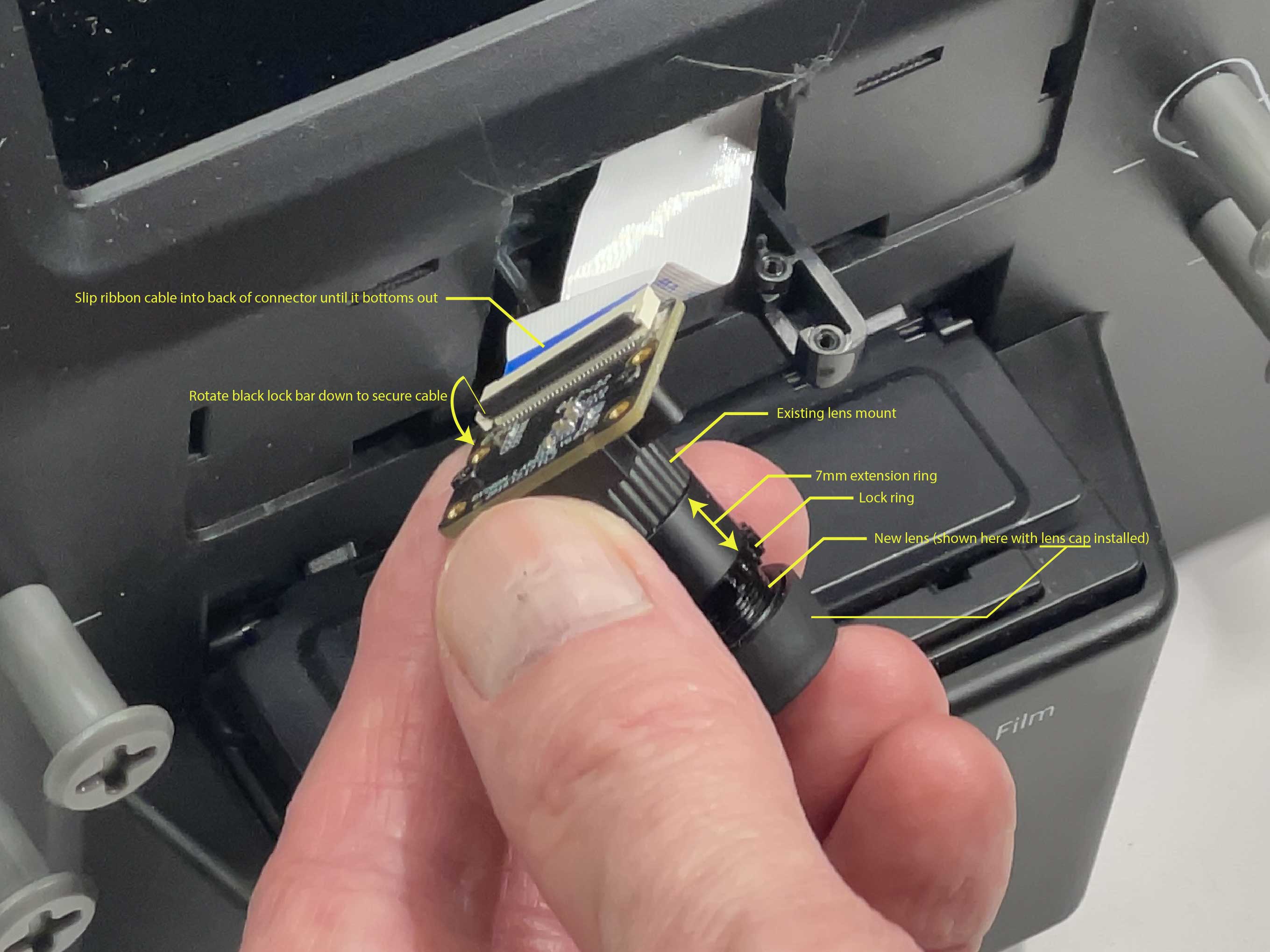

Installing new lens (https://www.rmaelectronics.com/azure-photonics-azure-1228mac/), 7mm extension ring (https://www.m12lenses.com/7mm-Metal-Extension-Ring-for-M12-Mount-p/pt-erm12-700m.htm), and lock ring (https://www.m12lenses.com/M12x0-5-Lock-Ring-CNC-Machined-Aluminum-p/pt-lrm12-2.0m.htm) onto the image board-
I don't have specific photos showing the installation of these components onto the image board, but it's relatively simple. First screw the 7mm extension ring onto the existing plastic lens mount. Be carful screwing it in. the metal threads of the extension ring can easily strip the plastic threads of the lens mount. Next screw the lock ring onto the lens, then screw that assembly onto the installed extension ring.
Re-attach ribbon cable to the image board

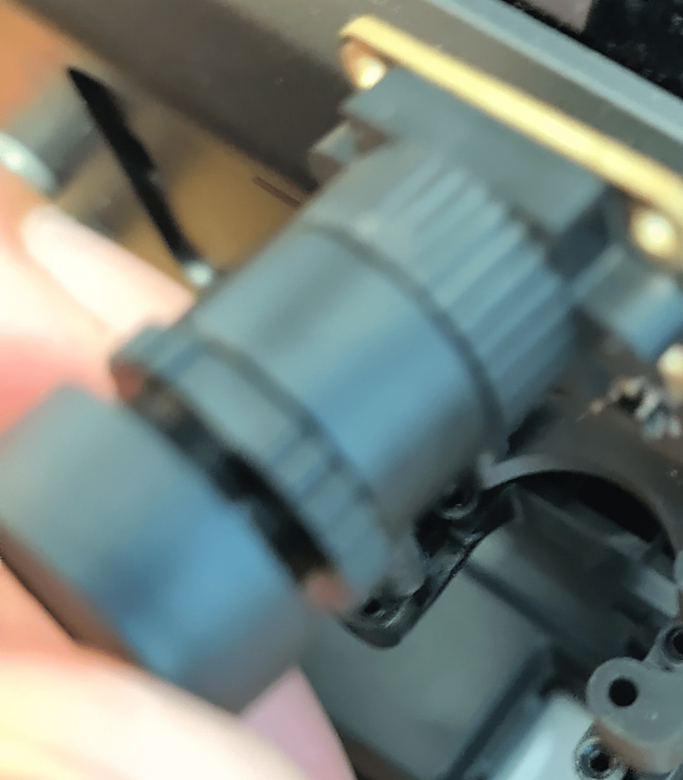

Has anyone else also tried this method with the original lens mount? And did you have to use force?
Pic is how far I can go before I need to use force

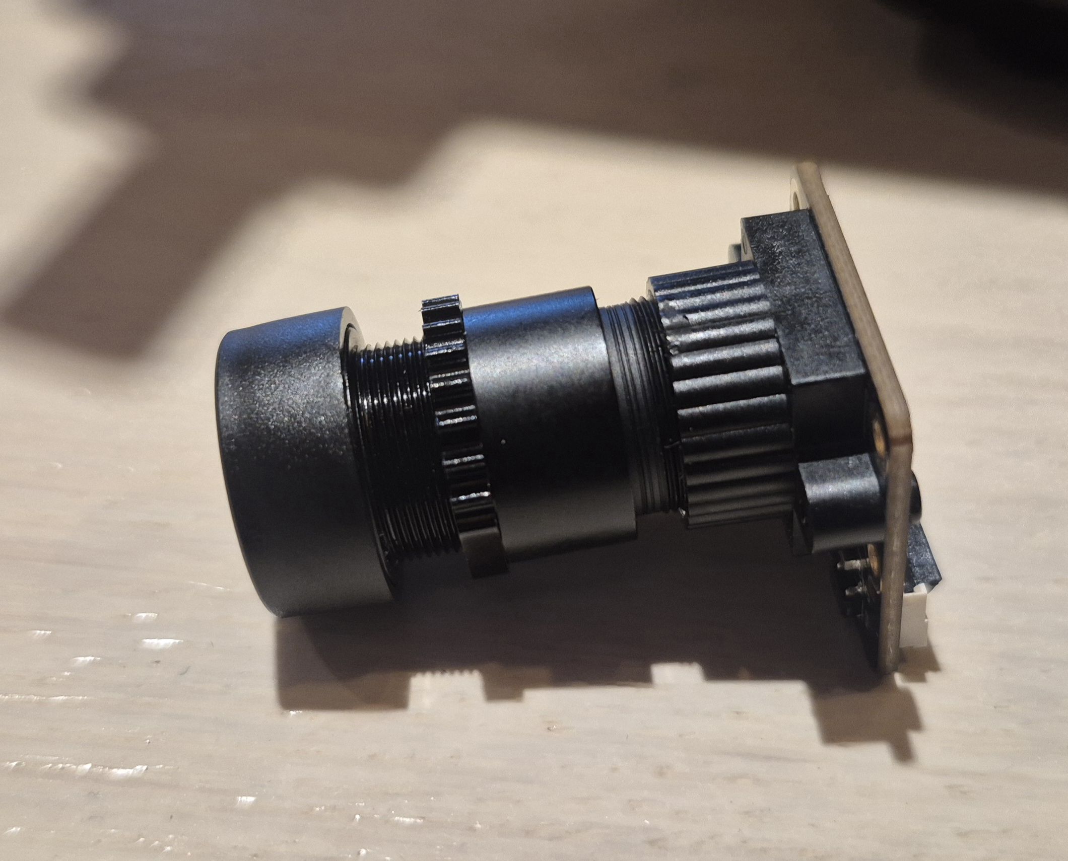

Mine is in more. One image out of focus, sorry.
What I did: remove the new lens and lock ring. Take the prolongation and the original female socket. Take grip gloves. I really don't know the English word. They would translate to Farmer's Gloves if I apply my mother tongue here. And then force it.
For me it caused plastic shavings. But I was able to blow them off the sensor surface just fine with a bellows.
After that, you can re-attache the lens and lock ring.
Thanks alot, I got it working 😁
I had to use alot of force and there was some shavings I had to remove after. It was also really tricky to get the extension ring to enter the threads correctly. It was very easy to get it crooked, but I managed to get it straight after alot of fiddling.

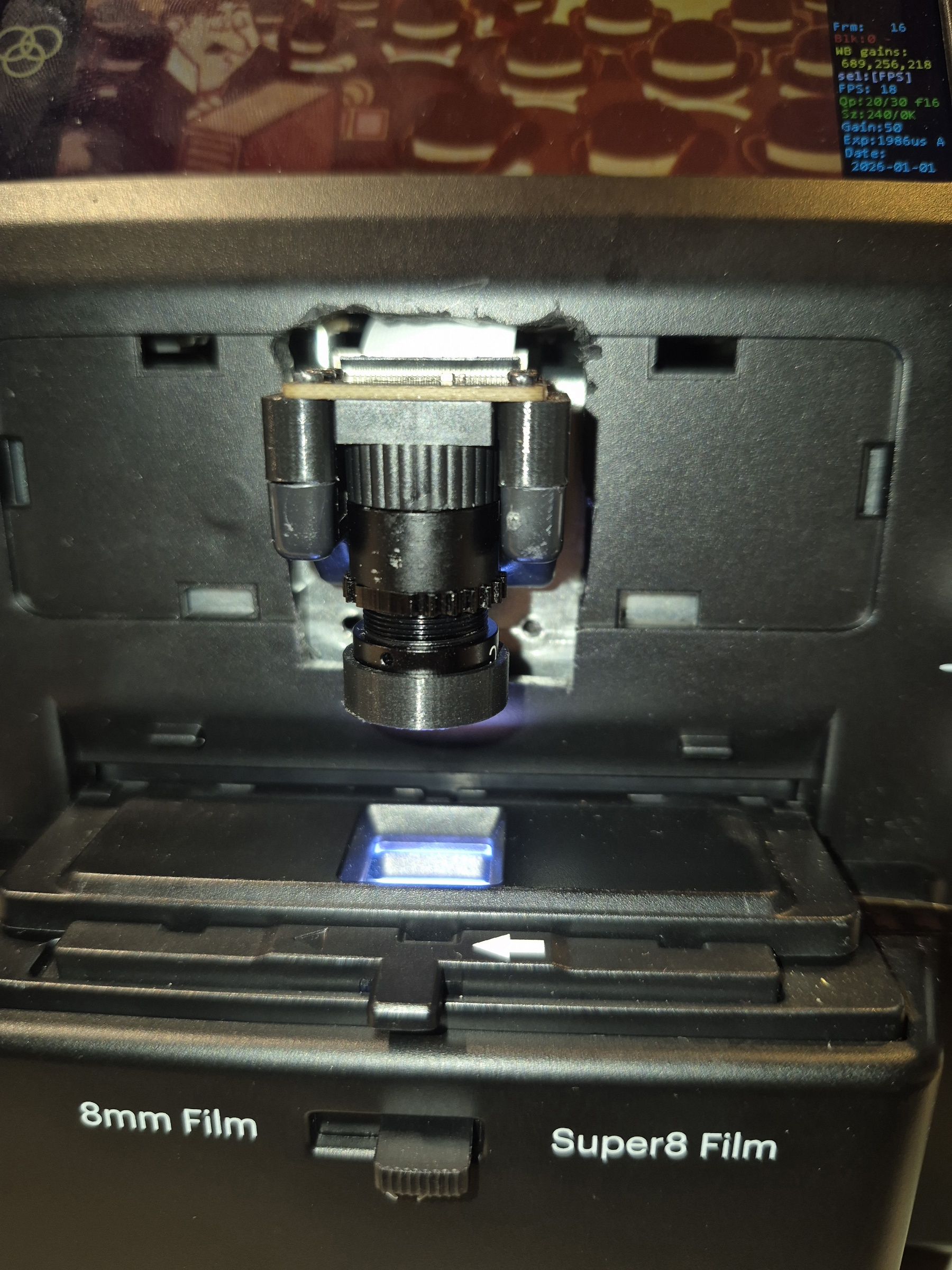

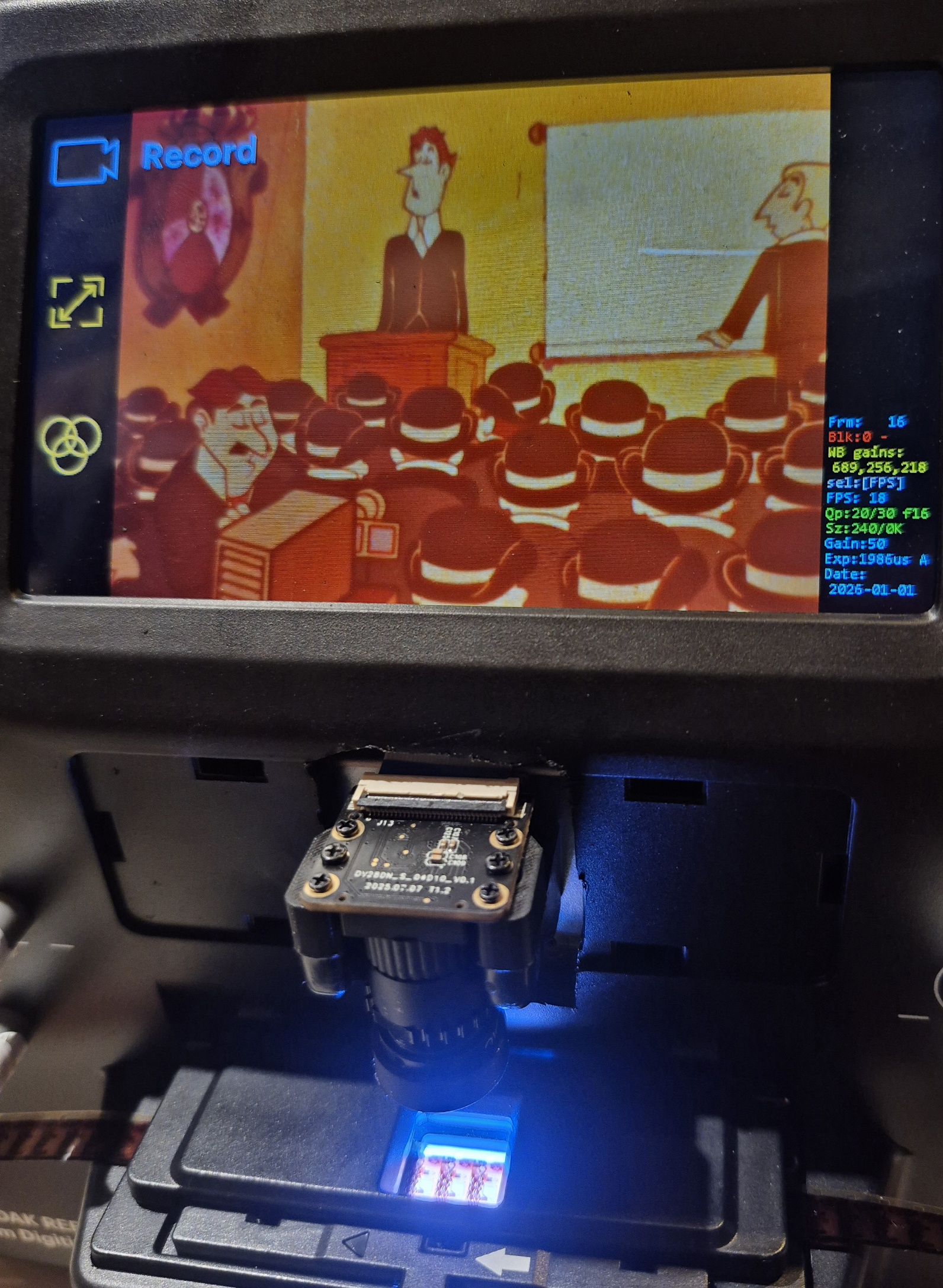

I've got the machine back together again. But I can't get the full frame in the picture. I can move the frame from side to side and up and down. But not more out. Not sure if this is a D-version quirk?
@melw is there some way to hack the camera to zoom all the way out? Or should I look for a bigger riser? I used the 7mm version in post #199 by Deano.
[...] Or should I look for a bigger riser? I used the 7mm version in post #199 by Deano.
I have that issue too, but I accepted it, because it's part of the secret sauce. Being zoomed out fully makes it such that you use the full sensor surface for the scanner and such that you have the best possible resolution for the setup. But yes, depending on what you scan, it's sad that the frame is a bit cropped, especially towards the top and bottom.

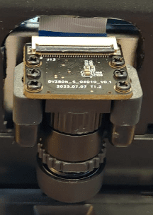

@Deano in post #199 you mention 8 and 9 mm versions of your riser. Would you mind sharing the step files of those by any chance? 😚
