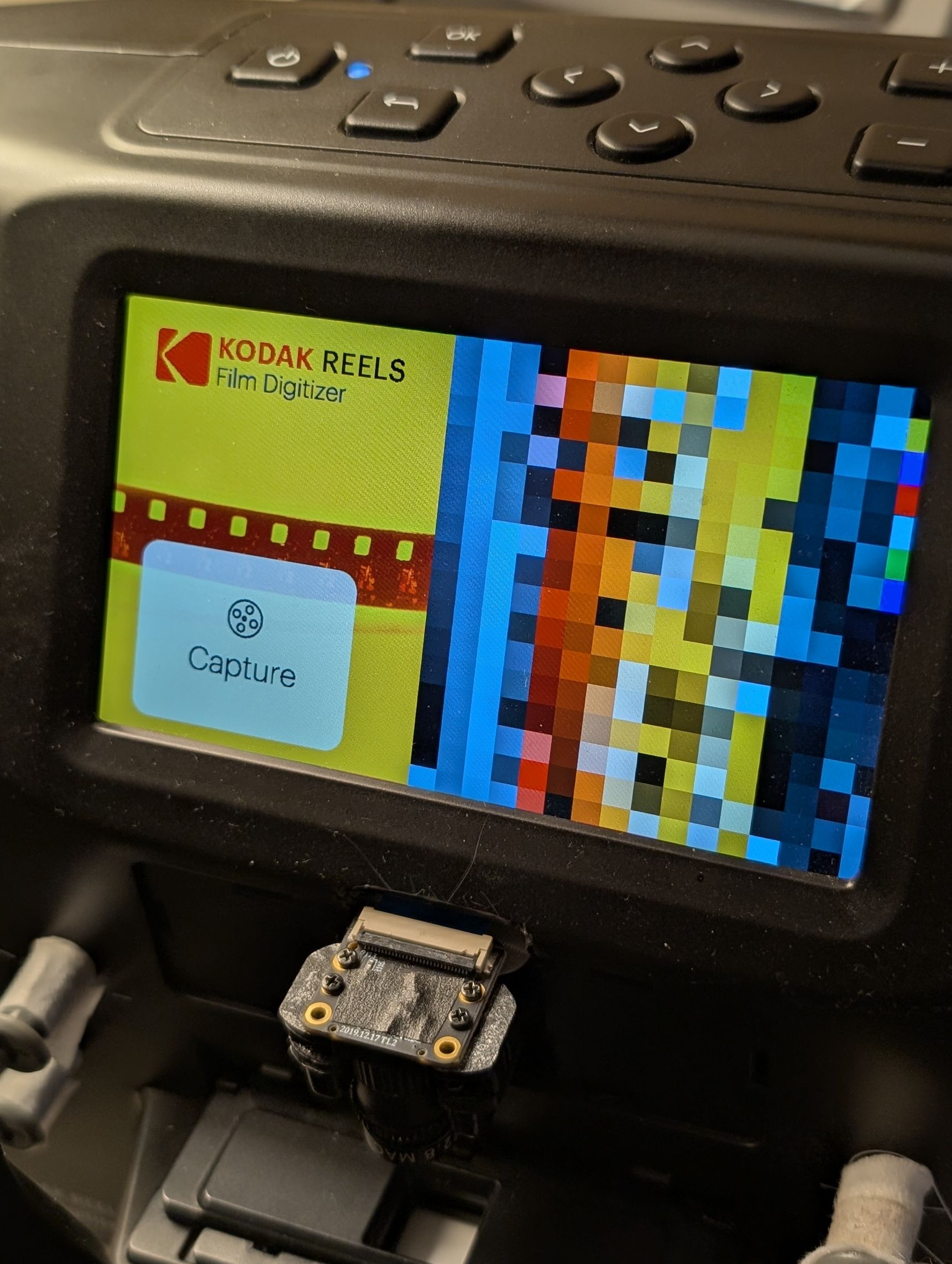

Trying to install various firmware versions I have found in this thread have failed to work on my device. I also am unable to find a default firmware that will restore the device. Any ideas?
FWIW, S/N: H2825148BK00161
It was not recognized by the lookup tool so suggested version B.
A and C give me a messed up display when the machine powers up to the Home Screen.
B looks good (the Home Screen), but the buttons do not function.
Thanks!
Do the buttons work with type A or C? If this is a new configuration, it would nice to see what it shares with other configurations.

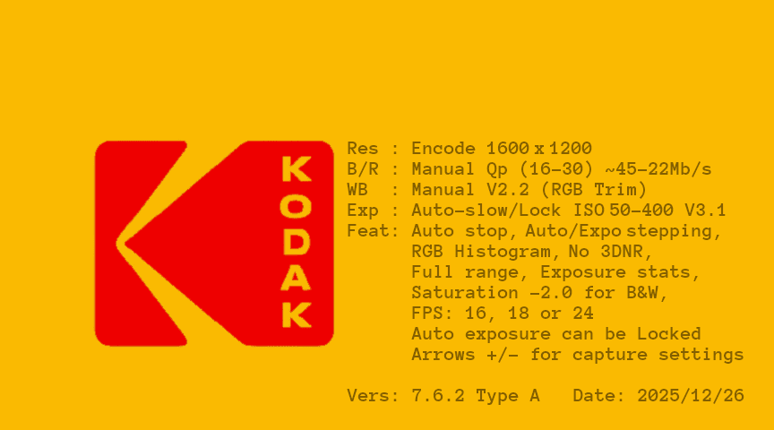

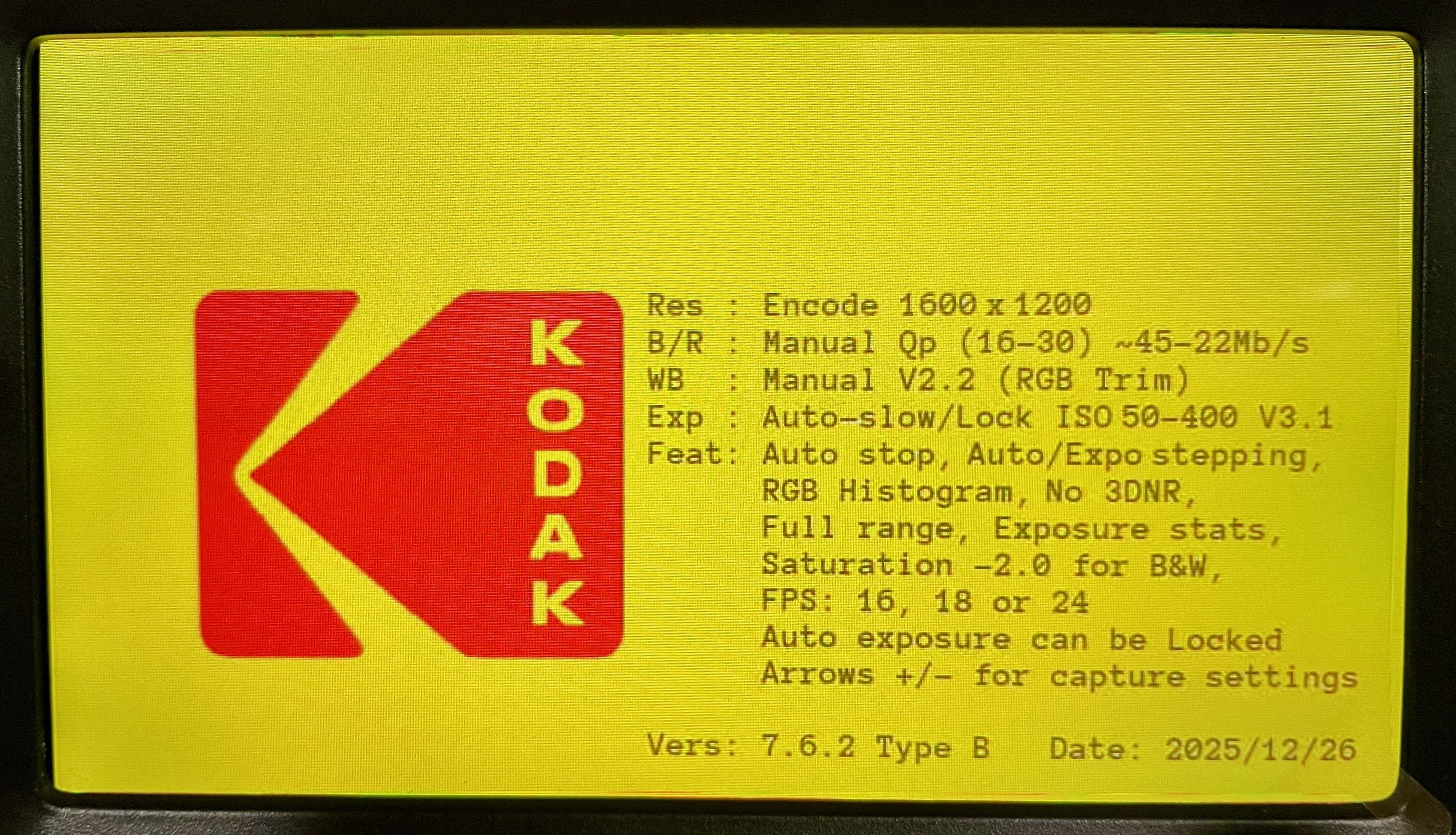

Here is v7.6.2, this has two bug fixes. First that the reframing wouldn't work immediately after the update, and the second that reframing was bizarre after capturing, if you used the arrow navigation controls. These both had the same root cause.
All the code changes are on https://github.com/0dan0/4reels

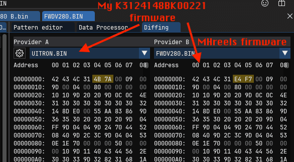

I just opened my K3124148BK00221 unit and dumped the firmware. It seems to be nearly identical (except for a minor change) as @MHreels posted (SN: H2324148BK...). The only difference is on the very first address line.

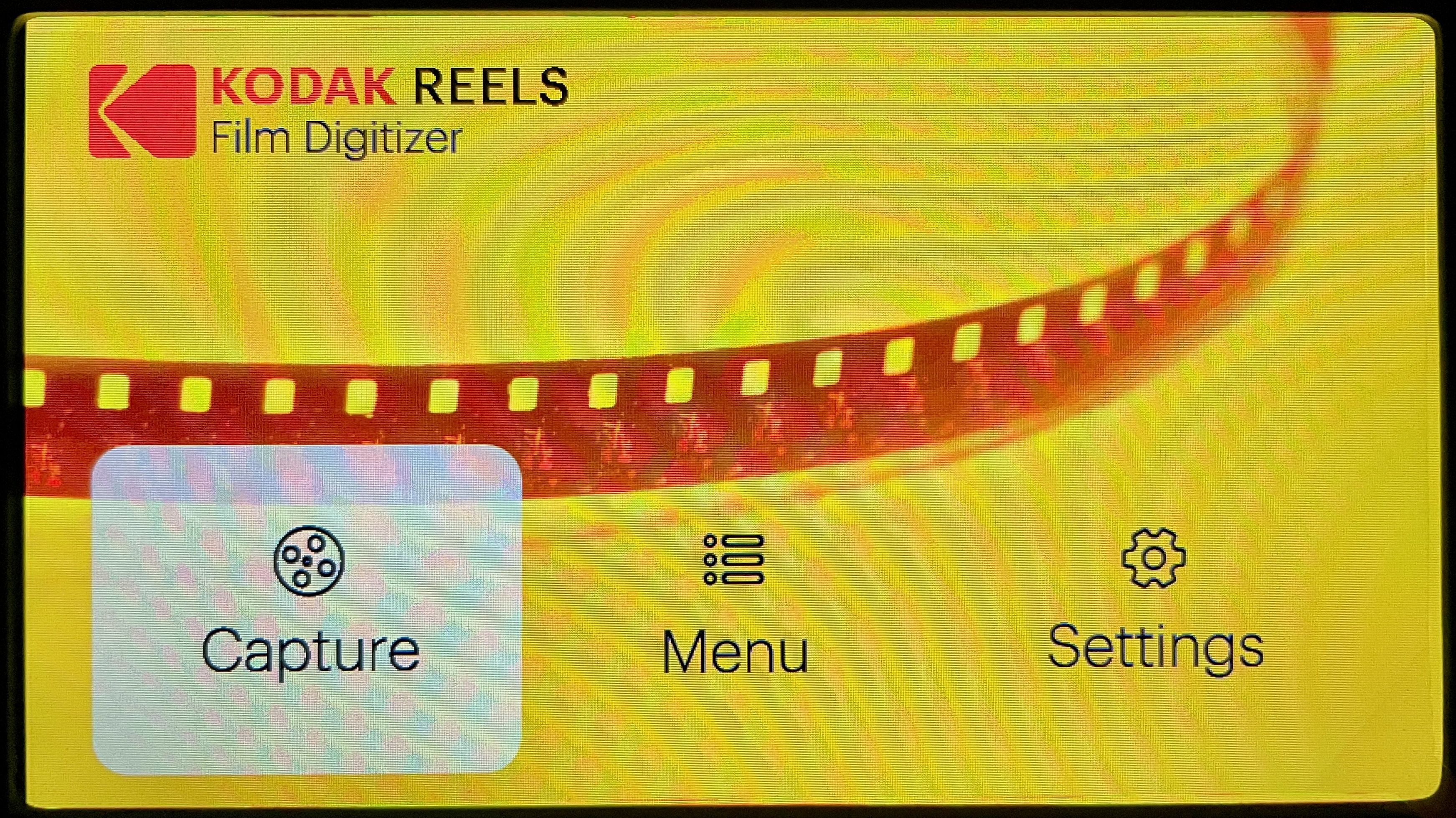

I tested your "D" test version and did not see a "color palette test". In fact it booted to a normal looking Home Screen—non-functional buttons.
Is there a way to enable the color palette test? Or ought it have kicked off itself?
Attached is the (brief) info screen before the Home Screen and the final Home Screen (buttons do not work):
This suggests the unit is crashing, it is not the buttons aren't working. Return it. The manufacture can easily refurb the units, and would have this issue if A) they didn't do a sloppy design, and B) they would provide users installable firmware.
