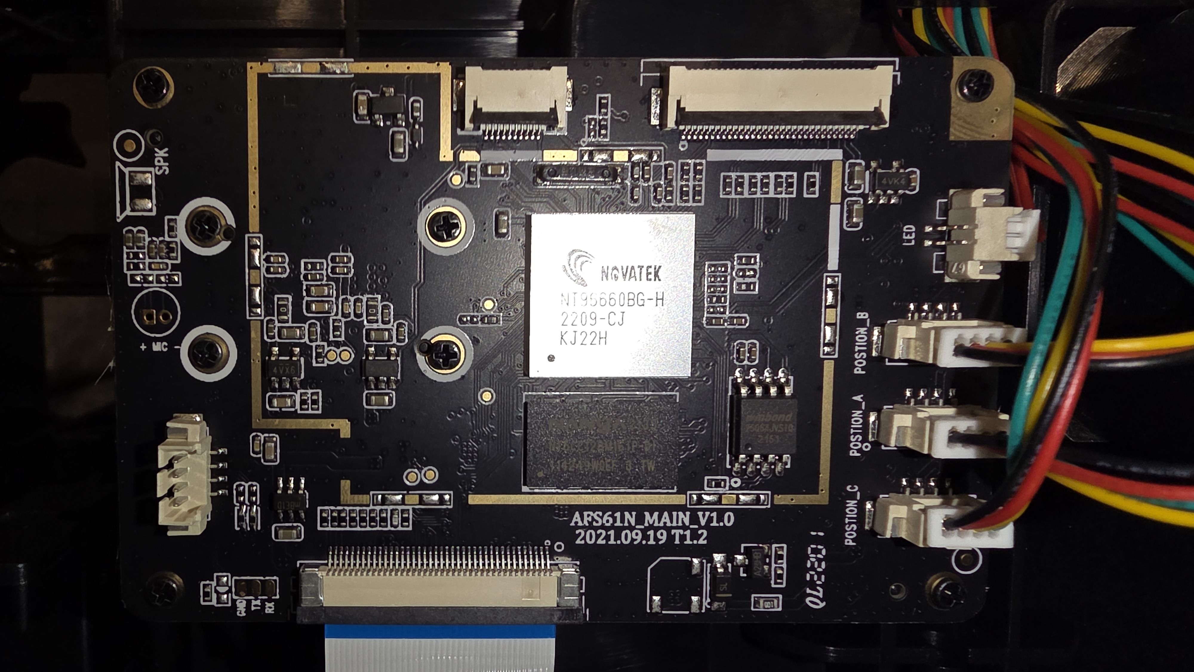

1. Hardware
  • Main board AFS61N_MAIN_V1.0 (2021.09.19)
  • SoC Novatek NT96660BG-H (MIPS, same family as the Kodak Reels' NT96658)
  • Flash Winbond 25Q64JVSIQ: 8 MB SPI NOR, the wide 208-mil SOIC-8 package
  • RAM: NANYA DDR3, 2 Gbit
  • Unpopulated GND / TX / RX UART pads (flat SMD pads, not tried yet), plus empty speaker/mic footprints (the board looks like a cut-down camera design)
  • Three slide-position sensor connectors (POSITION_A/B/C), stepper motor, LED light board
  • Sensor: 16 MP. The "16M" menu setting is the native 4920×3280. "24M" (6000×4000) is upscaled from it.

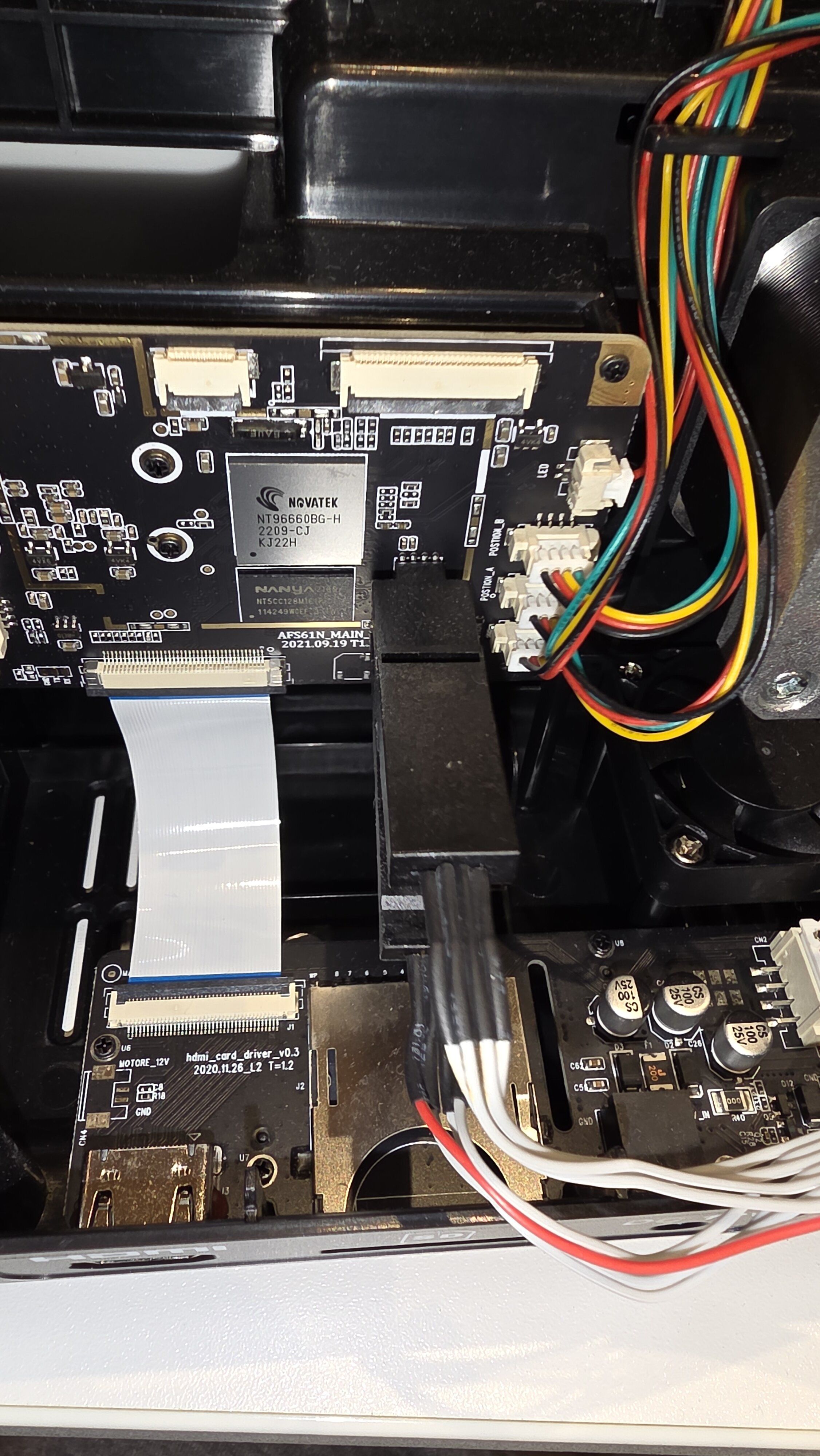

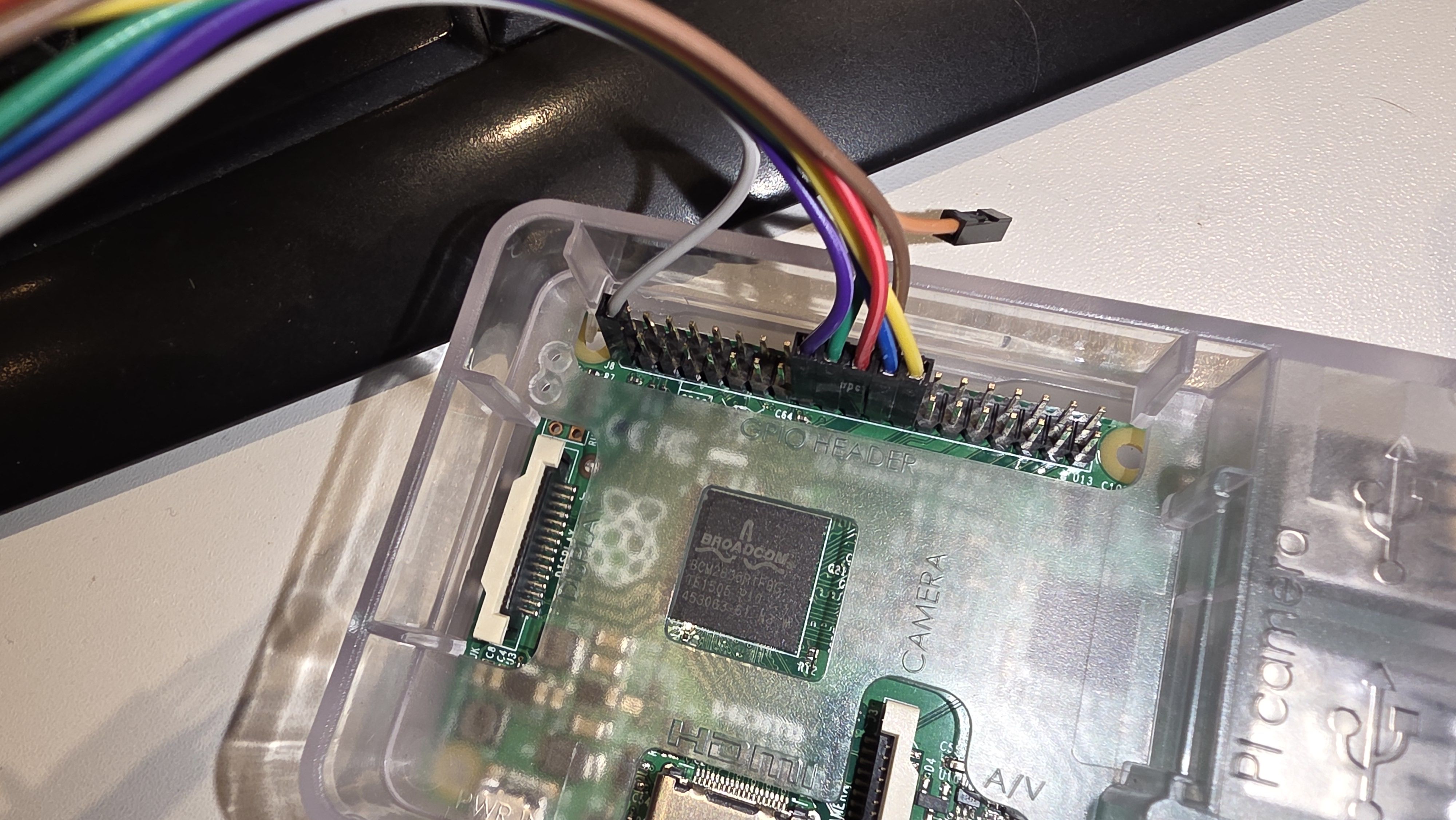

2. Dumping the flash (no soldering)
I read the 8 MB chip in-circuit with an SOIC-8 test clip + a Raspberry Pi 2 + flashrom (scanner unplugged; the Pi's 3.3 V powers the chip):
  • Wiring (flash pin → Pi header pin): 1 CS → 24, 2 DO → 21, 3 WP → not connected, 4 GND → 25, 5 DI → 19, 6 CLK → 23, 7 HOLD → 17 (3.3 V), 8 VCC → 1 (3.3 V)
  • flashrom -p linux_spi:dev=/dev/spidev0.0,spispeed=500 -c W25Q64JV-.Q -r dump.bin.

Attaching a few pictures of the board and from the flash dumping process.
