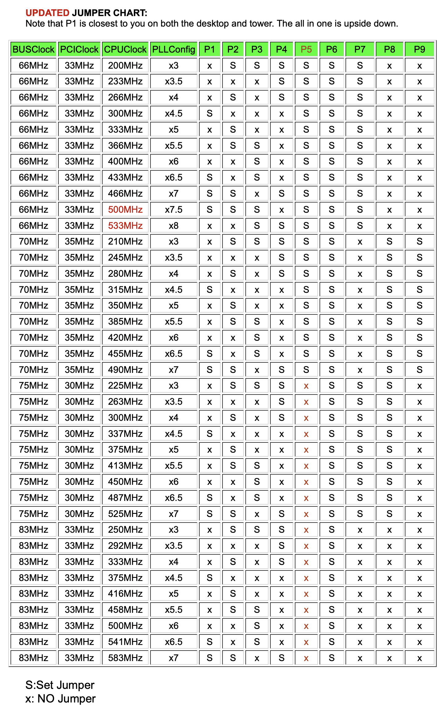

Just in case, I attach the positions of jumpers.
