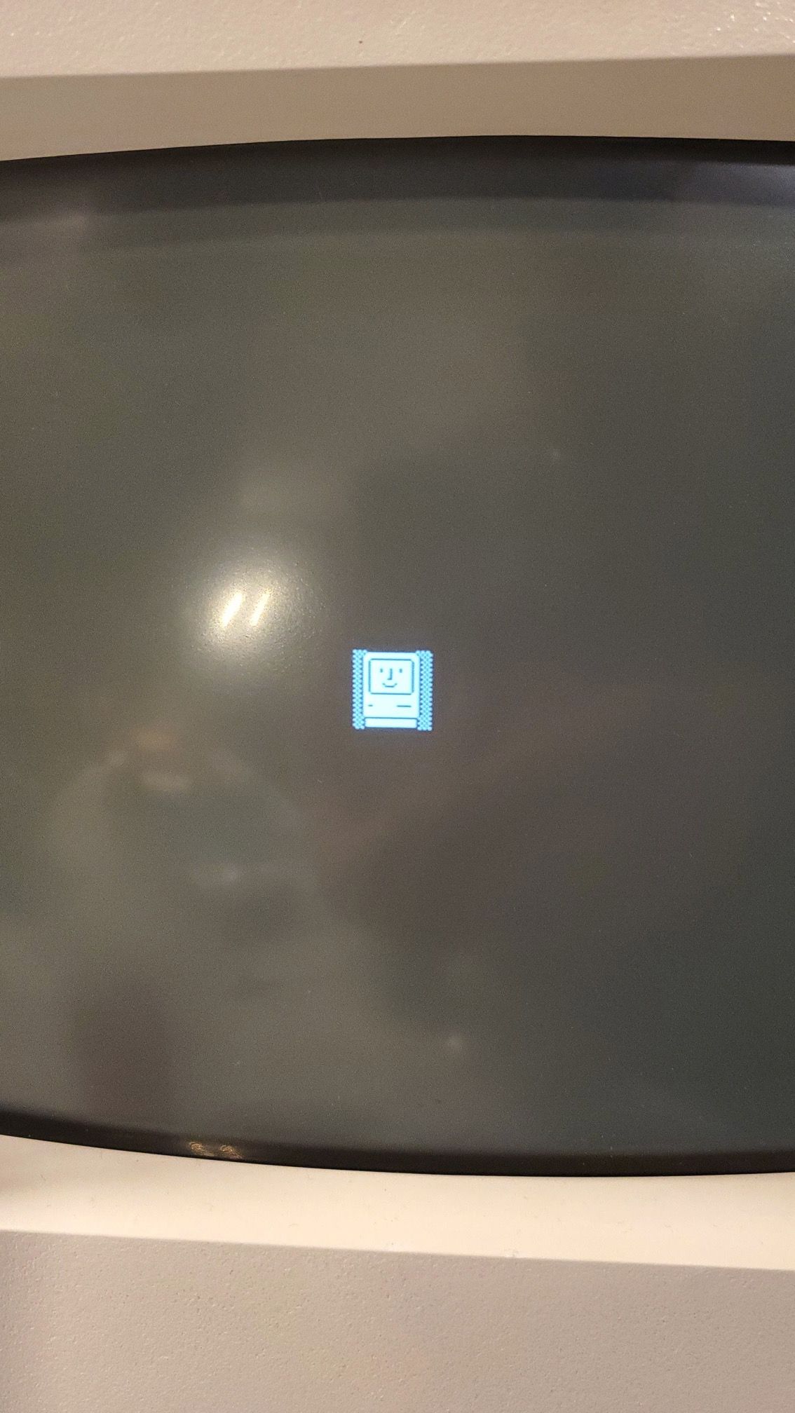

Also, the screen, although turned all the way bright is only lit up immediately surrounding the question mark or the happy Mac face while the rest of the screen is black. See attached image.

The image shows the few surrounding pixels lit up like the entire screen should be:

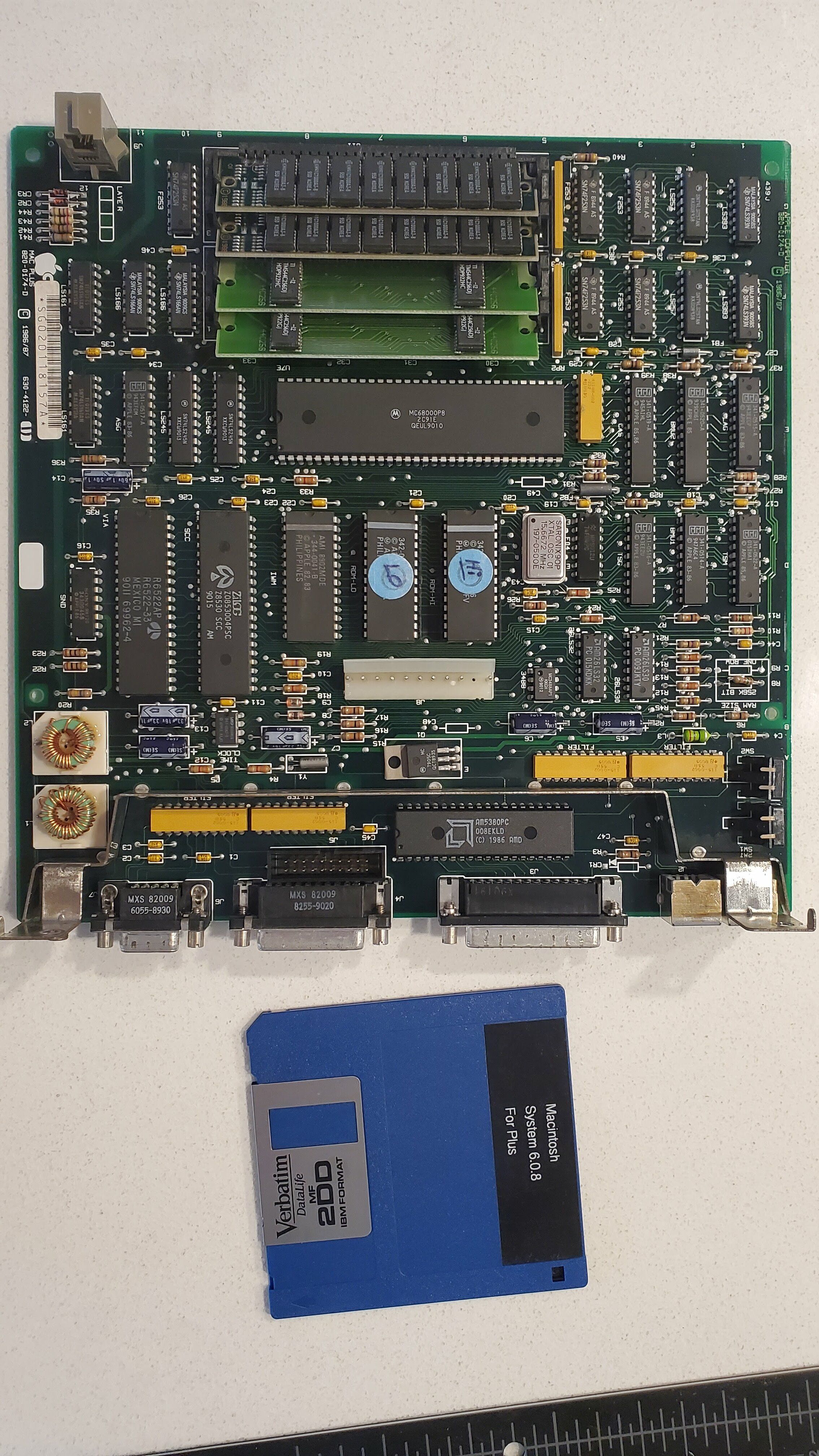

The second shot is the Logic Board.
A few thoughts, this is not medical or legal advice and should not be considered investment guidance:
  1. You are missing the checkered background on your happy mac and it makes me think there's a a RAM issue.
  2. Try with no RAM or 1 bank of RAM. You will need to adjust your resistor. You can swap matching pairs in RAM Bank 1 during this test.
  3. This could also be a ROM issue but I think that's much less likely.
  4. Adjust your R45 pot on the analog board so that the board produces 12v, then measure your 5v line to make sure it's not overvoltage.
  5. Adjust the CRT voltage pot on the analog board. I forget the identifier. I normally adjust this so max "brightness" is just a little to bright for comfort and "minimum" is barely visible. That way you have a reasonable level of control over the brightness as light conditions vary. Other people may have better (or contrary) advise on this point.

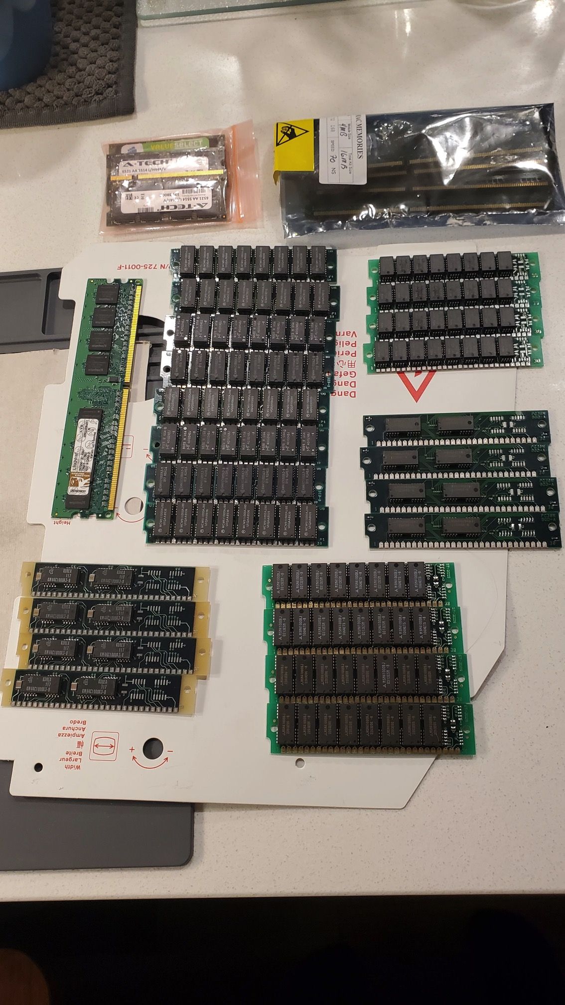

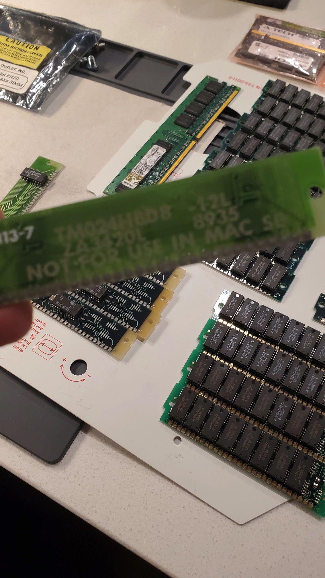

also... i know that Mac plus have issues with 3 chip ram. you have 2 chip ram. wonder if they are causing an issue?
(its just a wild guess. something would at least try)
I'll do some experimenting. I hadn't even thought of that.
2 of those chips say "DO NOT USE IN MAC SE".
I'll have to go through all these and see if something works:

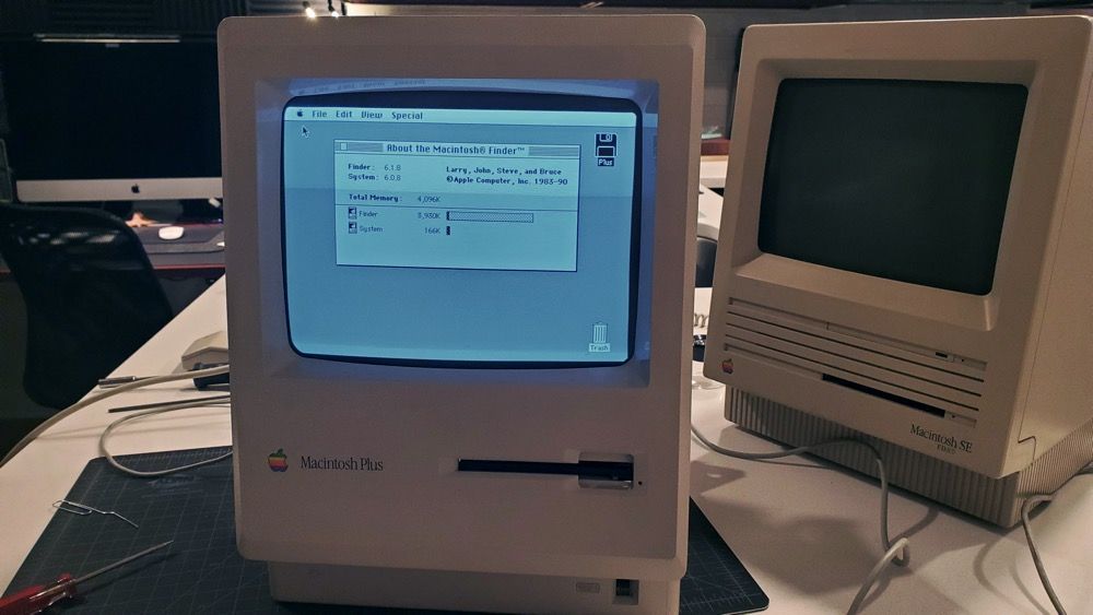

I put four 1MB chips in and I got a much better screen and mouse cursor. A little crooked but I'll fix that later. Double checked the 256k resister and it's clipped.
Now, the known good floppy drive and boot disk are just ejecting like something is wrong with the disk. this disc will boot a MacII though so I know it's good. I tried an original 7.0.1 tools disc and it ejected too.( I tried a red striped floppy cable and that didn't go well!) This floppy and drive would start to boot before and then stall, I'm assuming due to the RAM. But the drive read the floppy and gave me a happy Mac face. Now it just ejects.

Spoke too soon! I kept swapping out RAM and got 4 chips that worked. It boots off the floppy disk now!

Ah, a platinum plus. I only have a few but they are beautiful when the case is in good condition like yours. Congrats!
I just need to figure out how to move the screen over a smidge so it's centered.
There are two purity rings on the CRT neck you can adjust, that 'sweep' the display so you can center it...
