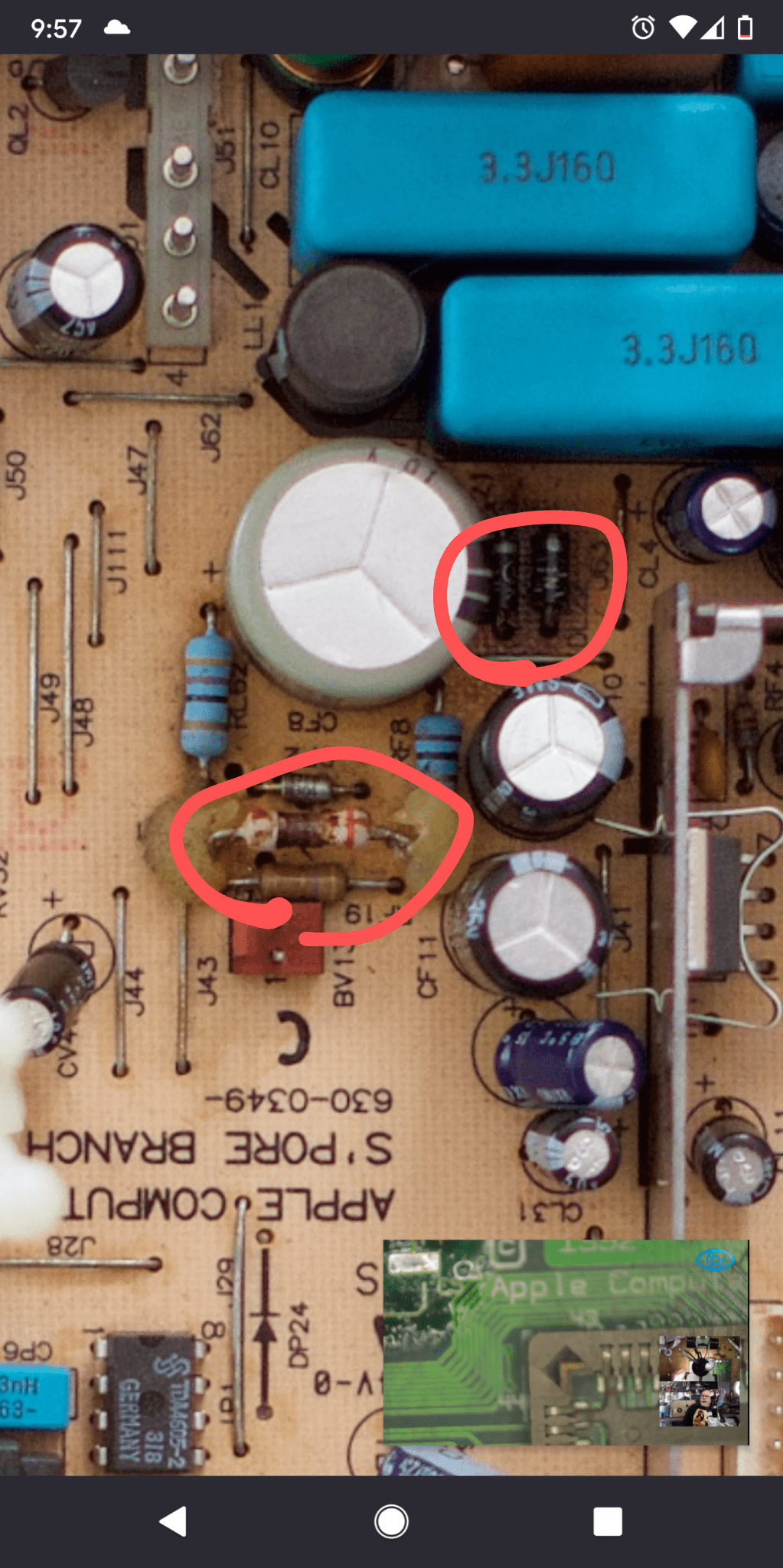

I have the typical burning resistor and pair of diodes on my Color Classic analog board (photo of problem area provided, with resistor and diodes circled in red). 2 of them, actually, same exact issue. They both work, but I'd rather not push my luck and fix them while I can.
Can someone please provide me with the values of the resistor, and any compatible variants if they exist? Also, do I need to replace the two diodes nearby, or does replacing the resistor fix that problem too?

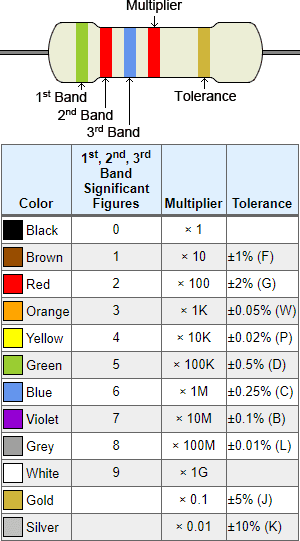

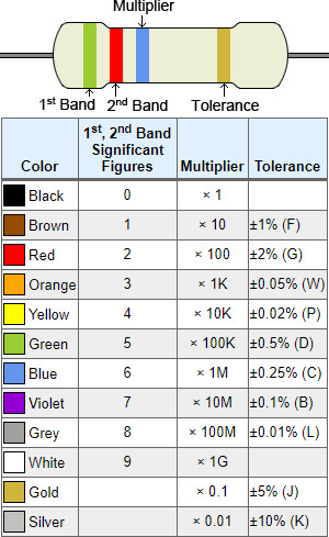

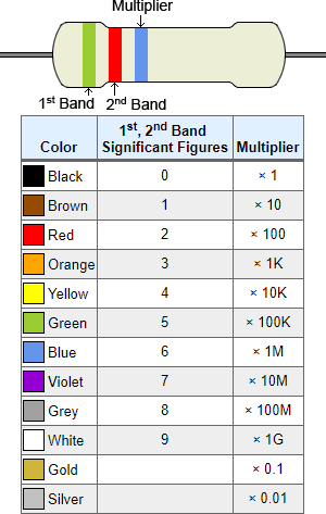

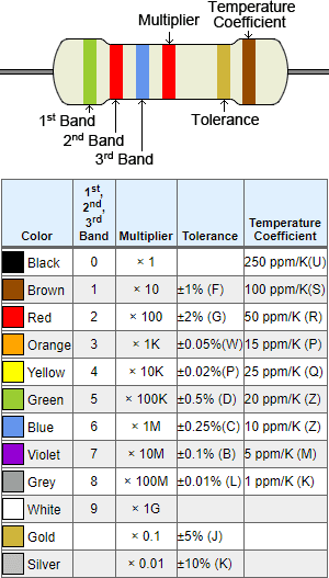

Are you familiar with identifying the bands on the Zener diodes? You can refer to charts for three, four, five, and six band diodes that identify the colors, values, and tolerances. That can help you to determine which ones to replace.
I have seen posts elsewhere, such as on 68kmla, about those diodes scorching on the color classic analog board, which is a common issue due to age and heat. However, no one is saying specifically what replacement diodes are. That baffles me.
Your picture does not provide enough light to see the bands of the burnt diodes. Can you please take another picture with more light?

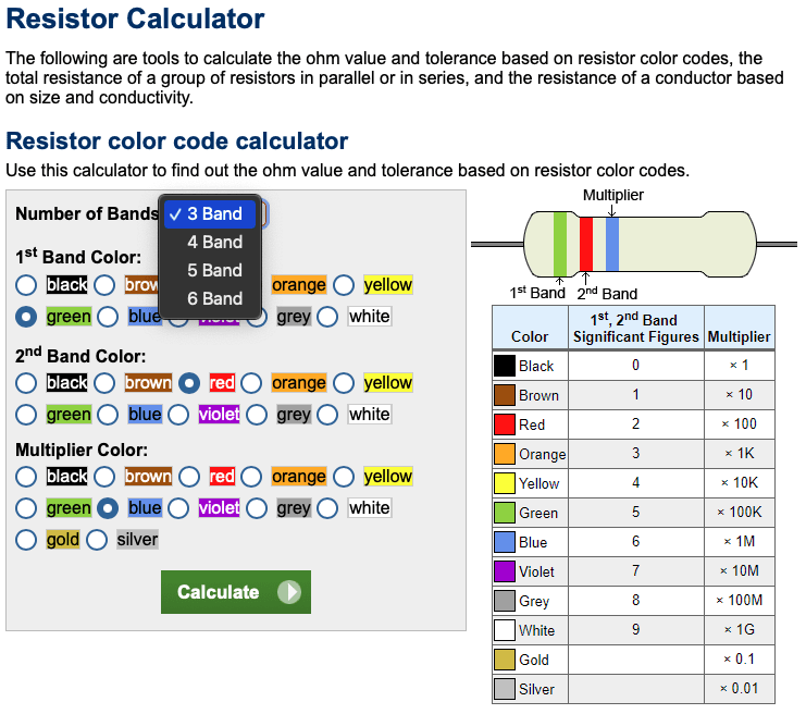

I found a nice resource, a resistor calculator online that can help you to figure out by selecting the number of bands and the colors. Here are the charts for the three, four, five, and six banded diodes.
@red_leader, I checked a post on the 68kmla again, and I see that someone found the diodes' values on the Color Classic analog board that scorched, like yours.
I gathered the following information:
  • DL21 22 diodes and RL62 (47 Ohms)
  • RF11 (390 Ohms) resistors
  • CF8 cap replaced with a 3300uF 25V 105C
@retr01 My RL62 is alright for now, not really nearly as toasty, and I was told the Zener diodes are 1N59 when an awesome Youtuber named Bruce of Branchus Creations took a quick look at his analog board after working on a Color Classic logic board. The photo I posted, on the other hand, is a photo of an analog board that I found online and, believe it or not, is a lot clearer than the ones on my board (they're a lot darker due to burning).
I guess I need a pair of those, along with a 390 Ohm resistor.
