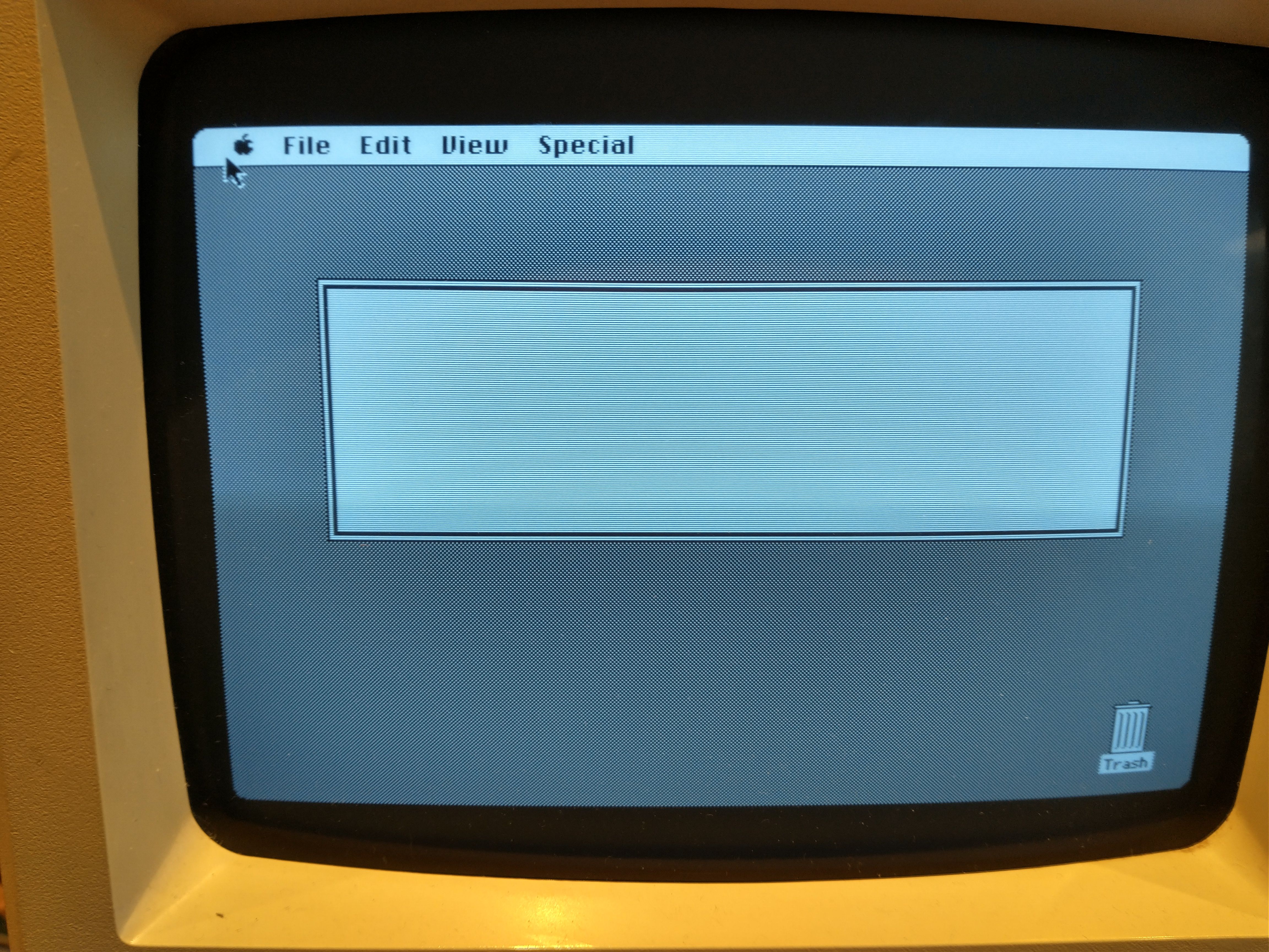

Update 10th April - I socketed the IWM chips in a Plus and the 512K and swapped them over. The Mac Plus still writes to a floppy with no issue. The 512K booted from the Floppy Emu in HD20 mode, so I thought it was fixed... Then tried an external 800k drive along with Rominator bootup and got the same old error when trying to save from Macwrite to floppy, "bus error" I think. Then tried the Floppy Emu in HD20 mode again and this time it hung with an error. Urgh!
Will try swapping the floppy port filter chip next. Could be some small part that's only needed when writing to floppy port?
