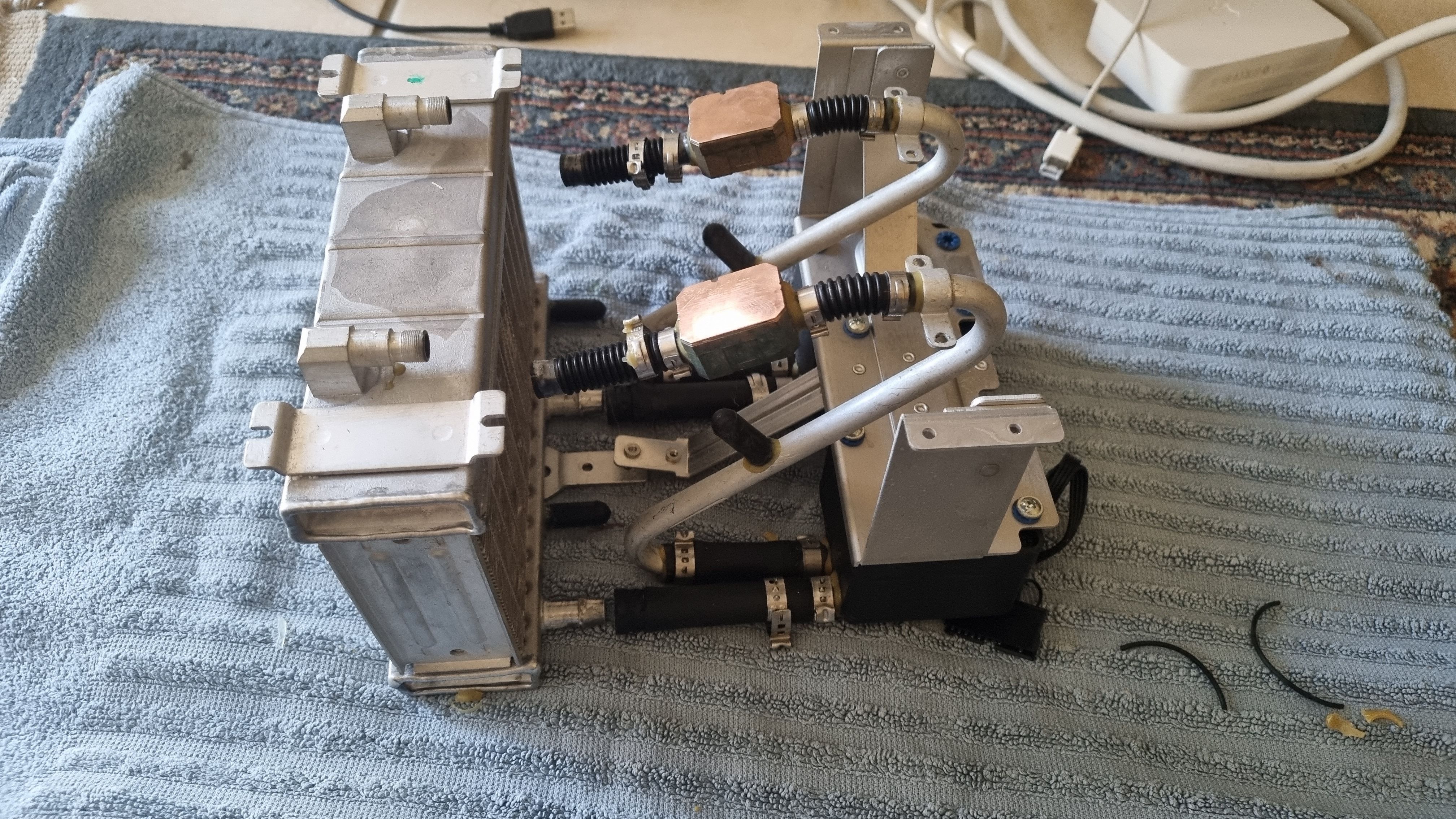

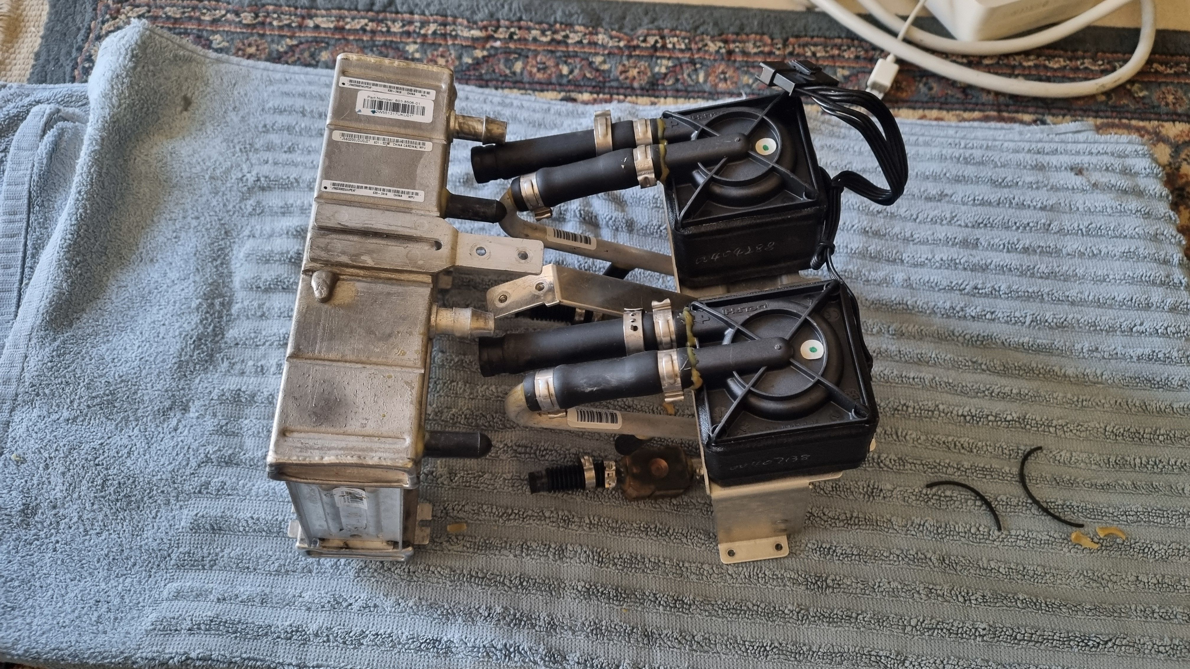

OK, so I am working on restoring a PowerMac G5 quadcore dual 2.5 cpu double pump liquid cooled system for a friend, and I am currently at the point where I have removed the radiator, tubes and pumps from the system, and I have emptied and cleaned the loops, and repaired the radiator as best I can.

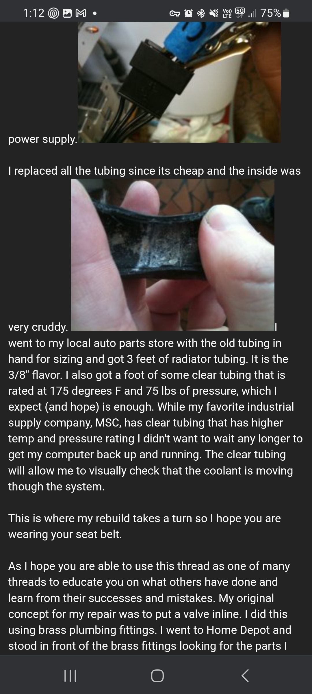

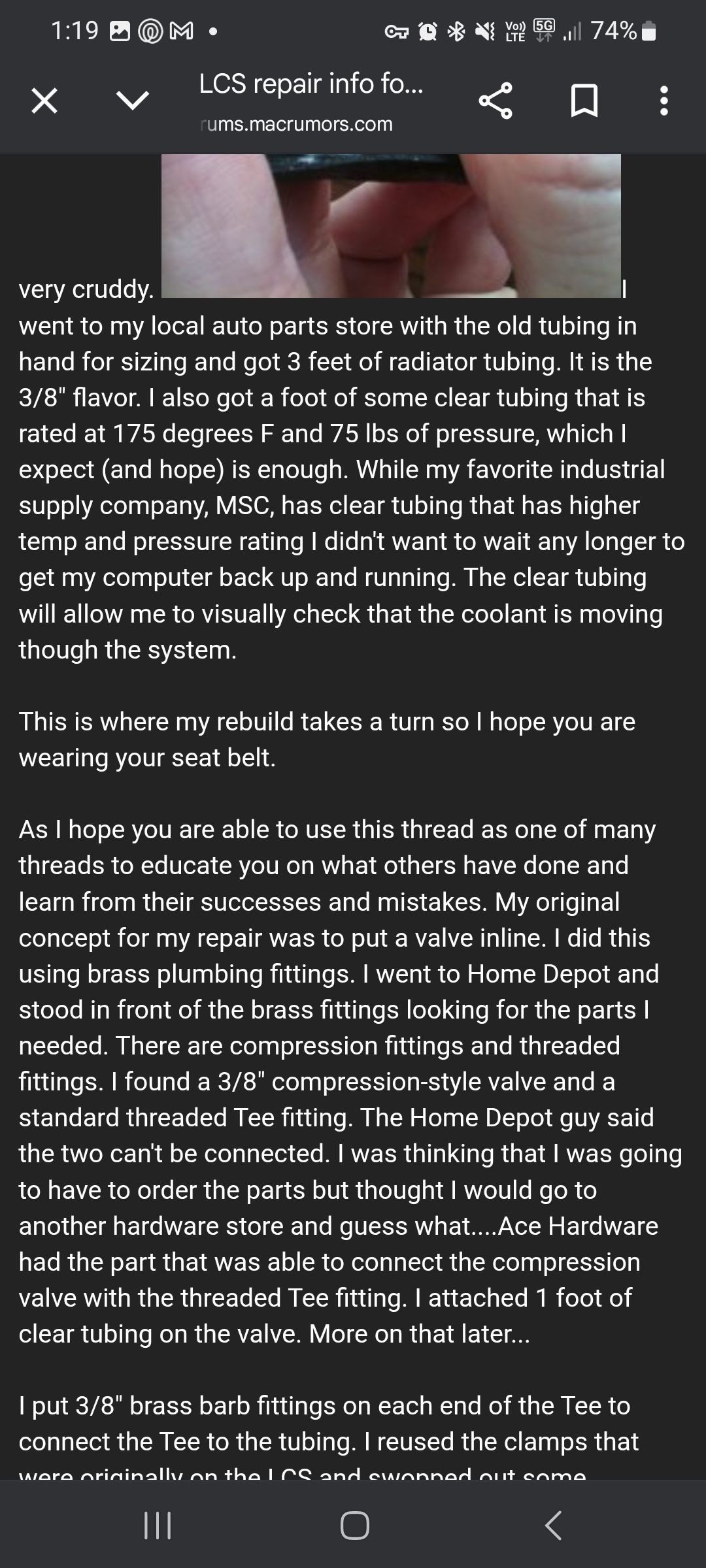

Also what is the stuff that is being used to seal the ends of the tubes with the rest of the construction? Also what is a good tube sealant for using in the situation, as I am going to be using a hyperdermic needle to help bleed the system of air pockets as is said to do in the guide, possibly also replacing the old tubes with new ones. Are the ones I have shown a good option?

Can I ask what the size for the tubes is for the ones that are connected to the CPU block? I feel like replacing the tubes is a good move here because I feel like there was some serious damage done to them in the disassembly process.
Also, is there something that I should look out for when selecting the type of tubing that I intend of using like I get using the clear stuff but what key things should I check for before getting it.
