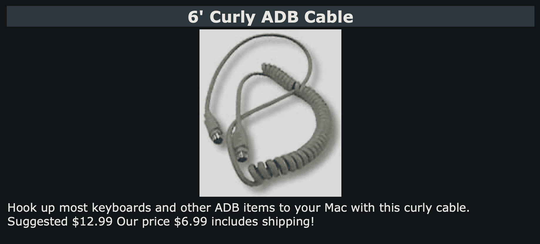

The ADB cable is enough of a mess that it's going in the trash as soon as I make sure I can get a replacement.
On eBay, the coiled ADB cables are priced like crazy. 🤑 So, I came across reasonably priced at Operator Headgap Systems for ADB coiled cable in reasonable condition 👀 🤩(y) (scroll down to around the middle of that page):
