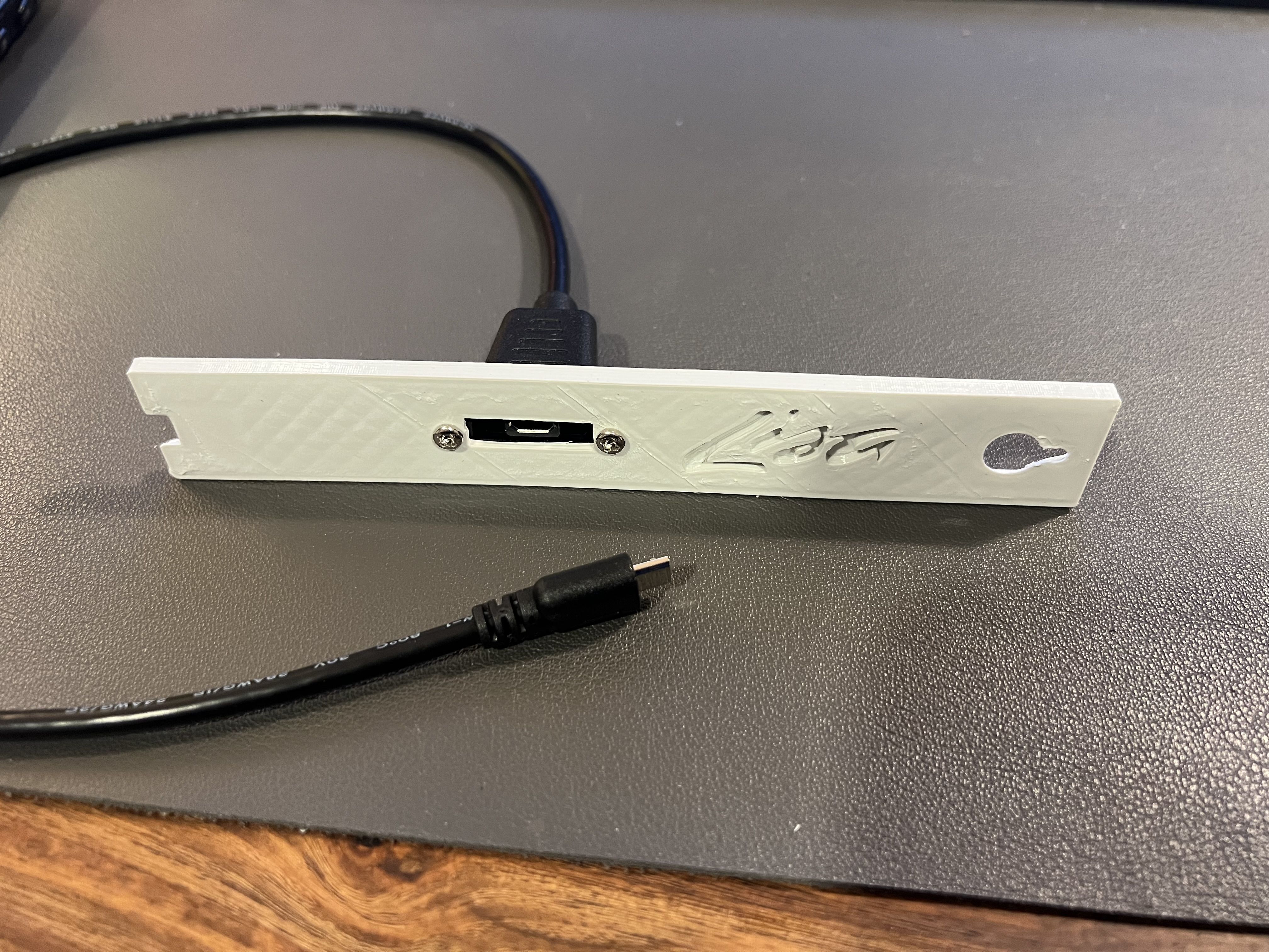

For the power, I think I was going to get one of these https://www.amazon.com/gp/product/B07LB4F9V7/ref=sw_img_1?smid=A2F0OPAFFWUQKL&psc=1
Then modify this blank Lisa Plate (https://www.thingiverse.com/thing:4500929) to be able to mount it. A bit cleaner than an open expansion hole.

Got the microUSB extension today. 3d printed a bracket for it. Not I just need the Cameo/aphid to plug into it inside the Lisa!
