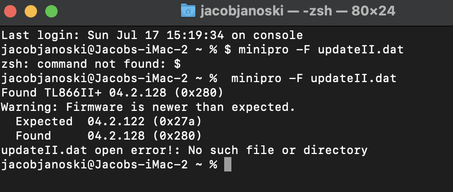

Found TL866II+ 04.2.116 (0x274)
Warning: Firmware is out of date.
Expected 04.2.121 (0x279)
Found 04.2.116 (0x274)

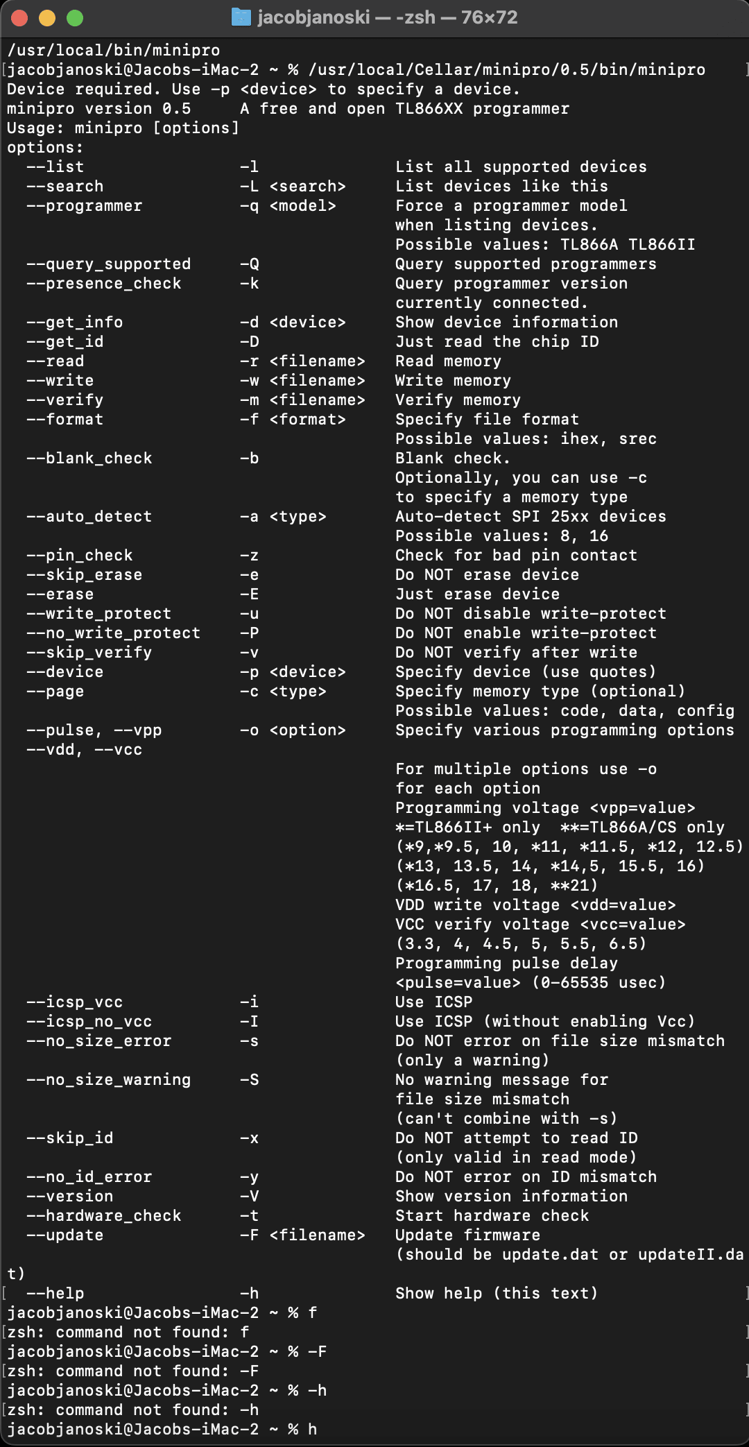

If you try minipro from the CLI do you get any more details? Can you do a pin test on the ROM you have? eg
minipro -p "SST39SF010A" -z
I get this:

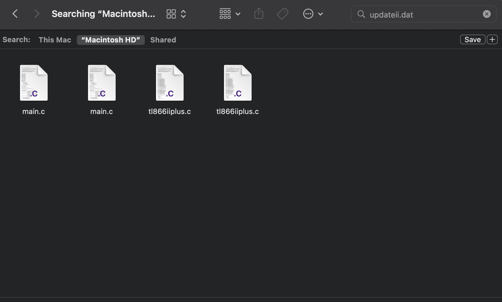

I wonder if the MiniPro works up to firmware 04.2.122 of the TL866II+? Do you need to downgrade its firmware or update the MiniPro so that it can use the newer firmware?

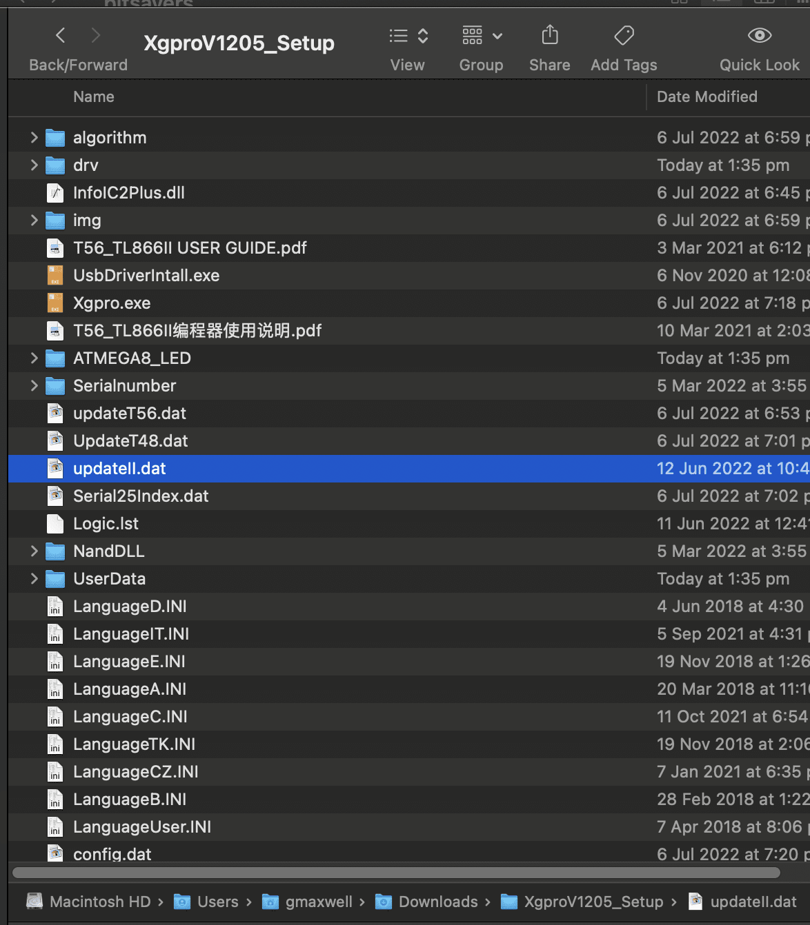

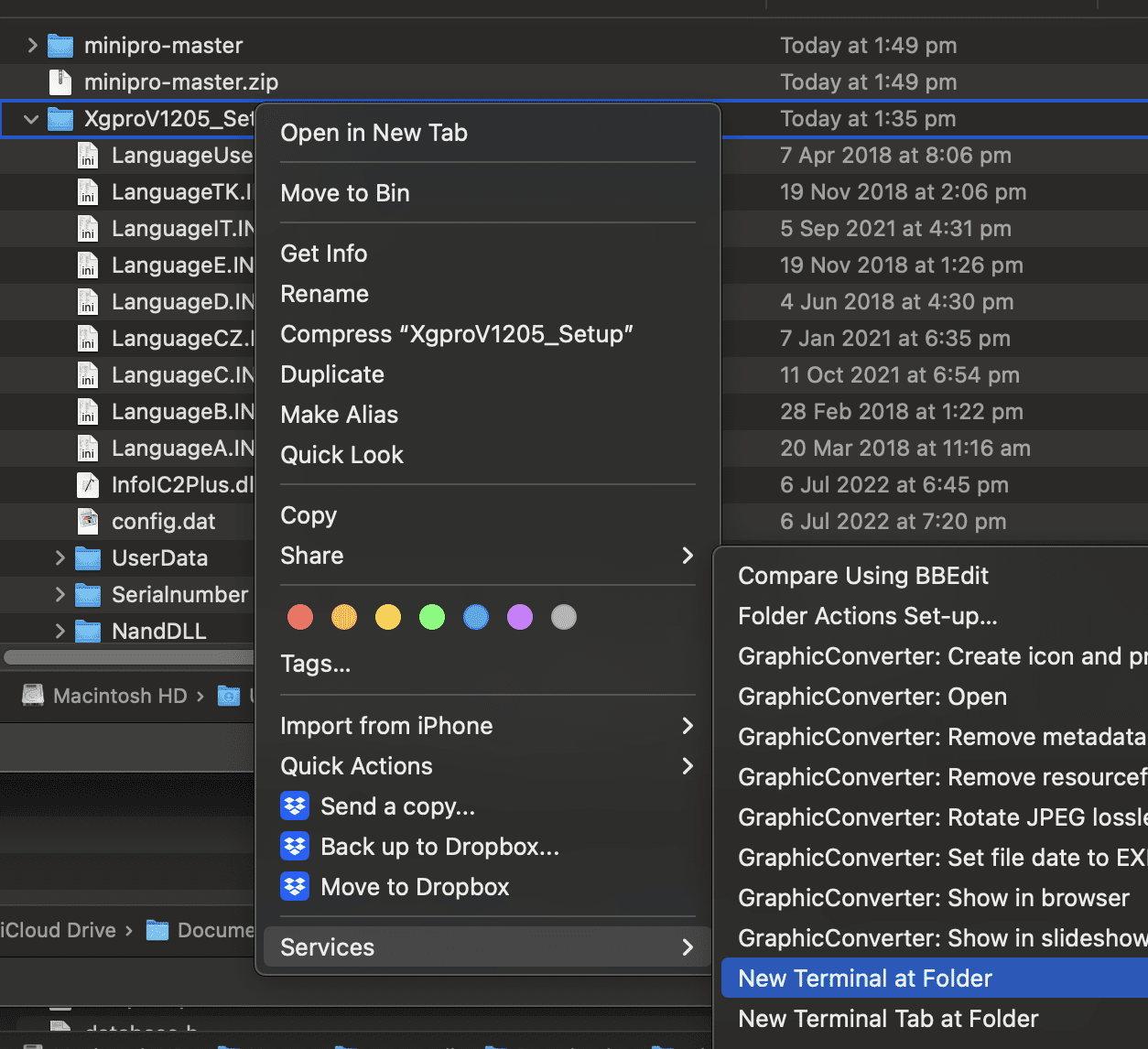

If you right-click the folder containing the updateII.dat file and select "Services/New Terminal at folder" it should drop you right where you need to be. Then the update command should work just fine.

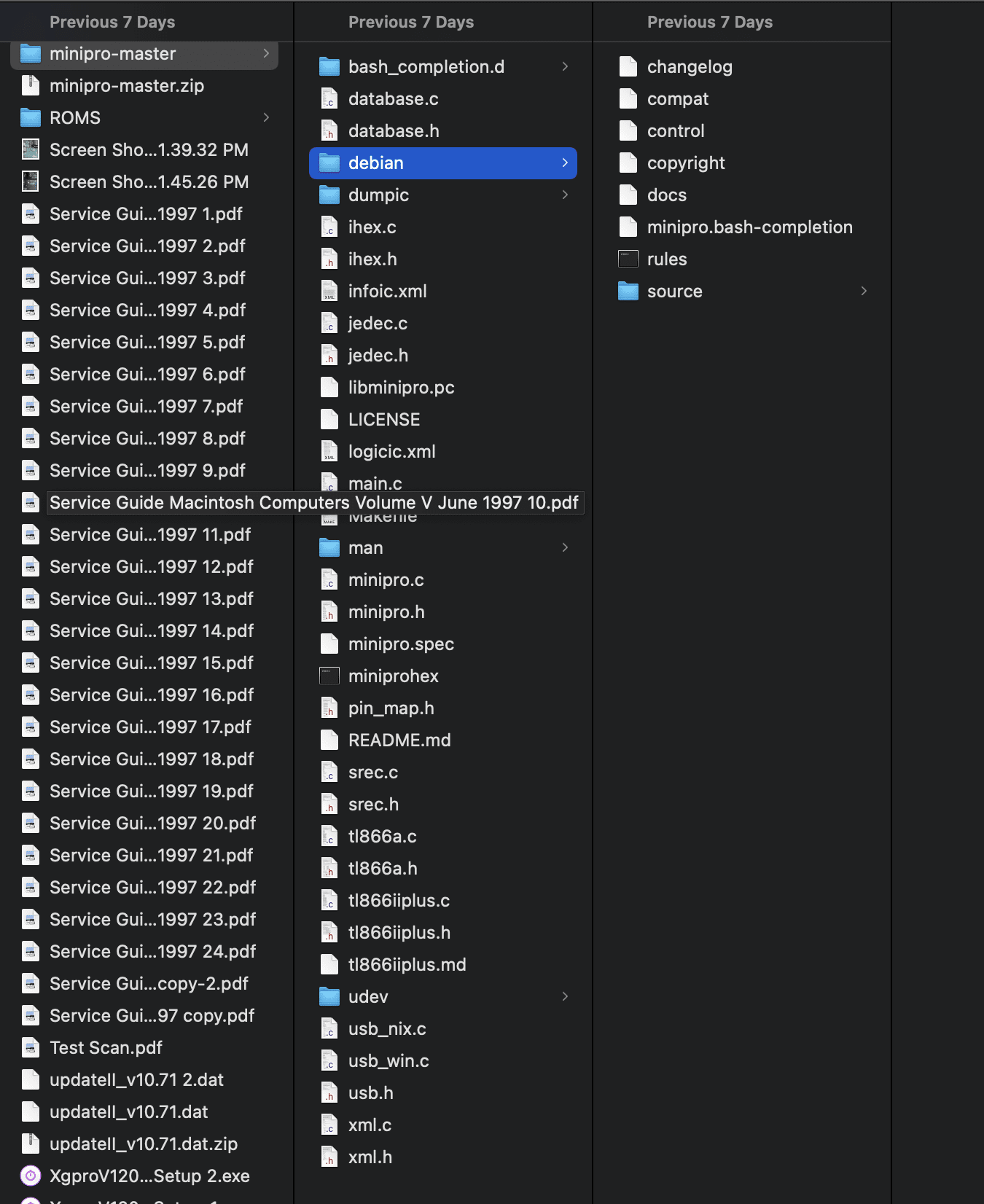

The "minipro-master" folder can be in several places on the volume—one in System, one in Users, and another in the application package. So, you need to be in the correct location.

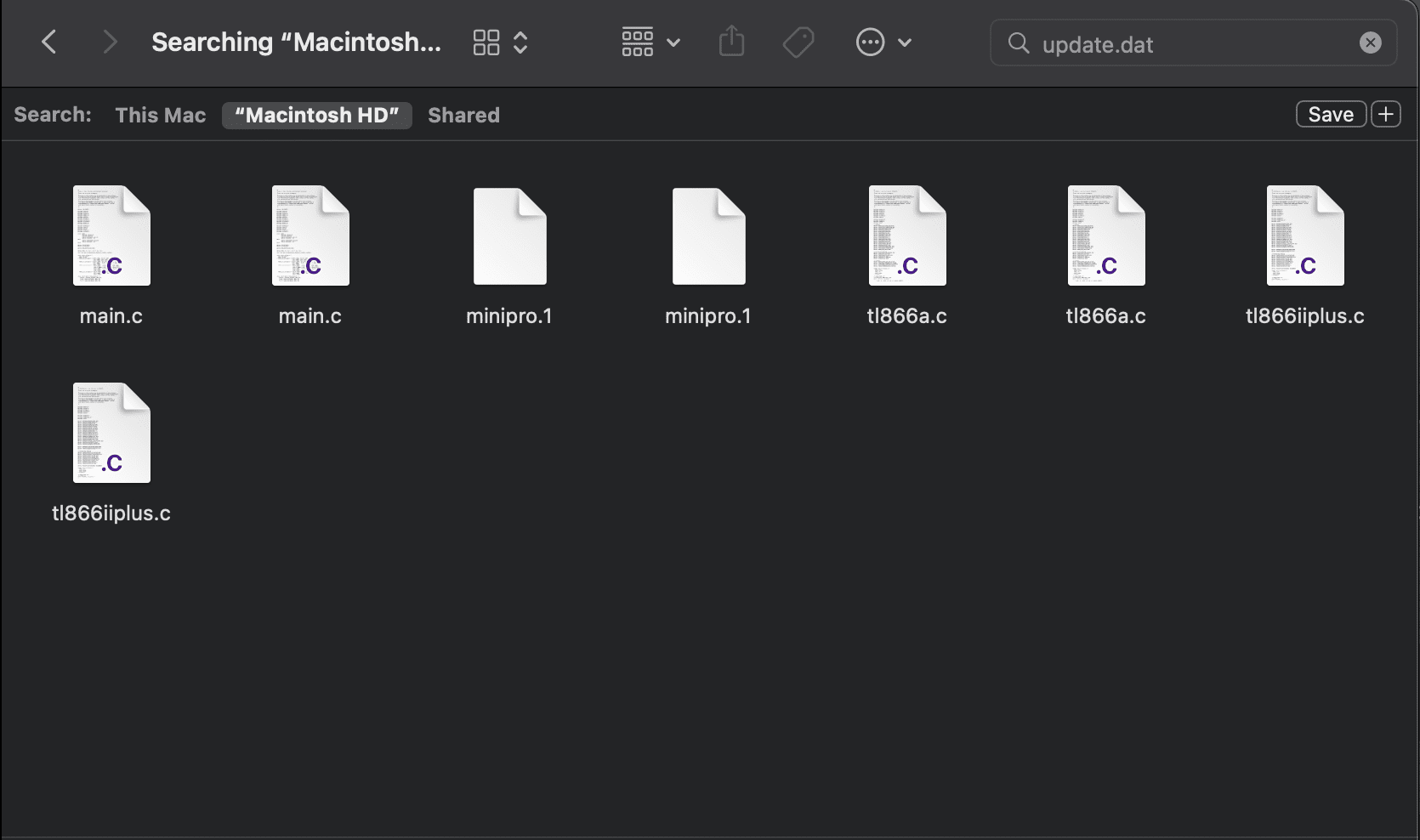

One trick is to search for that file in the folder that you want to open the terminal in that directory folder.
It's not part of minipro. It's part of the Window's application installer package. If you have the Windows app you should be able to find it in the same directory.
Or search for file "updateII.dat" then right-click that to open the enclosing folder. Go up one level. Then right-click that containing folder to open in the terminal.
