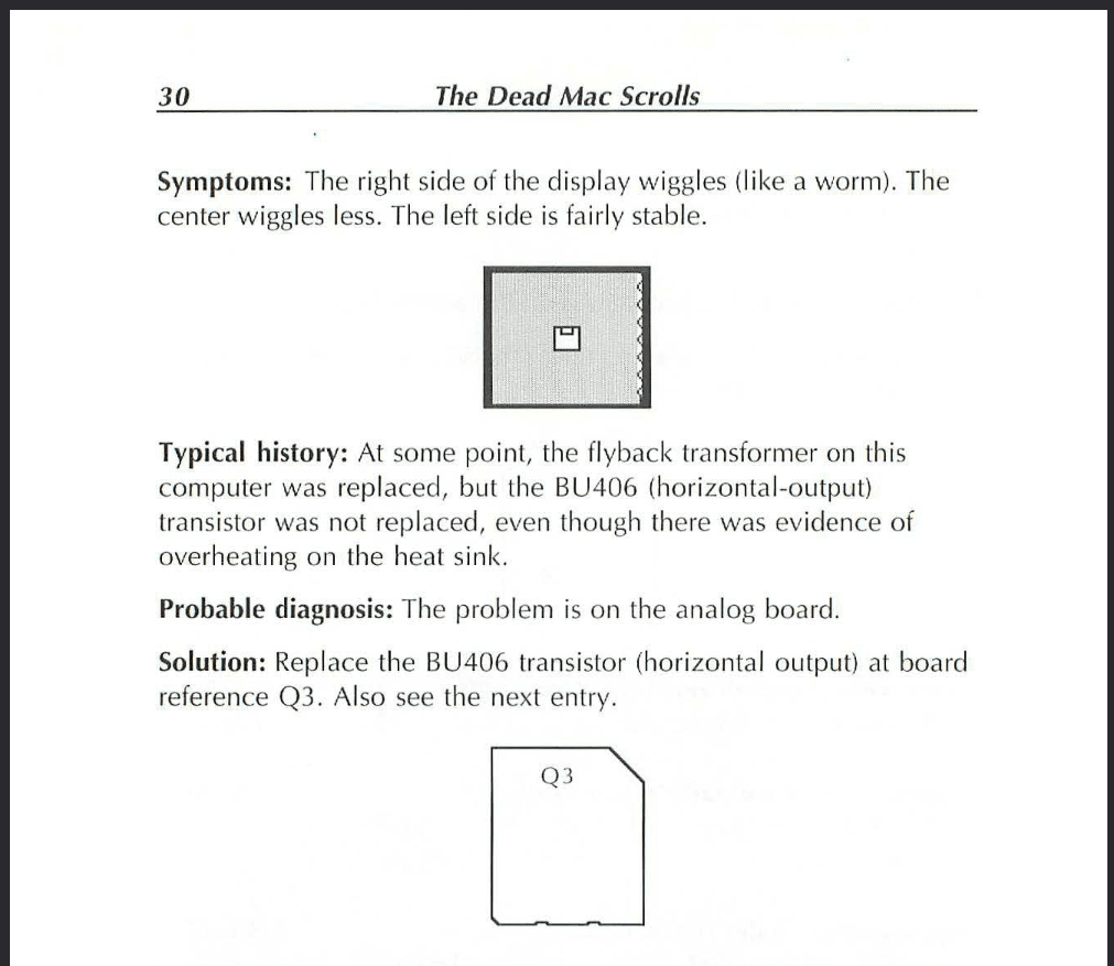

The left side of the display is fairly stable, but the right side will wiggle and shift randomly. The horizontal dimensions will also change by ~1cm randomly, back and forth. The jittery behavior is unrelated to any read access from the floppy drive, and happens even if the computer is completely idle without a boot disk inserted. This doesn't seem to stabilize with time, but I need to test that more. Tapping the AB doesn't seem to affect the jitters one way or another.
This behavior does appear somewhat similar to what I see in the Dead Mac Scrolls (see attached image). I'm going to attempt to replace transistor Q3 next week. Tbh I'm also just worried this could be the flyback. The epoxy seal is very brown, although there aren't any cracks, visible arcing, or ozone smell.
