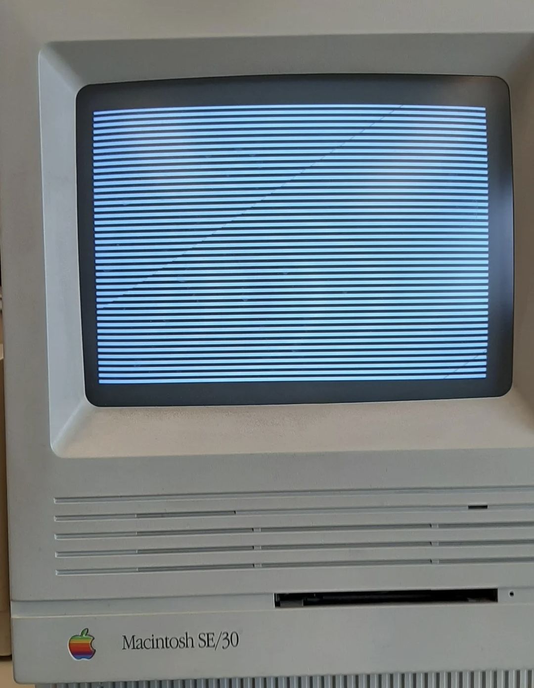

After a recap my SE30 now has horizontal lines with no chime. This happened about 6 months ago and I shelved it. I thought at the time I may have cooked one using hot air and decided to recap all the tantalum caps this time only using my iron. Same effect after as well. It was working fine aside from the audio going out prior. The analog board was recapped as well but I tested with a spare SE to rule that out.
What I have done so far:
Washed the board and made sure it’s all clean, no solder balls where they don’t belong.
Traced all new caps to verify they are on the pads and the next contact down the line rings out.
used deoxit in all sockets and reseated anything that can be reseated.
then recap it, no wonder it isn't booting up
Whelp, swapped with a known good power supply and it’s the same. One thing I didn’t mention prior was I did reflow one of the caps in the sound circuit because it didn’t ring out but now that’s working and I get the slow sad Mac tone. Also swapped the analog board and that still have the zebra. Then I placed an SE board in its place and that booted fine. So now I’m looking at a fault on the logic board.

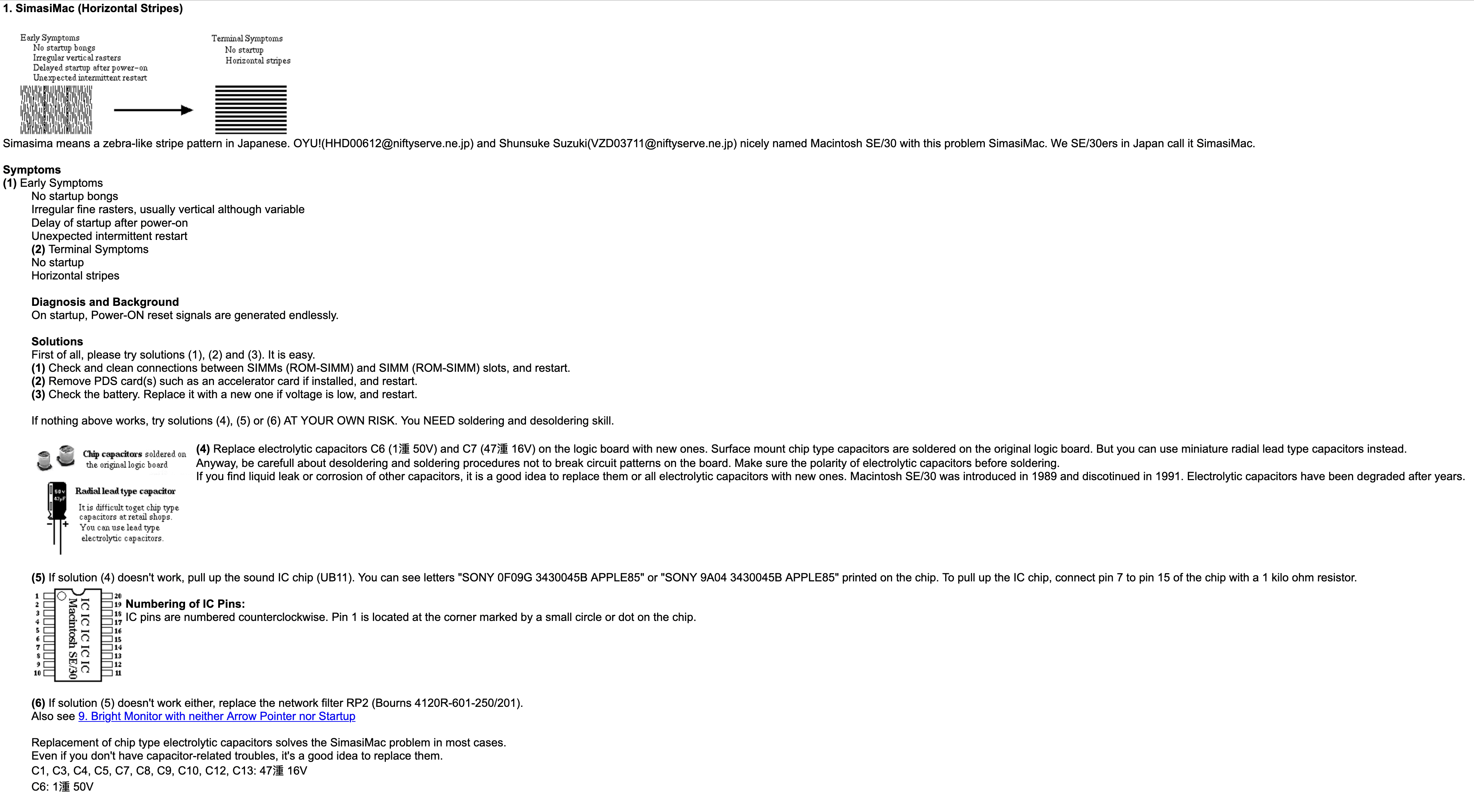

Was going to come here to post this image:
In my case, it was the sound Resistor Pack 🤷‍♂️ -- glad you solved it! :D
