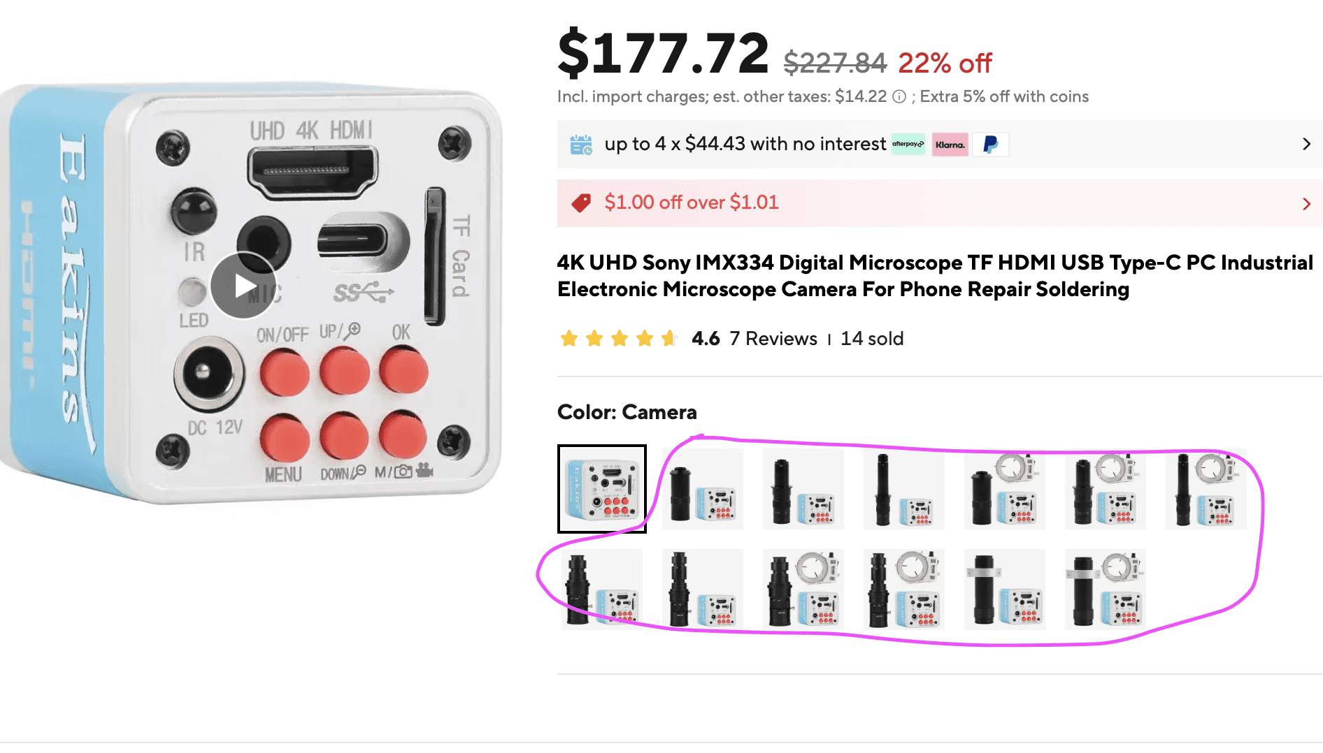

I actually hadn't noticed all the other "bundles" on that AliExpress product page. I probably wanted one that bundled a lens, but I have no idea which one I would have needed.
