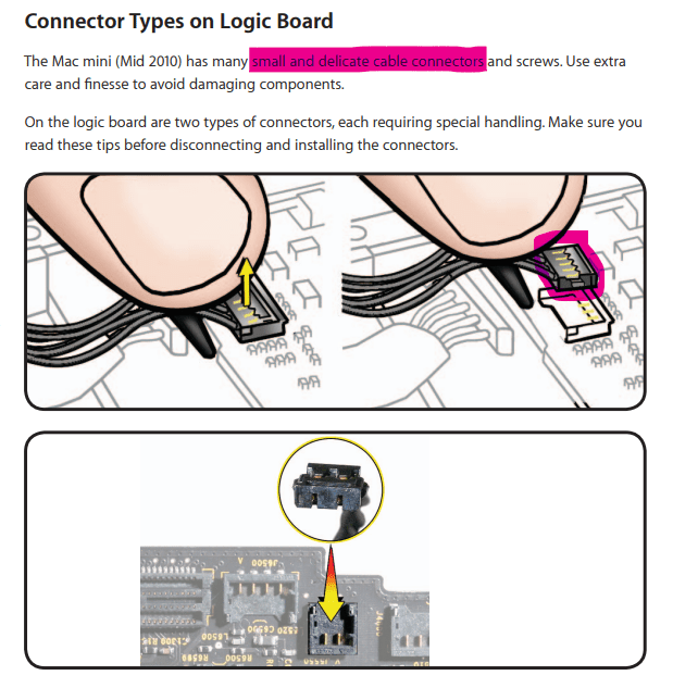

While working on my Mac Mini (2010), I accidentally pulled the wires out of two of the three 2-pin JST connectors that lead to thermal sensors for the hard drive(s) or optical drive(s) (depending on the Mac Mini model you have). Instead of the connector properly disconnecting from the motherboard, the connector stayed fastened to the board, but the wires were accidentally pulled out of the JST housing. The JST Connector case or package remained stuck on the logic board, only the wires came loose.​
The connector itself is fragile—the thin layer of plastic that holds the wires in place is soft and can easily break with too much force. To make things worse, both wires were black, so it wasn’t immediately clear how to reconnect them correctly. As a result, the Mac Mini’s fan started running at full speed, a common symptom of thermal sensors not working properly. I didn't know which wire went where. As you can see in the lower framed image, there are two copper pins that the wires slide into, the wires that I accidentally pulled out through a mix of carelessness, clumsiness or connector age that made the plastic too soft.

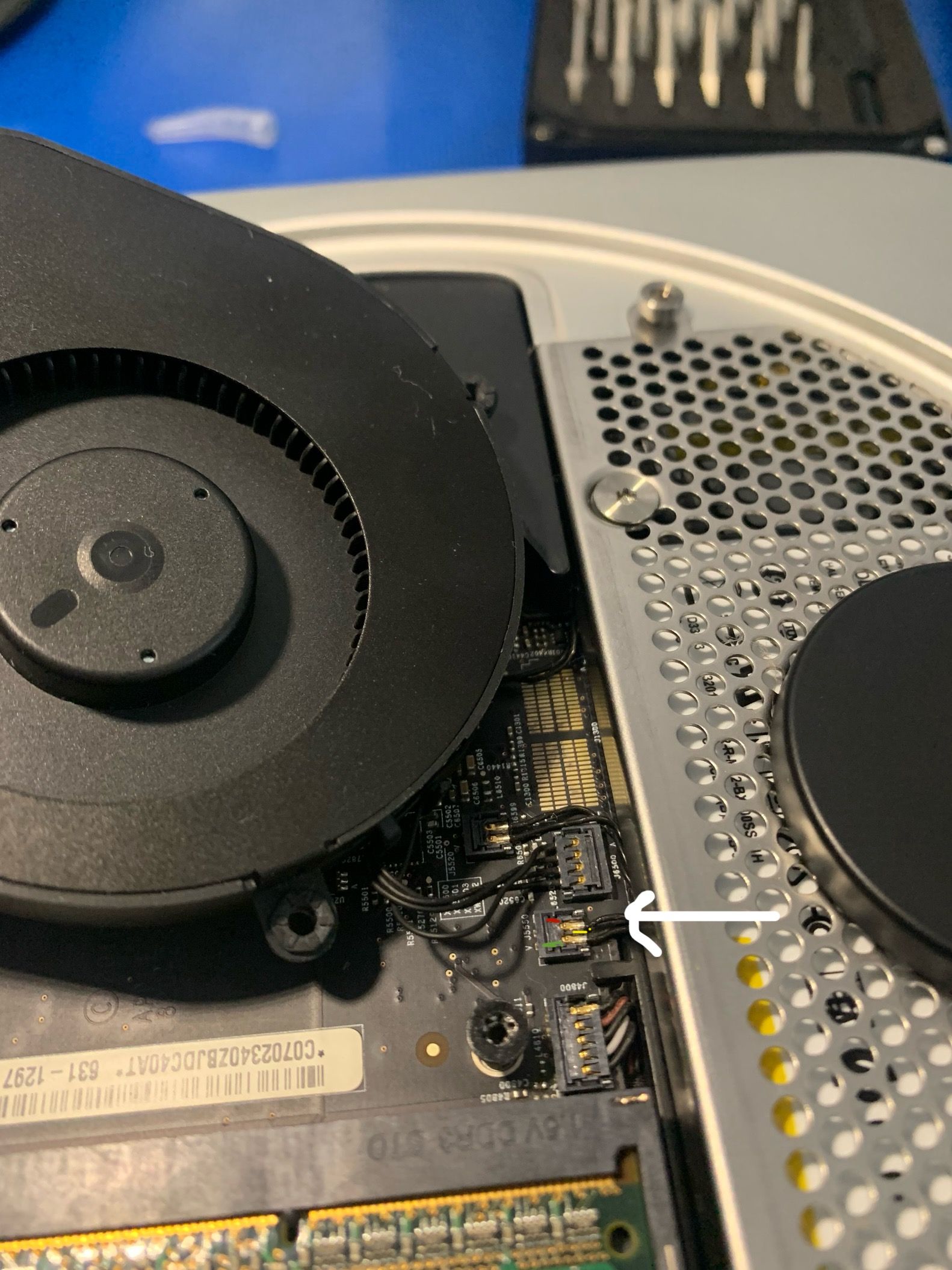

  1. I carefully reinserted the wires back into the JST connector housing (which remained attached to the logic board).
  2. After powering on the Mac Mini, I checked the fan's speed to see if the thermal sensors were working correctly.
  3. If the fan continued to run at full speed, I swapped the wire positions in the JST housing and tested again (see image below)
Step 2: Verifying the Fix​
After a couple of attempts, the fan no longer ran at full speed, it as otherwise always starting up correctly with a chime and flashing question mark (two new SSDs in place). This indicated that the thermal sensor was functioning properly, with correct wire placement and polarity.

In the image, I’ve marked the two pulled wires in red and green. Yellow indicates the barely visible "wall" of plastic that remains in place, which prevents the two exposed tips of the wire from shorting. It’s important to check for the lack of continuity between the two wires to ensure a short circuit is not possible. I will add some Kapton tape on top of the connectors before zipping up the machine.
Also, if you run into this problem as described in these two messages be sure to not have the machine connected, to screw down the fan with one screw to prevent a short circuit while powered on.
