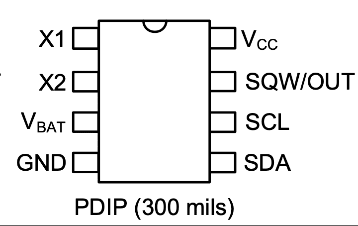

This is what I used, LINK. I've also attached the exact pinout of this chip below, which is an exact match to the original chip's pinout.

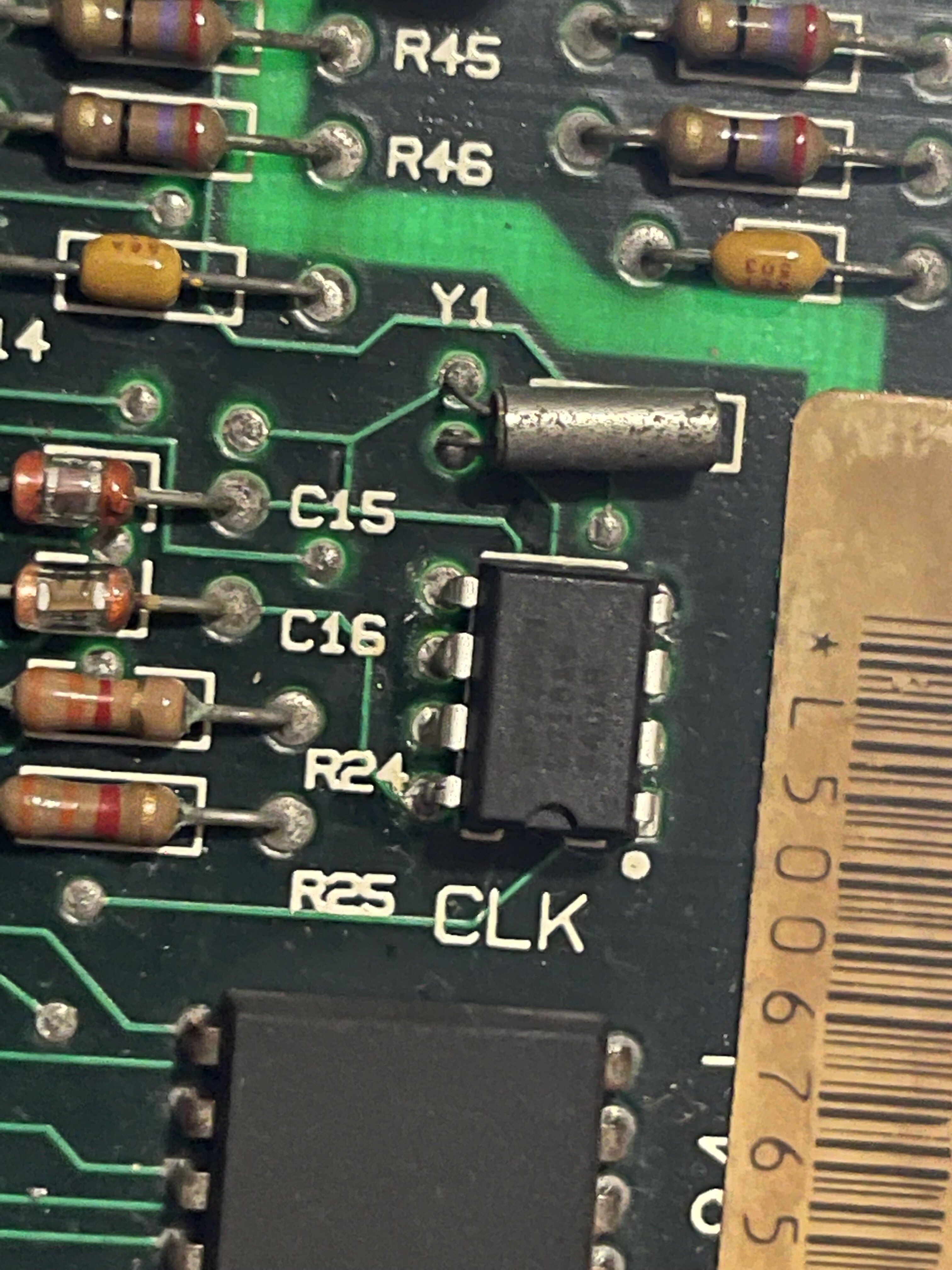

Here's a photo of the same chip in my 512k board:
Well my original clock chip was very rusty, it worked but I didn't trust it so resorted to that and I've had no issues. As far as compatibility I don't know if that same chip was implemented on the Macintosh Plus I'd have to take both Machines apart to see.
Edit: The Macintosh Plus Real Time Clock is different from the 128k/512k.
