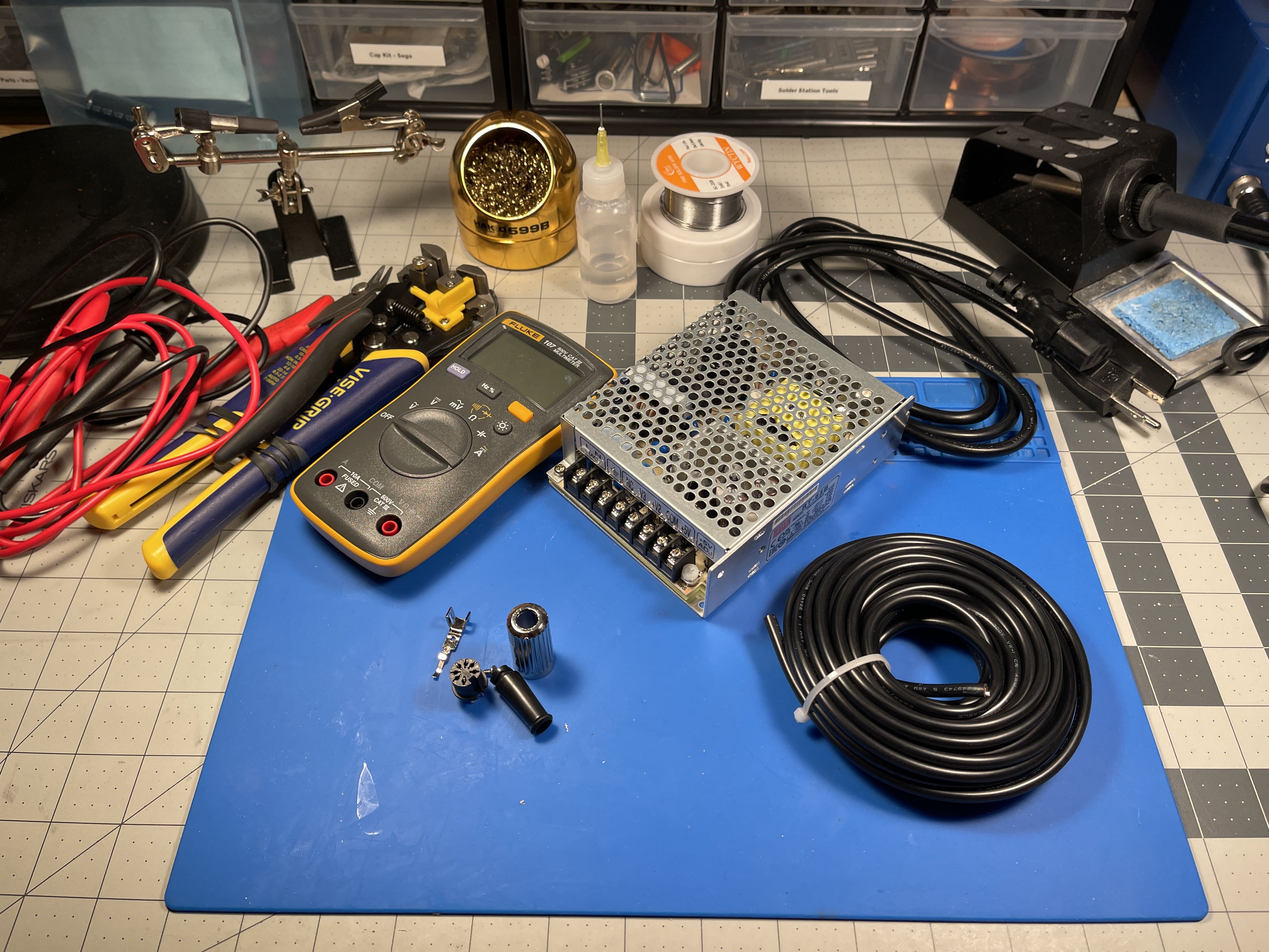

Materials Required
Tools Required
  • Multimeter
  • Soldering Iron, Solder, and Flux
  • Cable Strippers
  • Heat Shink Tubing or some hot glue

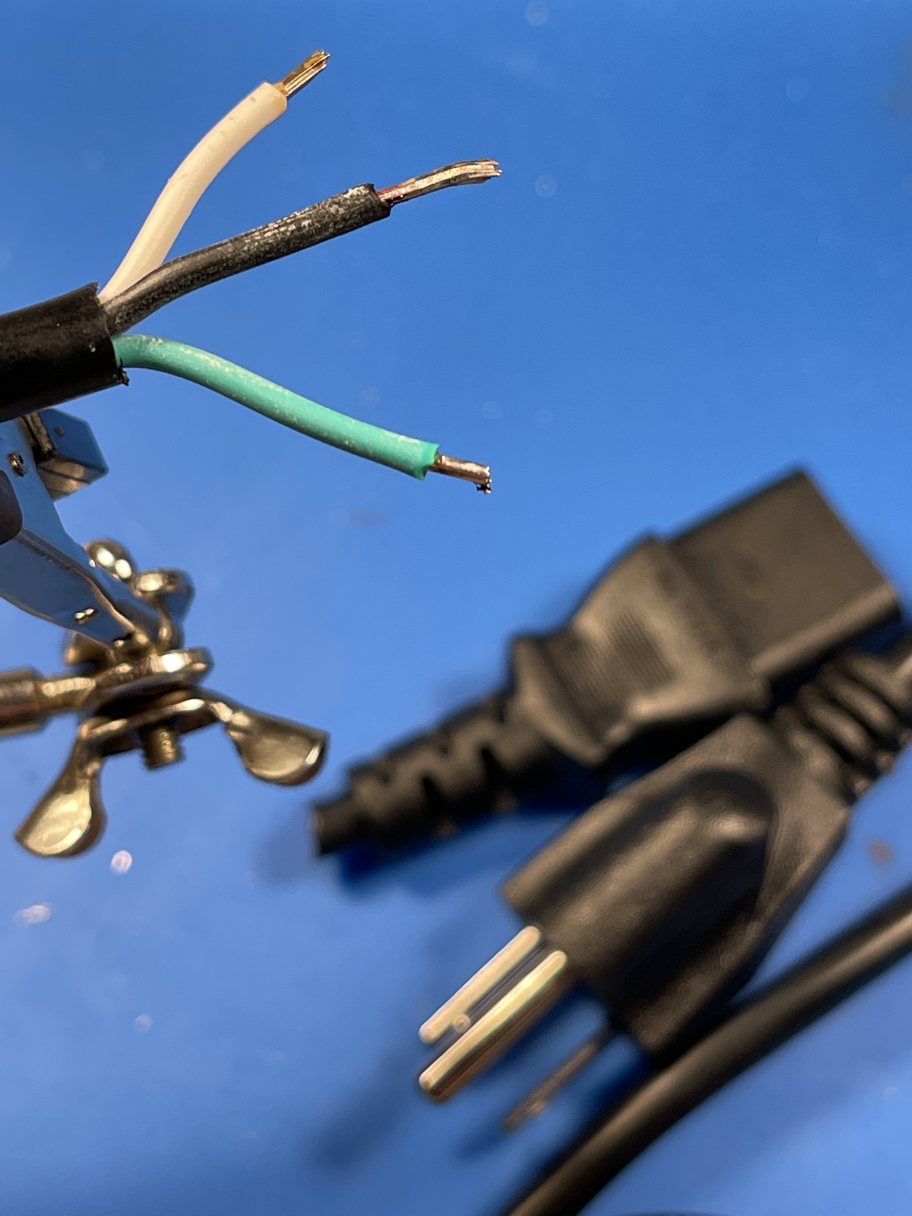

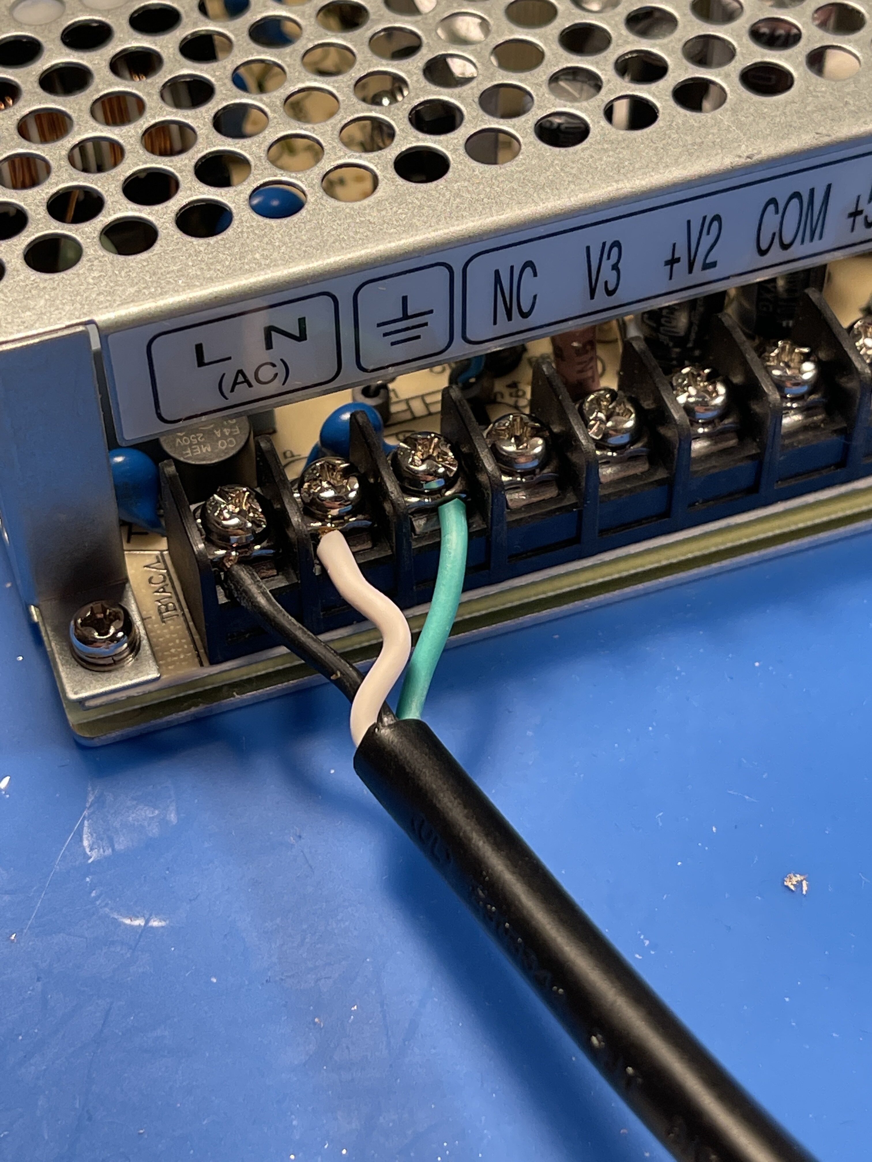

Cut the female end from your C13/C14 cable. Expose the three wires and tin (better than I did, ideally).
Step Two
Attach your wires as follows (left to right):
  1. Black to L (Live)
  2. White to N (Neutral)
  3. Green to Symbol (Ground)

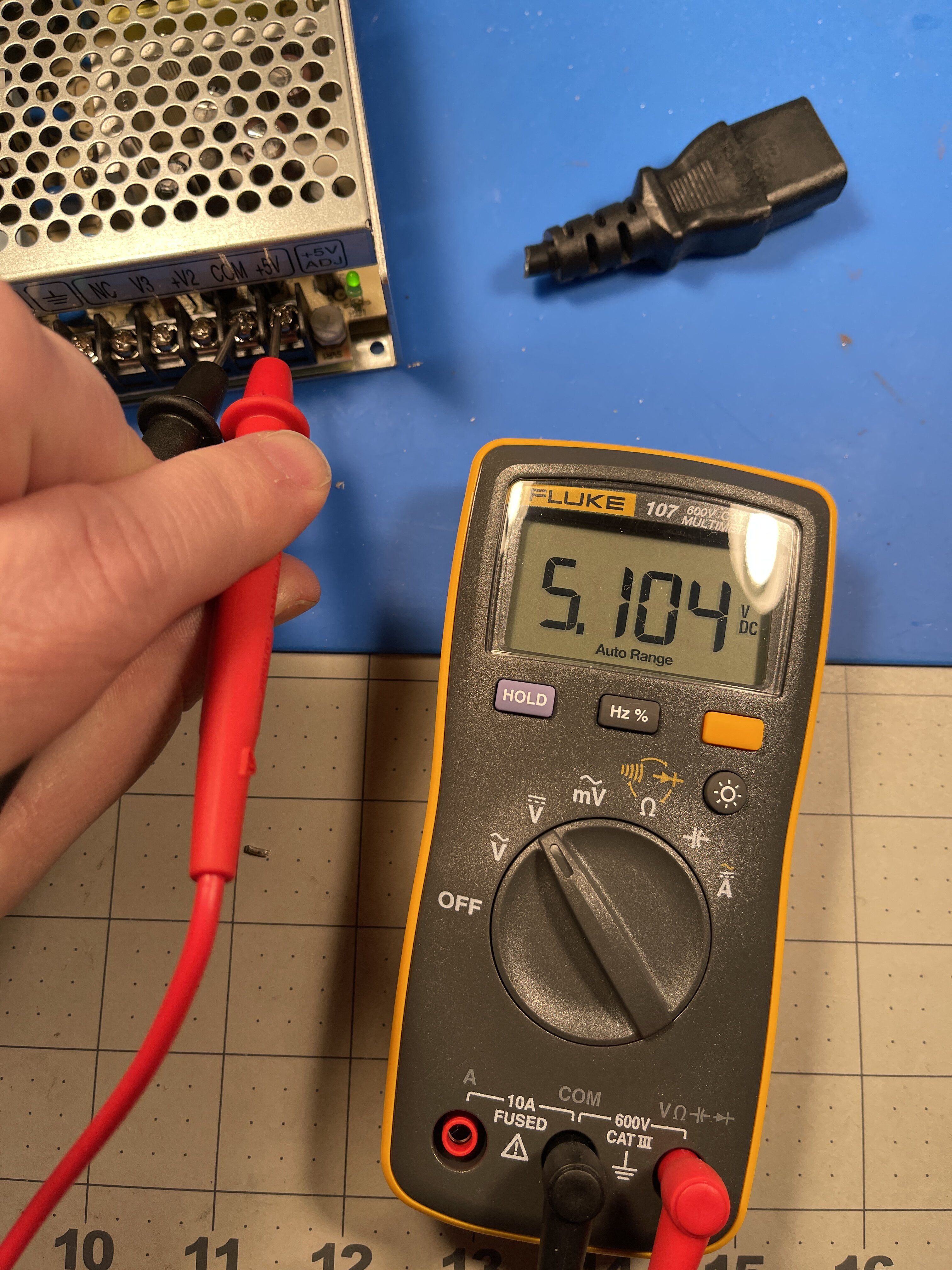

Plug the power supply in and verify your voltages.
  • +5V should be +5V
  • +V2 should be +12V
  • V3 should be -12V

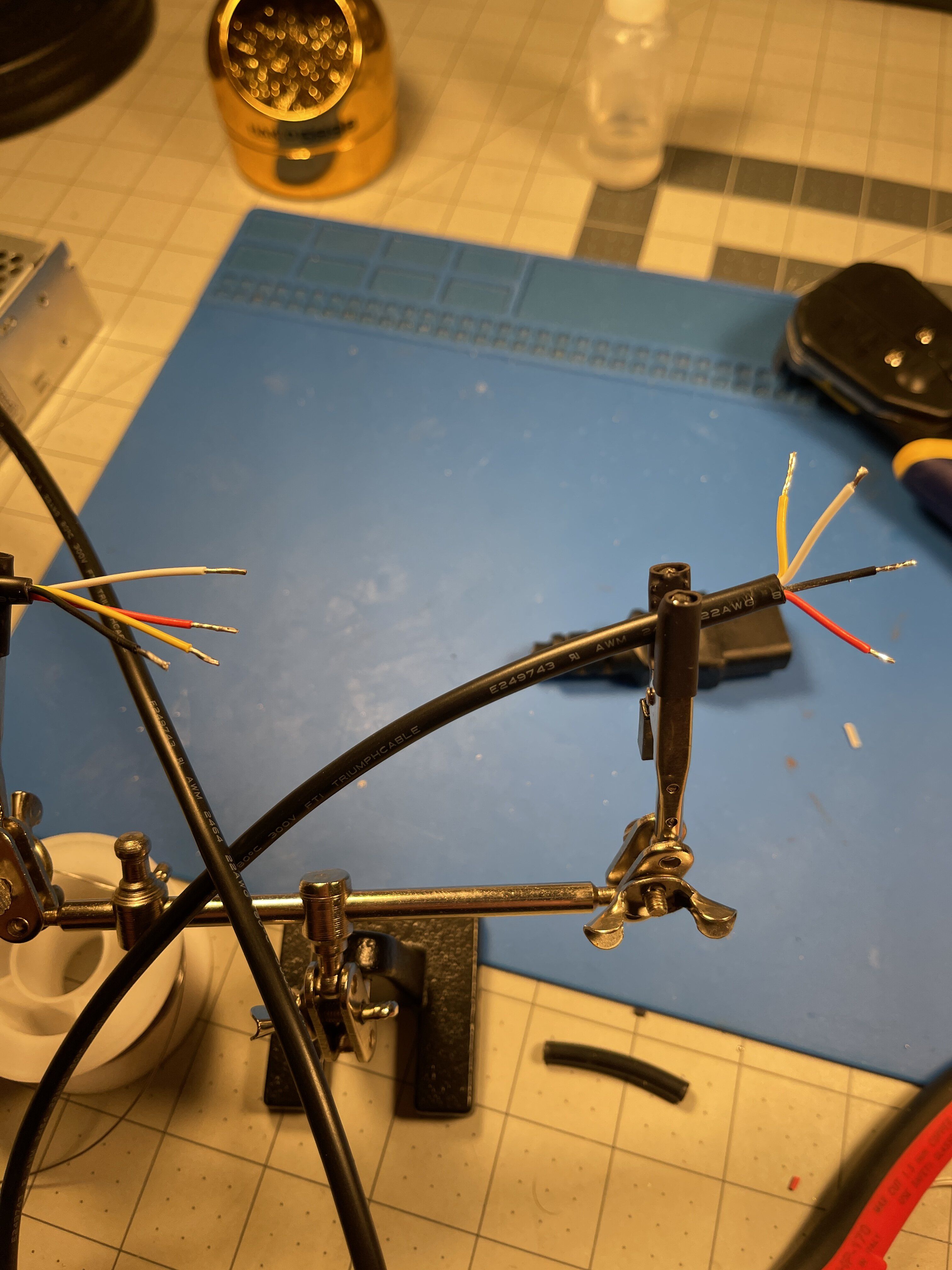

Cut the four conductor cable to length (I cut it to be as long as the C13/C14 side). Cut and strip both ends, the conductor wires, and tin.
For the purposes of this tutorial we will assign the colors as follows:
  • Yellow is +5V
  • Red is +12V
  • White is -12V
  • Black is COM

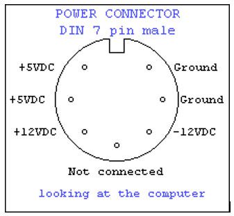

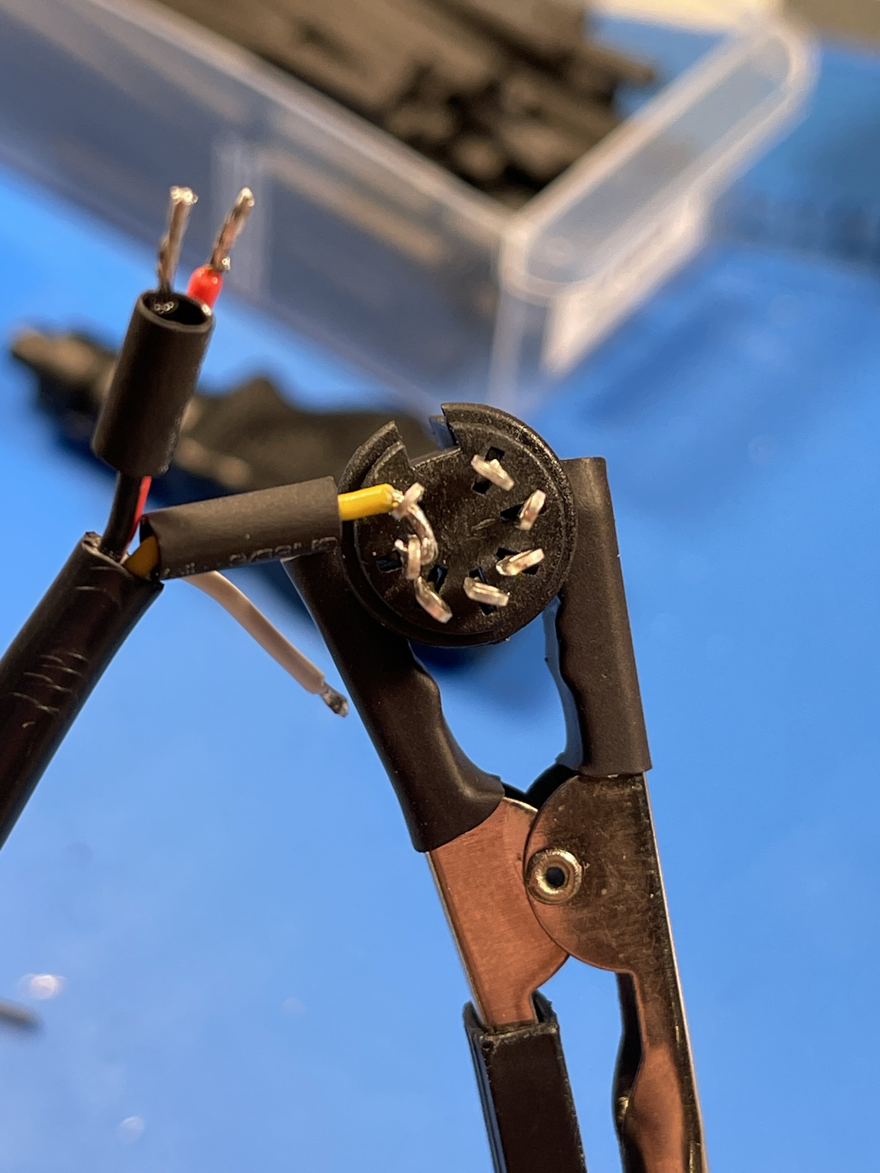

Consult the diagram above When you start to solder wires to the DIN connector, remember that the diagram is oriented as though you are facing the back of the computer, not the front of the DIN connector. Remember to add your heat shrink tubing before you begin to solder.
Step Seven

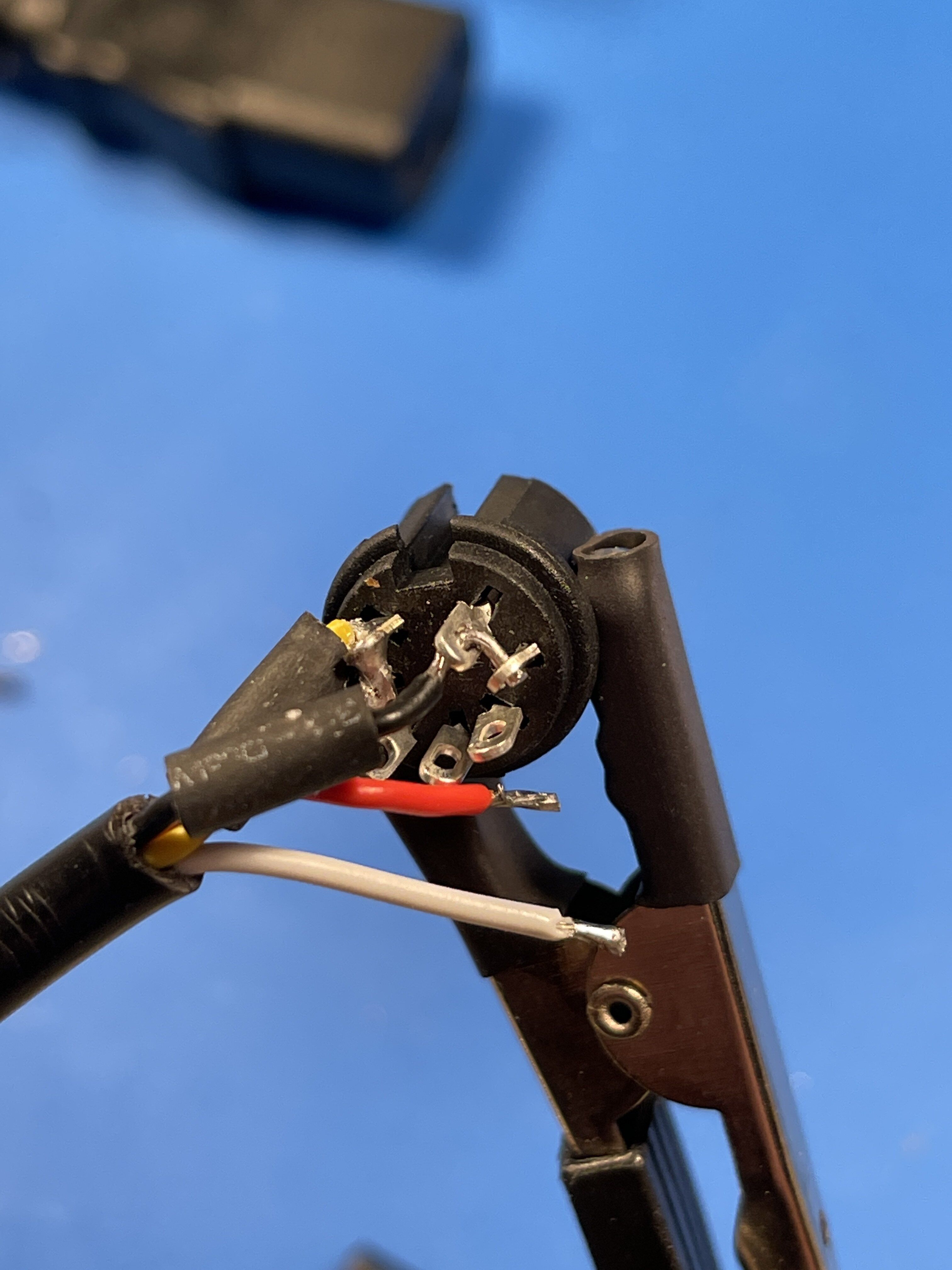

Bridge the two +5VDC pins with the yellow wire and solder into place.
Step Eight
Bridge the two Ground pins with the black wire and solder into place
Step Nine
Solder Red to +12VDC
Step Ten
Solder White to -12VDC
Step Eleven

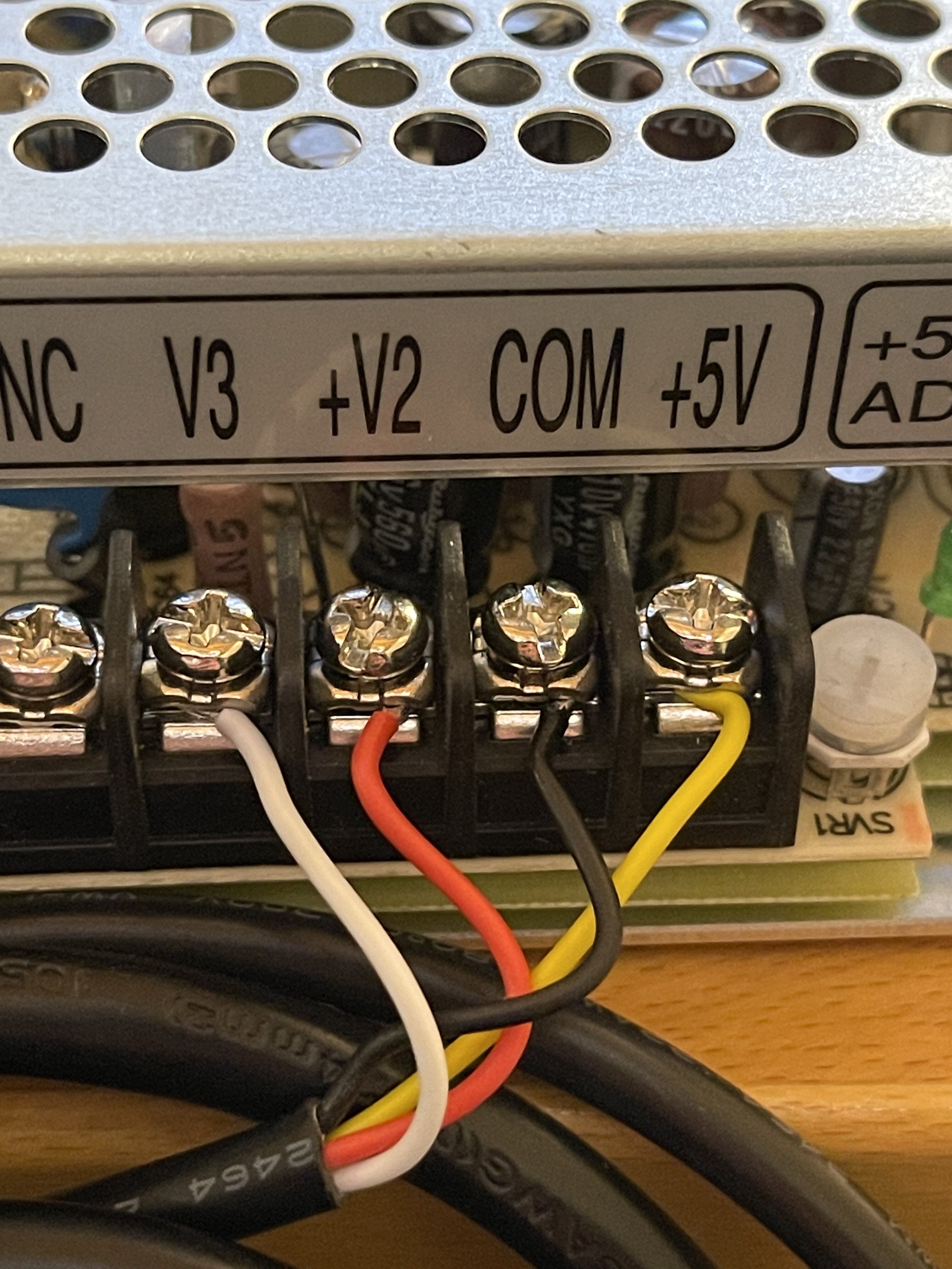

Attach the other end of the cable's conductors to the Power Supply as follows (Left to Right):
  • V3 = White (-12V)
  • +V2 = Red (+12V)
  • +COM = Black (Ground)
  • +5V = Yellow (+5V)

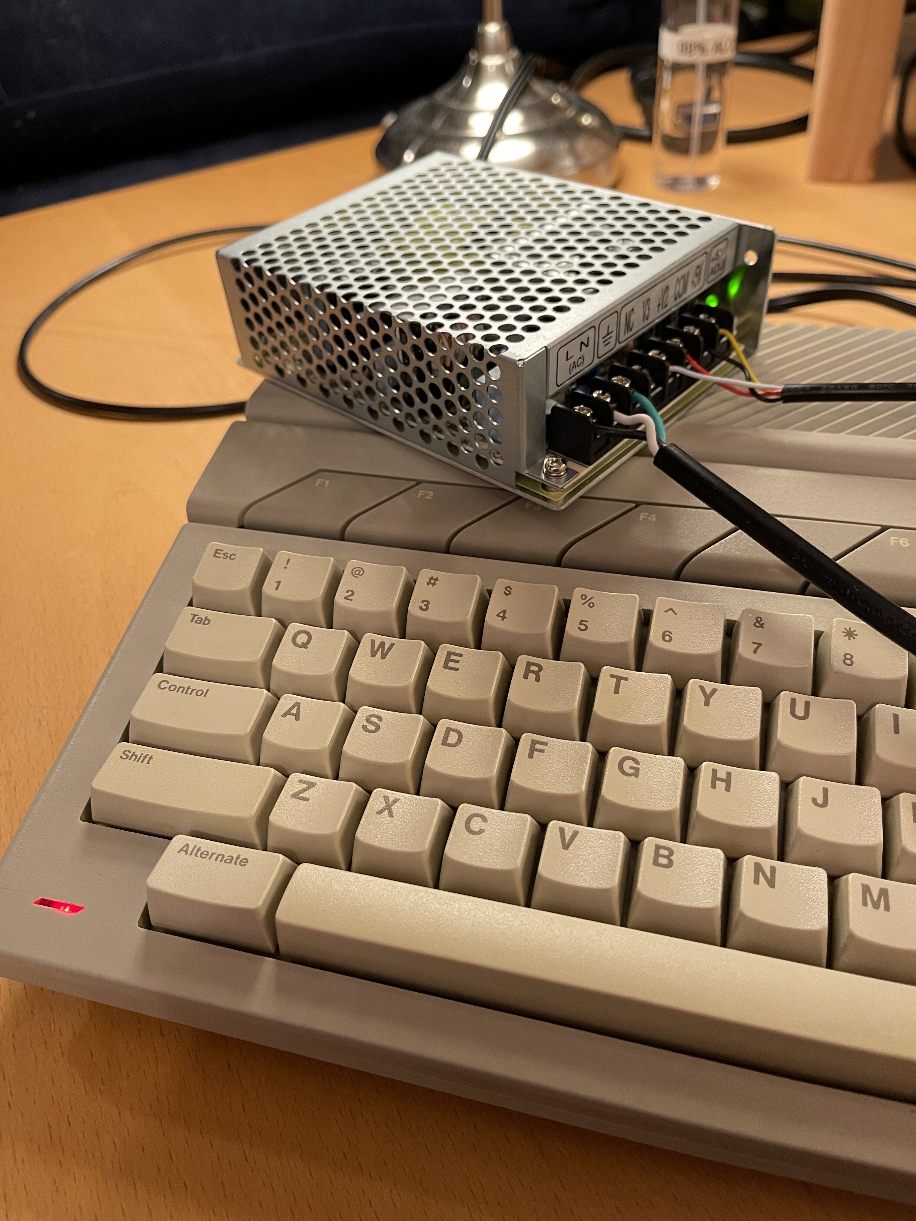

Plug in your power supply and test voltage at the DIN connector to ensure you have continuity and the correct voltage on each pin.

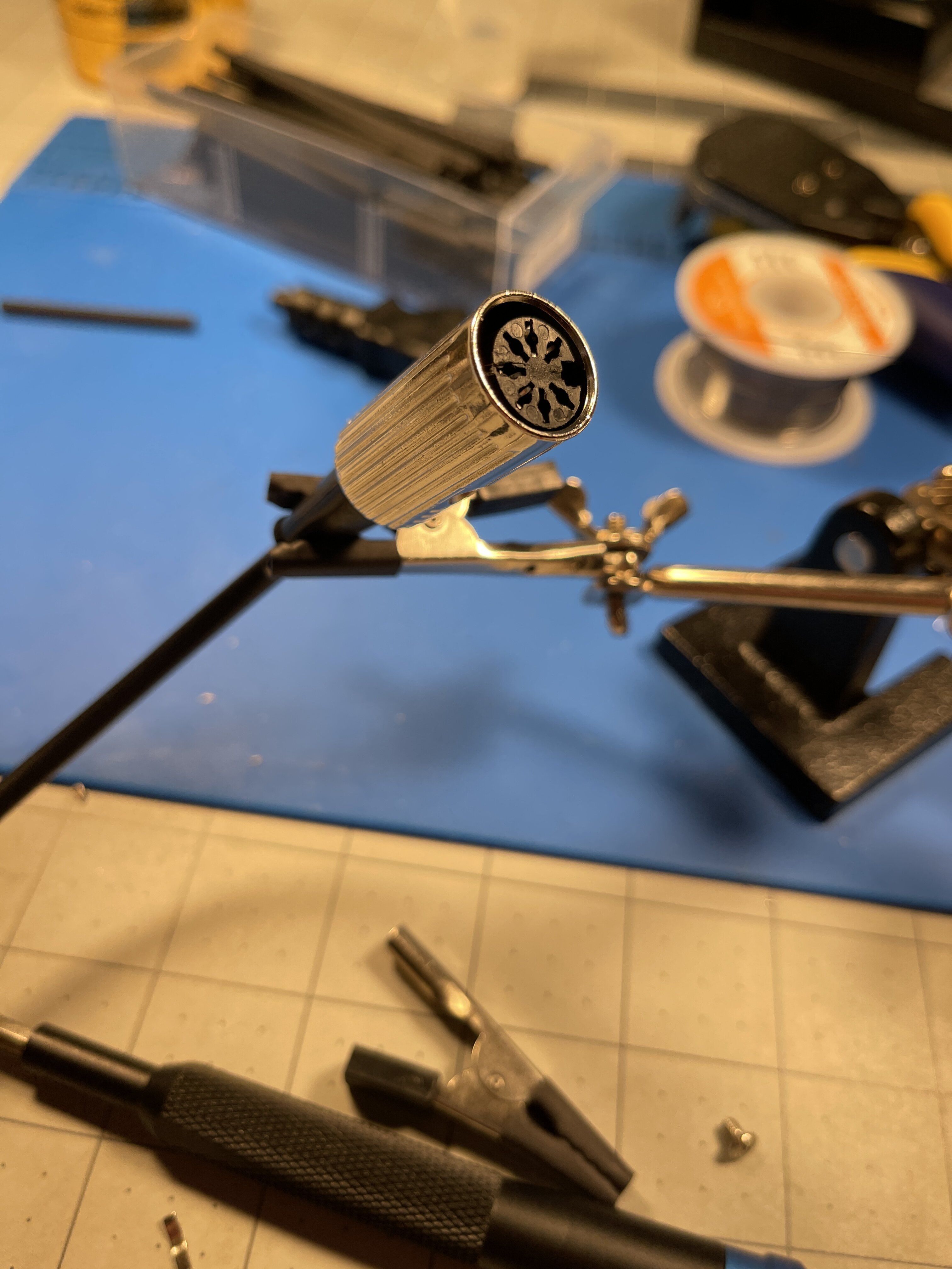

Step Fourteen
Assemble the DIN connector
