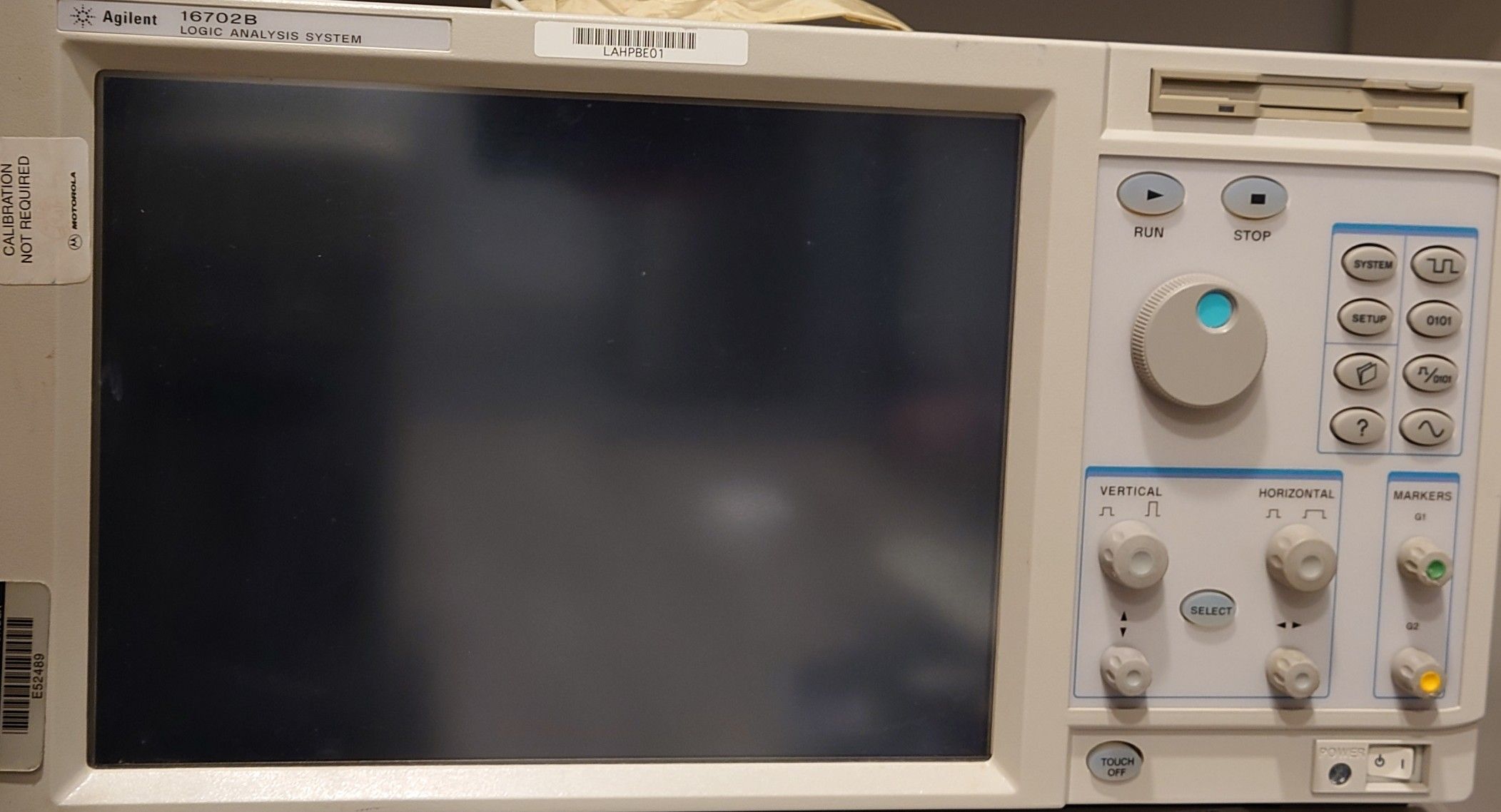

Quite some time ago I picked up an HP 16702B logic analyzer frame, and have used it for a variety of projects. But all this time, it has had one very annoying fault: the built-in display was not working. That's why it was priced so low, the used equipment wholesaler thought it was irreparably broken.

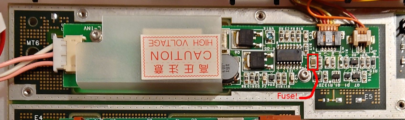

That statement about replacing the inverter unit caused some suspicion - why should the inverter need replacing? I've heard that CCFL backlights draw more current as they age, and there's a fuse on the board so naturally I tested it.
It's a strange translucent-yellow-orange color and the fuse filament is clearly visible inside - not visibly damaged. But the fuse measured 70k ohms, clearly too high to let meaningful current through.

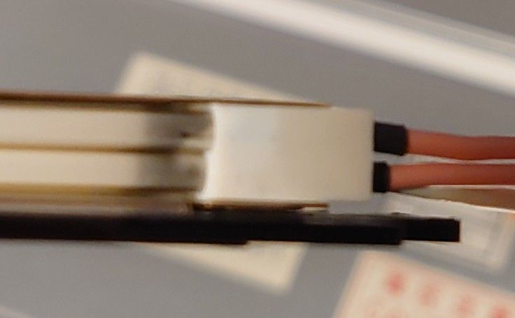

Examining the backlight tube on the old monitor shows some charring.
I pulled the fuse off the board and replaced it with what I had on hand: SMD 0805 polyfuse rated for 500mA continuous that will break above 700mA.
Started the machine and waited. And kept waiting (these boot slowly). Eventually the internal display turned on, and it seems totally happy now. No shimmering or blinking. Seems like it's fixed to me.
This means the frame chassis is expecting some sort of signal from the backlight driver that 'everything is ok' before actually enabling display output to the LCD. There was no image there at all before this, I checked with a flashlight. This made me think the LCD had actually died.
