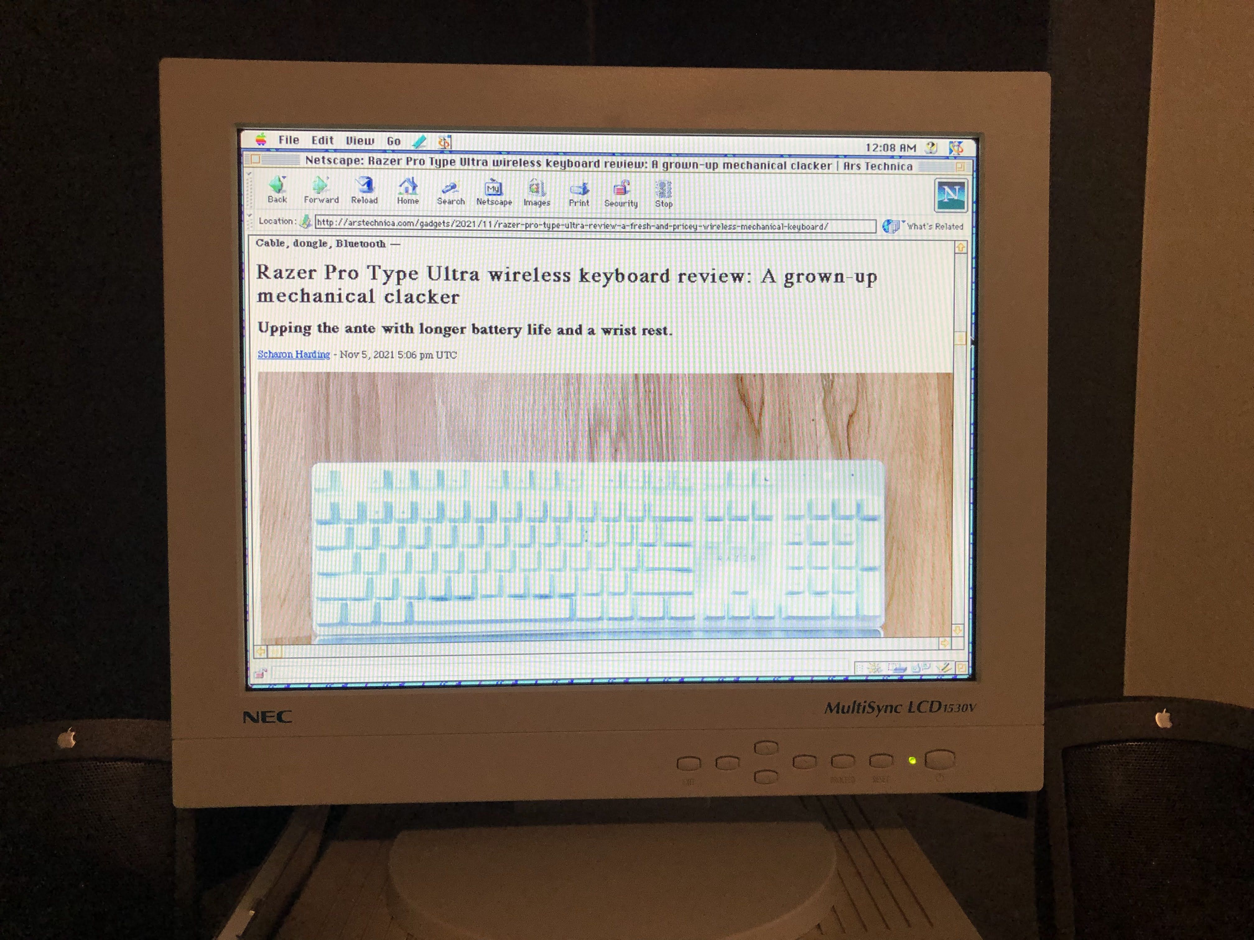

Figured out the easy way to get embedded images working! I tweaked the proxy logic to only modify the contents when content-type is 'text/html'. This way, any traditional embedded image (<img src="">) in traditional formats (jpeg, gig) work absolutely swimmingly on a higher-spec 68k Mac (Performa 476 below).
It slows down page loads in MacWeb on my Mac SE a bit since it has to handle a bunch of "image load errors" but still perfectly usable.

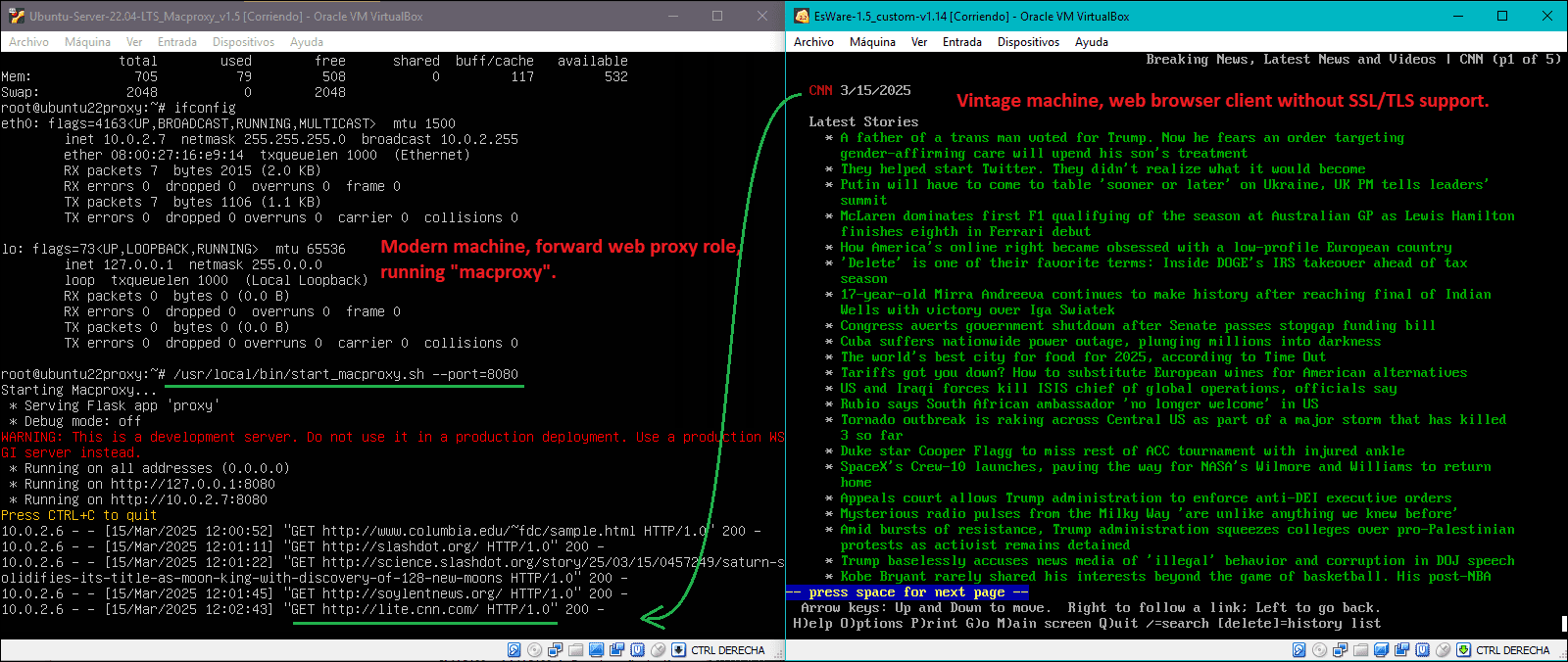

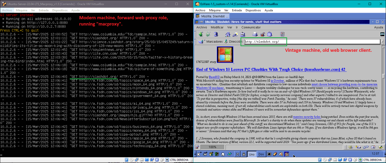

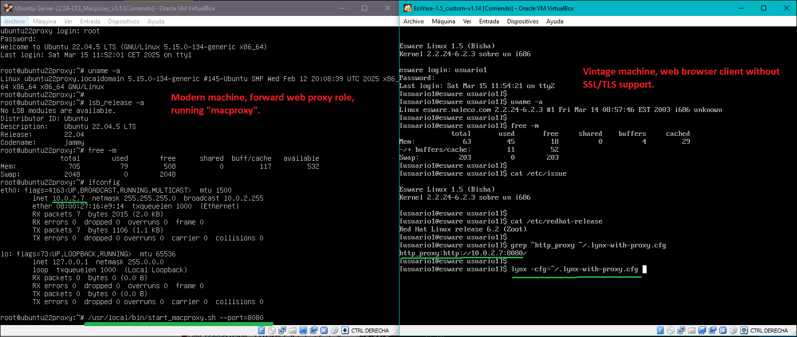

I'm using macproxy v24.8 and it works great. I run in on Ubuntu 22.04 and I have it set up as a systemd service, as described in its README.md file.
My aim is to use Lynx 2.8 and Netscape 4.7 on Red Hat 6.2 (the one released on year 2000, not the "Enterprise" modern version of Red Hat) to browse some "lite" modern web sites, like https://lite.cnn.com (where I can read great fake news and excellent propaganda). It works beautifully.

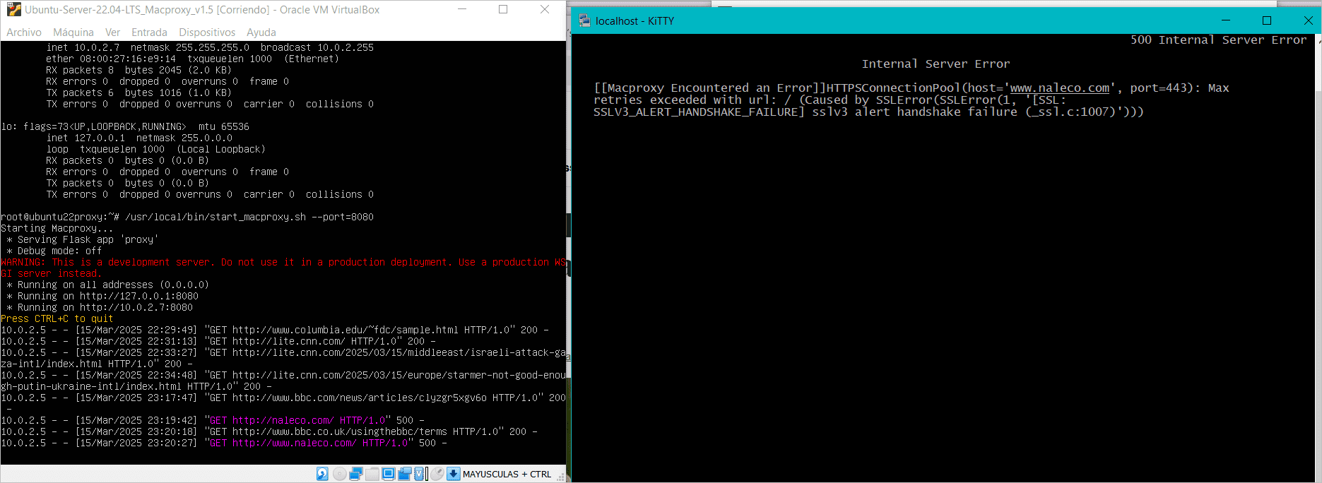

However, I have a problem where my setup (macproxy v24.8 on Ubuntu 22.04) cannot reach HTTPS web sites where TLS 1.0 is used as the only TLS/SSL option by the remote web server. I get the error message "[SSL: SSLV3_ALERT_HANDSHAKE_FAILURE] sslv3 alert handshake failure":
I understand this is not a macproxy problem per se, but caused by an UbuntU/OpenSSL default setting which is trying to sunset TLS 1.0 support.
I have enabled general TLS 1.0 support in Ubuntu 22.04's OpenSSL (by setting
Code:
CipherString = DEFAULT:@SECLEVEL=0
in the file "/etc/ssl/openssl.cnf"), but the problem remains the same.
So I guess the problem finally lies in Python itself, which in version 3.10 deprecated TLS 1.0 ( https://bugs.python.org/issue43998 ). And it so happens that Ubuntu 22.04 uses Python 3.10.
So does anyone per chance know how to force Python 3.10 on Ubuntu 22.04 to enable TLS 1.0 support? Any tips would be greatly appreciated.

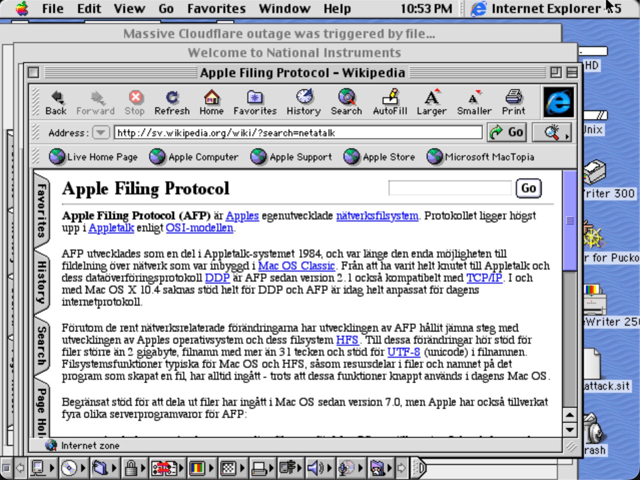

  • image conversion (jpg, gif)
Among other things, you can browse Wikipedia in your native language!
