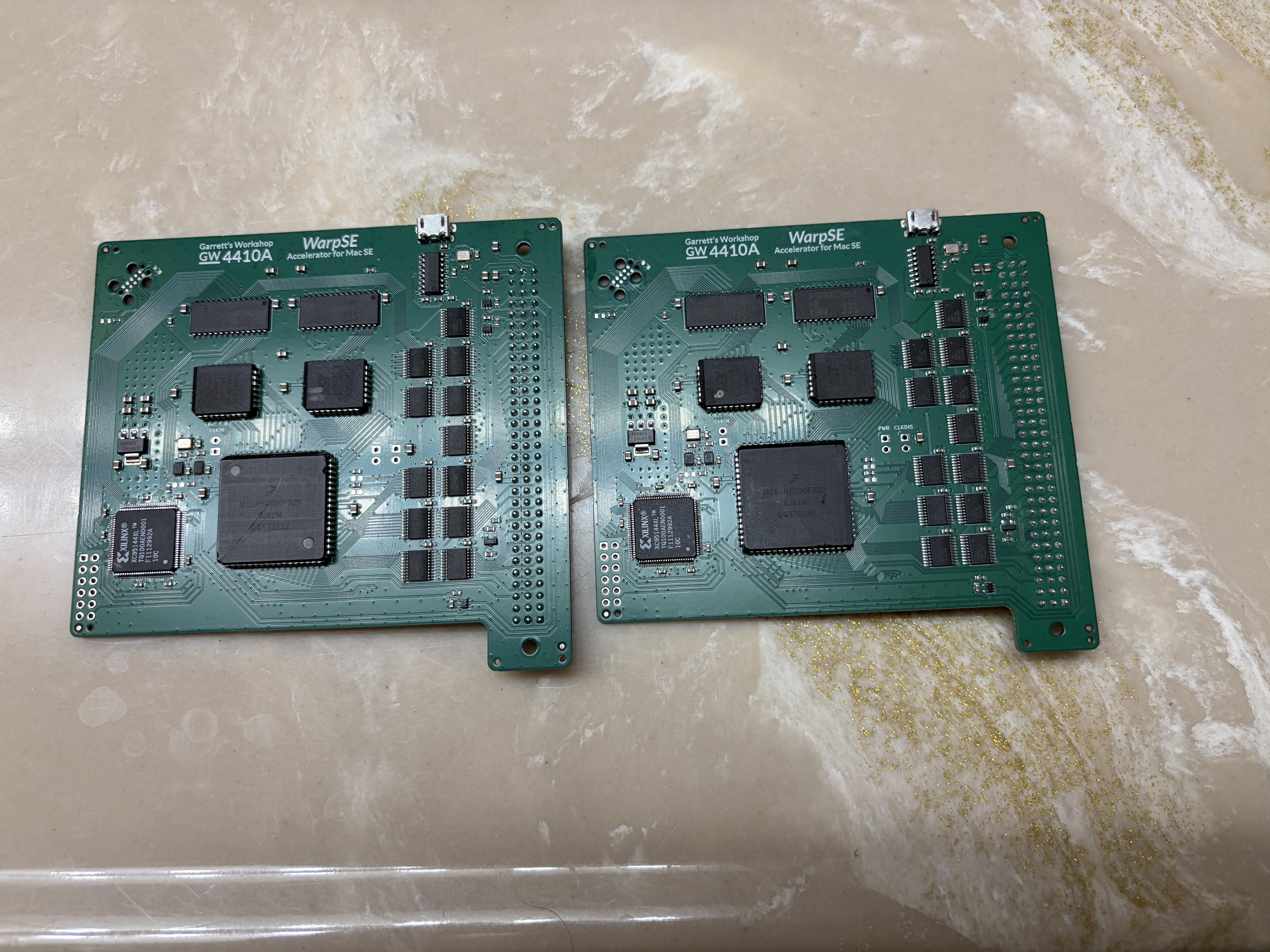

I reached out to someone I know and asked if they would attempt to build one for me. This would be a time and materials project. An order a minimum quantity of PCBs was made, but then we ran into a serious issue. We came to find out that the current PCB on the GitHub repo is not compatible with the current firmware. There were board level changes that have occurred, but the firmware was not updated to match. The only choice was to order another minimum quantity of an earlier PCB that was sent out the beta testers. Once these came in, everything worked as expected.

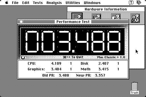

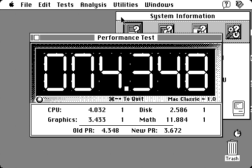

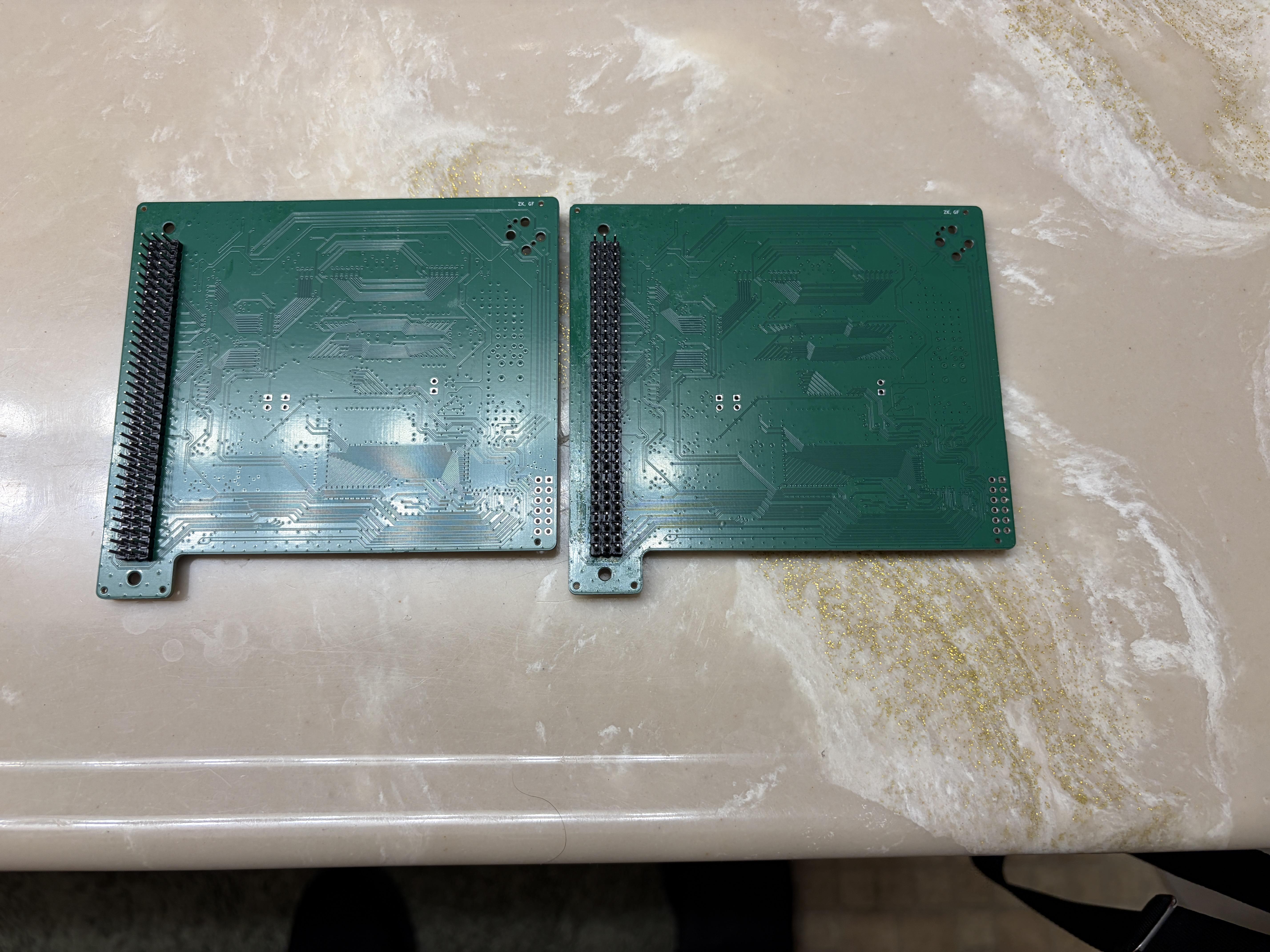

In the end I had two built. One to use now and the other as a spare or to go into another Mac SE in the future. This accelerator is really fast and totally compatible. It benchmarks just as fast a Mac Classic II and boots up in just seconds. I have run this through it's paces and there are no issues with software, the floppy, SCSI or audio. I am including some benchmarks using SpeedOMeter 3.23 for both a Classic II (it has an FPU card) and the SE with a WarpSE. I am also including photos of the two accelerators I had built.

Thanks @JDW for those kind and encouraging words. I am so glad this has brought some happiness to you today given what you have been through lately. As to details of the build, since I did not build the WarpSE I have I can only offer a suggestion. It should be possible to compare the boards I have had made to the PCB revisions on Github and find the matching one. The rest would be ordering, assembly and flashing the firmware. That sounds simpified, but that is exactly what the person who built these for me did. They went through the thread here on Tinkerdifferent and determine what PCBs were used for the beta testers. I will make an inquiry with the person who did the build and see if they can provide some specifics on what they did to pull this off.

Yes, but which previous PCB revision?
As I stated earlier the person who built these for me wants to stay out of the discussion. A visual inspect of previous PCBs from GitHub and/or the WarpSE thread here would have to be searched to find the exact one that was used. My only intent here was show that getting one of these is possible.
Looks like the PCB in the OP, is this one that Zane talked about on September 5th 2024:
Seems like this would be the correct era at Github, that the working PCB/gerber files would be found, (prerelease Rev.3 USB):
Maybe someone in the know can simply tell us if the above is correct, or if it's a later revision. The firmware would be easy enough to work through, it's the board revision that is expensive to guess.
