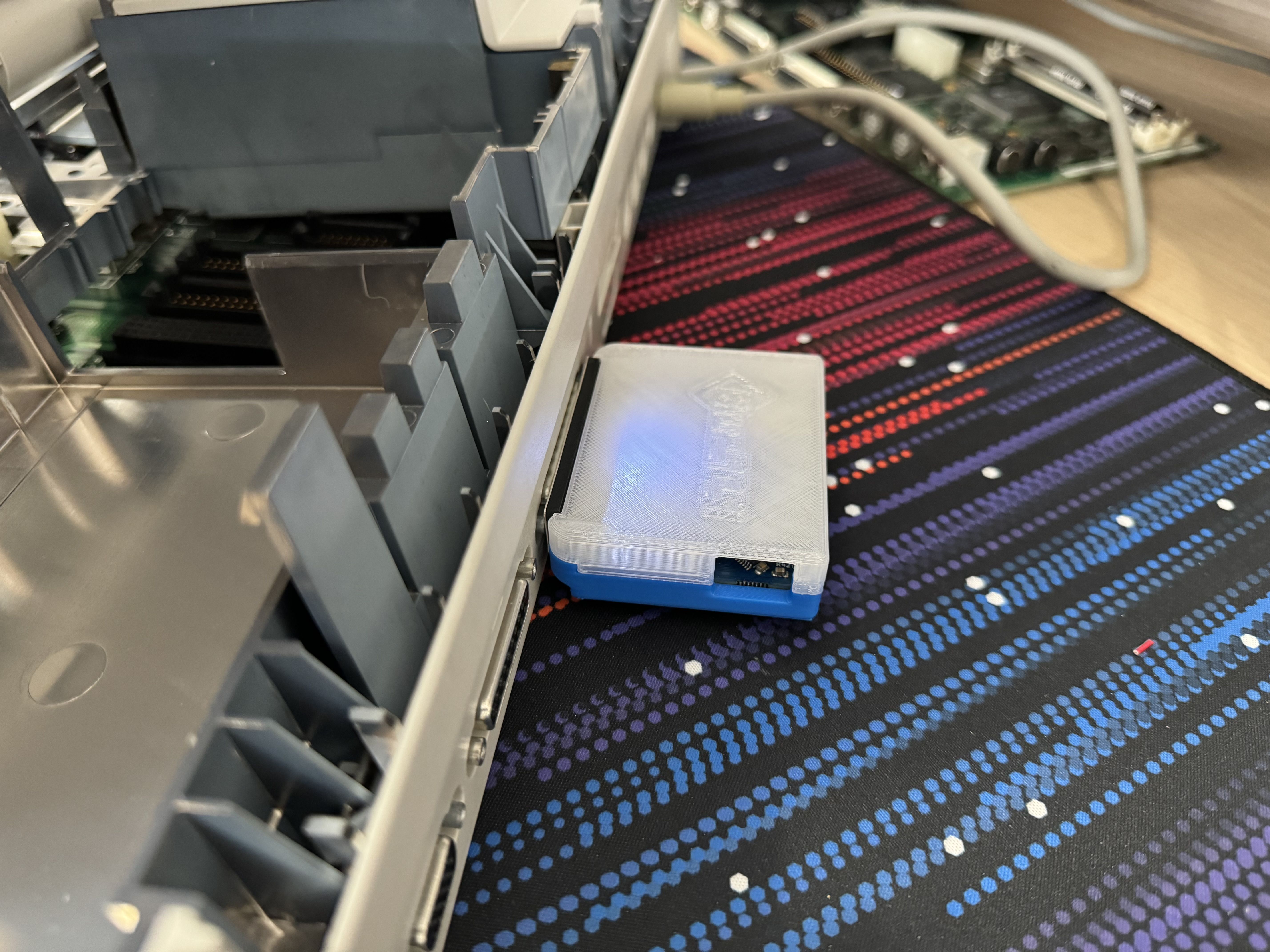

S SharedCow New Tinkerer Nov 9, 2023 5 6 3 Dec 25, 2023 #1 Added 5v to the termination power pin. Even managed to put the diode in the right orientation on the first try. Attachments IMG_1248.jpeg 2 MB · Views: 316 Reactions: pocketscience

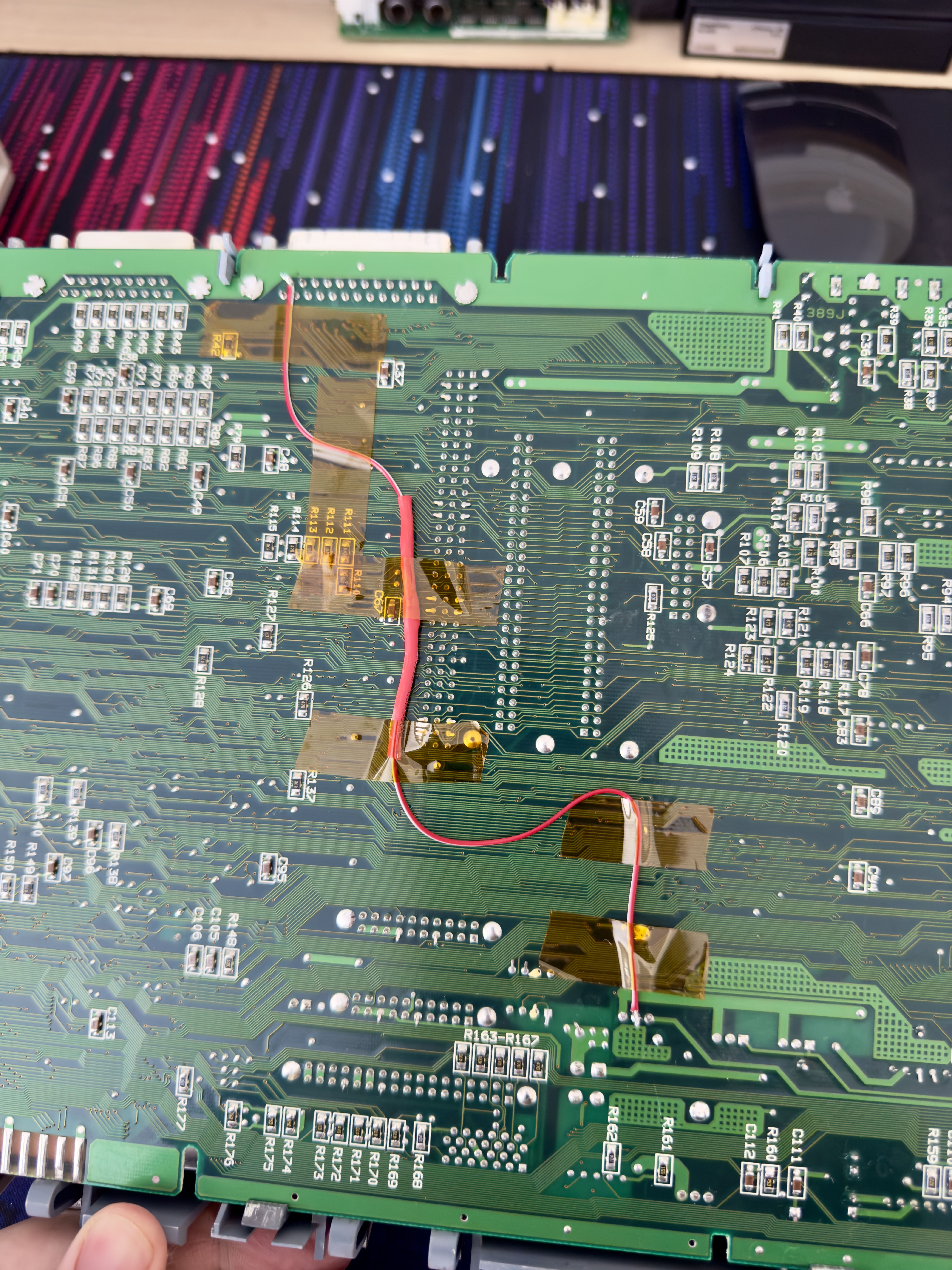

pocketscience Tinkerer Apr 29, 2022 261 185 43 Sydney, Australia May 1, 2024 #2 Where did you tap the 5V from out of interest? Any pics of your mod?
S SharedCow New Tinkerer Nov 9, 2023 5 6 3 May 1, 2024 #3 I tapped the main regulator, near the power in. Q16 I think? Check all those for 5v. Sorry, I don’t have the machine anymore.
S SharedCow New Tinkerer Nov 9, 2023 5 6 3 May 1, 2024 #4 Hey look, I found a pic I took of it! There’s a diode inside the red heat shrink tubing. Reactions: pocketscience, Elemenoh and Androda
