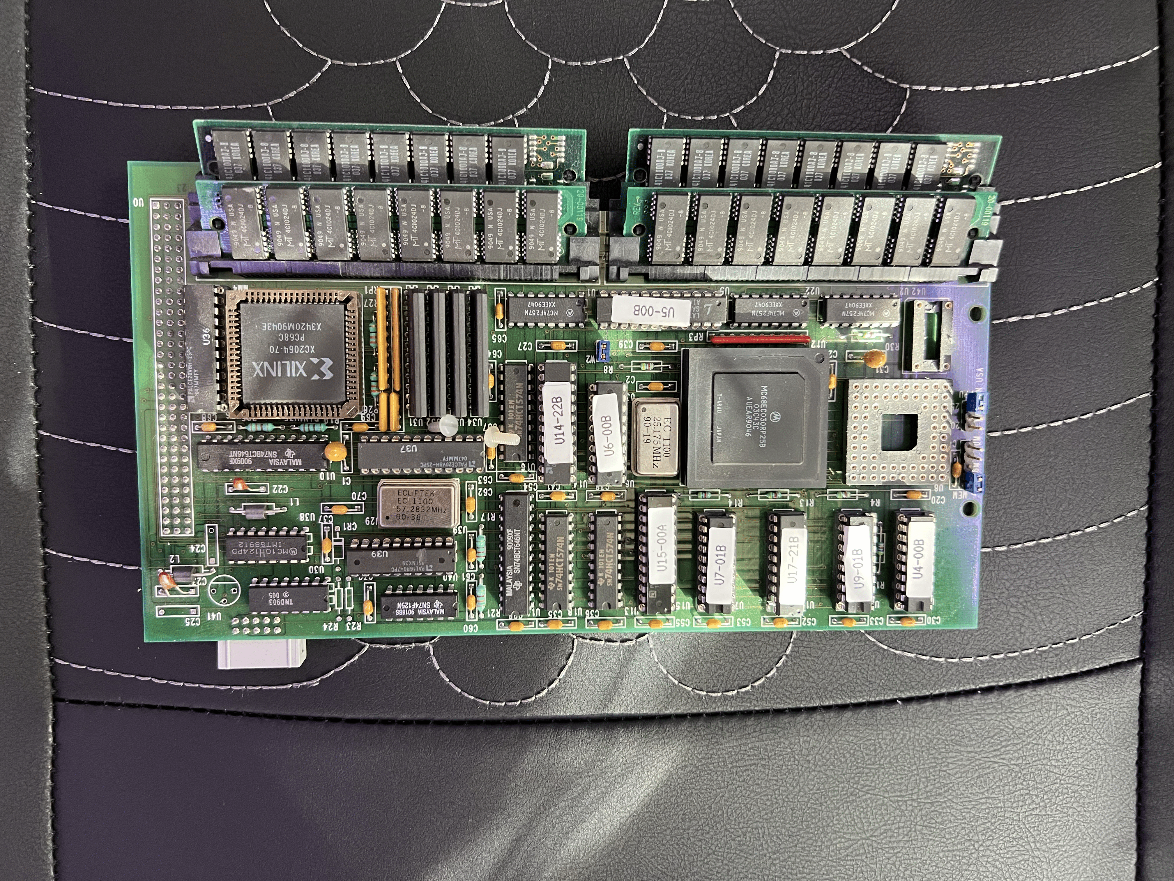

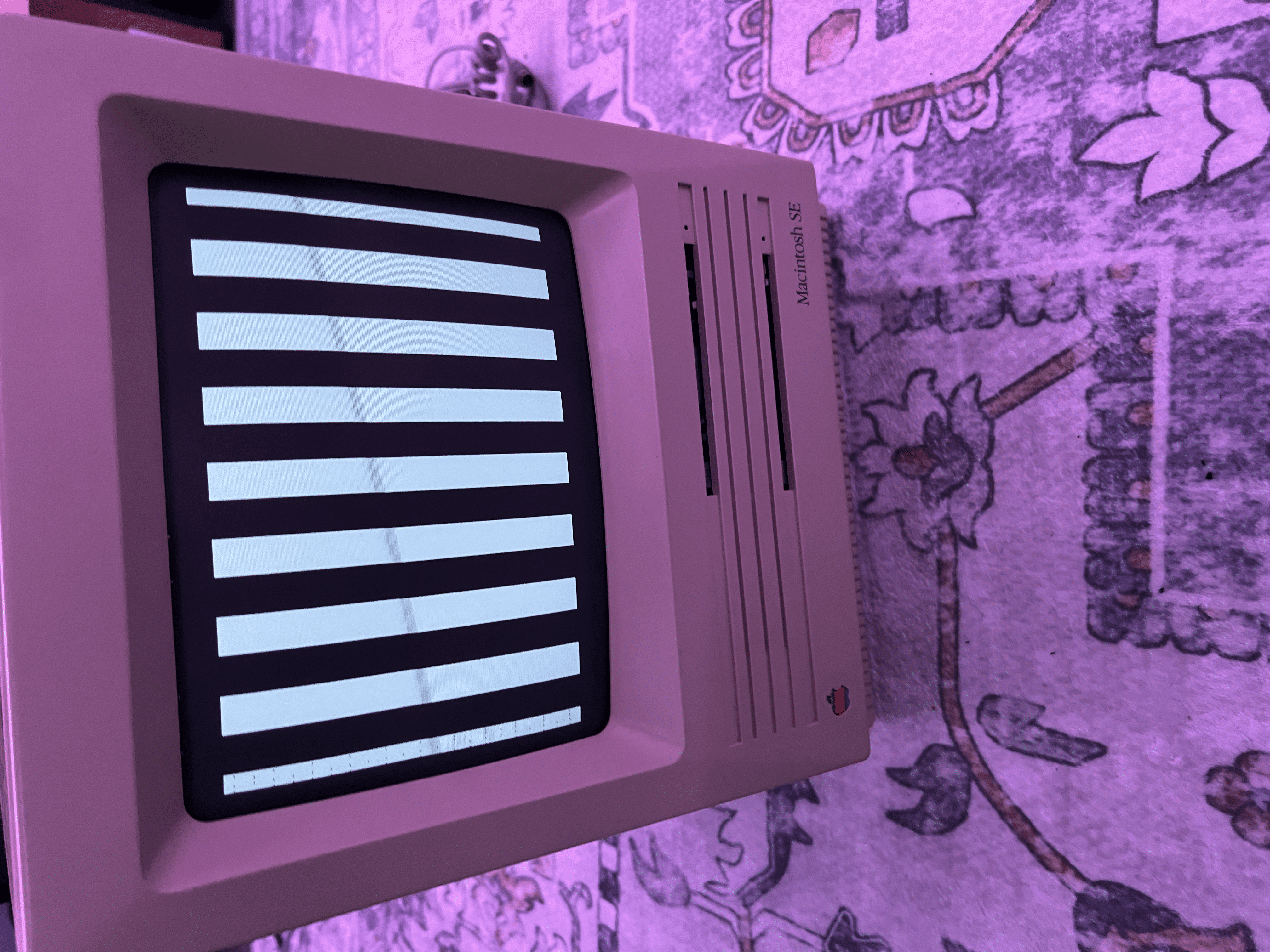

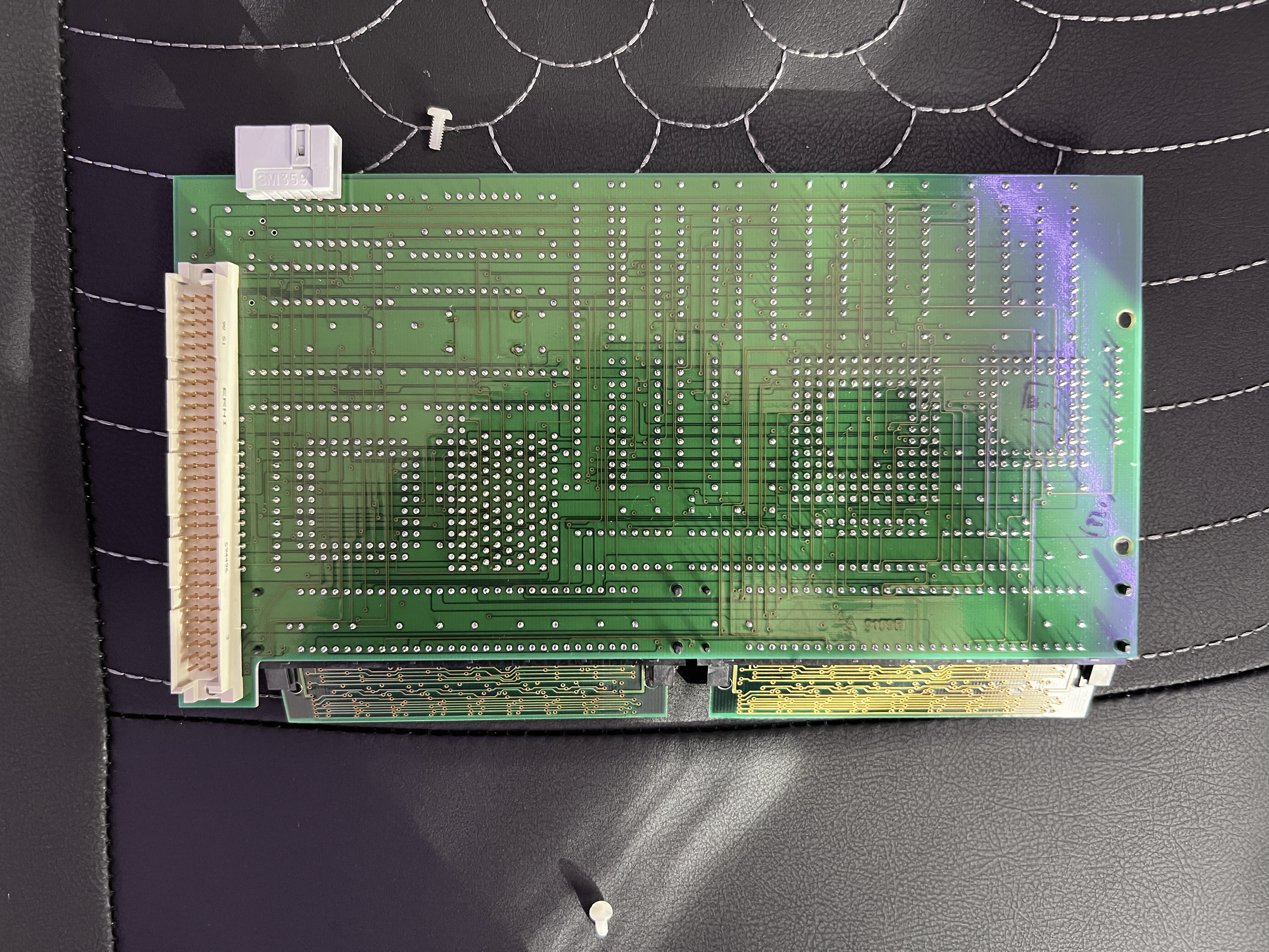

For context: About a day ago I had picked up a macintosh SE off of marketplace for about ~100$ with a keyboard and a few ADB mice, the computer was sold as for parts but was in otherwise in good condition, I got home and plugged it in on my bench and it didn't boot properly, showing the dreaded jail bars with no chime, I decided to take a crack at repairing it and took it apart. After sliding the logic board out, I noticed that the PDS slot contained a rather large card that has a 68030 CPU on it along with some ram and an FPGA, just for testing, I removed the card and plugged the board back in, and it seemed to boot fine with out the upgrade card, so that's mystery solved, the analog board, power supply, and motherboard's caps and battery all looked fine (although I will keep an eye on those).
After playing around with the SE, I turned my attention to the upgrade card and I couldn't find any markings on who made it or what it's specifications are, it also seemed to have a header for a vga output port, which was mounted to the back of the SE30, so I'm assuming that this might be able to do video out or something.
Either way, I've attached photos of the card and the failure it produces on startup.
Does anybody know what the card is or what's wrong with it, and how I might be able to go about repairing it? Thanks.

Looks like the Mobius 030 without the FPU - found halfway down this page:
From the above link:
MU 1993.06 (photo) Pinouts
Mobius 030: SE, Classic (25, 33MHz, opt FPU, 16MB)​
by Mobius Technologies Inc., Emeryville CA (TIL04628)
Clip on, Extended Video
Reactions: JDW and JeffC

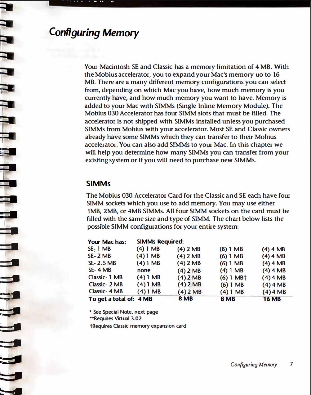

Regarding the Mobius not working: looks like you have the 25MHz version and according to Page 7 of the manual listed above, I'd guess you're having a memory issue. The manual says you need to have all the same size and type SIMM modules, it looks like you have two different types in there. Maybe try a matching quad set.

Yeah, as others have said that looks like a Mobius.
You can either use their drivers, or the GemStart driver works just fine with it too.
I'd be suprised if it was VGA - are you sure it doesn't have 9 pins?
It does do video out - depending on the option yours came with... pause... yours is a Full Page Display (portrait) version I think, with the 57MHz clock. Some did Two Page Display, but they have something around a 100MHz clock in the same location.
I've not bothered getting mine to do video - mine is also Full Page, it is a bit of a funny resolution and doesn't work very well on any of the monitors I own because it is taller than it is wide.
I would assume the card has memory that worked at some point and is set up right. My assumptions would be that the contacts on the connector need cleaning, or that the PSU is a little bit weak and the voltage drops just too low with the card installed.

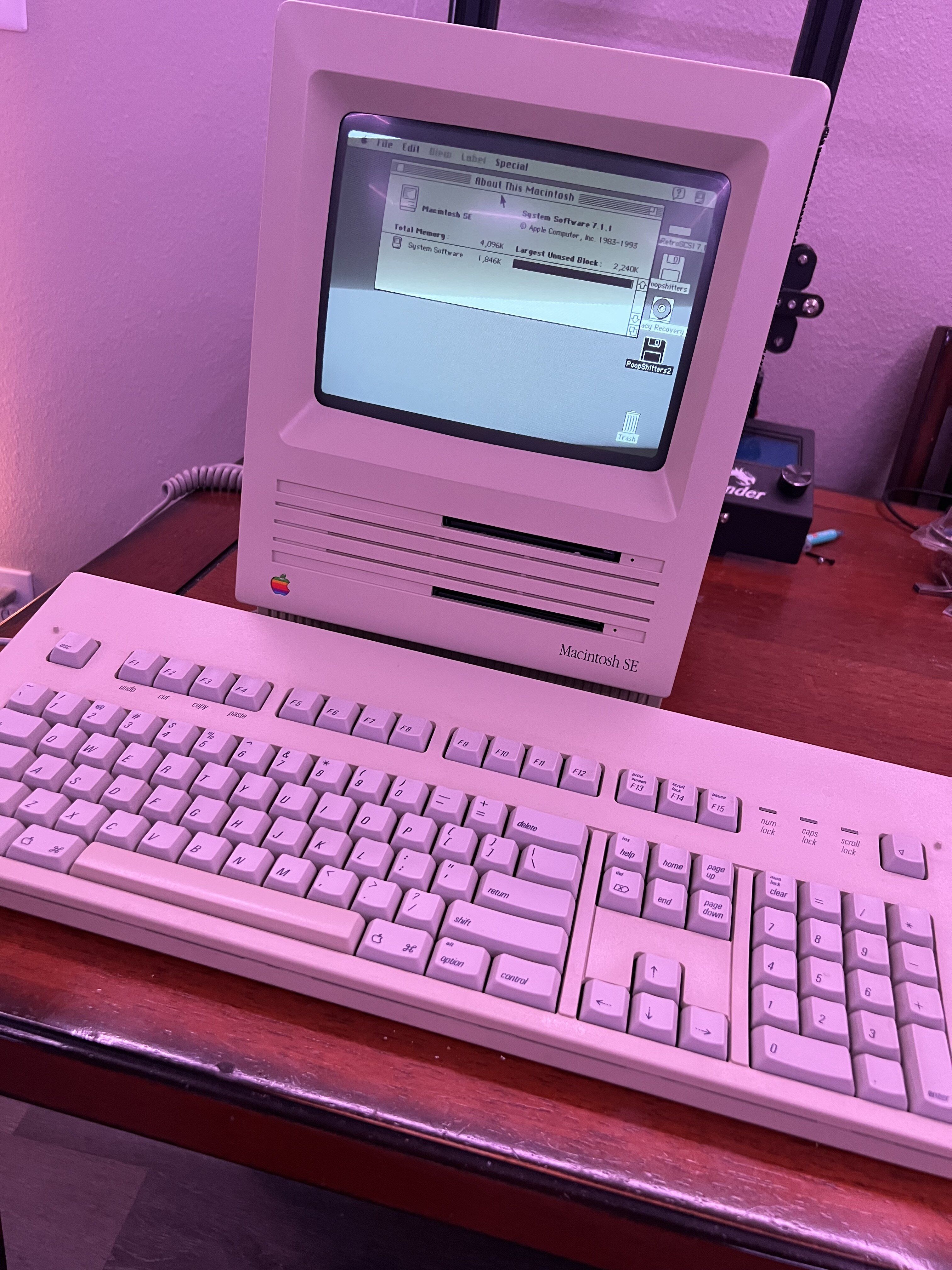

Update, so I did get it working and installed system 7.1, I solution was to reseat the 68EC030 CPU, and that fixed it. mystery solved I guess.
