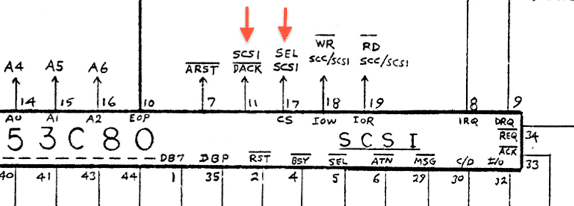

There were four pins that connected directly to UD11 - all showed good continuity. There are 8 data pins that are shared with UD11 - all of those showed good continuity.
There were two pins that I didn't test from the SCSI chip because I don't know where they go. Does anyone have an idea where these connect? I'm not familiar with the abbreviations.

Those will probably be connected back to the CPU or the Memory Decode Unit, but I’m not sure which. SEL is the chip select so that the SCSI chip knows the CPU is trying to talk to it, and DACK (Data ACK) signals back to the CPU that the CPU read/write to the SCSI chip is complete.
