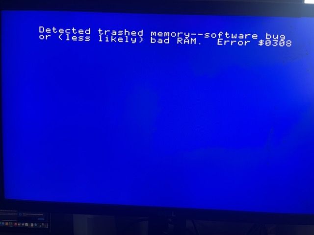

I have ran into an issue that I am going to try and problem solve. When I launch the latest edition of Script Central (2022) I get a bad software, less likely bad memory error. Really interesting. I don't get this issue with the 2021 issue, I run into the problem even if I am trying to run the hypercard sub stacks that the front facing stack pushes too.
I am going to attempt to install the apple squeezer control panel installer and see if I can resolve issues by messing with settings. I am also going to attempt to move the stacks over to a larger hard drive and see if the problem is because of a corrupt disk image.

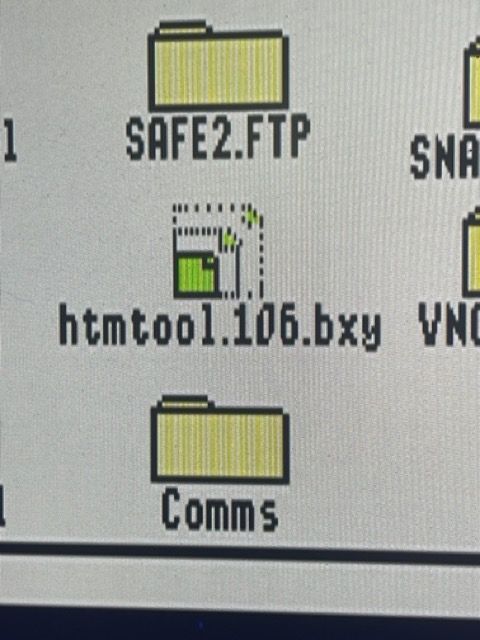

I also have ran into a bit of a brick wall when it comes to loading webber. It constantly looks for the HTML Tools file...I am going to attempt to transfer that over to my iigs from my Mac. I am not 100% sure how to get this as it seems that Apple has hidden all the old FTP settings from within the System Prefs. I am sure I can muck around and turn it on via command line.

Script Central 2022, is that the HyperCard IIGS thingy from this? It sounds like you may have found a bug or two. Can you get in touch with the developer? Can you post screenshots?

Okay, to further document the errors I am getting. I was able to download the HTML Tools using the Safe2 downloader tool. Its nice that I can point to a file on an HTML site and it just downloads.

I unpacked all the files and replaced tools, and fonts, and I am still getting issues with Webber. At this point I believe that I should just over with a new system disk, fresh install and start from scratch. I still get a "make sure the tools, fonts, etc" are installed" on boot.

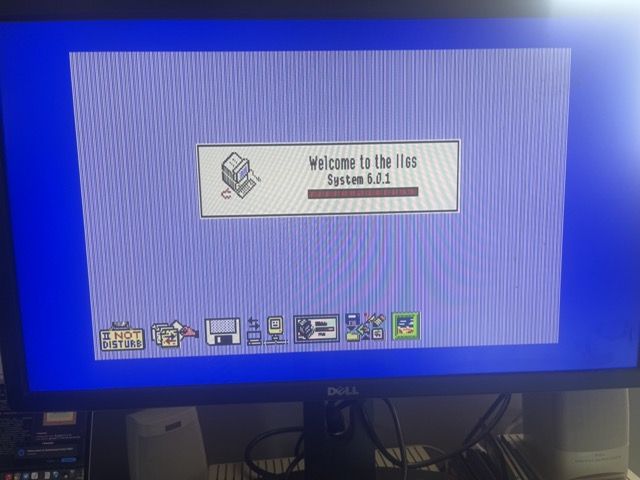

So, I decided to mess around with installing the Apple Squeezer control panel. Everything seems to load and install quickly, I am already using the latest core 4 version of the Squeezer, so I didn't need to update. I decided to untangle the "extra ram" feature and restart to see if I would fix any issues with the 2022 Script Central. (by the way, I emailed Brendan at Silverwand software. He thought it was an interesting crash, and didn't have a real solution.
Upon reboot after I unchecked the don't use extra memory I couldn't get my system folder to allow me boot up. I tried to boot up from all other system drives I had on my booti and all said can't find Pro Dos. Interesting. I eventually reinstalled Garret's 8mb card and was able to boot up. So the uncheck is really a check.
