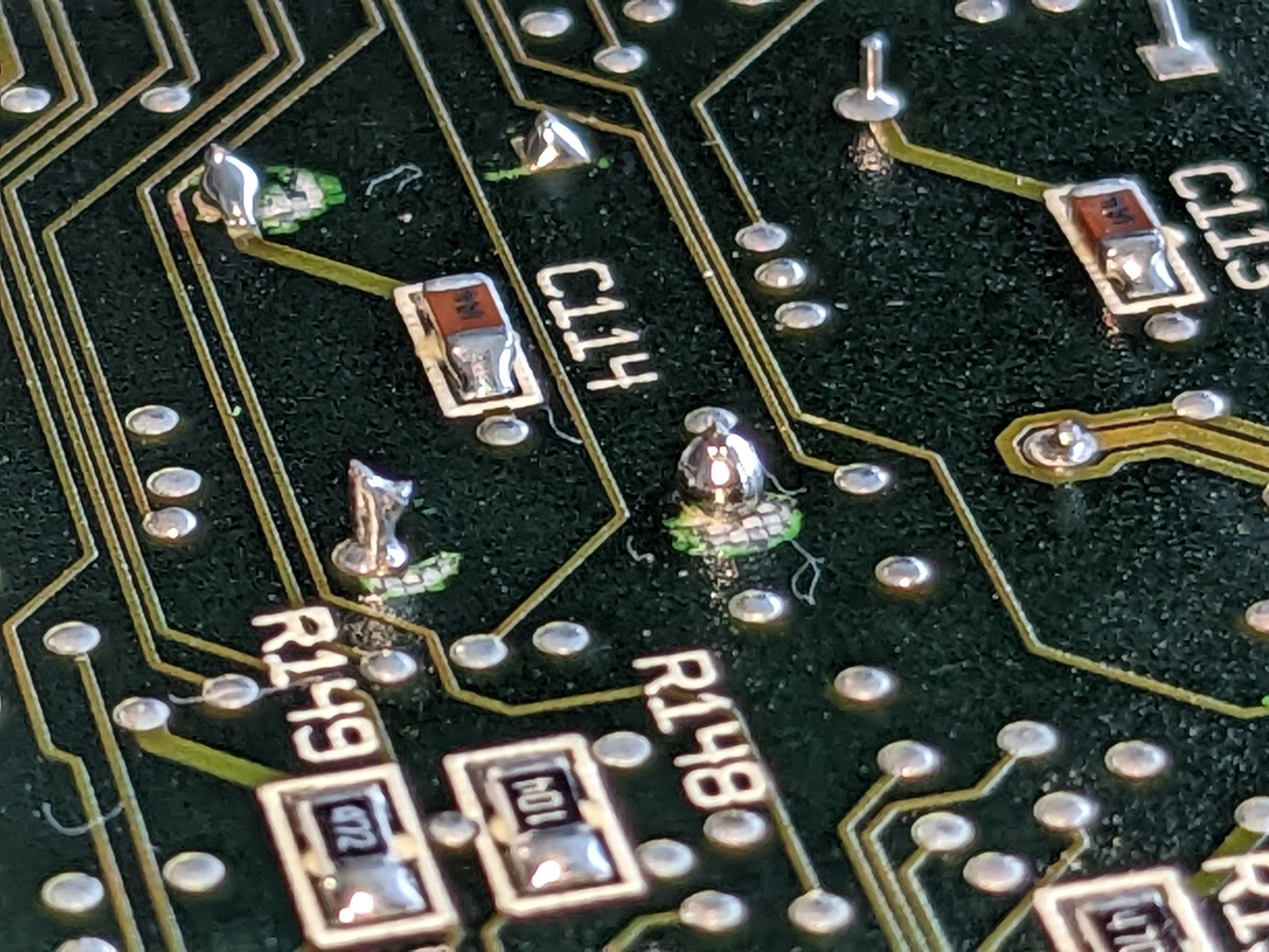

The machine is recapped with polymer caps and the board was cleaned as thoroughly as I could with IPA (a soak for an hour followed by a thorough brushing with a toothbrush. I do not have an ultrasonic cleaner. The PSU was recapped as well. The only rework done was bridging two small breaks between the pad and trace on two legs of an ALS245 chip. The board is overclocked to 25mhz, the person that installed the 50mhz crystal in the past did a butcher job, but it functions just fine. Pic of that mild carnage below. I doubt it is involved in the issue, but it never hurts to mention the small stuff.

Photo of crystal hack-job:
