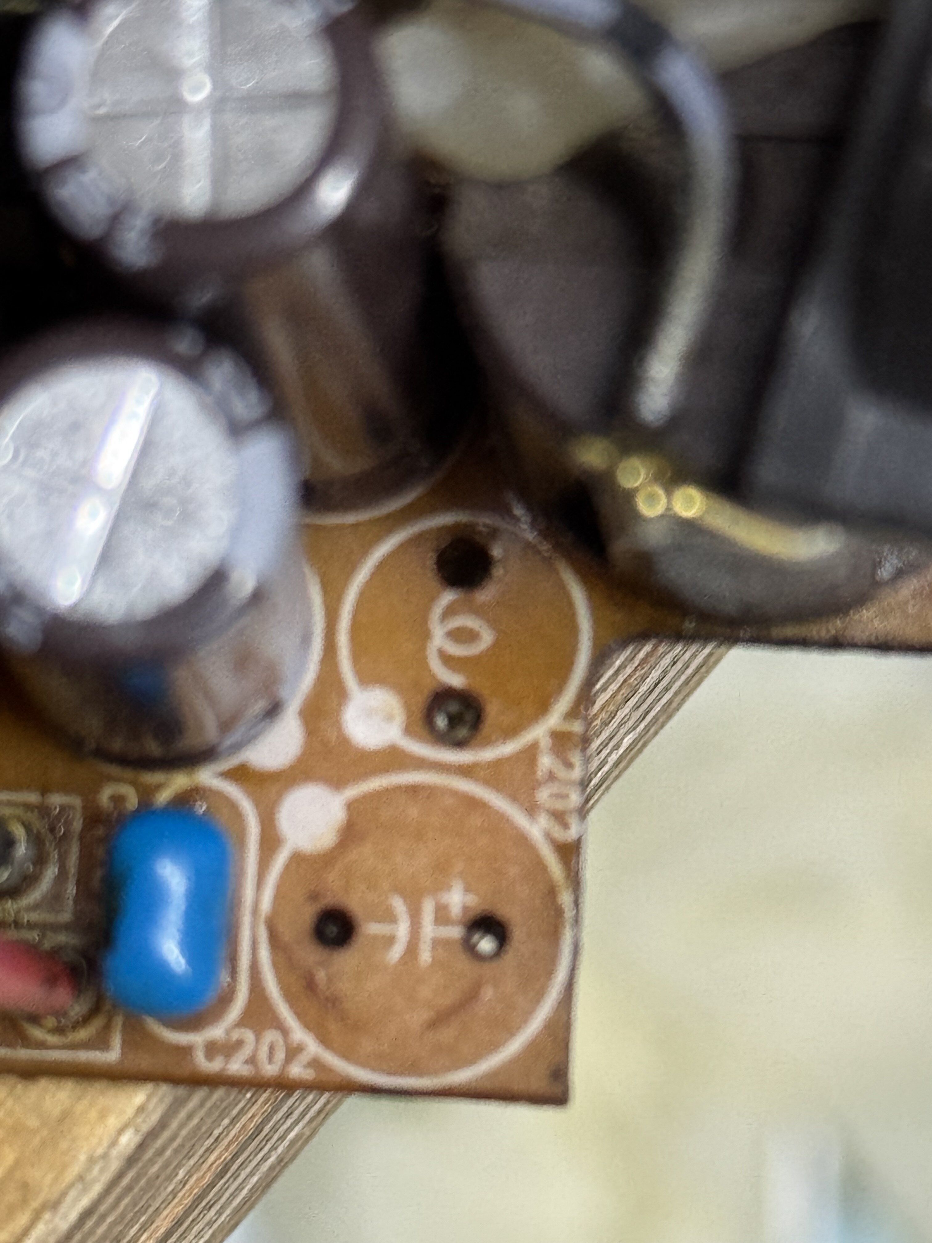

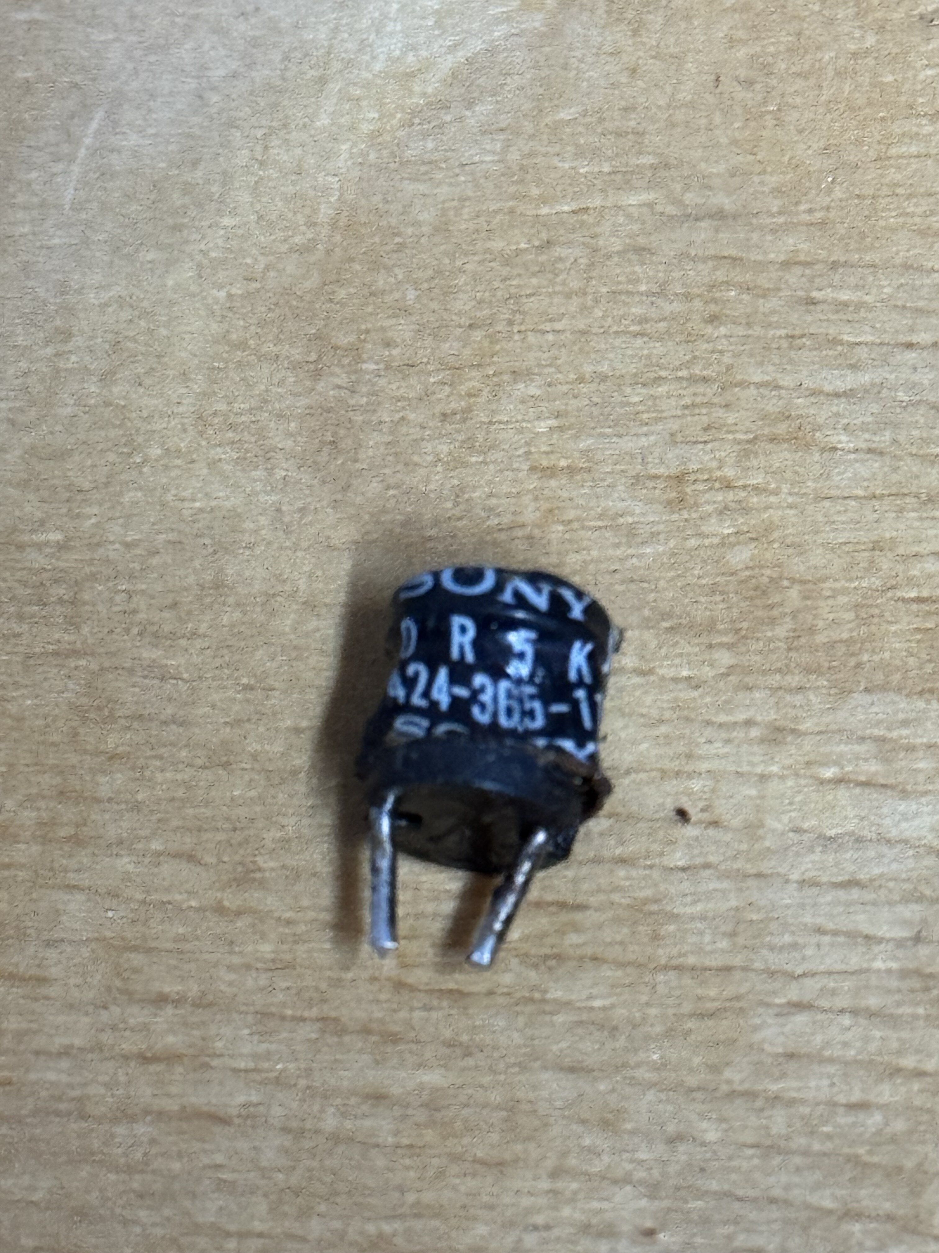

Hi all, I just received a IIsi with a massively leaky power supply. Got it more or less cleaned up and all caps desoldered. Unfortunately a part got destroyed which I cannot identify, Can someone help me where to get a replacement? Thank you so much!

I don't have an exact part number for you, but I measured L202 to be 0.4uH. Inductors of that value appear to still be common today, though what current rating that one is capable of I'm not sure.
Reactions: AlexMac
Thank you so much! I just reinstalled the part and system powers up. Even a chime is coming. But sad Mac crash sound right after it and no video - any ideas? PSU seems to be ok though
