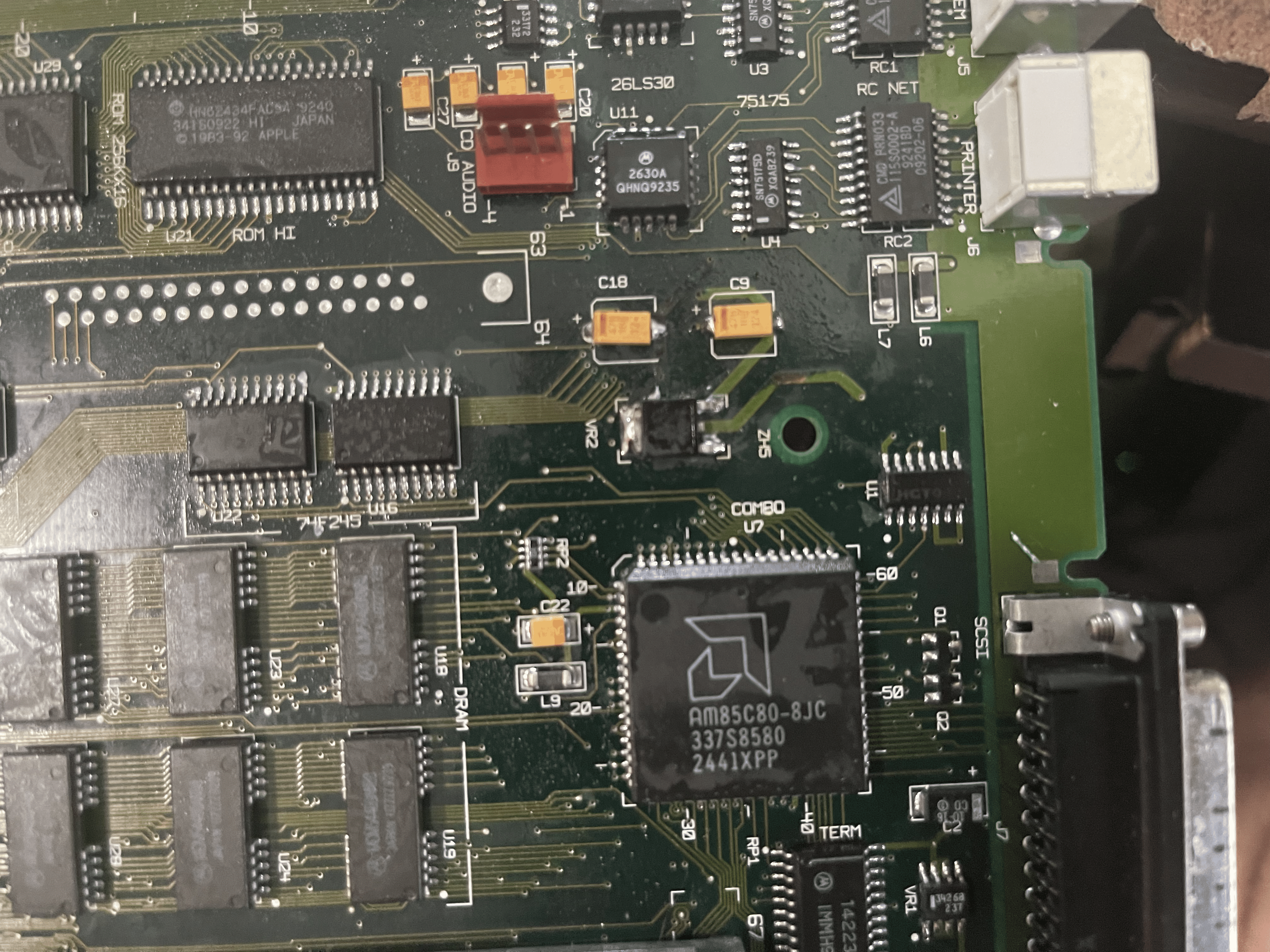

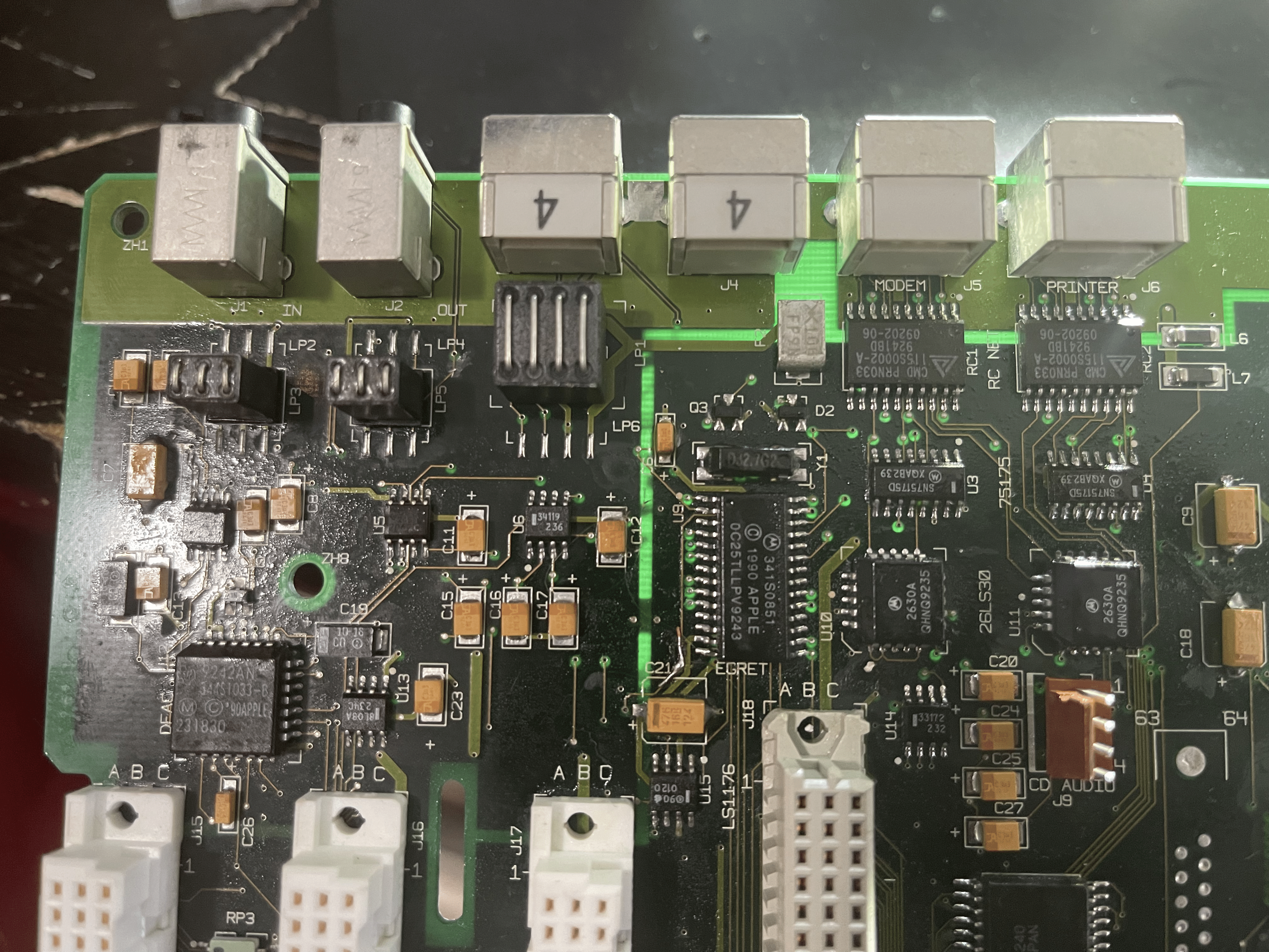

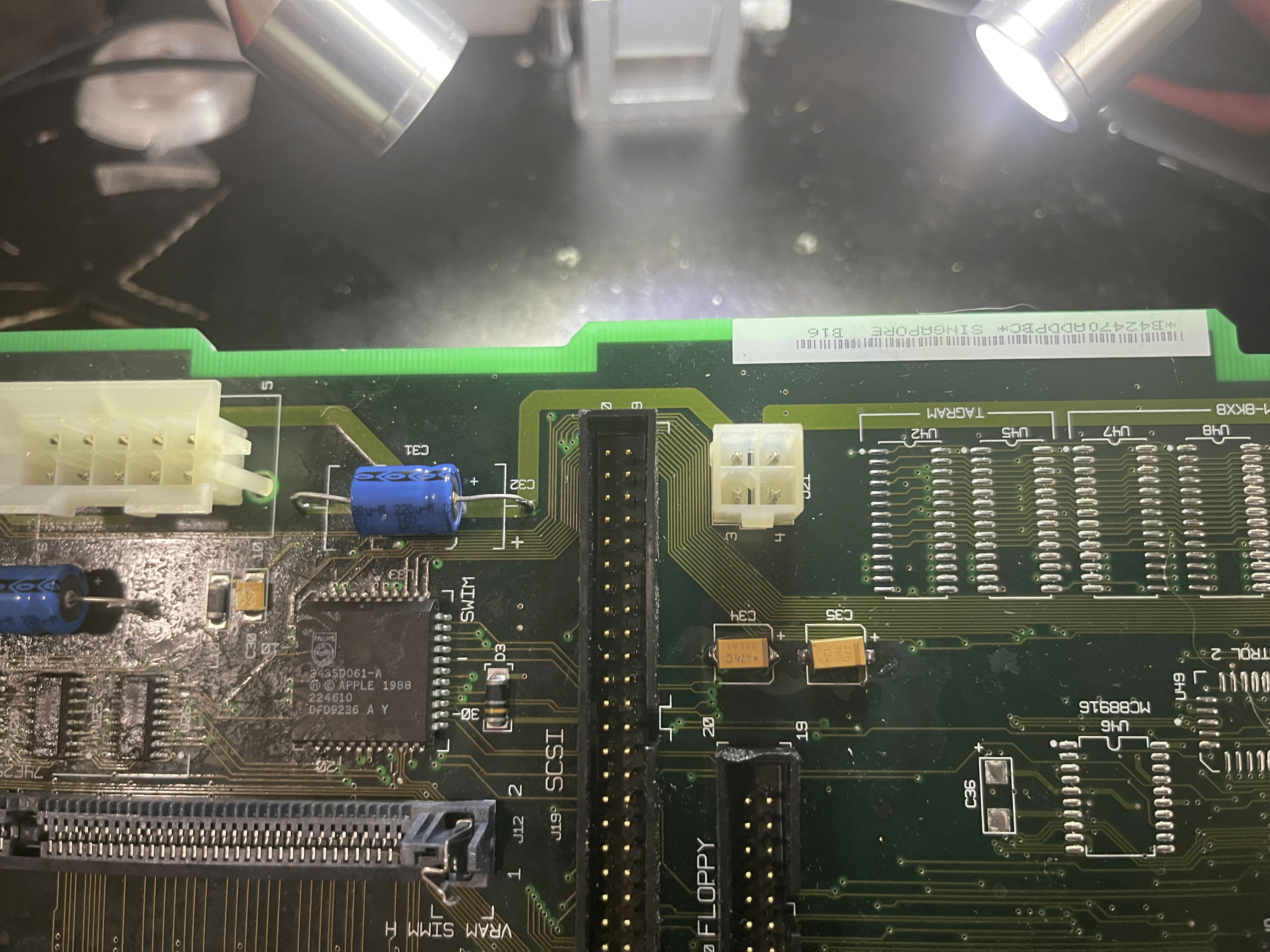

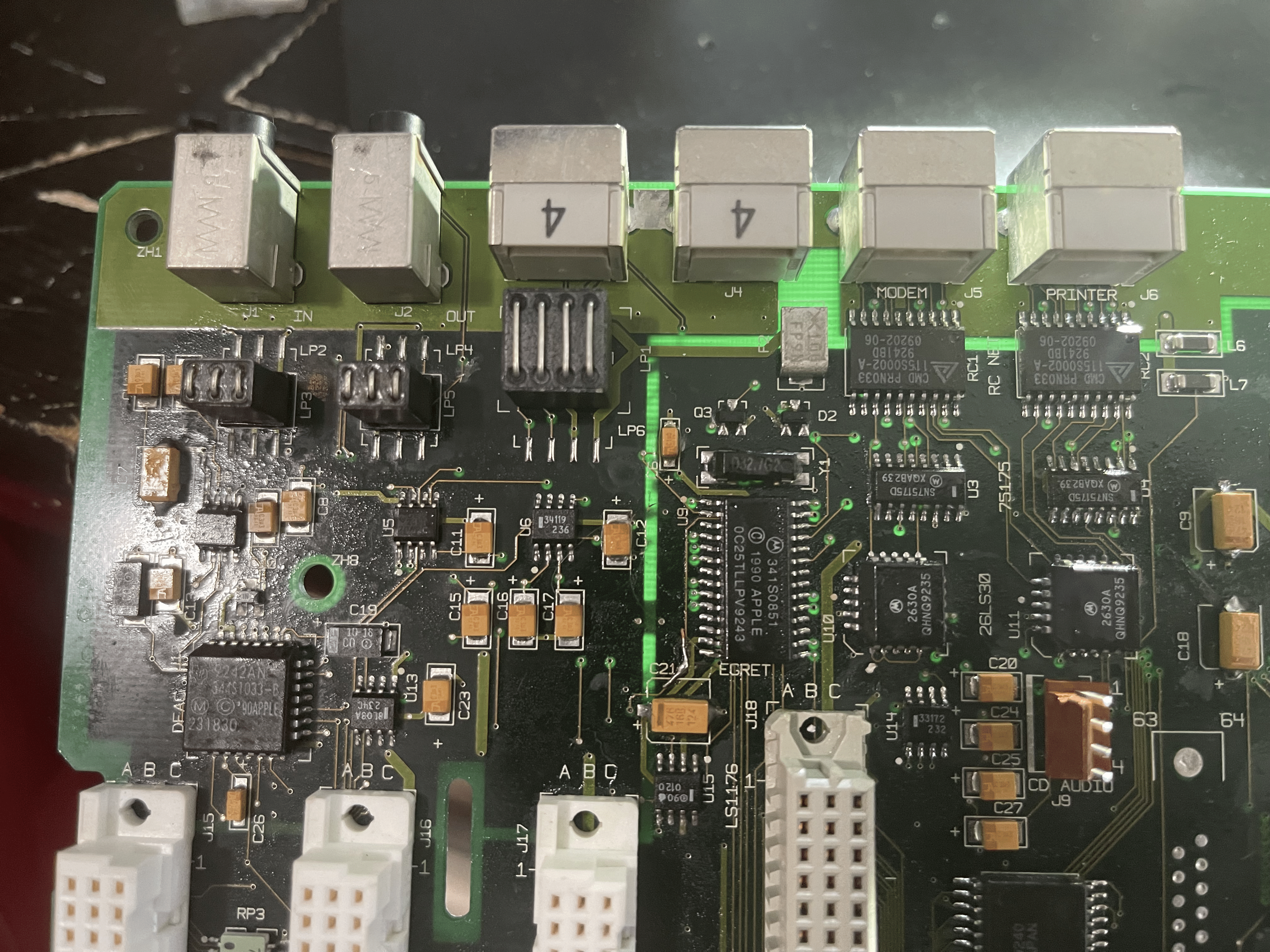

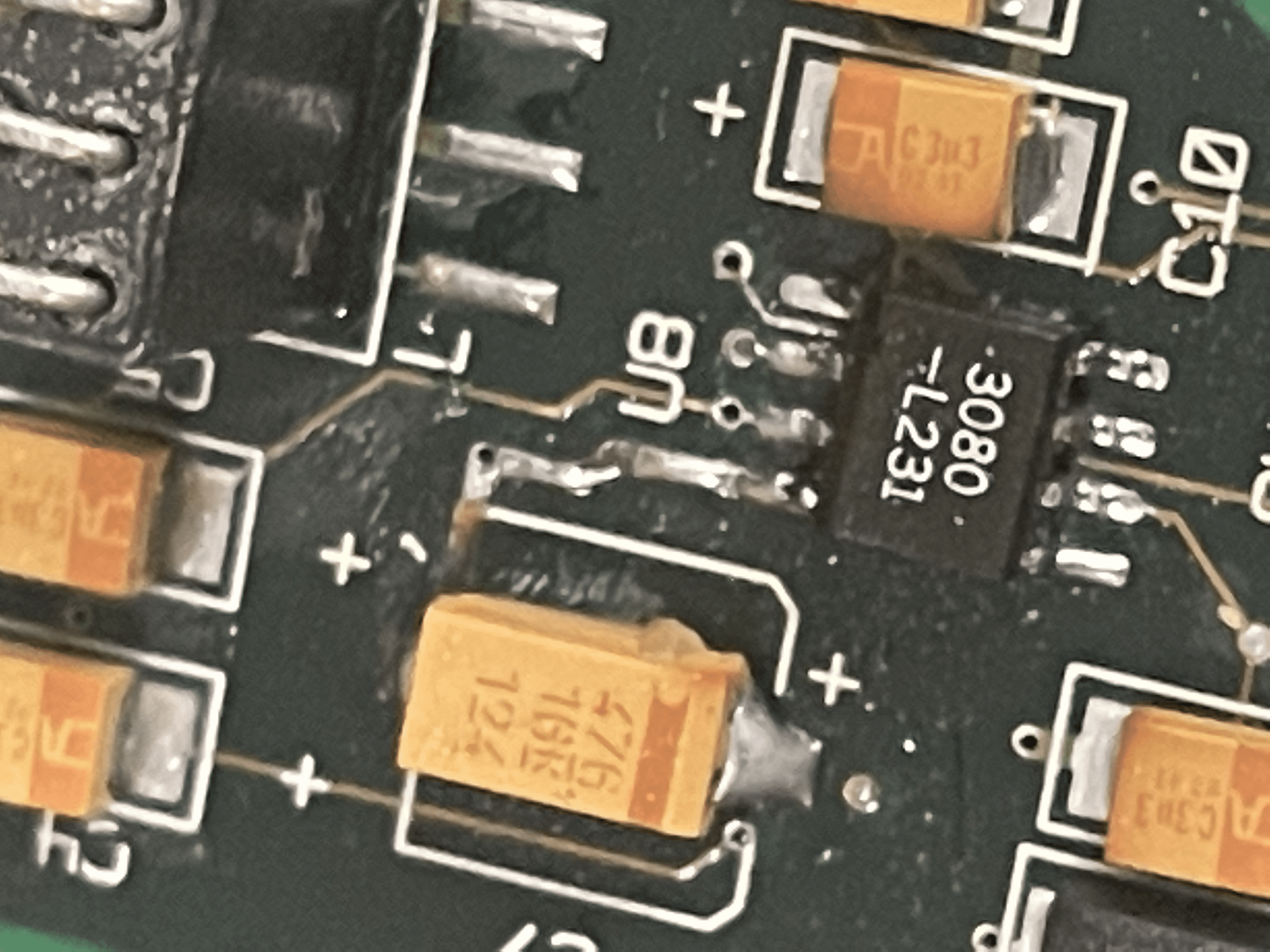

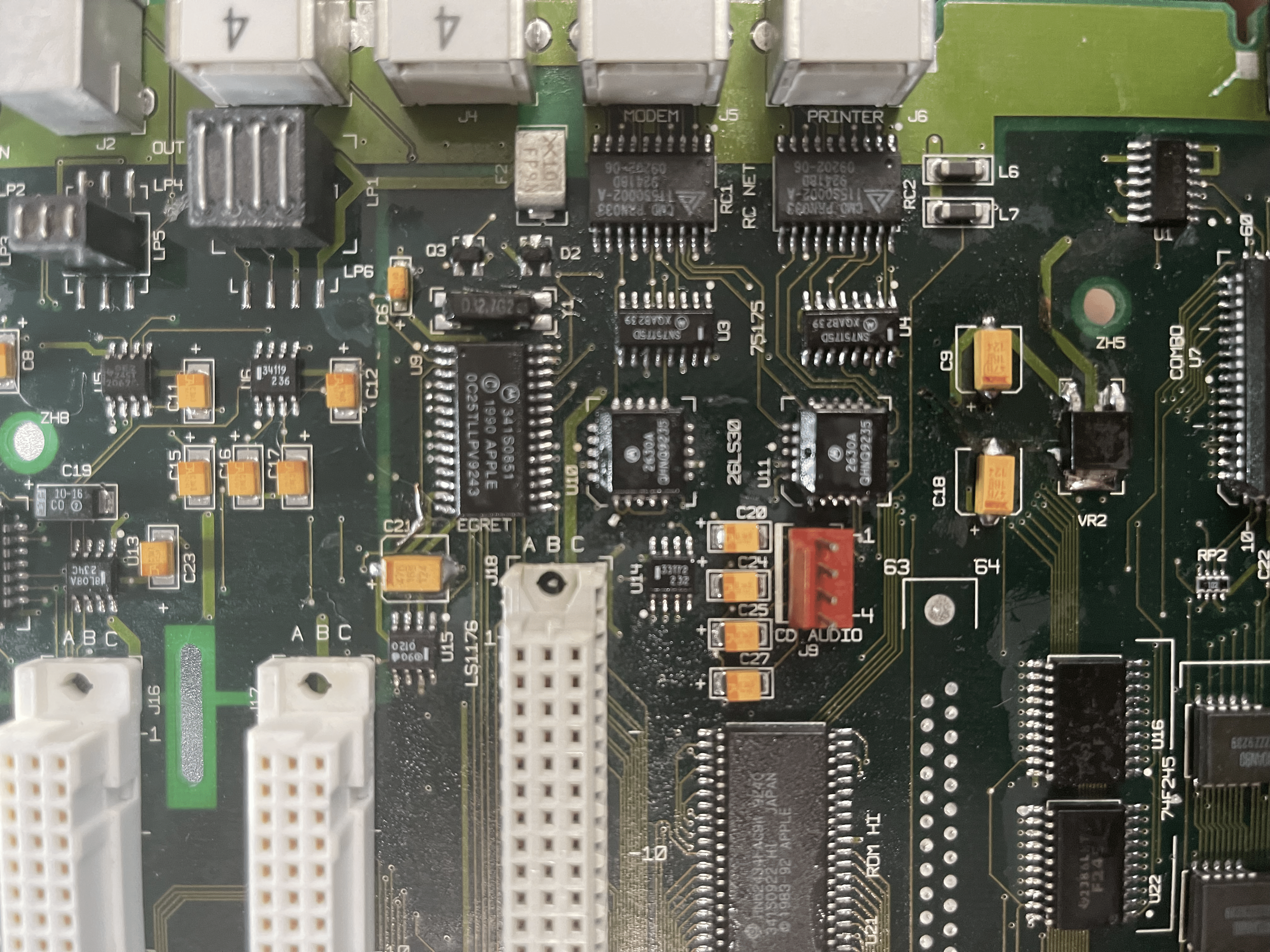

Excellent check list I have gone through and made sure, I have some photos there was one trace that was broken, same issues even after repair. I'll add some photos. Everything pictured with corrosion still has continuity.

Well I sent this one off to Amiga of Rochester for (hopefully a succesful) repair. In the meantime I had a friend in Sweden track down a spare board and of course it needed recapping. So I recapped this one as well and what do you know? Same exact issue as the one I just sent out. Difference here is there is way less corrosion and to top it all off absolutely dead, it will not power on or give me an LED at all. If this is a EGRET issue which I doubt it is I have spares but this one looks to be just fine. So what is it with iivi boards do chips just fail way more commonly or is it something that happens if they sit without a power cycle for too long?
