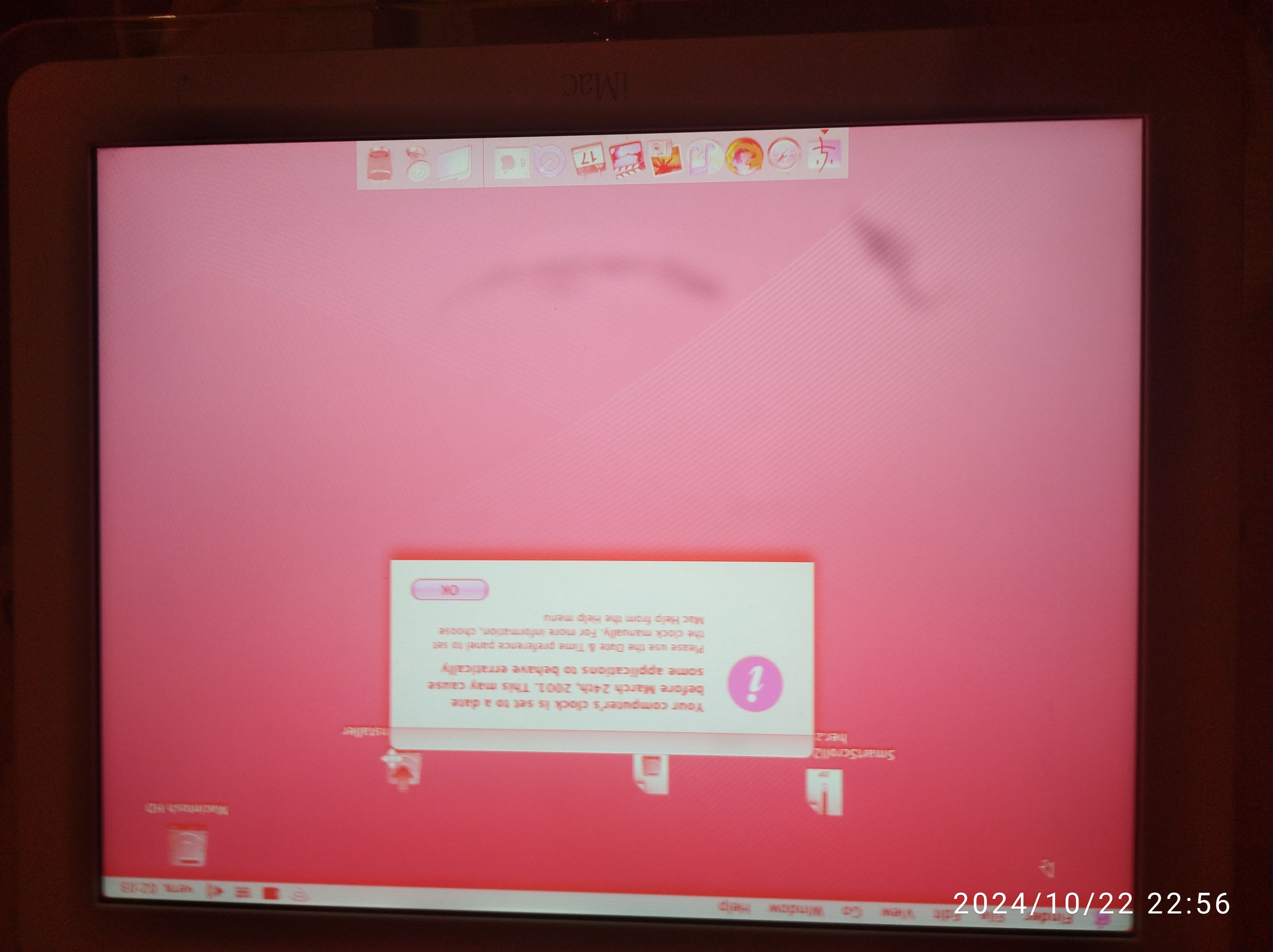

Recently got it, after I fully disassembled it to clean it, it started giving me this red tinted screen. Does anyone know how to fix this?

It was fine before I dissembled it and moving the arm has no affect. I remember it was really hard to pull out the display cable so when I was reassembling I didn't place plastic thing that covert it. Could that be the problem?

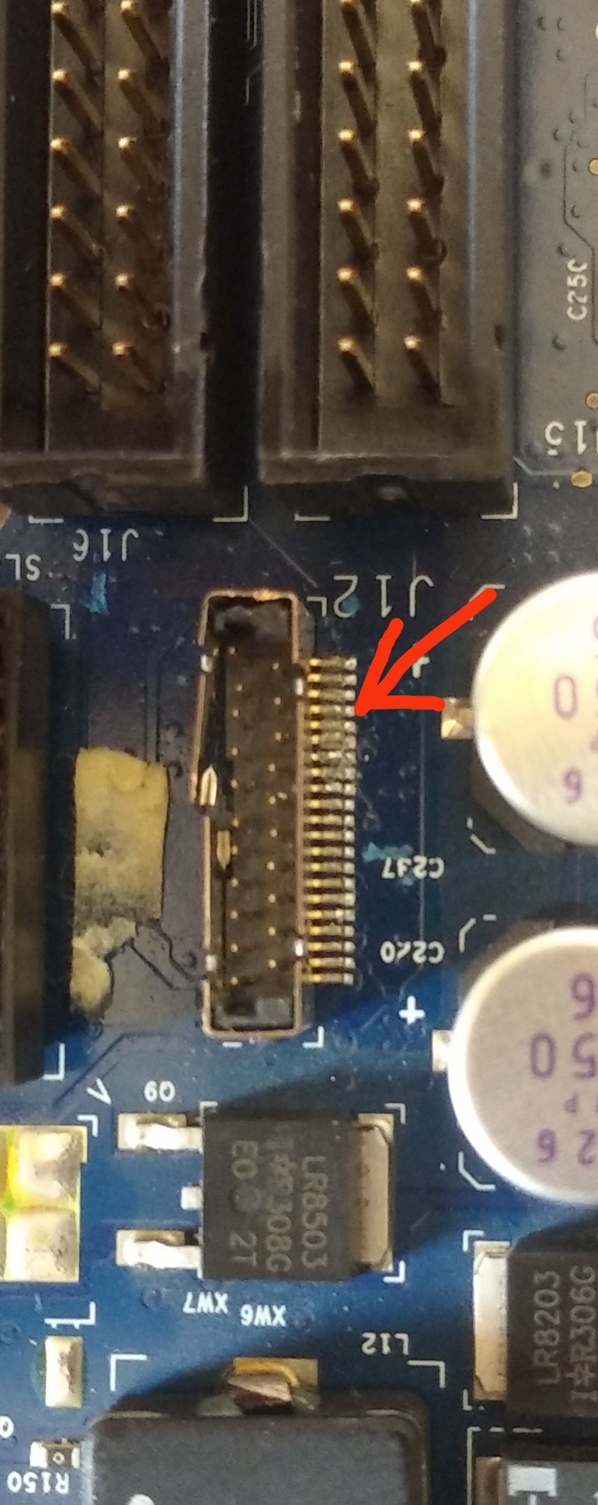

Upon a closer inspection I found out that when I was removing the display connector I accidentally ripped off this part. The good news is that it doesn't look too bad and I will be giving the board to a friend to micro resolder the pins.
