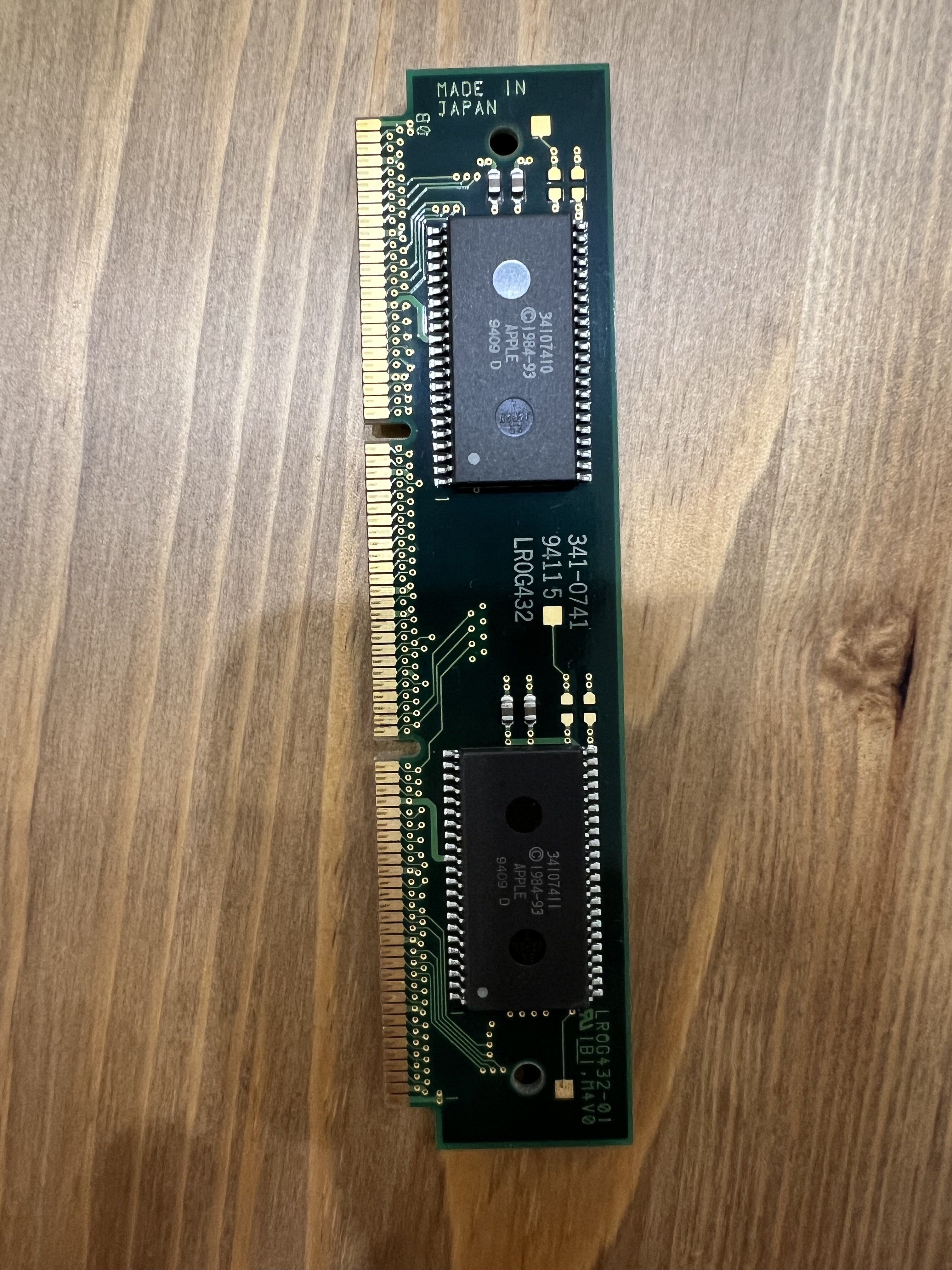

With x100 series Power Macintoshes - the ROM and Cache are both on a stick - you'll need at least the ROM SIMM installed to get it to chime. It can go in EITHER the ROM SIMM slot or the Cache SIMM slot since they're just bus-breakout slots that have identical connections.
@Kai Robinson, A new battery is installed, the ROM is installed in ROM slot.

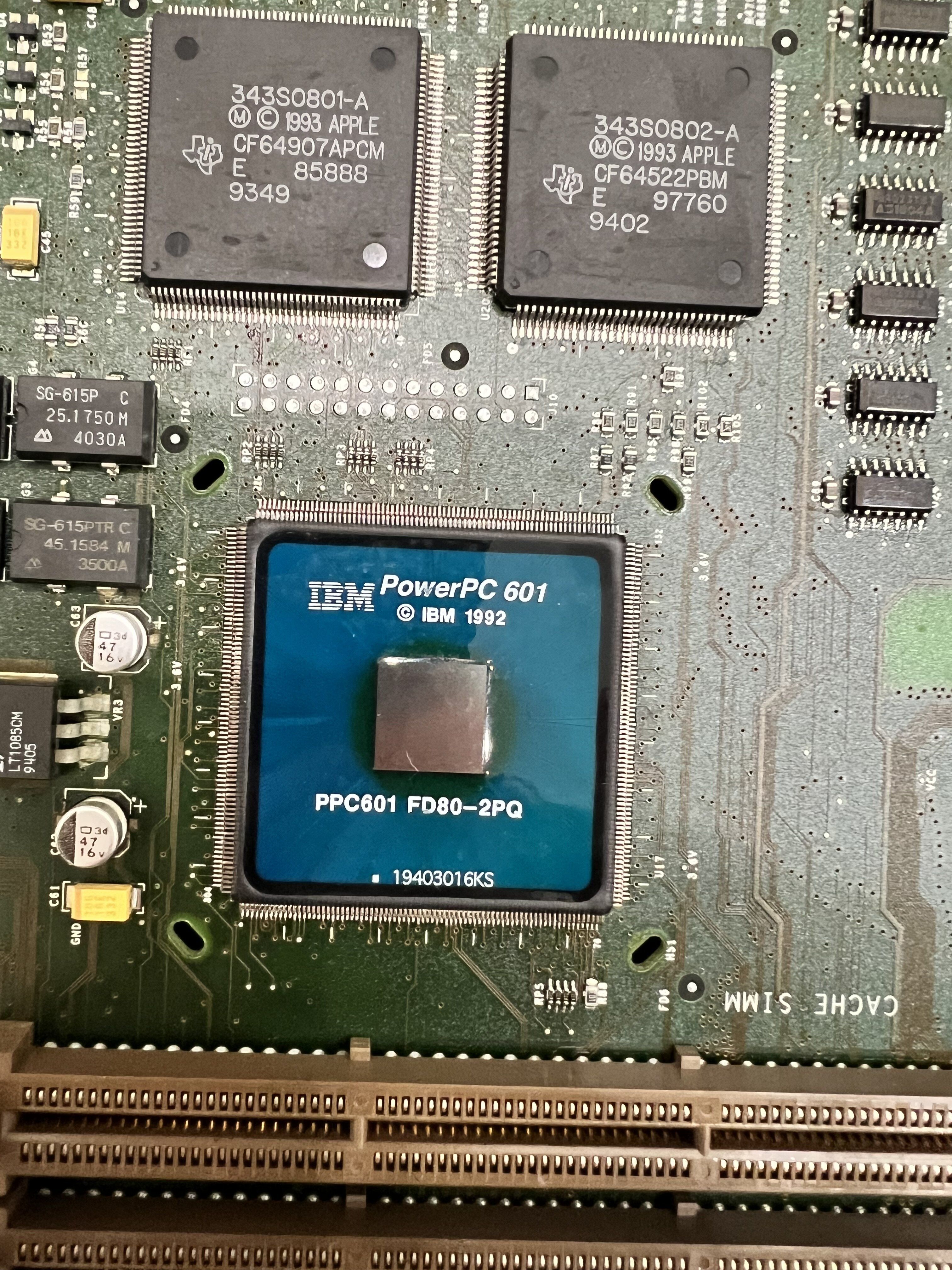

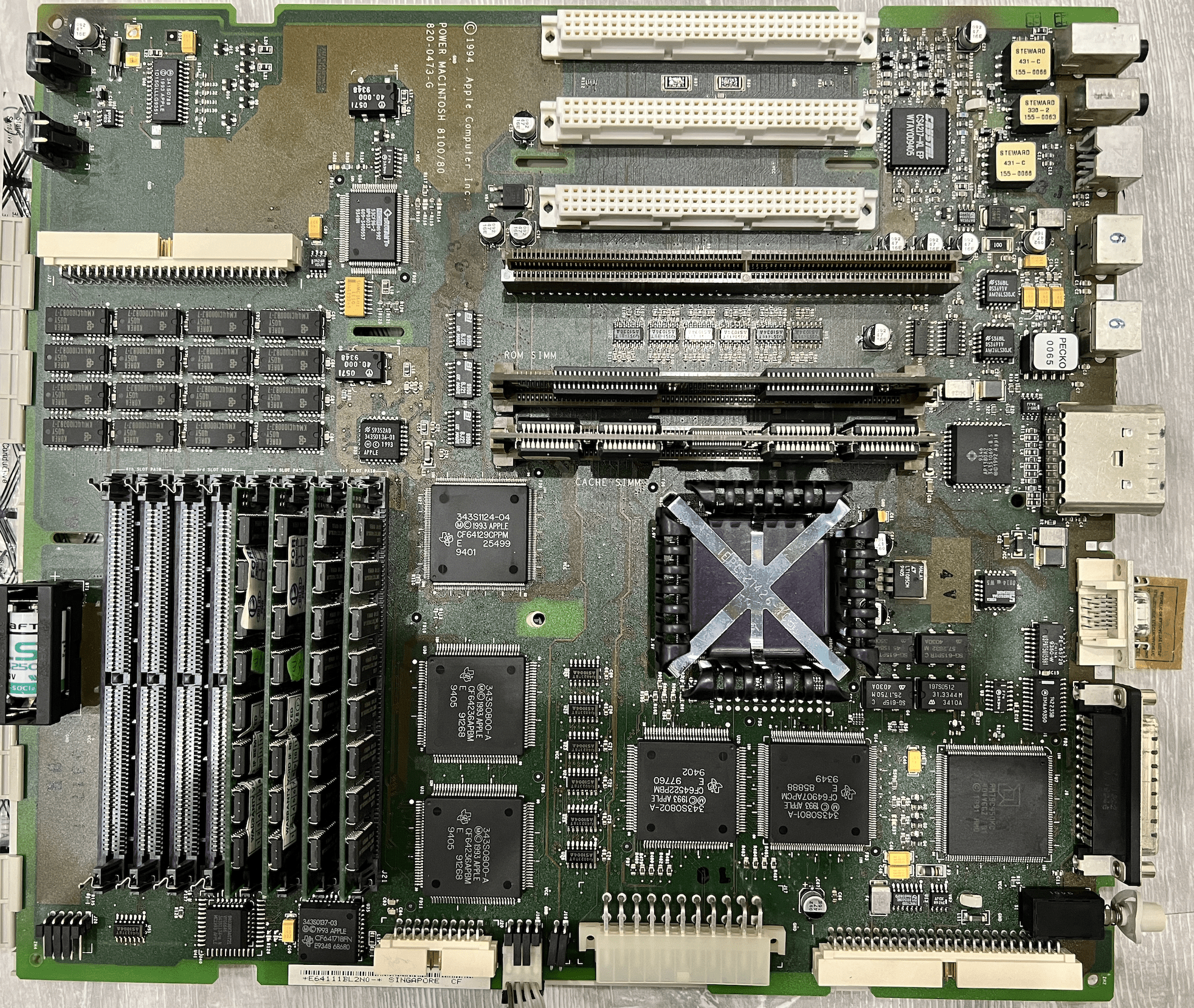

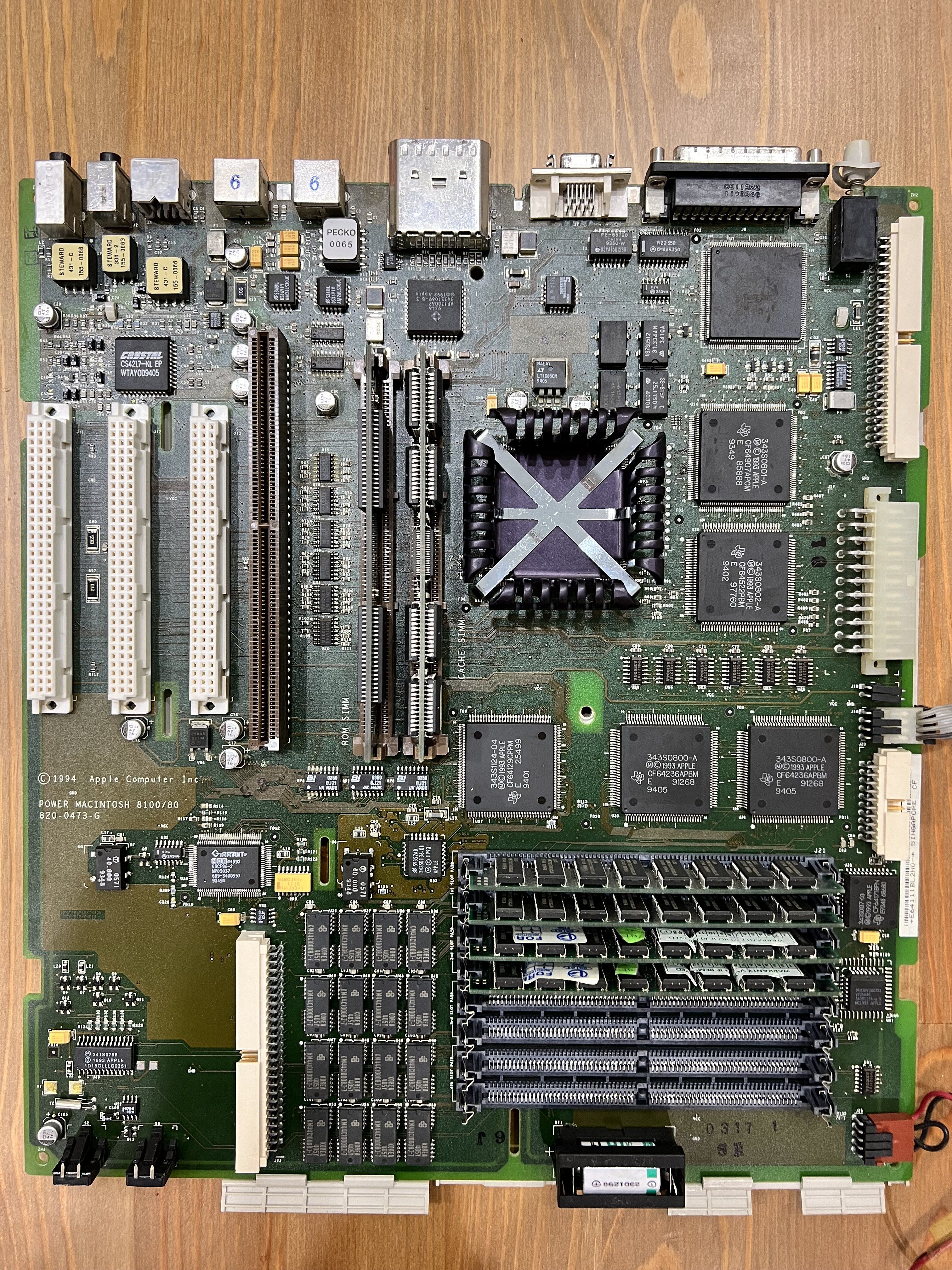

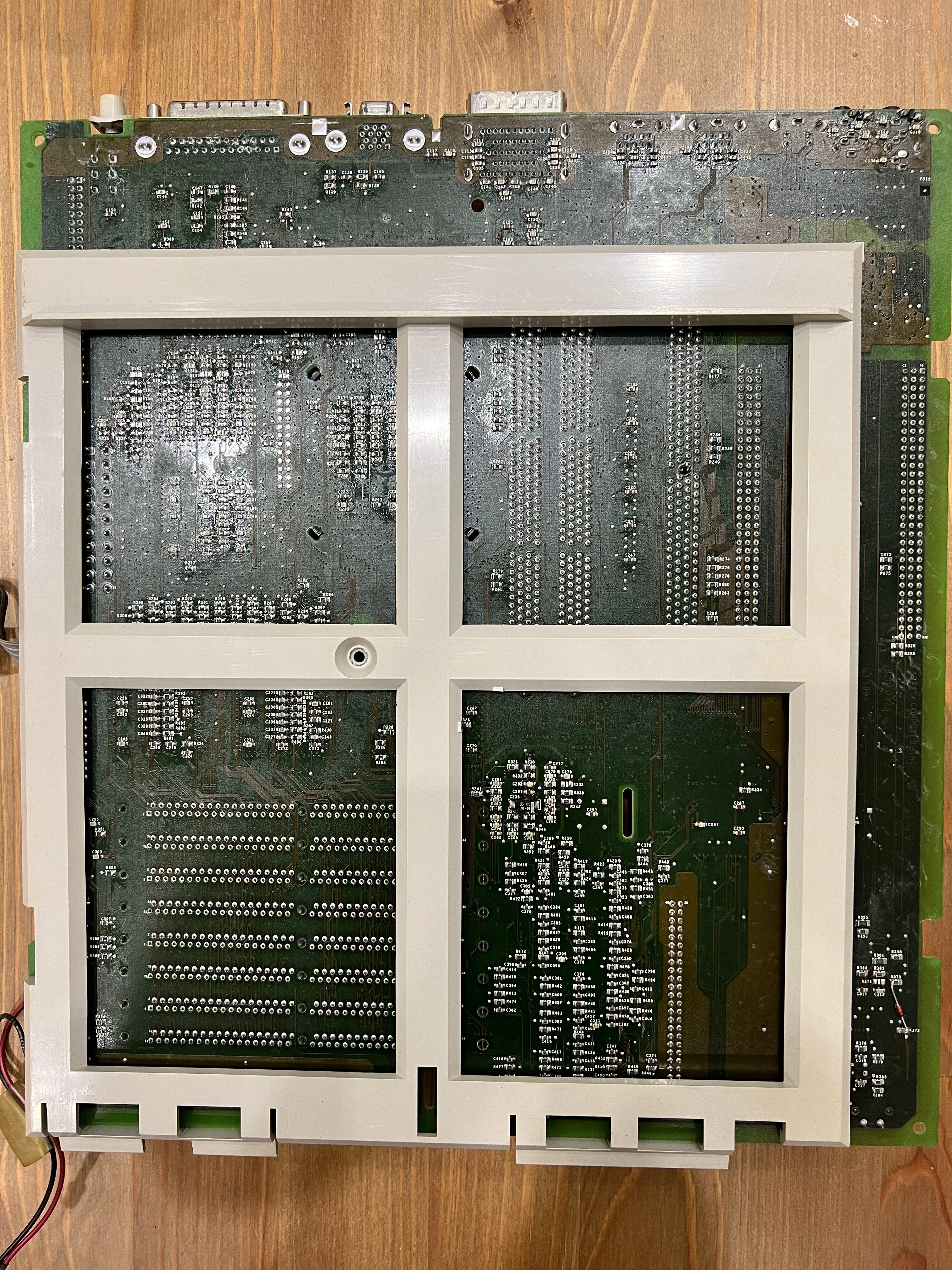

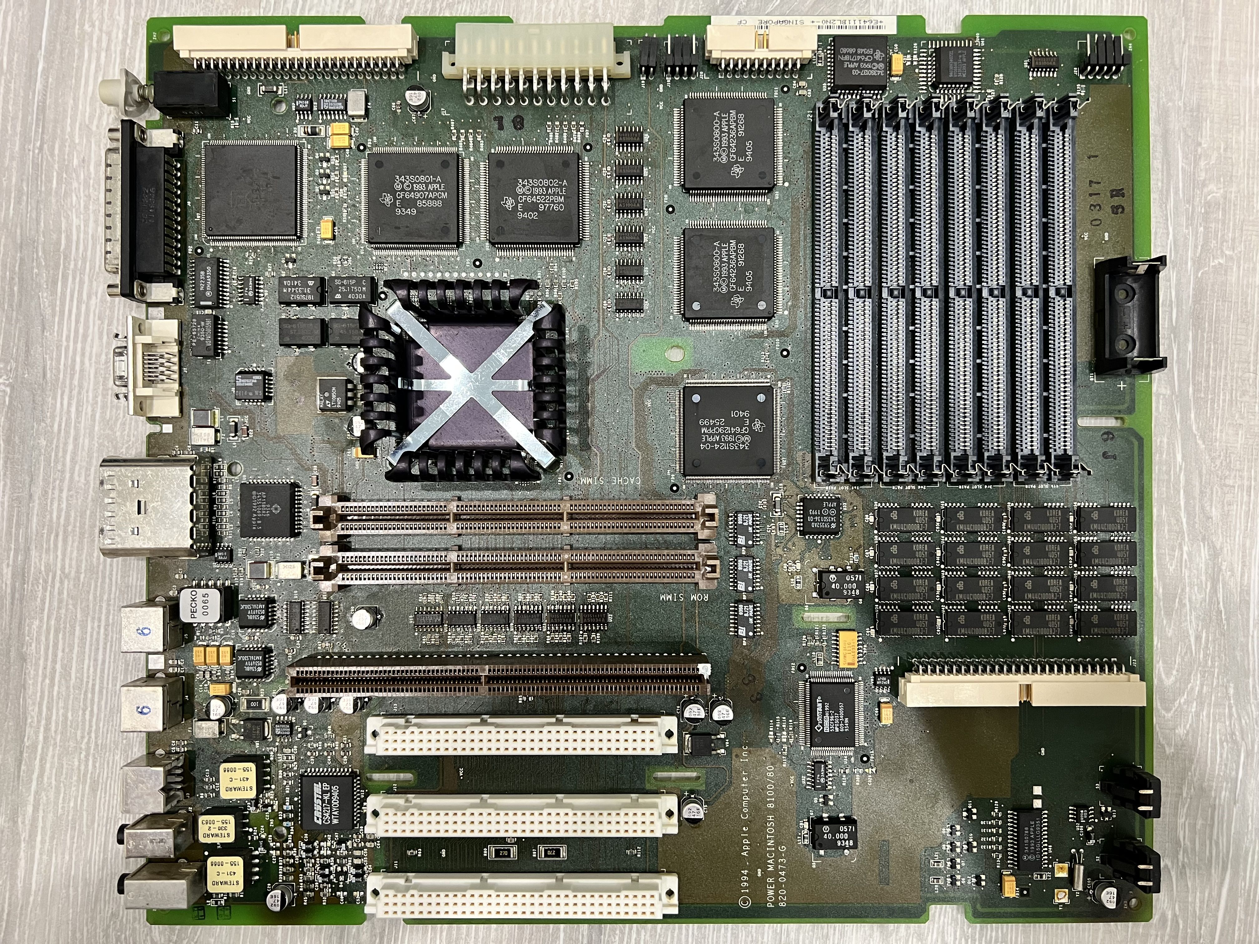

Can you get a good quality picture of the logic board on its own, with nothing connected or plugged in to it?
@Kai Robinson, Of course. I took the board out of the body.

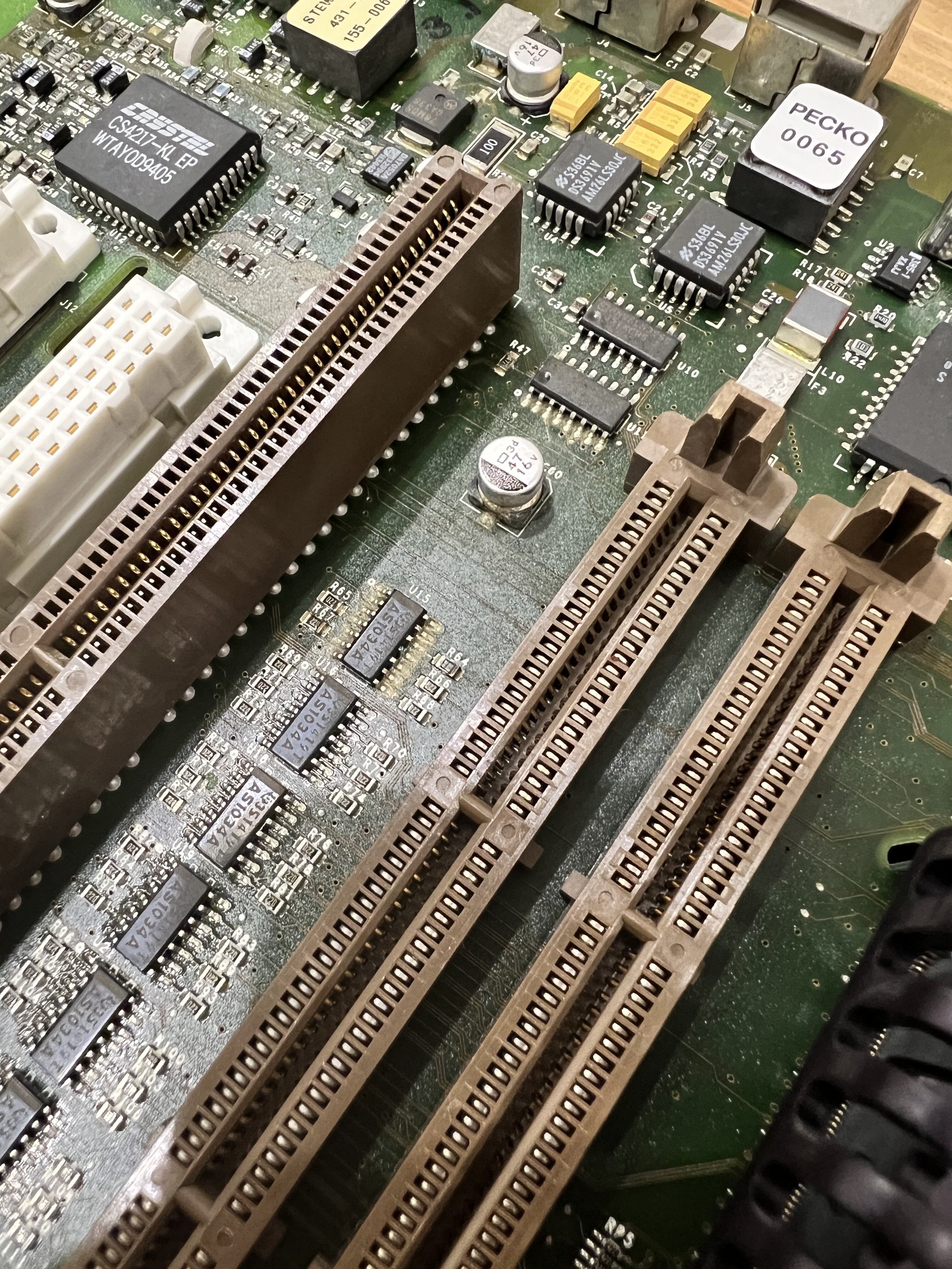

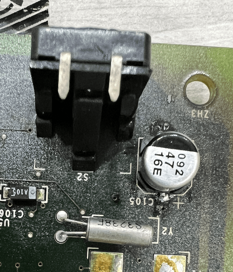

Near some capacitors I see strange white traces, and like dust on the contacts, but it is not washed. At first I thought there was a leak, but it doesn't look like it.
Otherwise, except for some strange soldering on the board, I don't see any problems: The cache and ROM slots look normal, the stick ROM looks normal.

That's corrosion - you'll need to recap that board - the 'dust' is corrosive gunk from the capacitors for sure. Just because there's no visible signs doesn't mean the board hasn't been subject to it. All the solder joints on those caps are dull.
Reactions: V.Yakob
@Kai Robinson, Thanx, I'll check it out -- I'll replace the capacitors and resolder other chips whose contacts look the same as in "dust".

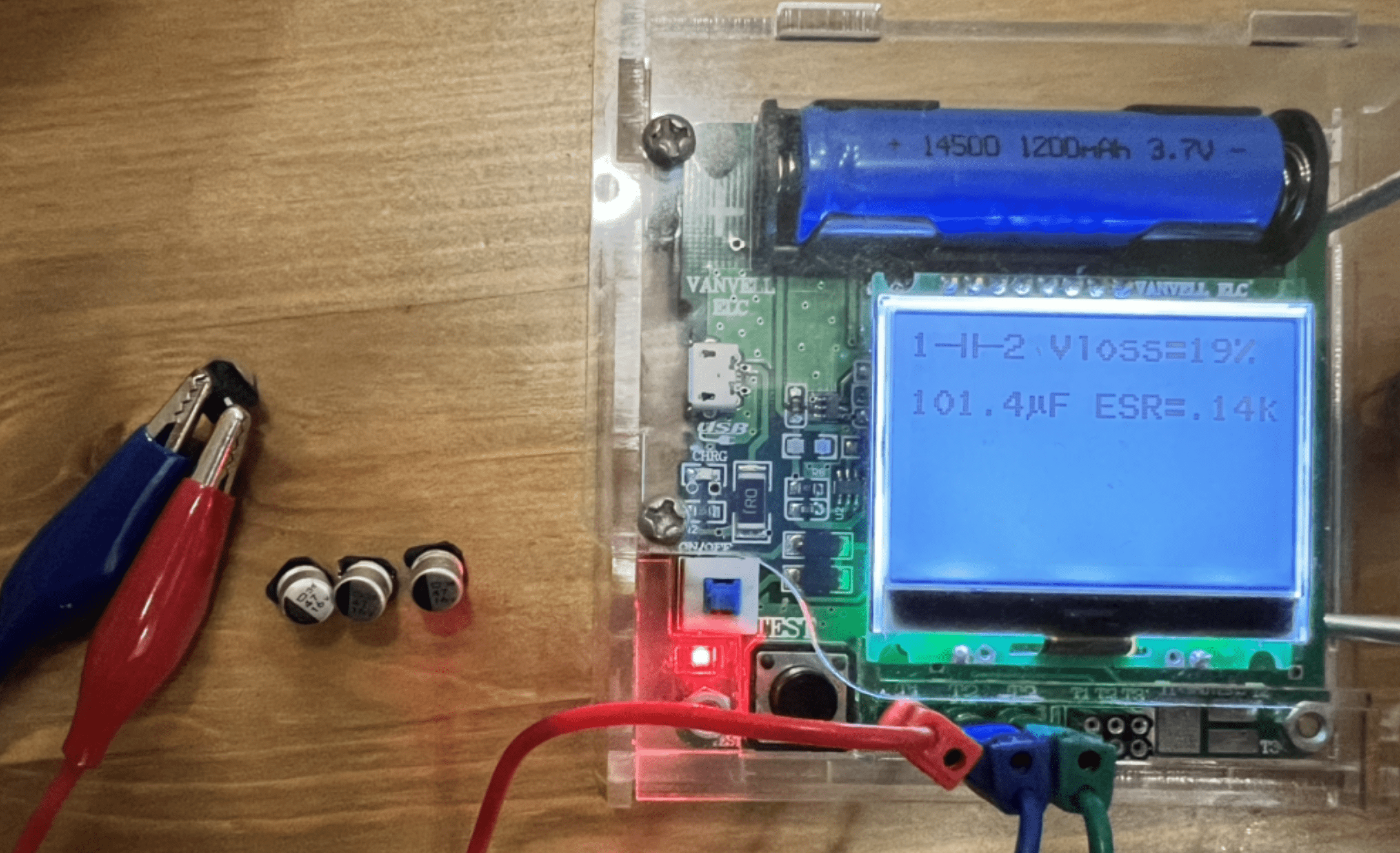

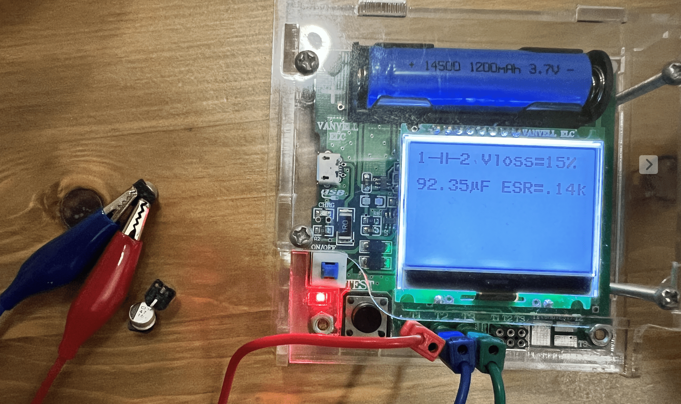

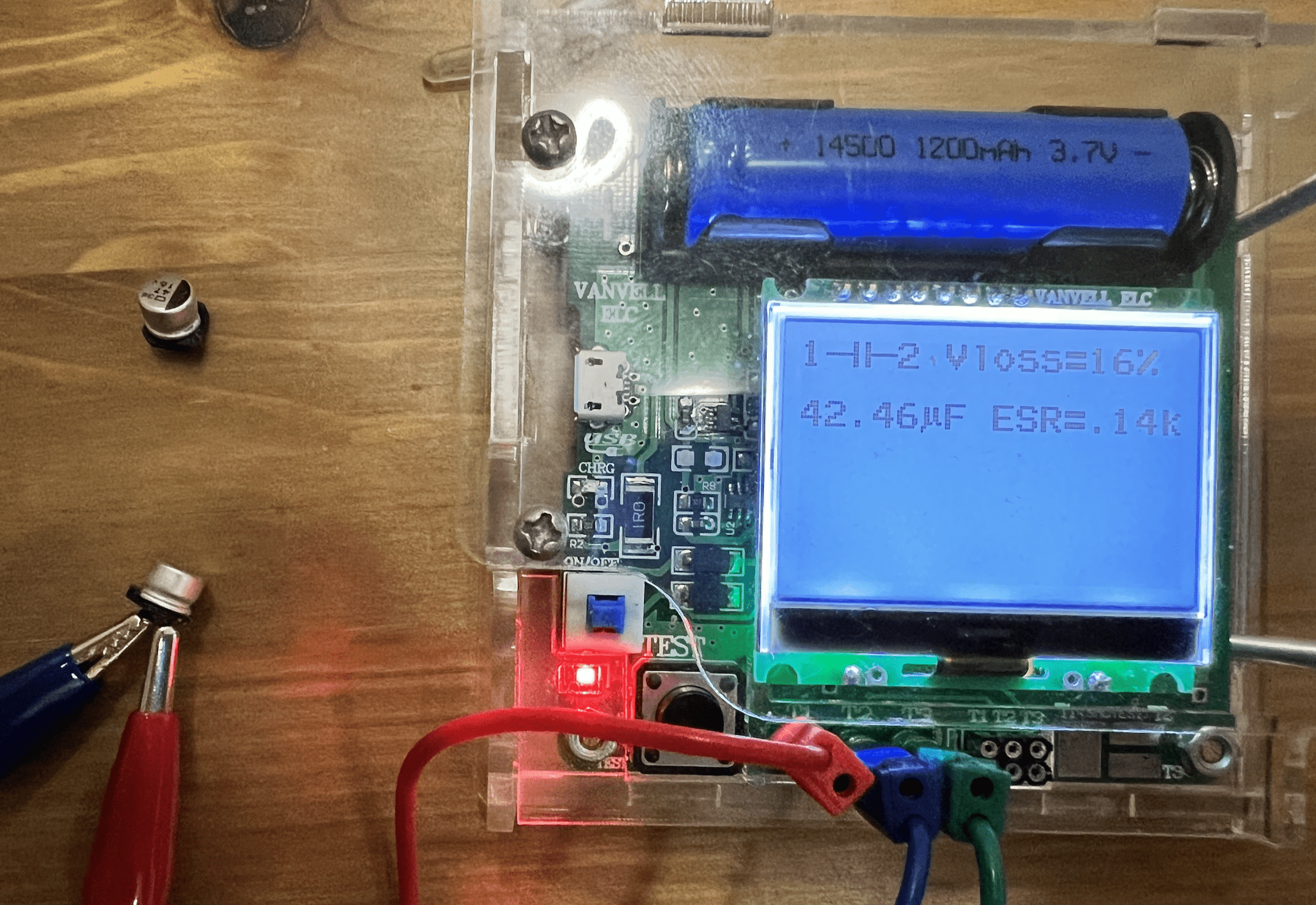

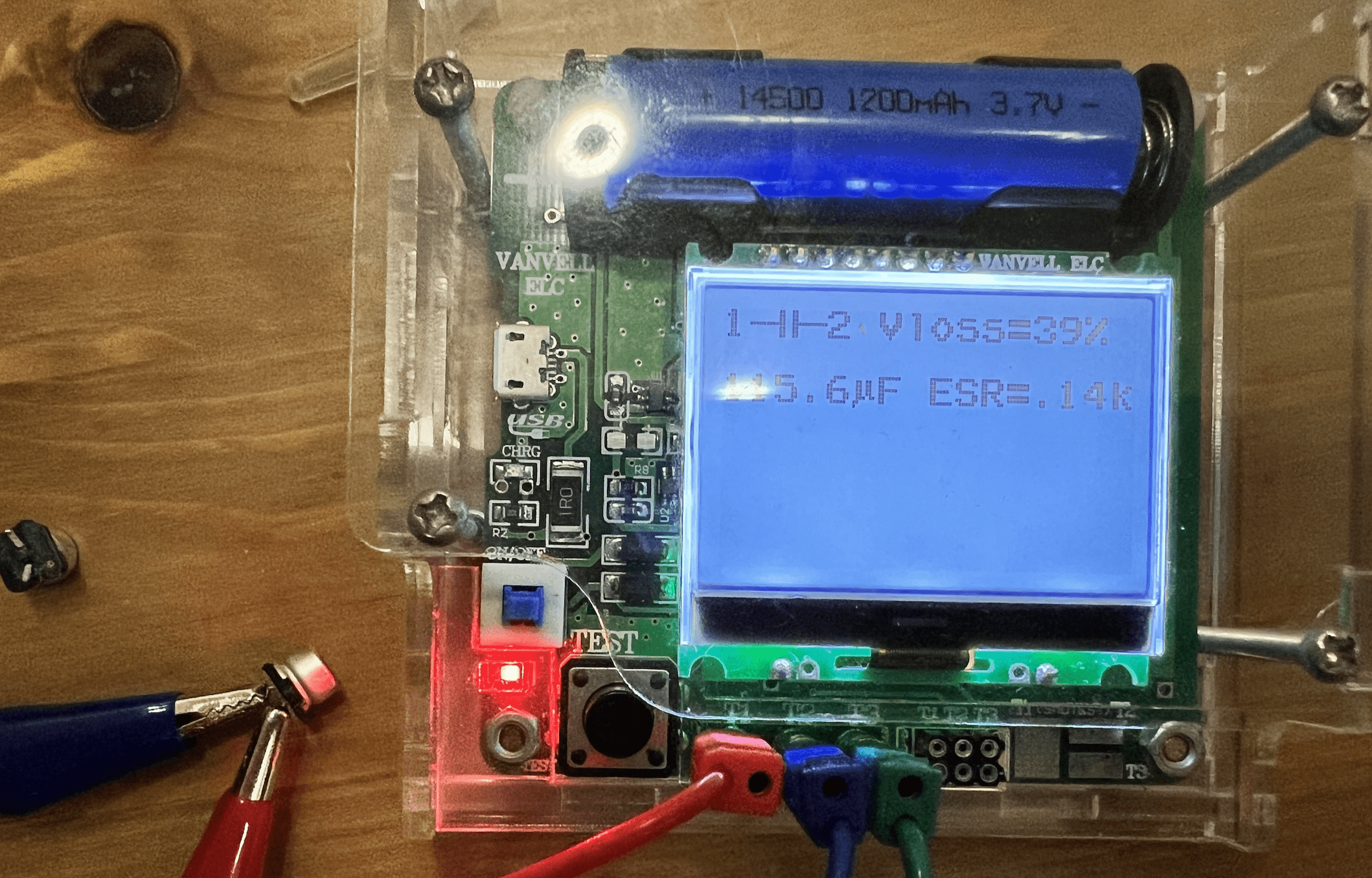

Today several capacitors fell out and tested them on the resistor tester, the results surprised me.
According to the marking, it is 16V 47μF, And in fact, μF has changed in 30 years.
I've always believed that the value can decrease, and here it increases.

Checked the remaining capacitors.
Only 13 pieces:
7 --show knowingly incorrect values;
2 -- completely not working, because the tester could not determine them;
2 -- the values are close to marking, but I consider them defective;
2 -- looks completely working.

Remember, the specs on the caps are likely +/- 20%

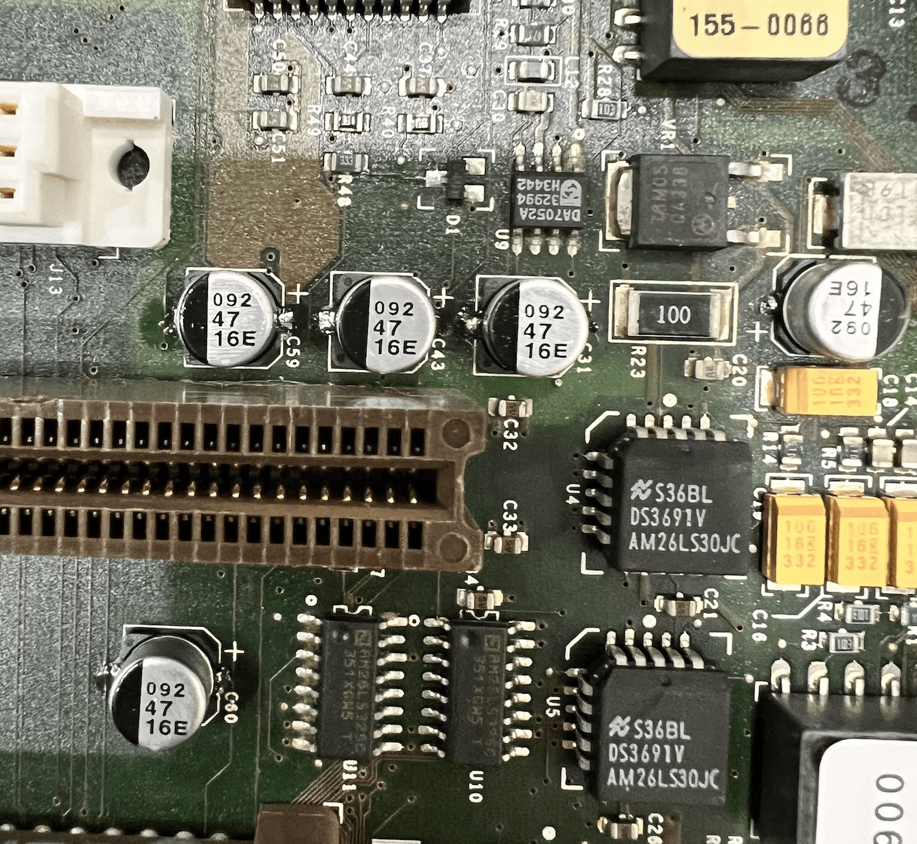

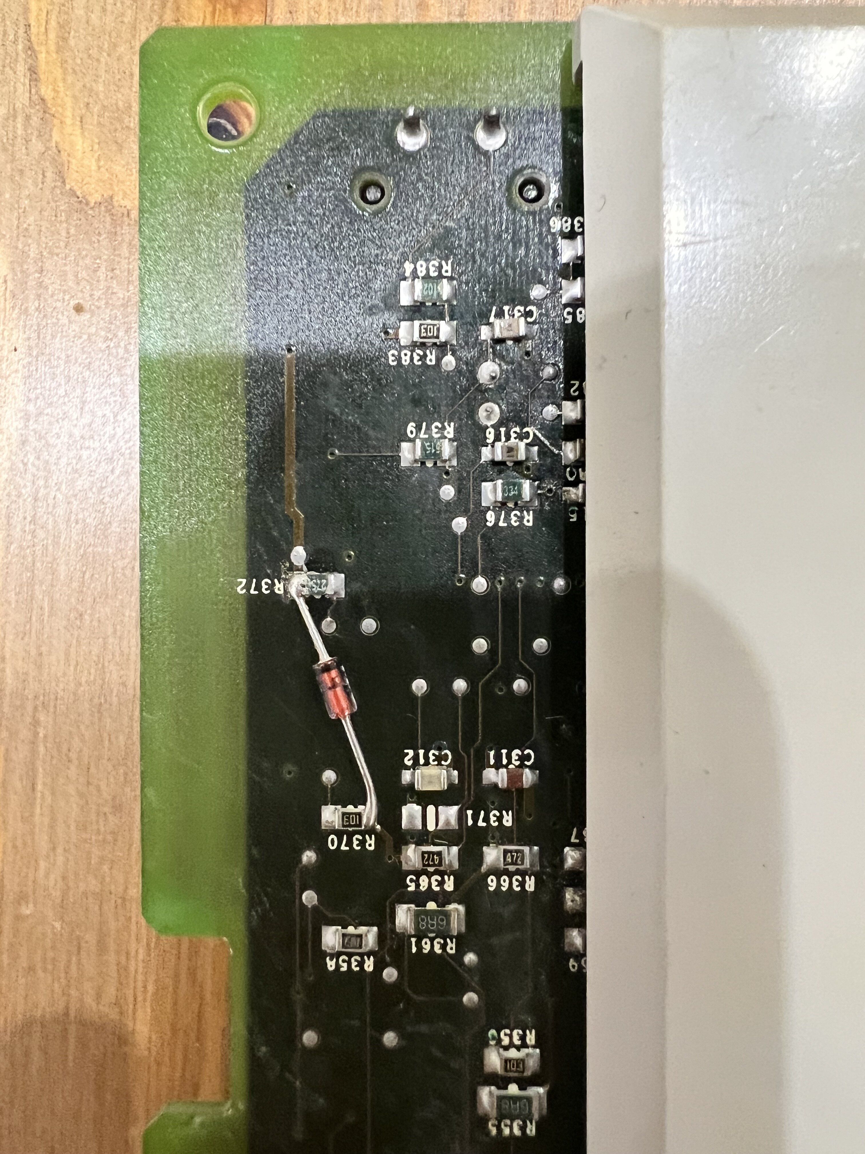

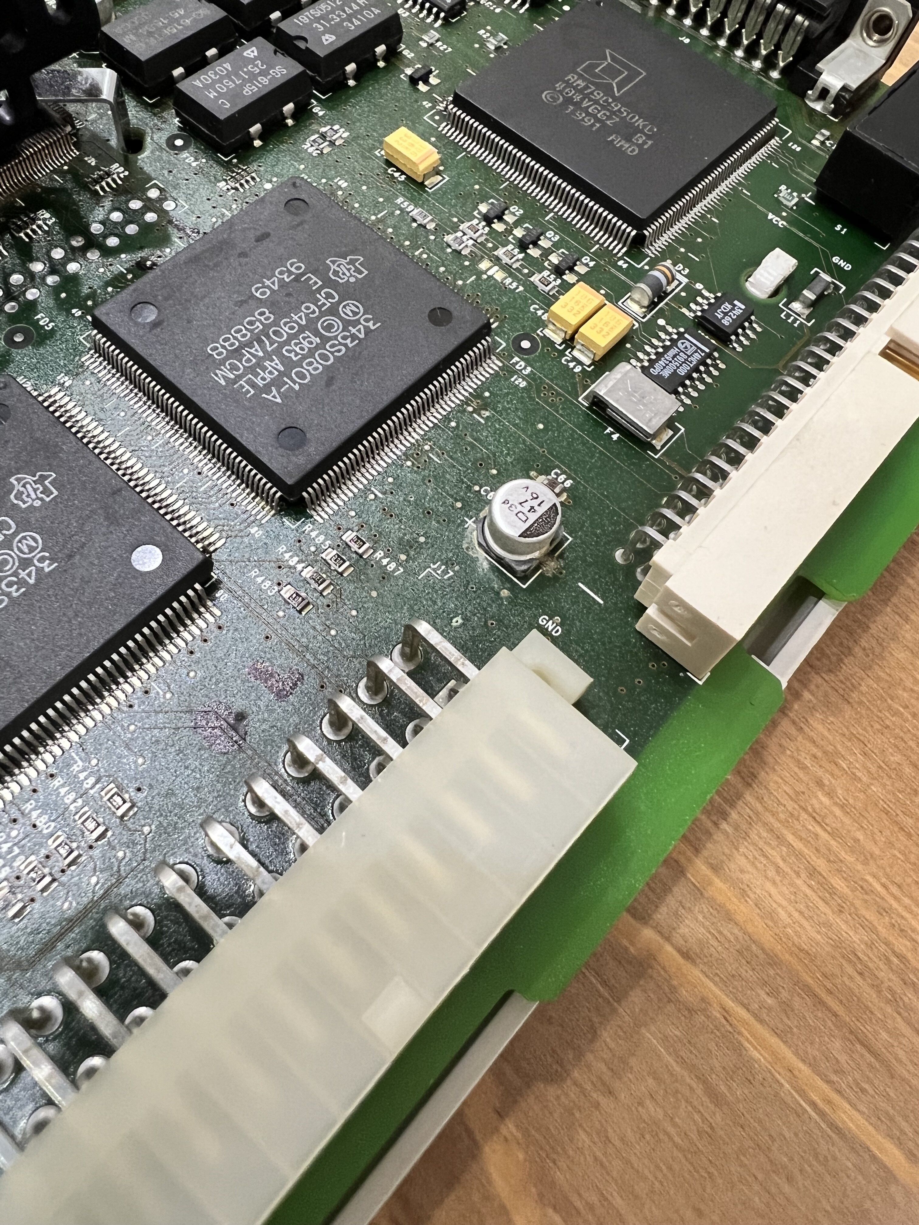

The parcel from China arrived faster than planned. I got it yesterday and soldered the capacitors.
I've never soldered such capacitors before, it took a lot of patience to figure out how to do it. The textolite in two places has darkened a little due to many unsuccessful attempts.
However, it worked, now the computer boots and works fine. I have 2 SCSI drives that have Mac OS 8 and Mac OS 9.0.4. Mac OS starts up and looks good at first glance. And I finally found out that the memory bars are installed here - 4x16 Mb. Not enough.

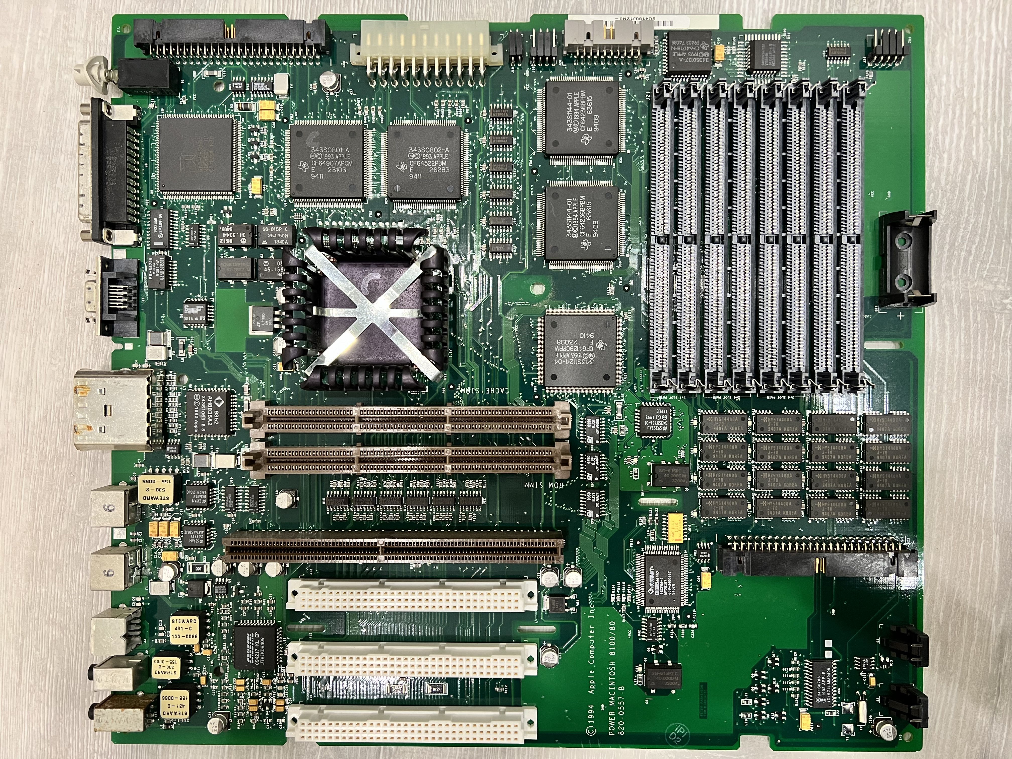

And so, time went by and I finally received a parcel with a different motherboard, as I understand a newer revision than it was.
This board was stored under normal conditions because I don't see any obvious signs of corrosion.
I installed this board, and everything seems to be working properly.
Moreover, the nubus ports apparently did not work on the old board, I have one SuperMac Thunder/24 video card that did not work there and was not even detected. Maybe there are some other malfunctions in that board or I overheated something with a soldering iron.
It works here.
Just in case, I'll leave photos of these motherboards here for history. Apparently, newer revisions of chips are used on the new board, because in general they do not seem to differ.
