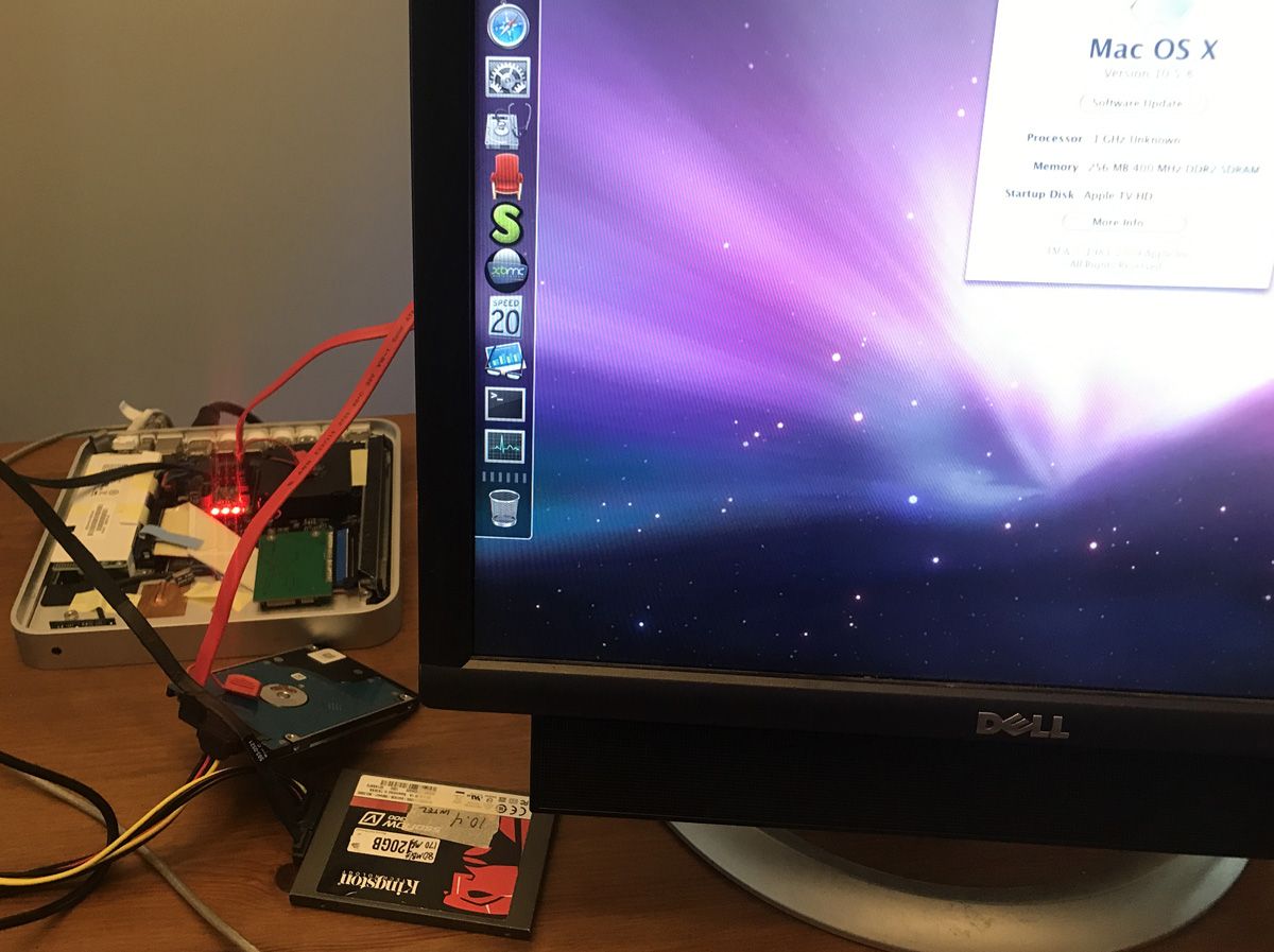

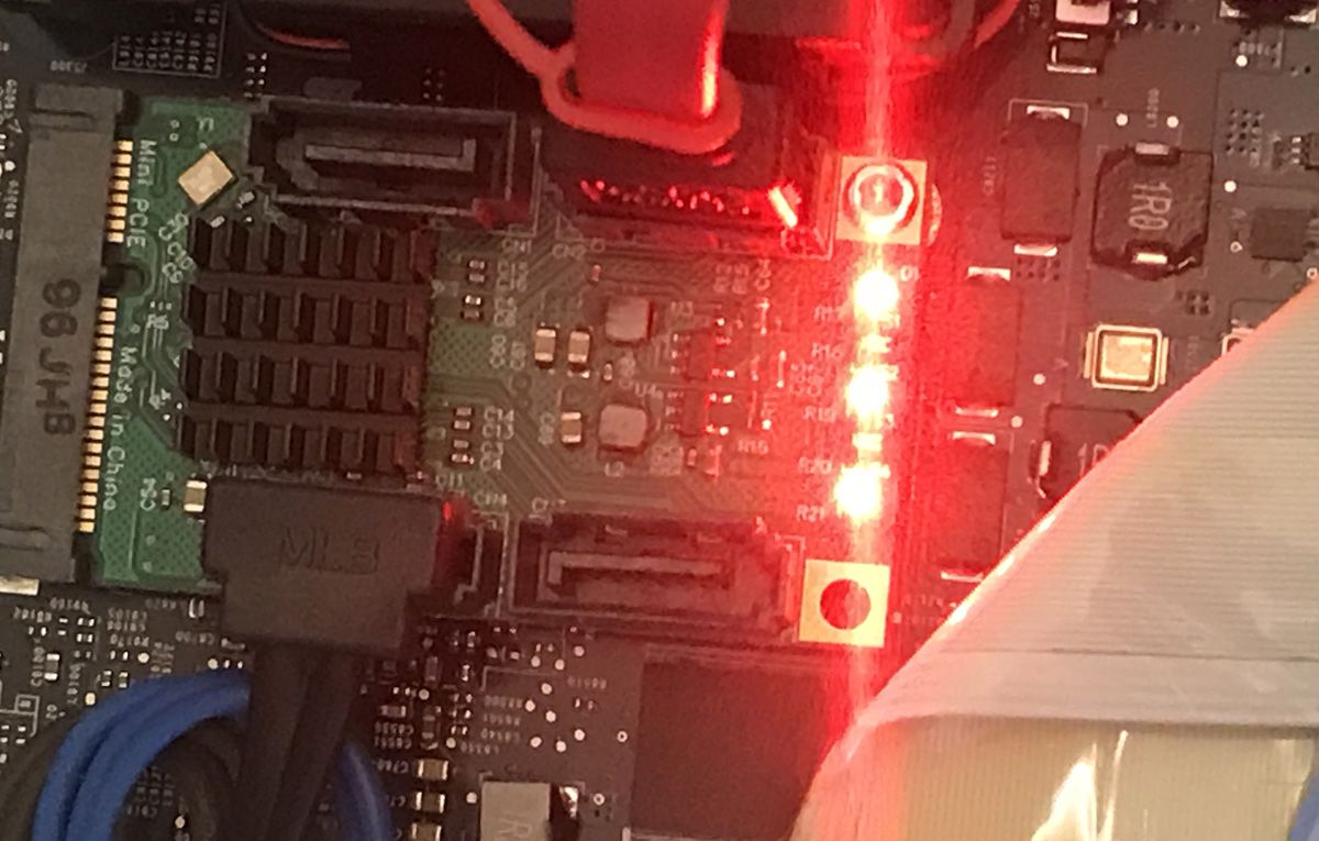

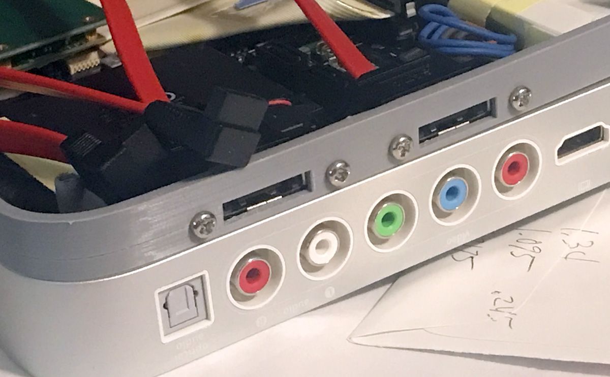

My next hack/mod will be trying a Mini-PCIE quad SATA adapter. If it works with all 4 drives, then I will 3D print a 1/2" riser so I can mount two internal 2.5 drives and have two eSATA ports on the back.
The mPCIe Quad SATA card arrived. Installed and tested with two drives attached (I will post screenshots later), it worked out of the box, no driver or kext needed. Proceeding with the lift kit, I have to figure out where to relocate the fan, maybe make a exhaust port left of the dual eSATA ports. This is on 10.5.8.

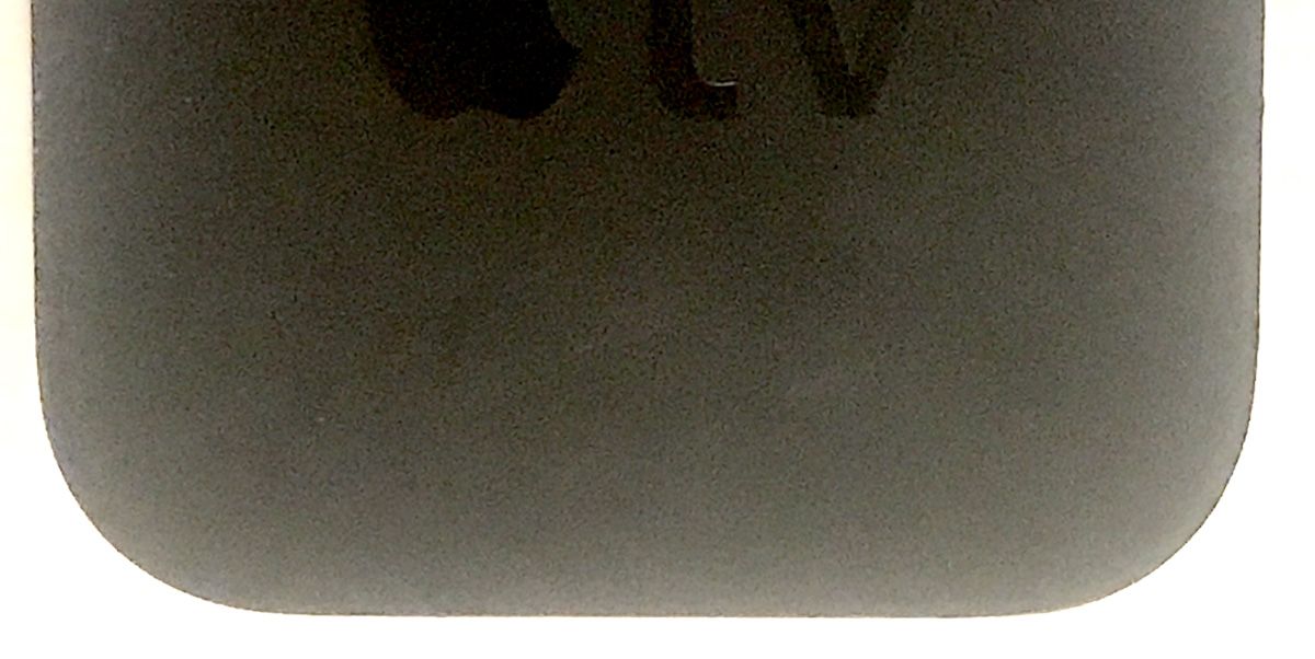

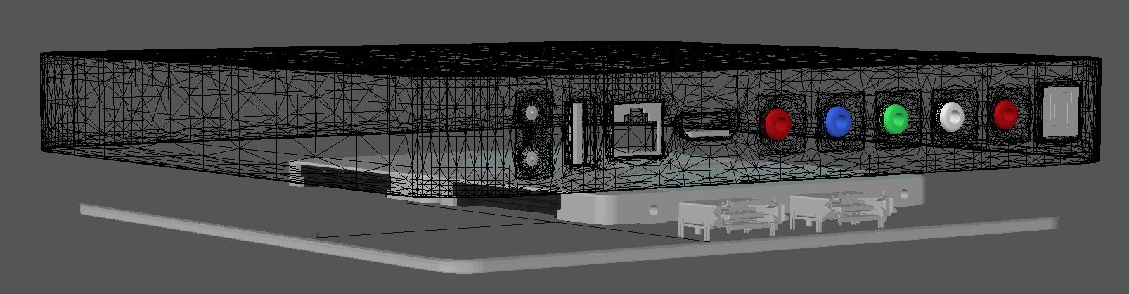

The online 3D models of the ATVg1 did not match the actual device.... That led me down a long slope of G3 Surface Continuity that took way too long. Instead of trying to calculate such a curve, I compared an AppleTV gen 2 to most other Apple devices and they all have nearly identical curves, just separated with longer straight surfaces for larger items (even lines up on a 27" iMac).
Imported a photo of the ATVg2 into Illustrator and matched a curve and exported to my 3D model. Adjusted and did a test print in gray. This is upside down of course. Final will likely be in white.

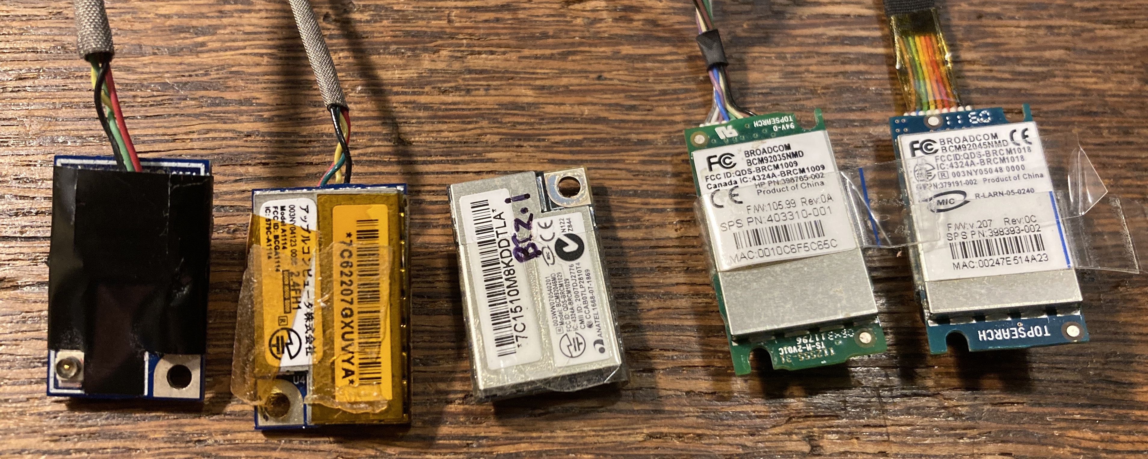

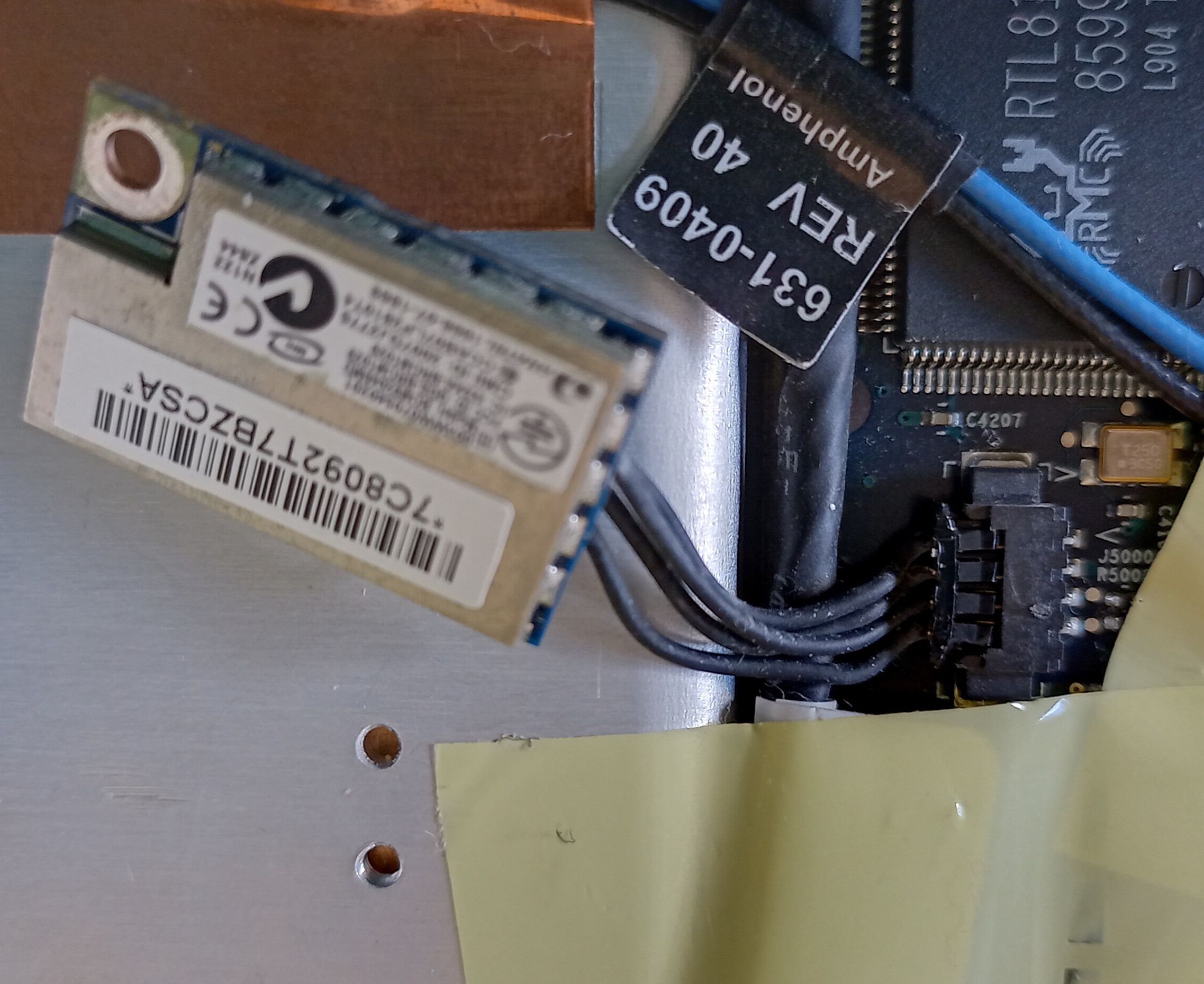

Hi
Long story short:
Long ago I read about a guy how plug some speakers on this port and it blew them , I find one Bluetooth card from an iMac (07-08?) and plugged in on this port and if I plugged one way the ATV won't star but turned around and it turned on but the OS (10.8.6) don't have bluetooth on system pref, the BT card is not recognise by system profile. anyone think this card should work ?
any Idea ?

• Btw the Bluetooth card was plugged inside the ATV on the only port that is free on the board that I only once I come across someone talking about it , I also try to run a new instal of OS (10.6.3) to see if the system will pick the card but again I find that probably the OS X was strip of the Bluetooth feature on this version any ideas?

Hi
Long story short:
any Idea ?
Interesting port option... I powered one of my AppleTVs on, and I get +5v at the first pin (with the big arrow V), 2nd pin ground, then two other minor voltages, assume the 3rd and 4th pins are D+ and D-. I will have to cobble together a test setup and see if its actually USB or not. If it is, then I have several USB BT cards from old computer pulls, so if one connects with my 10.5.8, that would be super! Since I removed the wifi and installed a quad SATA card in the mPCIE slot, some wireless connectivity would be cool.
Possible donors:
Reactions: atv1G
