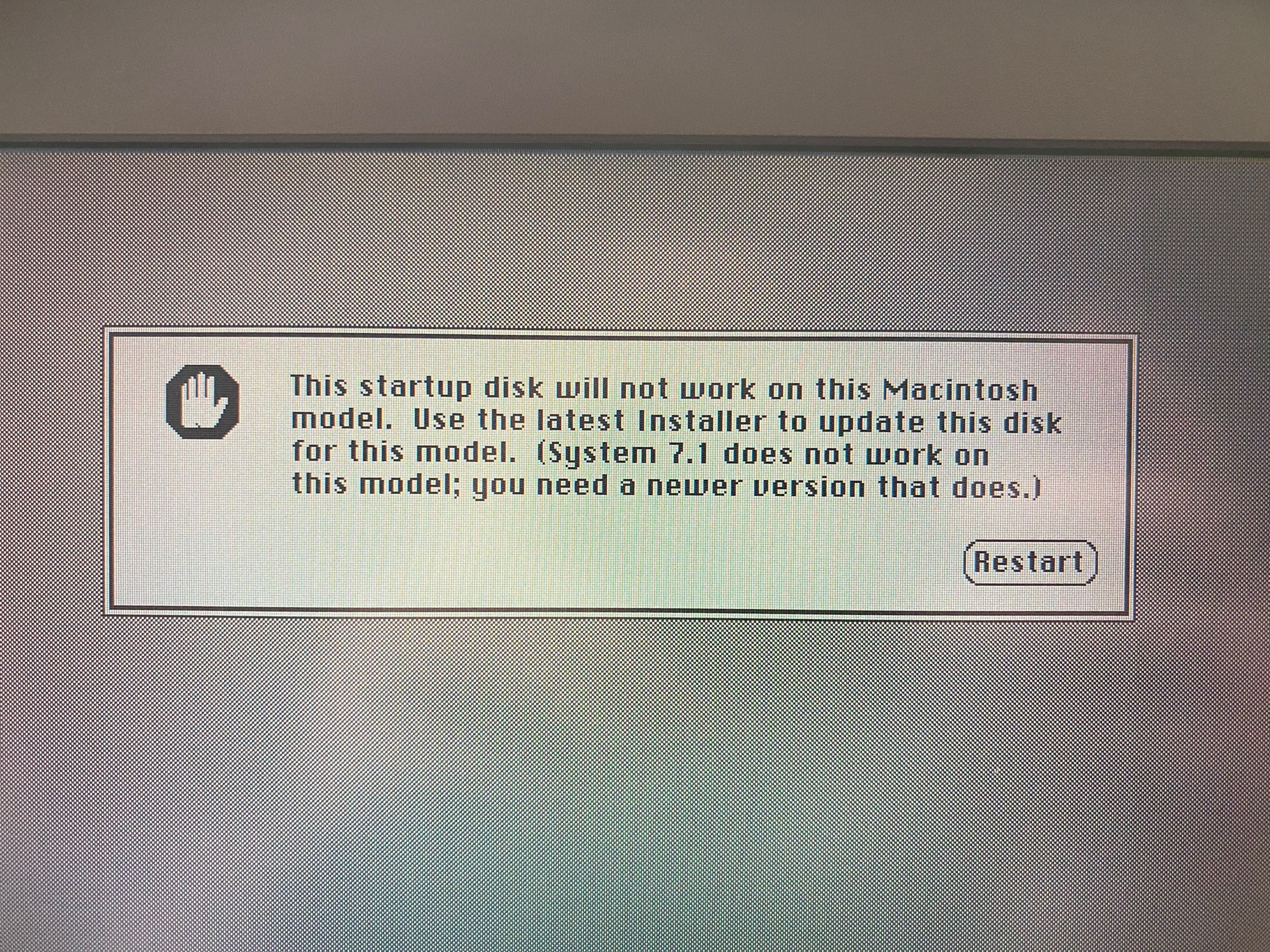

However ... after installing the BlueSCSI and inserting a known-good System 7.1 Install 1 floppy, an error appears that states 7.1 "will not work" on this machine. So, it seems I cannot install System 7.1 despite the fact that this machine was already literally running ... *checks notes* System 7.1.
Is there some kind of voodoo-magic required to get this to work, or am I just missing something here? I'm familiar with seeing this error when trying to install OS versions that are obviously totally incompatible with a particular machine, but have been quite baffled to see it in this case.

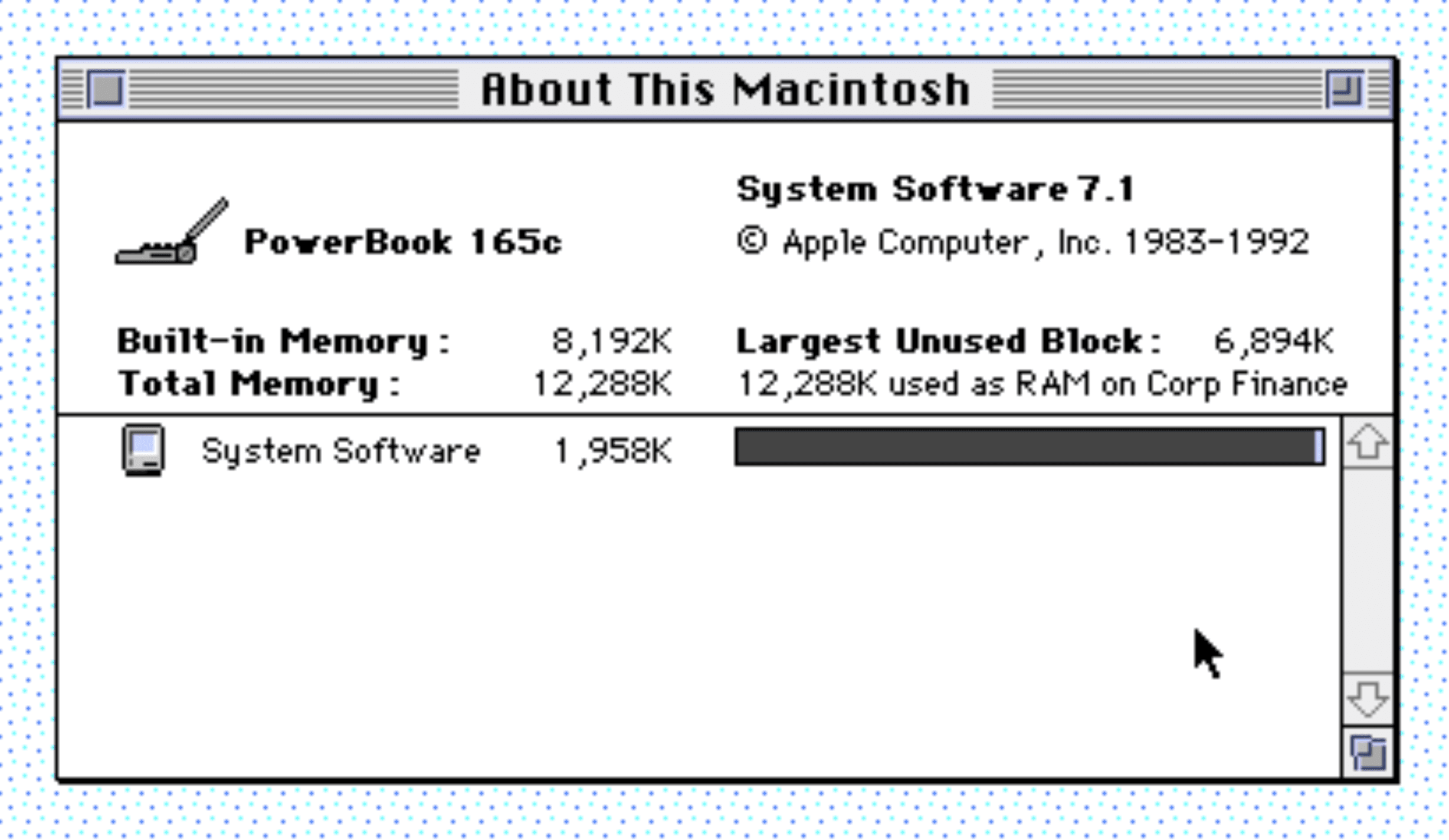

Screenshot running off the original HDD:
Error message:

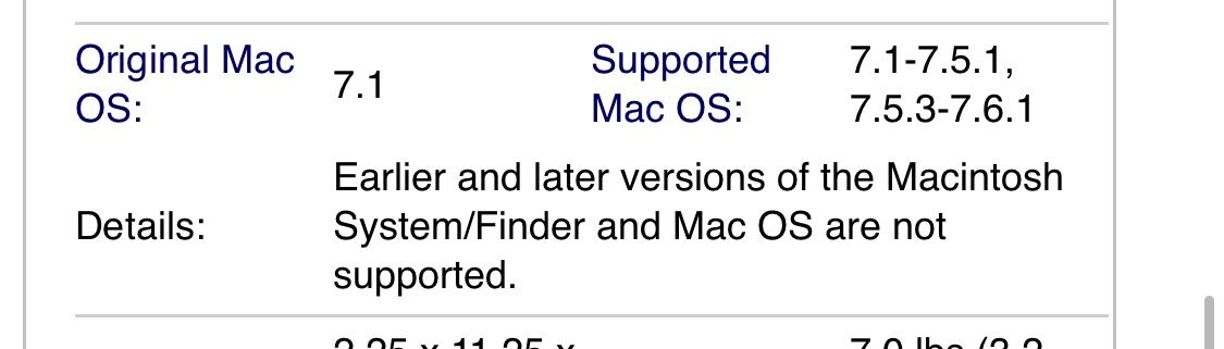

From EveryMac:

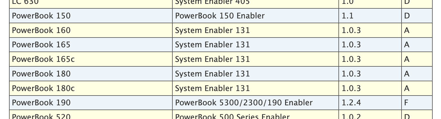

What are you using for your System 7.1 install source? I ask as 7.1 requires "System Enablers" to work on many systems (including the PB 165c) I would expect you'd see that error if you are using a 7.1 install source (floppies? images?) that includes a System Enabler for another model Mac.
Neat page that lists all the System Enablers:

I agree this is because of a missing enabler. You can download this from the Garden and just add it into your existing 7.1 install.
Yeah, I discovered it is System Enabler 131. Apparently the 165c is one of a select few 'oddball' machines that requires this under 7.1, as usually you can just use a "standard" installer with most other 1xx series machines. I've been wondering how/why someone would be selling install disks that are unusable, since they don't have the proper enabler(s) - so that would make far more sense. Going to give it another shot today...

I think this is normal, that a standard set of 7.1 installer disks will not have all the various enablers included. For systems such as the 165c, you’d need to use the installation media that specifically came with the machine.
Also, I can confirm that the PowerBook 160/165/180 also need this enabler 131 under 7.1. The 140/170 don’t as they were launched before the general release of System 7.1, so the custom code needed to boot these machines would have been integrated into the system.

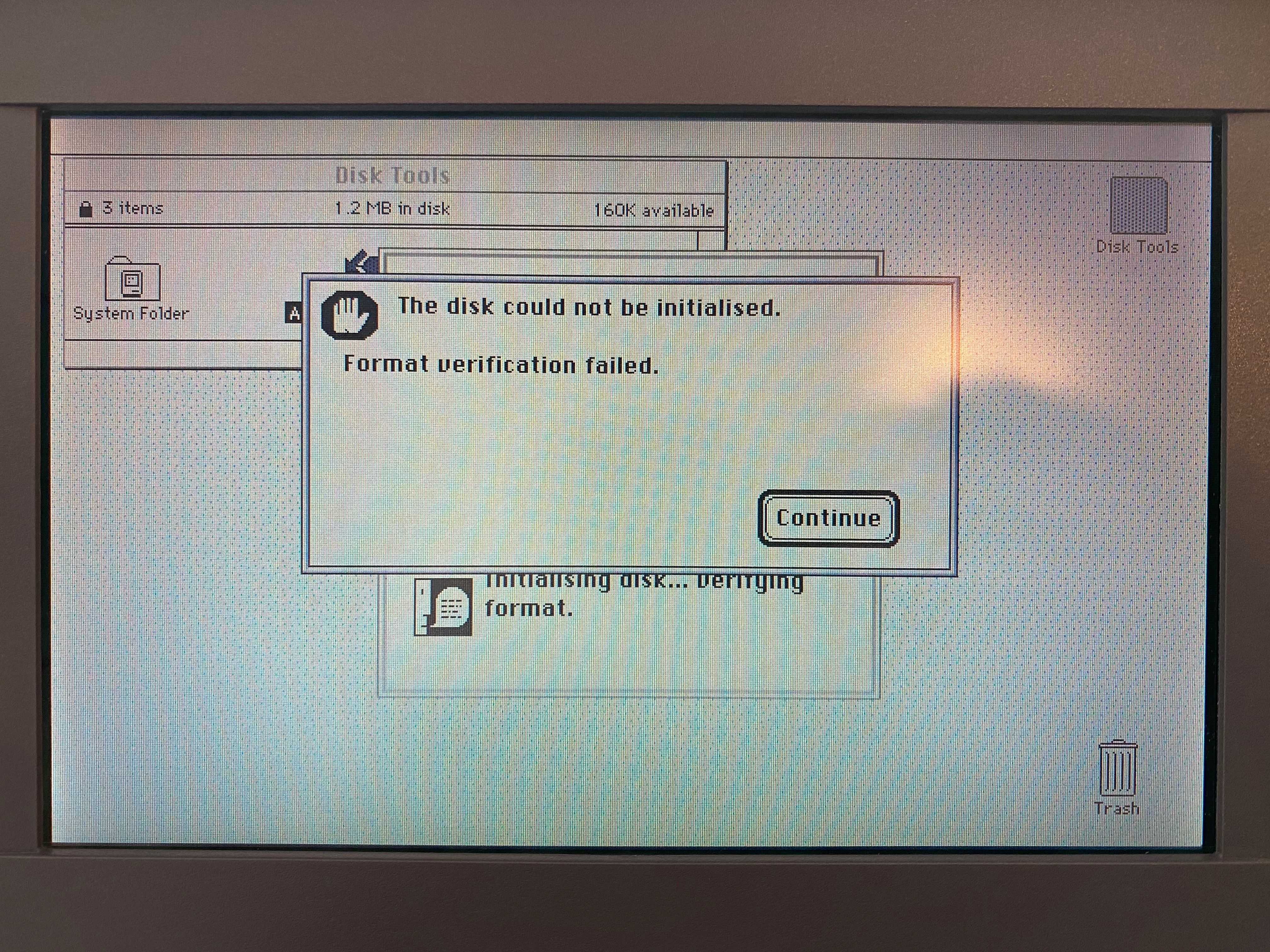

Alrighty, so a few signs of progress but still no success yet:
After a week of sitting, the PowerBook has now decided that it sees the BlueSCSI and will boot from it 🤷🏻‍♂️

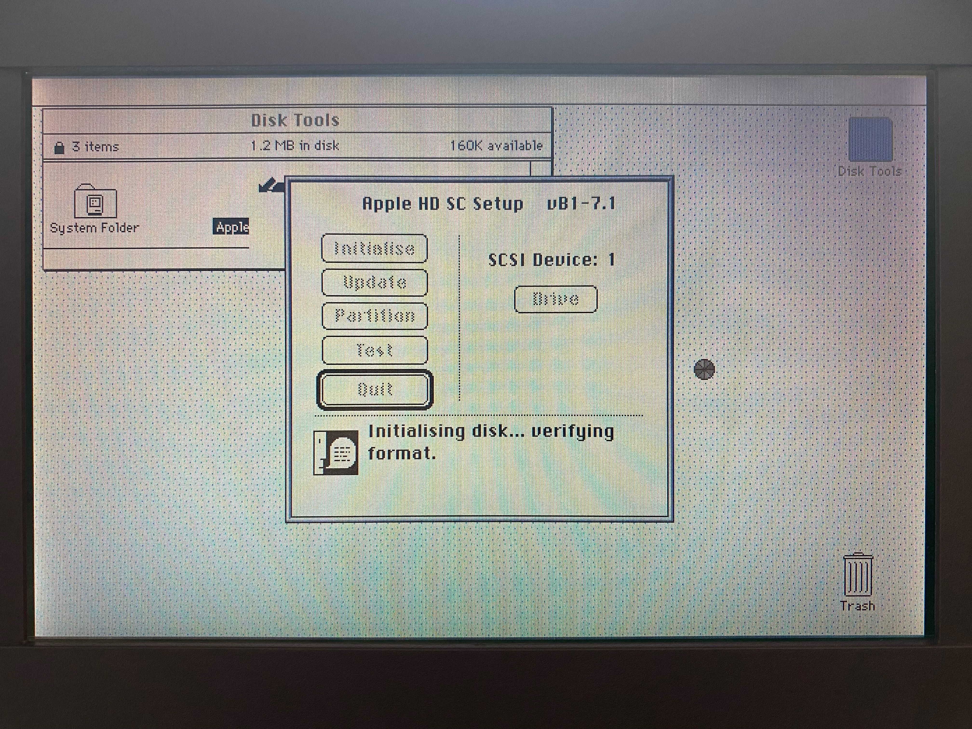

I also got my hands on a proper set of 7.1 disks with the correct enabler. Attempting to format the BlueSCSI using Apple HD SC Setup, I get a rapidly-spinning black-and-white ball (looks like solid black here) and it eventually throws this error.
I have tried (a) both a 128GB and a 16GB micro-SD card (I've read online that others have used these sizes with no issues after partitioning), (b) formatting them as both exFAT and FAT32 on my modern Mac, (c) using both GUID and Apple Partition Map. Nothing has worked. I re-read a lot of the documentation on the BlueSCSI site and re-watched several of the videos (including Geeky Bit's SD formatting guide), but I cannot see anything that I am doing wrong here. Is there something else I am missing?

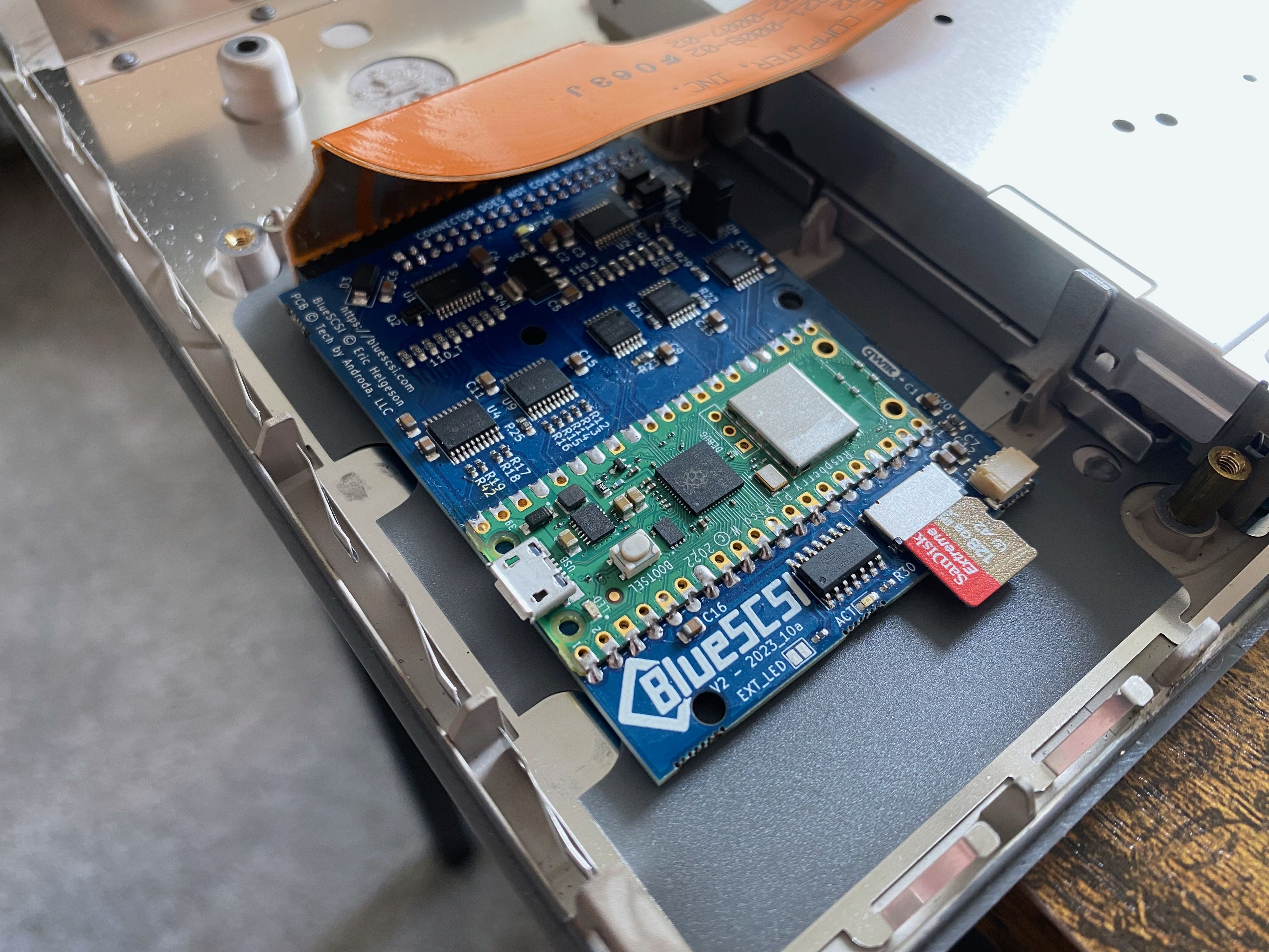

Do you have to the option to connect your original drive and the BlueSCSIv2 to the same computer and just clone the drive? I am no expert soldering guru myself, but the closeup of the BlueSCSI appears to have very inconsistent solder joints between the Raspberry Pi and the BlueSCSI board (some holes filled, some not, granted these are not hole through soldering, but still inconsistent).
I bought this BlueSCSI pre-built, so I spoke with the person who built it for me and they said it looks correct (these are "castellated" edges so this is normal in appearance for them).

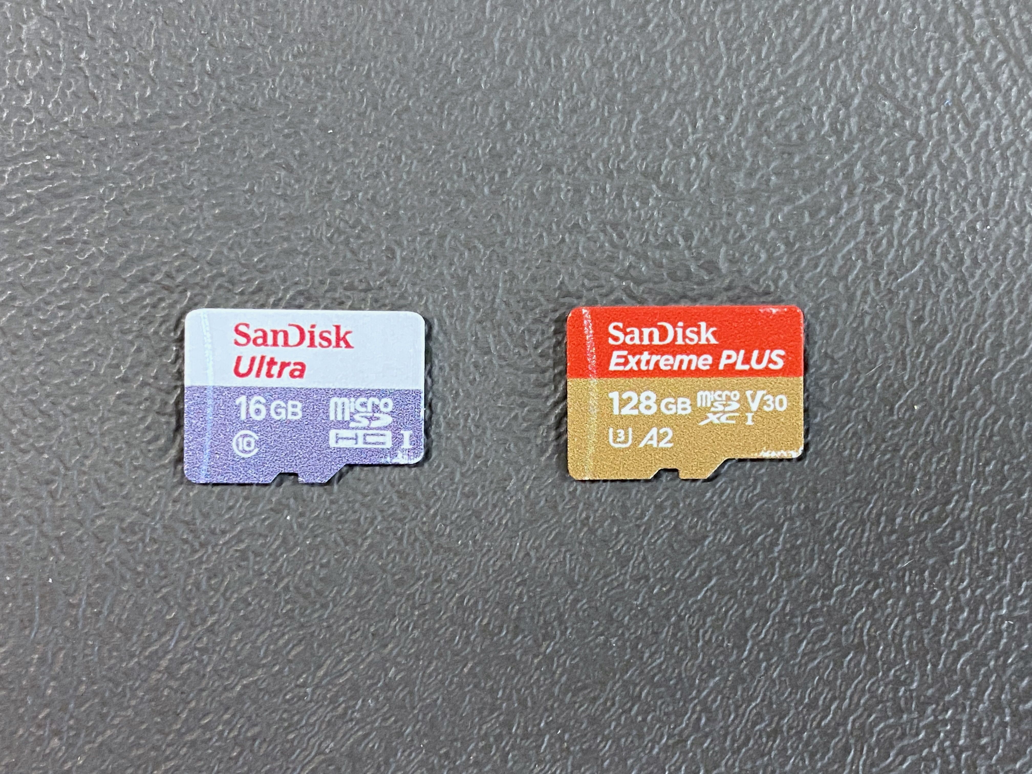

Now, the odd part: I had originally intended to use a 16GB SanDisk Ultra card for this, but long-story-short I discovered that this card DOES NOT WORK with the BlueSCSI (at least in this model/machine/configuration). I would format it as FAT32, copy the .hda file onto it, and install it into the BlueSCSI, but the blue light on the BlueSCSI would flash (which I think means it can't read the card?) and the machine would not recognize it or even write a log file onto it.
The card that ended up working is a 128GB SanDisk Extreme PLUS card, which - when set up *exactly* the same way as FAT32 with .hda copied over - worked just fine. The machine boots from it immediately, writes the log file to it, and the happy green light on the BlueSCSI flashes.
So, these two cards are formatted and set up exactly the same way, but one of them works and the other doesn't. If I'd known that certain types of SD cards were required beforehand that would have saved me a toooon of time and headache, but this is not mentioned anywhere in the BlueSCSi documentation as far as I can tell. If anyone has any insight into this, I'd love to hear your thoughts!

I'd recommend formatting the SD card as ExFAT, which is the preferred option as it lets you work with larger disk images (per spec, FAT32 supports files no larger than 4GB).

Thanks - yeah, those were both things I tried (before I got it working) but we've since discovered that the problem all along may have been something unrelated: the extra pin on the SCSI header wasn't properly removed and was preventing the cable from seating fully, which may have been the source of these issues. That would explain why it's been such an intermittent and odd issue, and why I couldn't seem to boot from the ALR CD image on the BlueSCSI initially.
Going to get the header replaced in the coming days and hopefully that'll sort this once and for all! Assuming I can get the thing to boot from SD reliably after this fix, will definitely reformat the SD as exFAT. The 7.1 image was working well (during times I could get it to boot) but I'll probably throw the ALR CD image back on there as well, just to have it.
